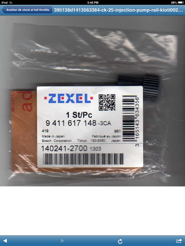

Questions for thepumpguy:
FYI, the full repair saga is in another thread but I don't know if you are following that one so I'm trying to pick your brain here.
When I opened up the IP, the gear on the #4 control sleeve was missing four teeth. I only found one of the teeth in the IP so I assumed the rest were in the oil pan (maybe in fragments). I replaced all four control sleeves, which was quick and easy.
After I reinstalled the IP I decided to check it by cranking (with all hard lines removed) and I got a nice little shot of fuel from delivery valves #1, #2, and #3 but nothing from #4. Thinking I reversed the plunger or something, I removed the IP and checked plunger #4; it appeared correctly assembled.
I had not planned to remove any delivery valves but I didn't know what else to check. I removed the #4 delivery valve and found some dark-looking dirt on the top of the little poppet so I cleaned it up and put it all back together. I put the IP back on the engine and still no fuel spurt from #4 when I crank.
I did have a concern about the little copper washer (delivery valve gasket) because I couldn't figure how to keep it centered when I reinstalled the delivery valve. I ended up hand-tightening the delivery valve and then using a small dental pick (from the bottom) to try to get it centered (more or less) before torquing.
So is it possible I just have some kind of air lock that's keeping fuel from reaching #4? I don't think I screwed up the control sleeve because the other three seem fine. Is it likely the #4 plunger/cylinder or delivery valve was damaged by the failed gear tooth? Should I just send the whole thing off to a Diesel shop (I don't know of a local one)?
Anyway, I thought I'd ask your advice before doing anything else. Thanks.
Scott

FWIW, Can you swap out #4 with a different cylinder/plunger to see if it changes delivery on the #4 line, before deciding to send the IP out for inspection/rebuild?

CM: I may try that but it requires removing the delivery valve and I am unsure how to keep the DV gasket centered for reassembly. I'm hoping TPG knows a trick he'll share. There are a couple of other things I want to check, like the #4 cam and free movement of the #4 plunger. Thanks for the suggestion.
/ Another dk stuck at full throttle. #45
The gasket centers itself in the "nut".. if you wanna feel better about it, put the dv gasket IN THE HOLDER 1st.. then set it on top of the dv & screw it down.
Its not likely that the plunger got damaged from the teeth, but anything is possible..
It would have been very noticeable by its movement in the bore.. {wouldn't slide back in}..
The cut on the plunger, goes opposite the rack..
Its possible that #4 tappet assembly [roller] wont go up & down.?? Lock the pump in a vise & use a screwdriver on the tappet to compress it several times.. IF it was stuck, they get stuck UP.. & would have been noticeable when you pulled it out the 2nd time..

TPG countrybumpkin, and CM:
SUCCESS.
I had reassembled the #4 delivery valve wrong, but maybe it came from the factory that way. I had the gasket below the delivery valve seal (a machined cylinder that sits on top the pump cylinder) instead of above it. I figured this out by (in desperation) removing the #3 delivery valve (which always worked) and inspecting it. I saw #3 had that copper gasket between the valve holder and on top the deliver valve seal. So I reassembled the IP like #3, put it back on the engine, and soon had little shots of fuel from all four cylinders when I cranked the engine. Just so you know, I then put the rest of the tractor back together and the tractor runs fine now.
Now, I wonder if the #4 delivery valve was mis-assembled from the factory. I got no fuel from #4 while cranking even before I ever touched that delivery valve. I could swear that I reassembled the #4 DV exactly as it came apart (but senior moments are more common now). With 4 cylinders I could have missed weak power from one cylinder. I wish I took more photos along the way but I only had two very dirty hands.
Your suggestions helped enormously, but TPG's words about centering made no sense until I realized the gasket was in the wrong place (after examining the working #3 DV).
