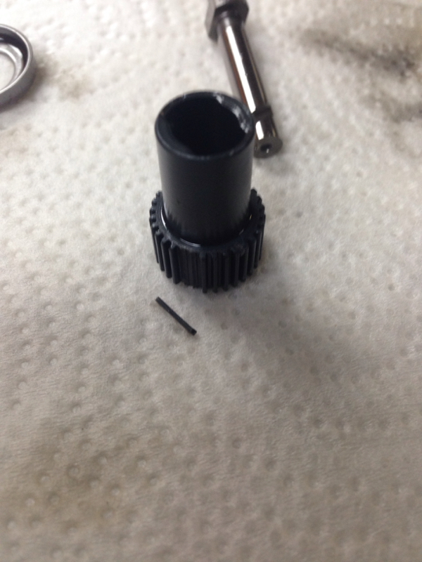

I was able to get all four new control sleeves from a local diesel injection pump shop for 12 dollars each, after disassembling the pump, I found only one control sleeve with broken teeth but I changed out all 4. Got it all put back together today and runs great. Thanks for all the help and info.

Thanks, I did know to keep all parts to the same bore, I never did get a number from the pump, I had it with me in case I needed it, but when the guy seen the control sleeve he went to the part racks and came back with for new sleeves just like the old one. It did turnout to be the same part number as the zexel pic in one of the write ups from above. I'll see if I can find it again and link it here. I should have took a little more time and effort and documented a bit better with part numbers but between the holidays and being sick over the last week I was just happy to have it finished. :) my buddy was ecstatic just having it back running and very little cost, he has only had this tractor a few months, but has had his other kioti for 10 years with little issue.

Is it possible for the gear teeth to be broken and the pin move freely?
/ Another dk stuck at full throttle.
#28
Yes it is, if the broken pieces fall out and don't get jammed in the rack.

Question for Country Bumpkin: Hope you still monitor this thread. I think my 2006 DK45s just broke a control sleeve tooth. I'll cover symptoms elsewhere but I wanted to verify that the photo you posted shows the part number for a DK45s IP control sleeve. Thanks.

Yes that’s the part number I used to replace the broken ones. Only one was broke but I replaced all three.
