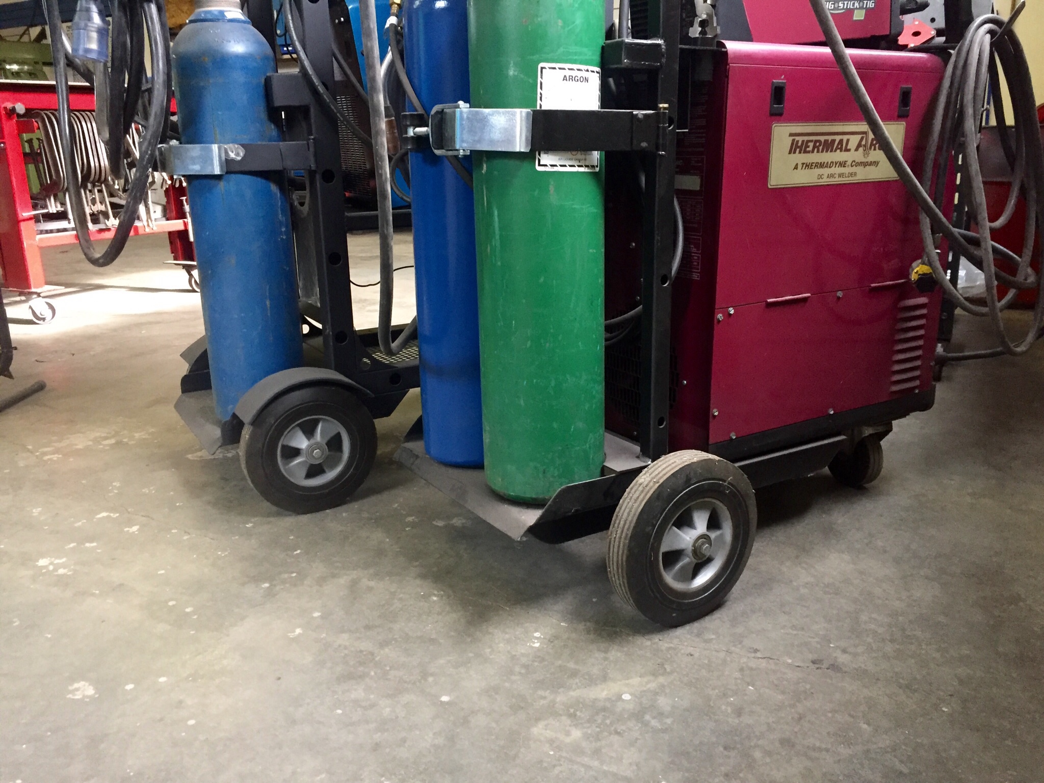

Some how I can't get my HF 10" wheels on 5/8" bolts inspired enough to look like that.
   / angle iron axle #26
Without any information other than what you've given us and realizing this is the bare minimum, I'd just weld a piece of shaft in the inside corners of the angle iron and have it stick out far enough to be the axles.
I've extended the width of a few hand truck axles that way so they wouldn't tip over when I hauled fence posts around he pasture. A couple of wheels have cracked possibly from too much weight but the axles and stubs have held up well.
   / angle iron axle
#27
What I ended up doing was to weld a couple of 5/8" nuts in the corner of the angle. Then bolted the wheels on using 4" bolts with locking nut. Two inch square tube with slide out inserts would be nice. Could keep the wheel base tight for getting through doors then widen out to be more stable when in use.
I made it tall so I could avoid bending. It is actually less stable lengthwise especially in the vertical position. I am going to hang some weight on the light end rather than extending the frame.

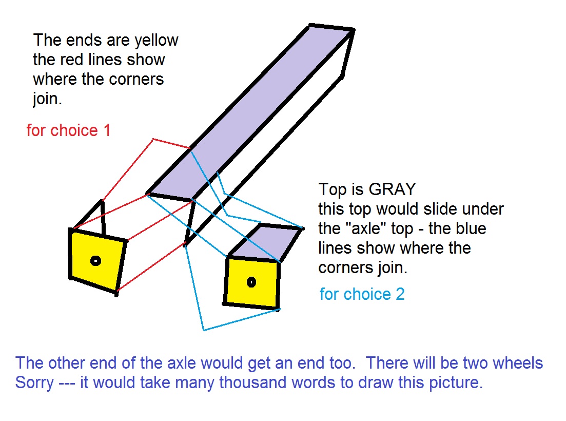

   / angle iron axle #28
A picture is worth a 1000 " tell us more" posts.
Sketch something on paper, take a photo, and post it. You'll get some good advice.
Without more information, it will look like this if you do what everyone will suggest. :)
Bruce
I anxiously await your posts Bruce!!!! Where do you find this stuff??? Great example. :D
