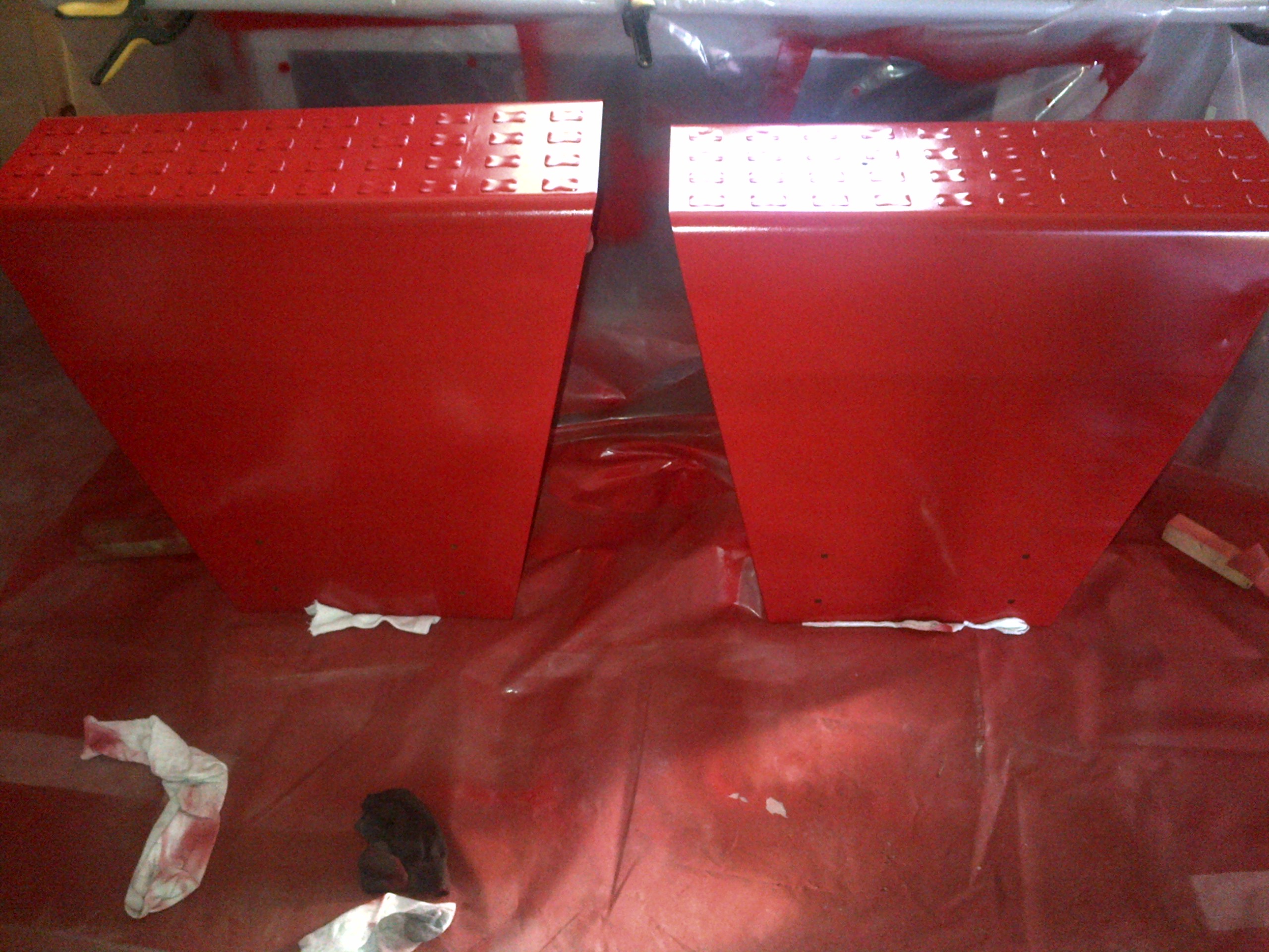

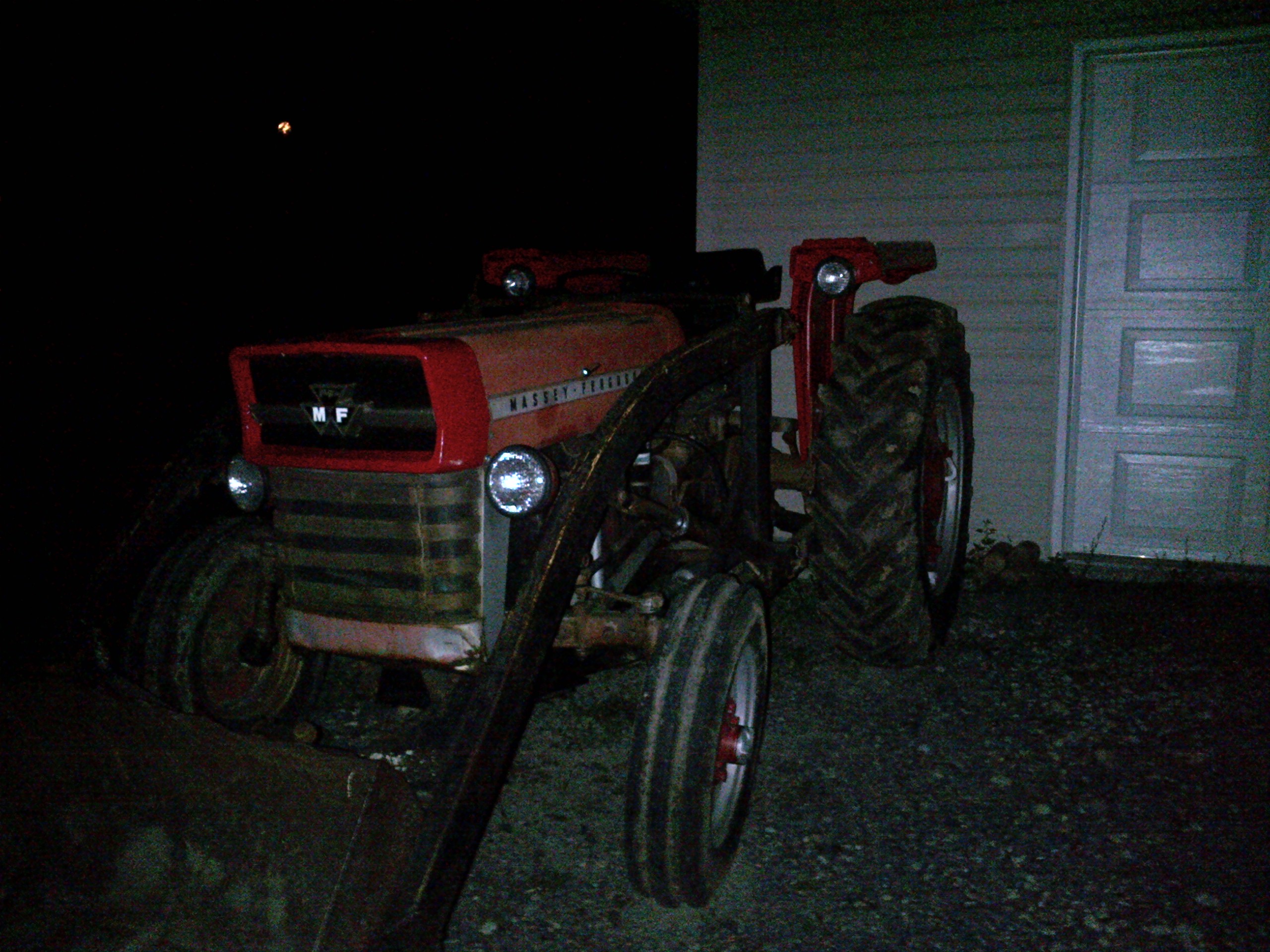

Finally got both fenders back on the tractor! Poor picture but I was excited last night... I installed the fenders 1 position higher than they'd been previously as I picked up some chains for the winter that are pretty bulky with large links that I was worried about clearance on. But for 25$ for the pair I can't complain!
You may need to move your rear wheel out one notch to allow clearence between fender and tires for the chains since they wrap around. I had to move mine to about 60 inches center to center otherwise the chains were clipping the fenders. sure wouldn't want to mess up all that hard work. Lookin good.

Thanks for the tip - hadn't actually thought of it that way. But you're absolutely right I'd hate to do that!
Speaking of hating to mess up the work... in full daylight this morning I noticed that I did muck up the one fender a bit during re-installation. Guess it rubbed against the position control lever. There's a scratch maybe 1/16" wide by an inch long. If I clean with alcohol or varsol or something can I just touch up with spray? Or any other ideas? I'm dissappointed, but I know it's going to happen over the course of being used anyways. But want to prevent moisture getting in and the rust starting under the paint.
/ AMD's 1968 MF 135 #44
Simple. Do it same way as auto touch up paint. Spray some rattle can paint in the cap. It may require several times to touch it up. But it does work. Use a Q-tip, broken end of a toothpick, tiny hobby paint brush. -kid

OK, cool I can handle that. I've never done auto touch up before but should have known - we do a similar process at work for touching up conformal coating on PCBs... Thanks Kid!

Thanks namyessam, I'll have to check my clearance. When I was reinstalling the fenders I had a 3" extension on my ratchet so I may be alright. As I had mentioned a while back my fenders aren't from a 135 so there may be some extra / different spacing. How much space do you have now? I was hoping to keep my outside wheelbase under 72" - it's at 68" now - so that I'm not driving on snow that hasn't been blown... with the intent that I'm getting a 6' blower.

I'll measure the clearence between the tire and fender this weekend and let you know. The centerline is about 60 and 13.6 inch tire width puts it about 74 inch wheelbase.
/ AMD's 1968 MF 135 #49
Measured the clearence between the fender bracket bolted to the axle housing and the tire and got 4 1/2 inches. Op manual says the PAVT adjust in 4 inch increments. I believe that is two inches per side. Overall wheel base was 73 inches with 13.6 - 28 tires.

Thanks - Do you have dished fenders? I measured and have at minimum just shy of 4" where the wheel passes closest - it might be 3 and 7/8. I have the same size tire and wheel base is maybe 68.5" - so I'd assume I'm one position inside of where yours are. Hoping this will be enough...??

I have the two headlight flattop fenders on mine and if I have 4 1/2 inchs now originally I had about 2 1/2 inches before I moved them so if you have 3 7/8 to 4 inches you should be fine. I think I have the drive lugs in the second and third hole in the rail on the rim. you are probably right about your position compared to mine. If your overall is 68 1/2 and add 4 inches that would be 72 1/2 give or take a little. That will be a good setup with the 6 foot blower.

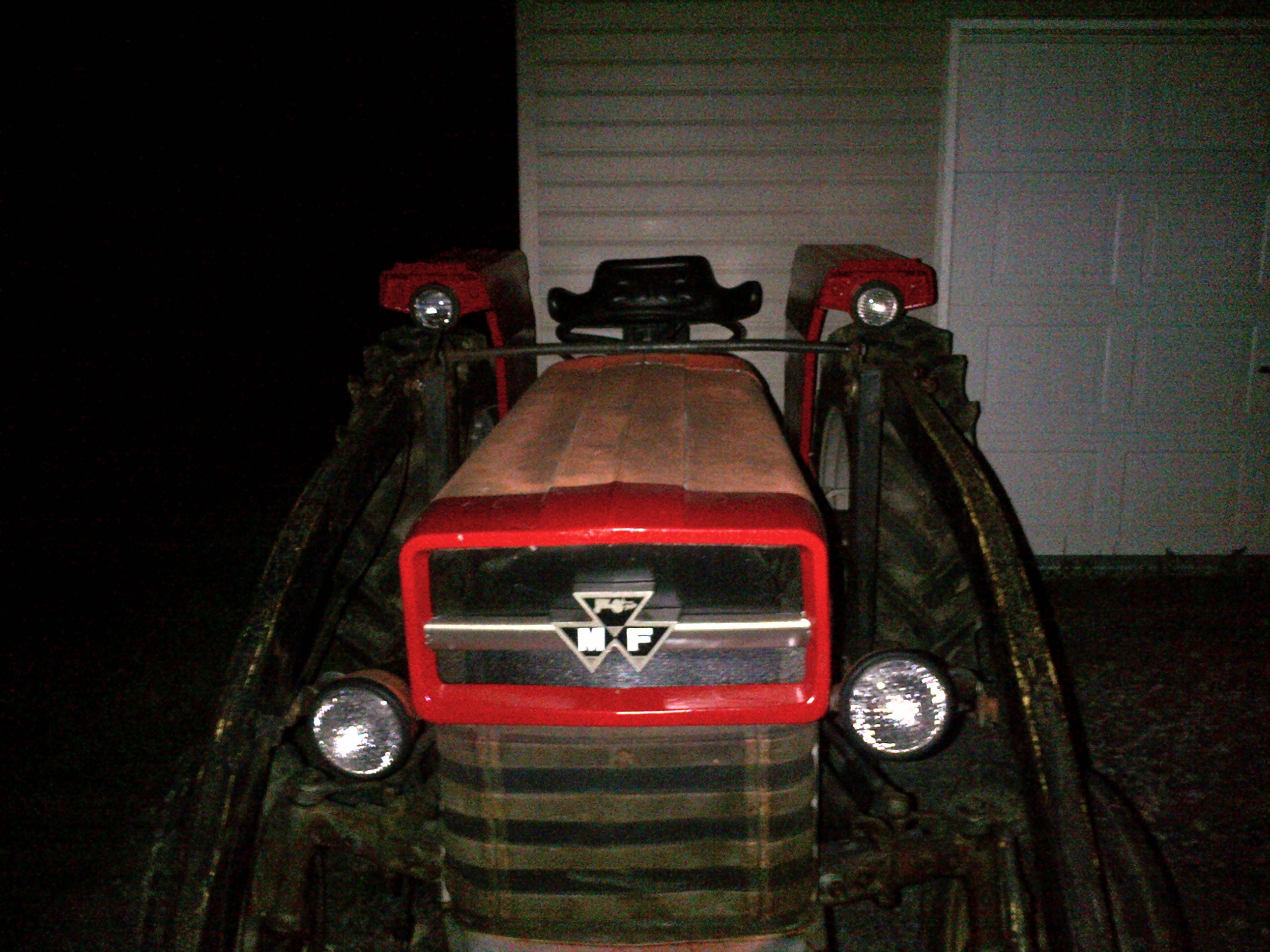

Hoping for some more help again :)
I did get an old George White snow blower and have actually put it to use in the last week. However the tractor still needs a few things to make my snowblowing experience even better:
lights > just need to hook them up to the switch and get power to them. Think I'm on top of this, just never have found the time... however snowblowing at night with a flashlight was less than ideal and increases my urgency.
chains > when I went to put my chains on last weekend, I found that they wouldn't fit between the tire and the loader mount as there's only about 1" of clearance. Obviously something I overlooked - oops. I have PAVT rims so should be able to adjust them out 2" on each side which will allow the necessary clearance - question is how? I've read the manual and searched online and haven't found a definitive answer that makes me condfident I know what I'm doing yet. Each rim has 4 connections from the outer part to the inner part but only one of these has bolts that seem to hold the position. Do I only need to loosen and remove these 2 bolts on the one slider to be able to adjust? That's how it looks to me but none of the directions make it sound this simple. Any help appreciated!
