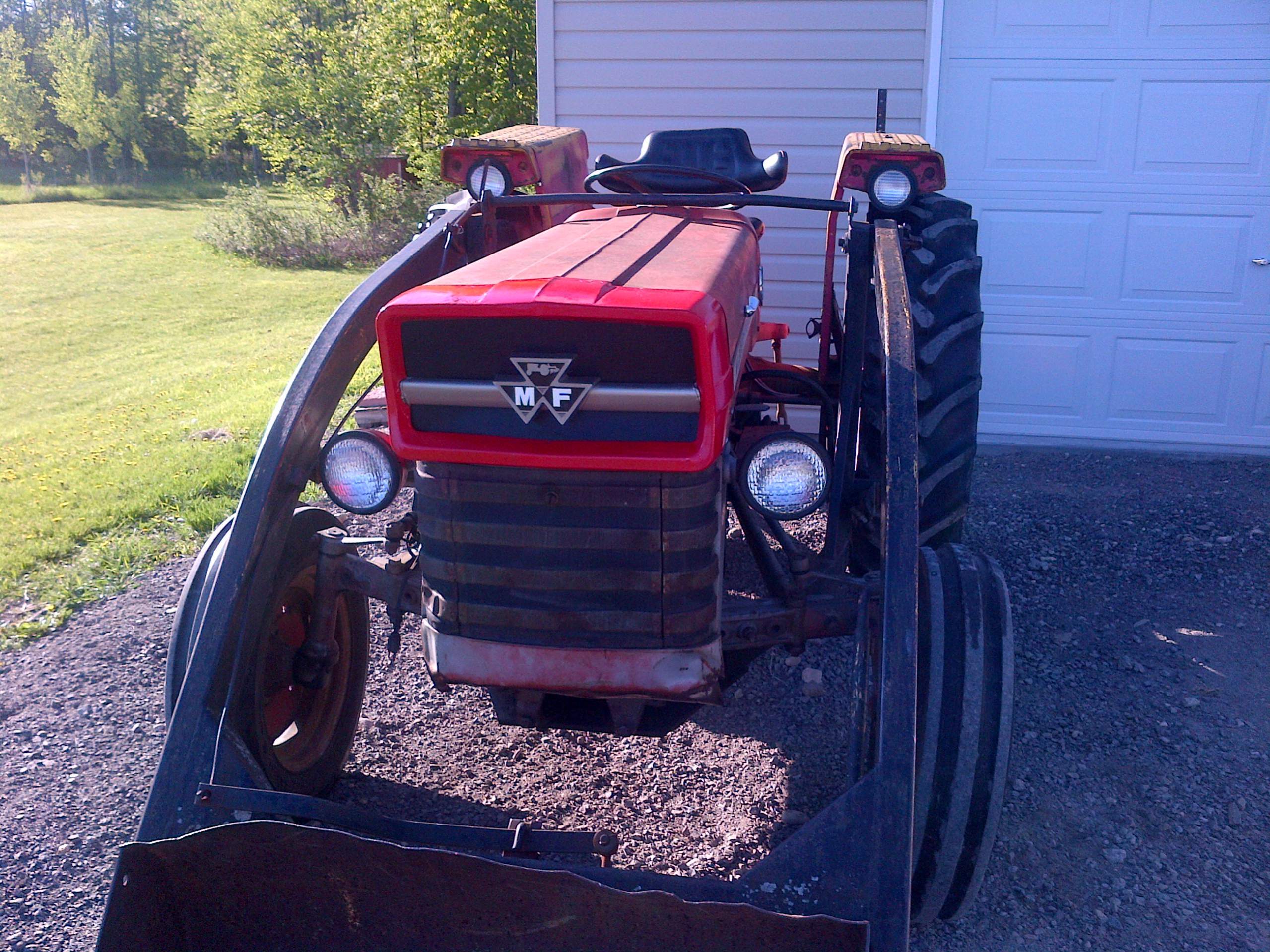

It's the same one! - Just cleaned up and painted. It had a pretty bad bondo job before - up close it's far from perfect but much better than it was.
/ AMD's 1968 MF 135 #23
nice job!

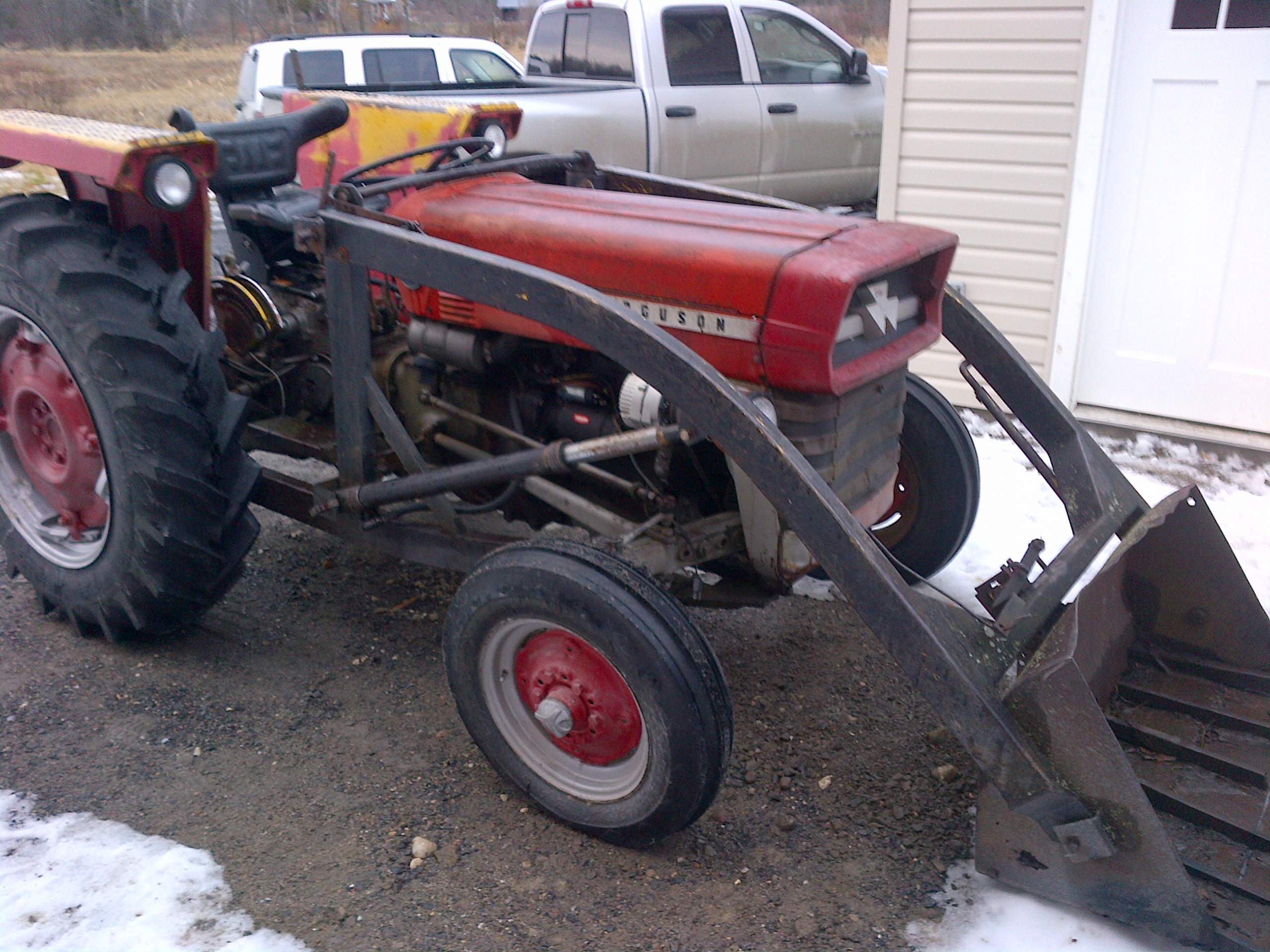

As mentioned I'd removed my fenders - the carriage bolt that attaches the bracket at the axle must be worn and allows the fenders to wobble. I haven't gotten the bracket off yet however. The loader I have prevents me from getting a socket on the front nut as the mount is below the rear axle. I tried to see if I could loosen the loader and slowly back up far enough to gain access without removing the loader completely but that didn't work - it wasn't free enough to stay put while the tractor moved. So I'll have to revisit that at a time TBD...
Anyway, since I have the fenders off I figured I'd clean them up and re-paint. Worked on that a little on the weekend. Found some wasp nests... and some rusty parts. But all in all pretty good. I still don't know where my fenders came from - in a previous post I mentioned they are flat top, but they don't seem to match what should be on a 135. Under the red paint it was yellow, so I wondered if it was the 2135 Industrial version but the part number doesn't match what Agco parts book has for that either. The rear light in the fender had a sort of red film on the back and there was a smaller bulb behind the PAR 36 - so I'd almost assume this was a brake light for something? Here's a photo of the housing that goes on the front of the fender - part number 193026M1. Is there a way to tell what this is off of? I did quick internet searches and can find the part but not necessarily the intended tractor it belongs too.

I was in at the Massey dealer on the weekend and I found out the origin of the fenders I have - as mentioned they were not from a 135. He was able to plug in the stamped part number off them and found them to be from either a MF302 or MF304 - both industrial which did explain the yellow paint. The one unfortunate part is that on 2 of the light assemblies the part that that holds the light to the fender portion was well rusted and they're no longer made - 1019387M91 "frame assembly". I've done a few quick internet searches and no idea yet if I'll be able to replace them.

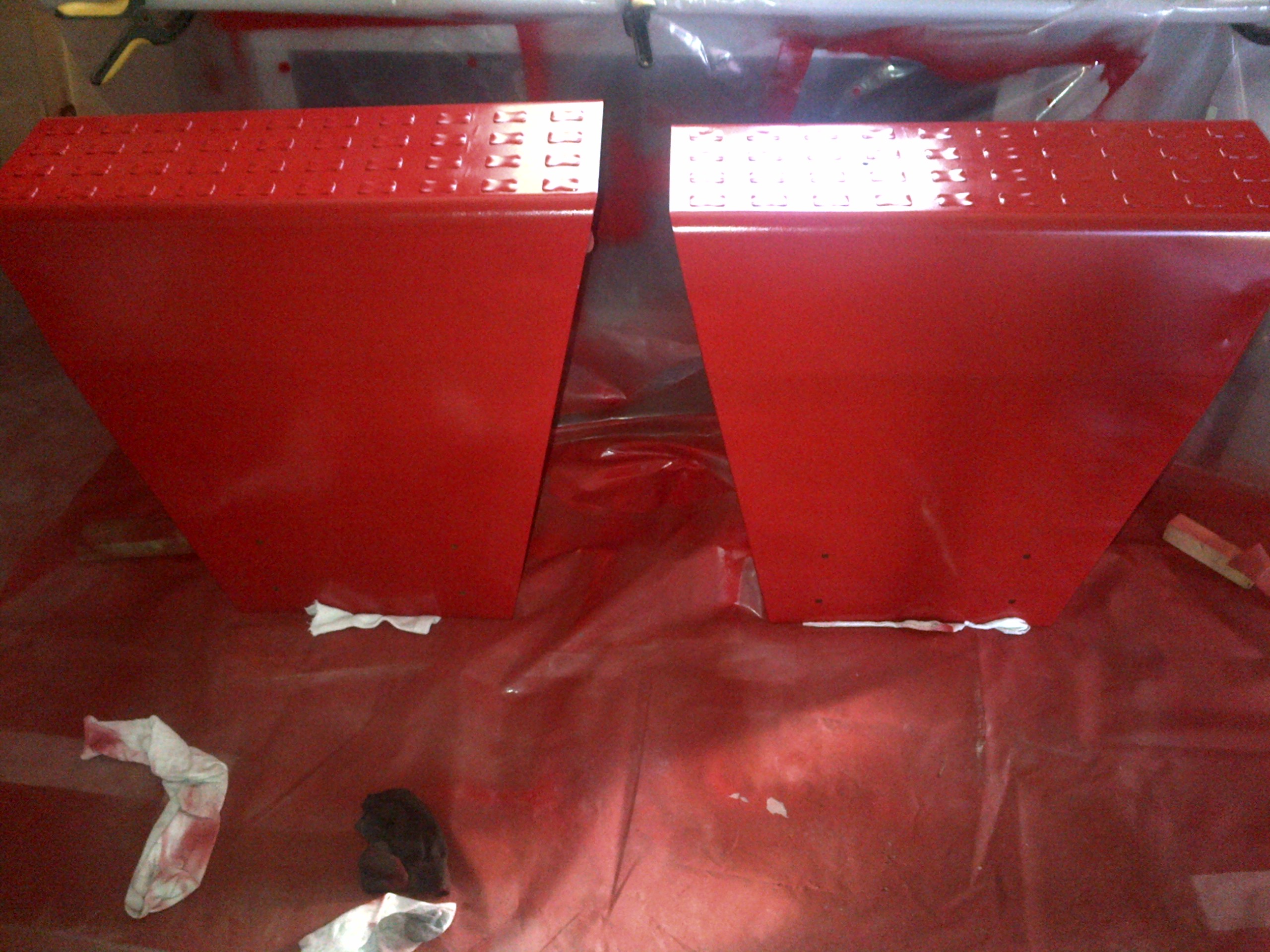

Slow progress on them but they're coming along:

I picked up some new hardware last night and sprayed the bolts - may get these installed tonight if I have time. Also hopefully fixed the wobbly fender last night by replacing the carriage bolt with a new hex bolt and washers on top & bottom to accommodate for the rounded hole on the bracket. It may only be temporary but should do until I can remove the loader mounts to get the nut off the front of the bracket.

It was the one already on the tractor when I got it. Not sure if it was original or not, but it was in pretty bad shape and had some bondo on it. I just cleaned it up a little. Don't know if the originals were all metal or not, but this one is not.
/ AMD's 1968 MF 135 #35
I can tel you for a fact that that is the original nosecone. Notice the flat surface facet on the very front. Aftermarket are somewhat rounded. Trust me, I know the difference. It looks like it cleaned up really nice. You are better off for fitment with that one.

Finally got both fenders back on the tractor! Poor picture but I was excited last night... I installed the fenders 1 position higher than they'd been previously as I picked up some chains for the winter that are pretty bulky with large links that I was worried about clearance on. But for 25$ for the pair I can't complain!
