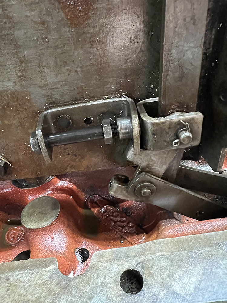

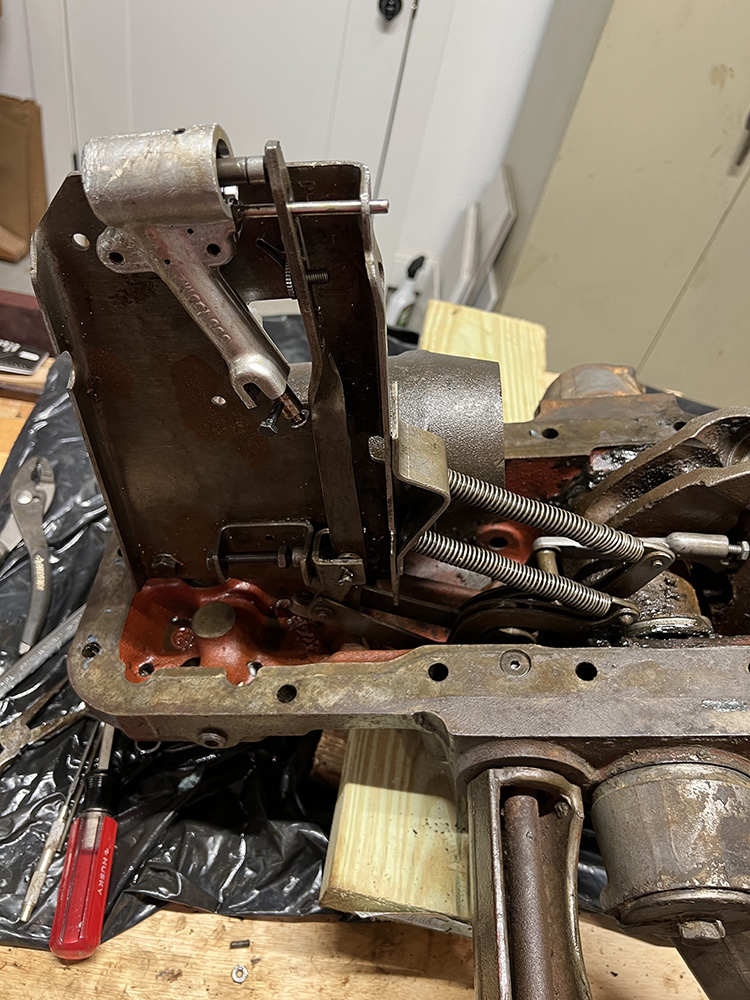

Thanks for the replies lokester. Update: I have removed the top with lift arms and have it upside down on my bench. Right away I see the draft spring has somehow been pulled part way off and the draft rod has been bent. So I'm obviously replacing those. I don't see any other damaged parts or something that looks out of place according to the shop manual and yt videos I've watched. What appears to be the problem is that when I move both draft and position levers in the UP position, the control rod (that moves the hydraulic lever) does not move far enough to allow the hydraulic lever to fully move so the lift works, if that makes sense. It seems like the control rod should move all the way towards the rear of the tractor so the hydraulic lever can fully move too. I think there may be a problem with the adjustment screw on the back of the control lever yoke - it is a very short (1/2" approx.) set screw that doesn't touch anything. It is just there with a nut on it. Maybe a longer screw is needed to actually make that adjustment. Anyway, I'll check out the above link/thread to see if it will help. I'm waiting on a few parts so I'll post any significant updates here later on.
Attached are some pics of current situation. You can see the draft spring is jacked up from where is was partially pulled off. I put it back on just while working on it.

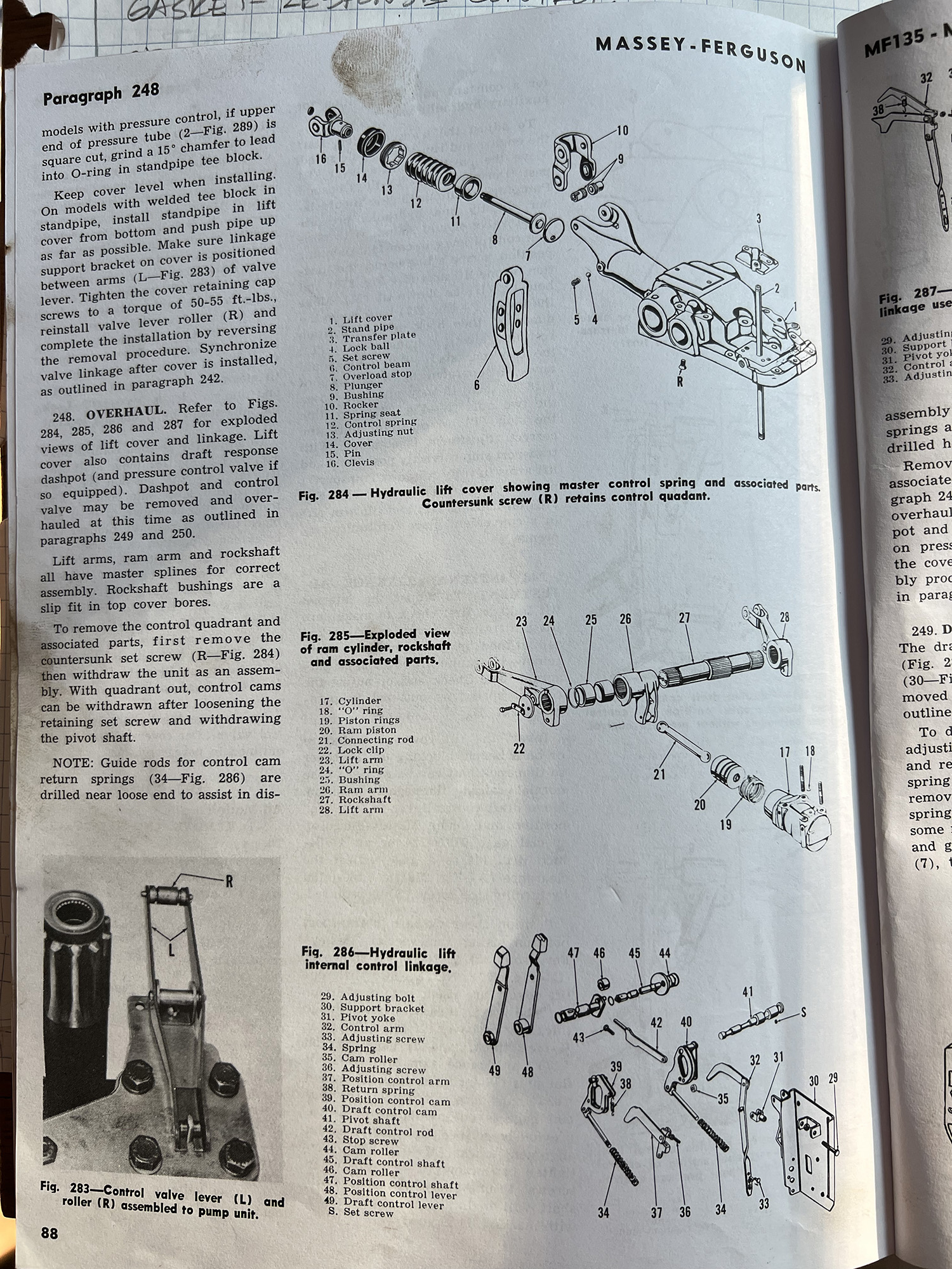

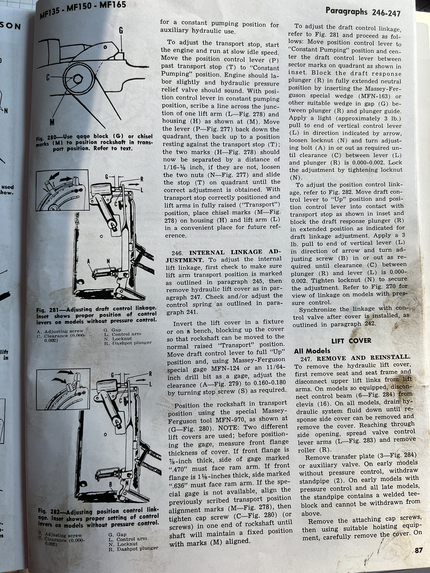

Also lokester, here are some images from the MF-27 Shop Manual (purchased from local Tractor Supply) that may be helpful for your question about arm setting while making adjustments. I think you're correct using the block, but this has more info about that too. Hope this helps.

UPDATE: I removed the top lid and put it upside down on the bench to work on the linkage (hydraulic pump was not the problem). Basically replaced a couple parts (draft control spring, draft rod, large draft spring assembly). The levers that are moved by the quadrant control were out of position so I fixed those. I also adjusted position and draft controls according to above image instructions. Also replaced hydraulic filter and drained and put in new fluid. Put the top back on (hardest part of the entire process was moving that thing - very heavy). Cranked tractor and move the quadrant levers. No lift (hide sharp objects moment). Then I thought about the stand pipe - so I removed the little cover for that part, pulled it up and reset it and then the lift worked. I guess I didn't have it seated properly. Anyway, I don't know if draft is working exactly as it supposed too, but it lifts, holds and lowers implements which is what I need. Hope this helps someone.
