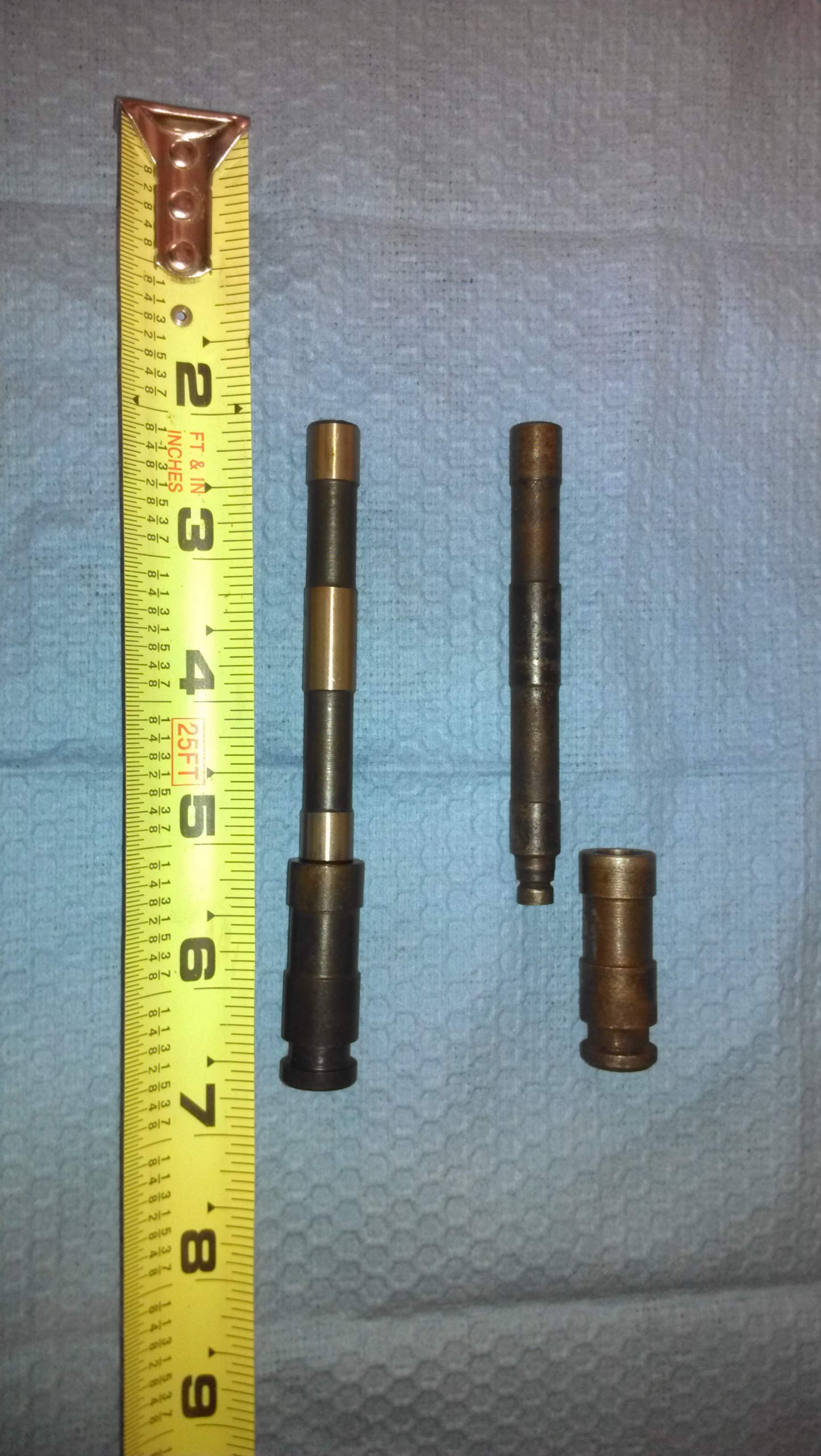

Forgot to post a picture of the new vs. old hydraulic linkage pivot shaft. It actually is a two piece pin but there is a sort of brass snap ring that holds them together. The old one had a lot of slop in it.

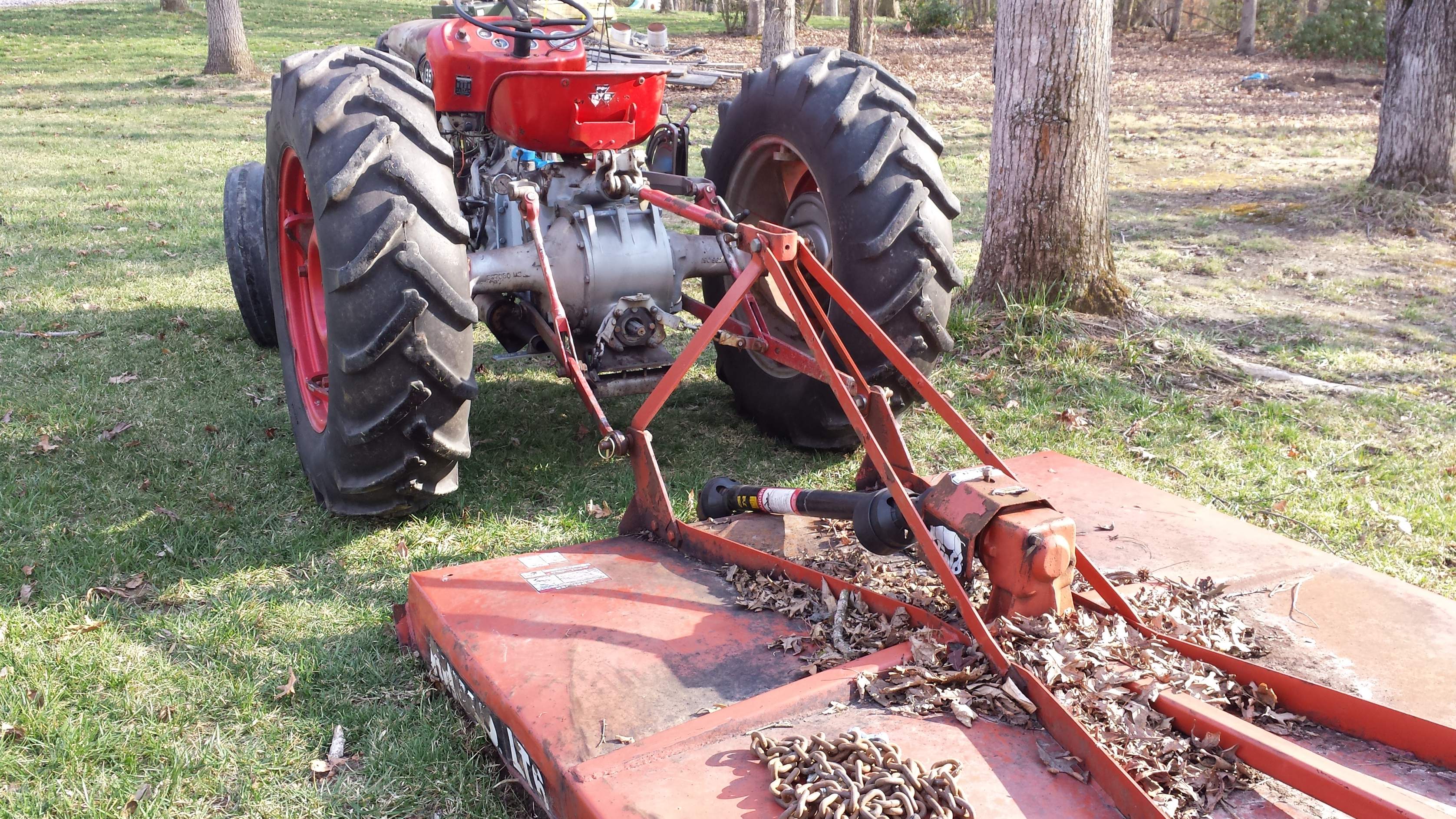

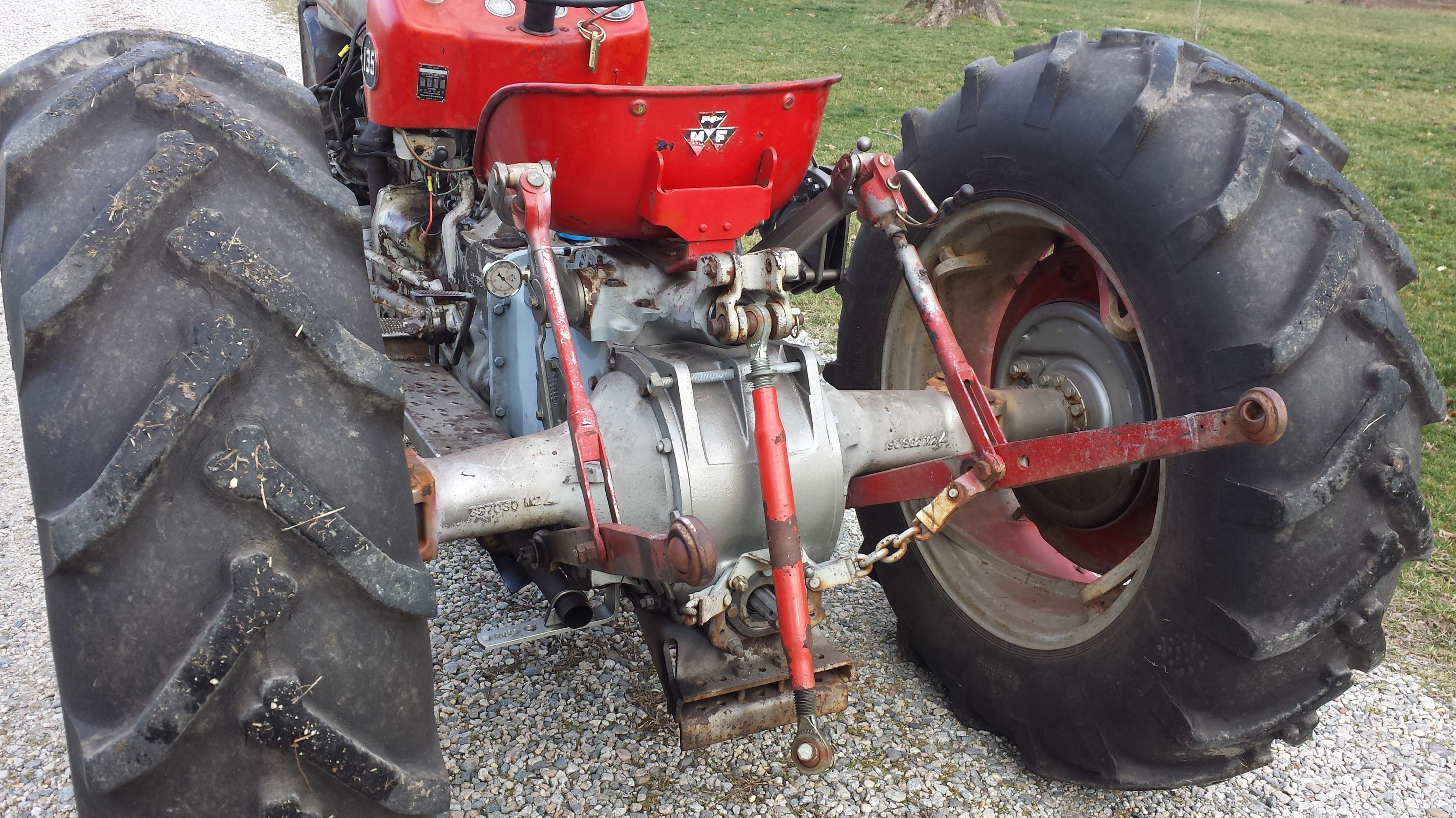

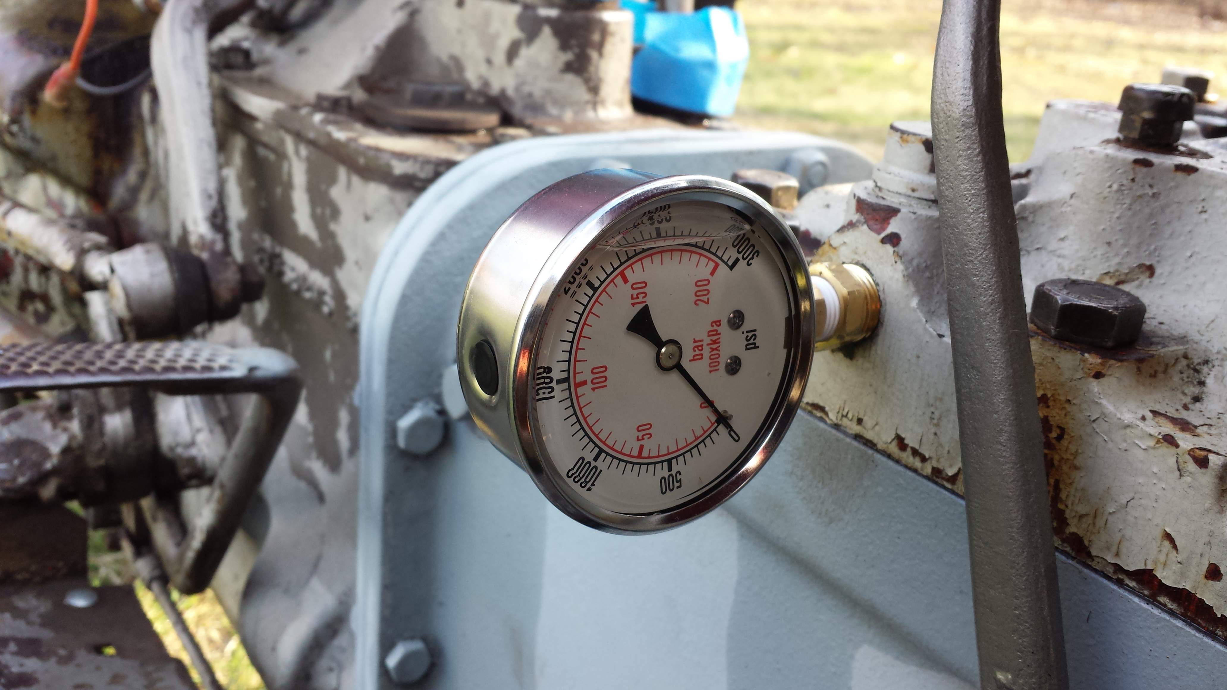

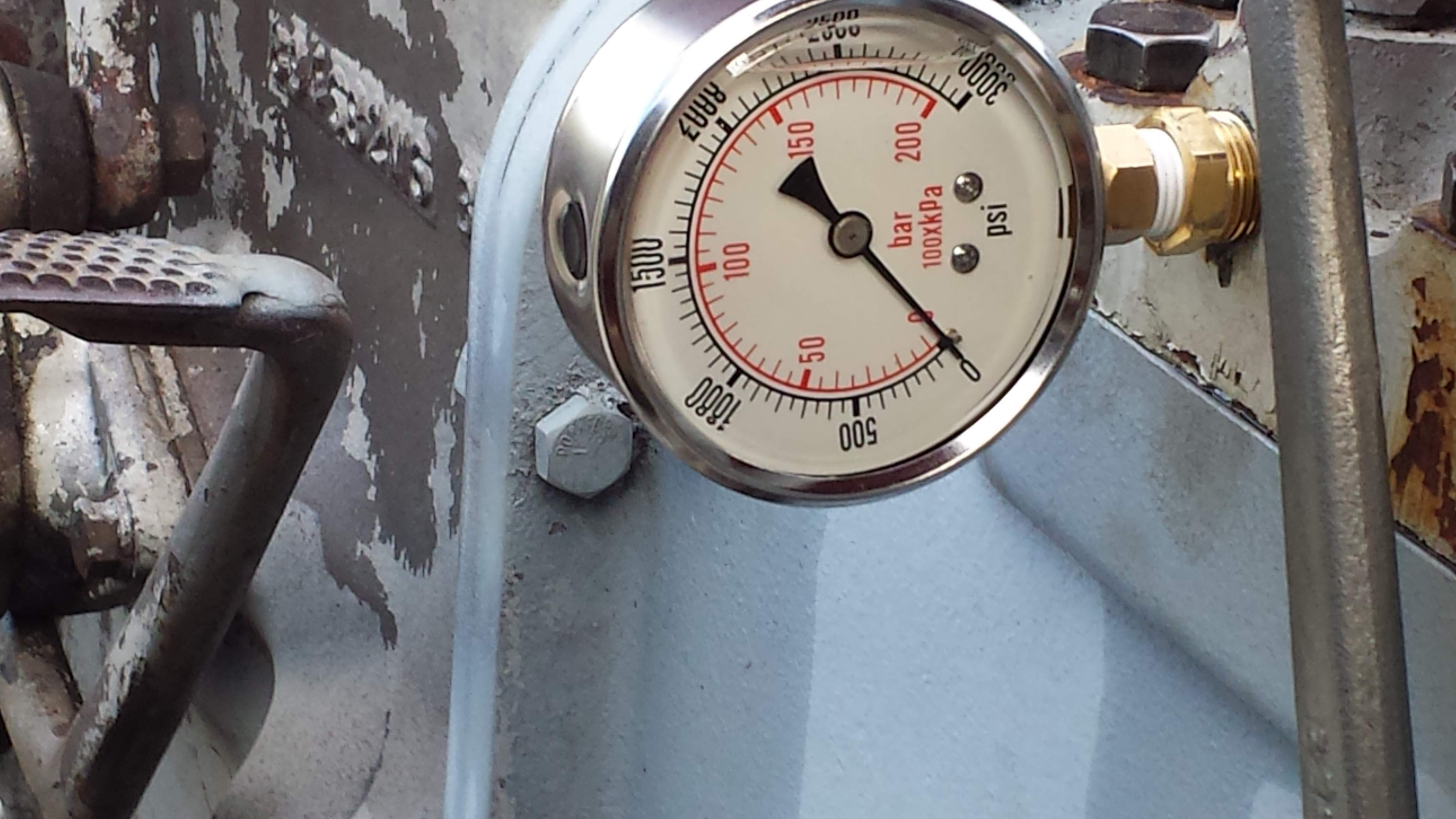

Ok, I got a 3000 psi gauge from Northern Tool. Got it installed today and did some testing. I have not drained any oil or removed the side inspection plate but here are my results.
I first checked the gauge without an implement attached to the three point hitch. The draft control lever is in the full up position and the position control is moved through the full range stopping at the transport position. The gauge reads 0 psi through the full range of motion. When the position lever is placed into the constant pumping position, you hear the relief valve begin to sound and the gauge jumped to about 2800 psi. I didn't get a picture because I didn't want to leave the system in this situation that long. Here's a picture of the set up.
Next I connected a bush hog as you normally would through the top link. The levers were operated in the same manner and the front of the bush hog wouldn't even come off the ground. The gauge barely came off 0 psi. Here's a couple pics:
Last I removed the top link connection and attached a chain from the top link connection of the bush hog to a bolt below the top link connection on the tractor. I operated the levers in the same manner and it raised the bush hog through the full range of motion. The gauge read about 700 psi with the draft control lever in the full up position and the position control lever in the transport position. Here are some pics:
Based on the above information, what is my next move? Any guidance would be greatly appreciated.
Thanks, Michael

G'Day termyte.
Excellent photographs.
So now we know the pump is o.k although the pressure is a bit high , should be around 2500 <>psi.
Remove the sideplate as suggested and with the toplink in the Normal operating position that is attached to the draft link , and again the draft lever all the way up, slowly raise /move the Position control lever towards and stop at the transport position watching what the control valve is doing ,if you find that the control lever is returning the control valve to neutral before the linkage reaches the transport position gently assist the control linkage and move the control valve to allow the pump to raise the implement, if this has the desired effect you will have to remove the draft link assembly ,the one with the big spring inside, remove complete and readjust when you are happy all is good with this part ,thoroughly clean out the housing and make sure the sensing rod inside is properly located ,that is it should be sticking out about 1/4 inch if all good reassemble and test ,you may have to adjust the compression on the spring to fine tune the controls, this is done by Tightening the big NUT behind the dust boot ,adjust say 1/4 turn at a time and test till you get a satifactory result.
Let me know the results and we can go from there.
Happy Days.
Hutch.
   / MF 135 Hydraulic 3 Point Hitch Questions #30
What happened when you placed the lever in constant pumping with bush hog on the upper 3 point position (draft control)?
I agree that your pump is fine, you just have maladjusted linkage.
Aaron Z
