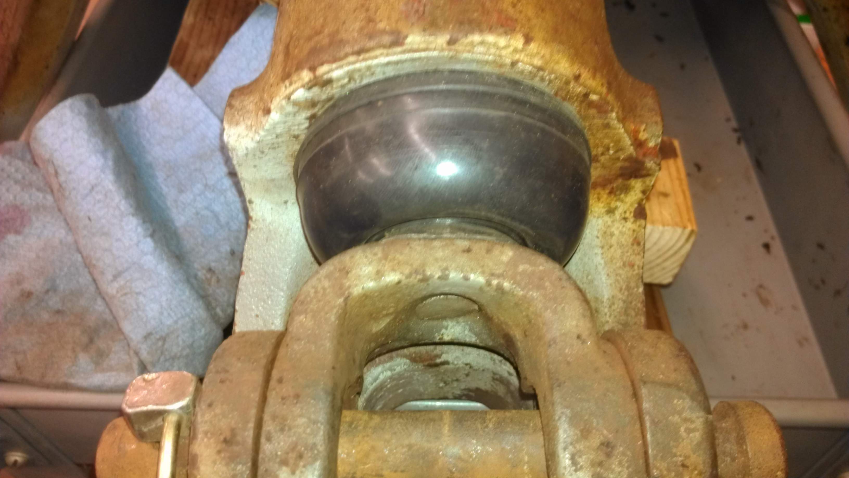

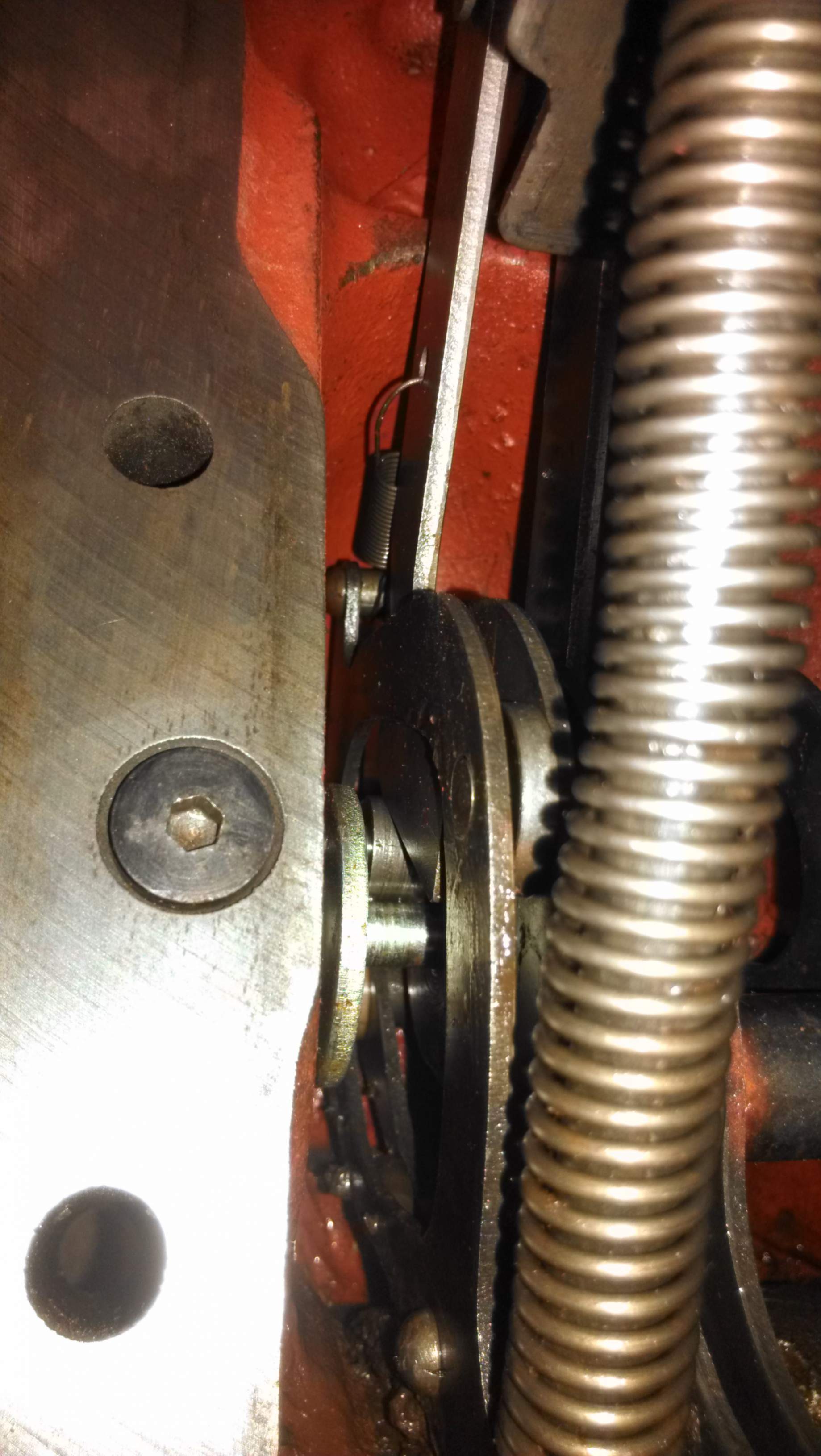

Well its been a while since I posted but I finally got a new pump and got it installed today along with the PTO shaft and drive shaft with coupling. Moved on to the internal adjustments on the lift cover and think I may have found another issue. Got the draft adjustments taken care of and then moved on to the position adjustment. Changed the positions of the quadrant controls but when I went to apply the 3 pounds of force, the lever moved with barely a touch. I did some investigating and found the hydraulic linkage pivot shaft may be in question. It is part number 898304M91. Is this supposed to be a rigid shaft? It has play in it right next to where it comes through the casting on the cam assembly side. This should show up in the attached photo. I have googled the part number and it is available but I'm hoping someone can confirm my suspicions first. Thanks for all the help to this point.
Michael

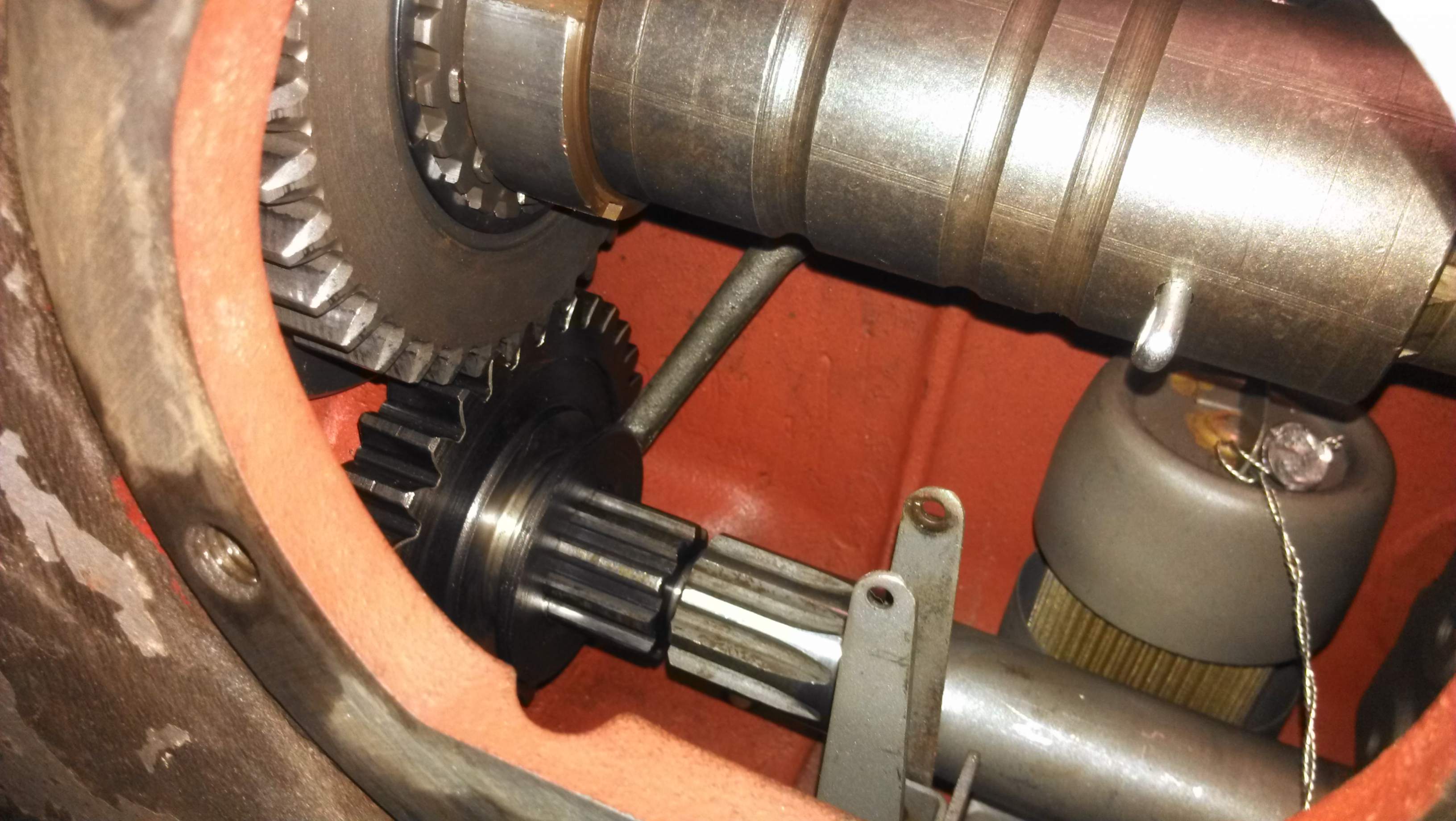

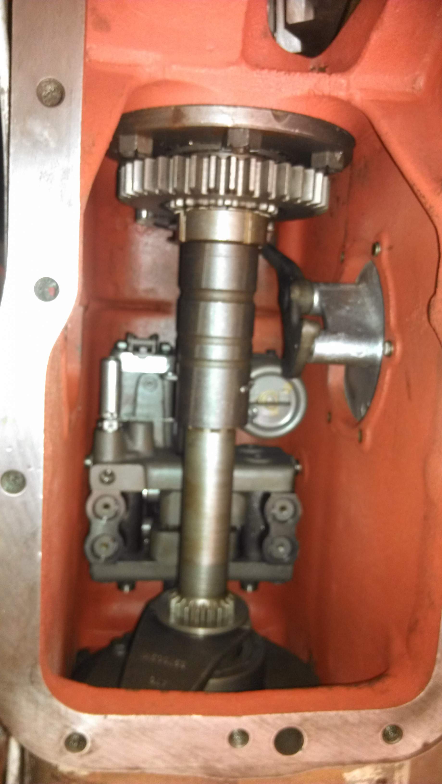

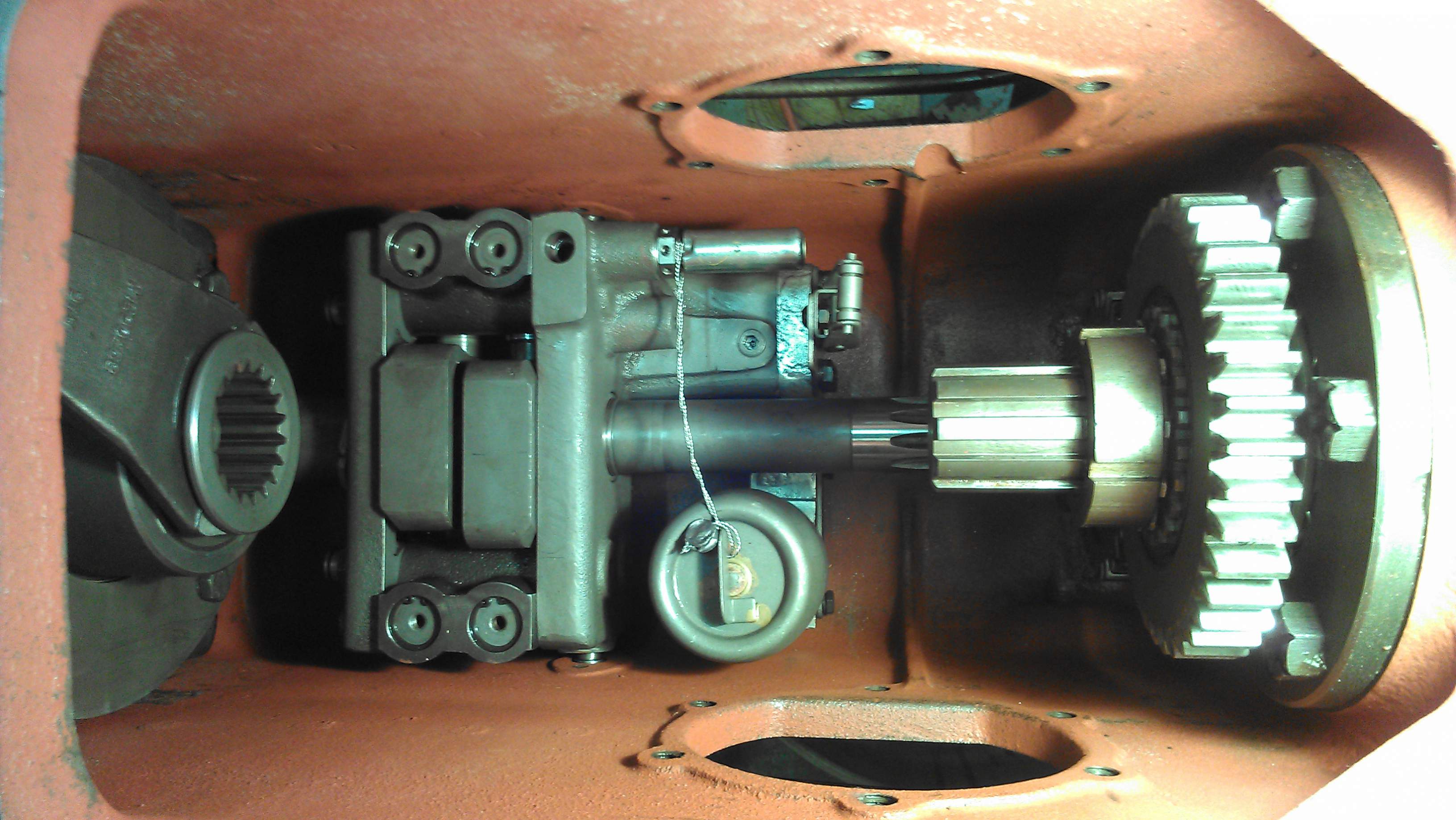

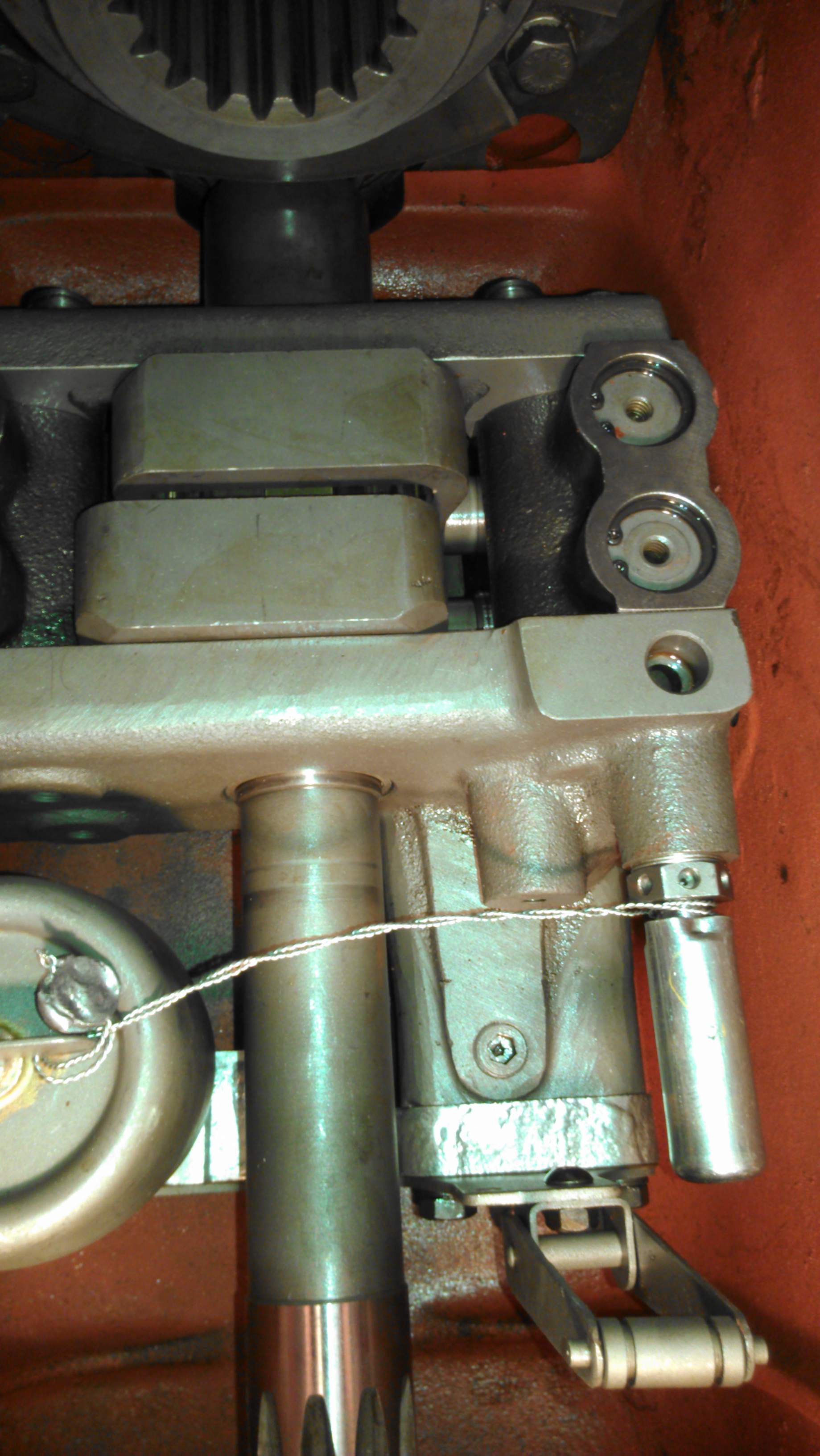

Well I finally got some time to post pictures of the progress so far. Got the new pump installed.
The new coupling that came with the new pump to join it to the transmission had to be removed and the old one was used. Simply could not get the pump up on the shaft with the new coupling. Took the new coupling off and tried just fitting that on by itself and it still would not go. After two+ hours of trying, decided to use the old coupling and had the pump installed in 10 minutes.
Got the PTO shaft re installed with a new seal and o-ring.
Also got the drive shaft and coupling reinstalled. Forgot to take a picture of the needle bearing in the transmission end of the shaft that needed replacing at this time as well (all the old needles starting falling out when the shaft was removed).
Also got the PTO side cover reinstalled. Went ahead and did this so I could verify the selector went in the proper slot.
Also got the adjustments done on the draft control spring and a new boot installed.

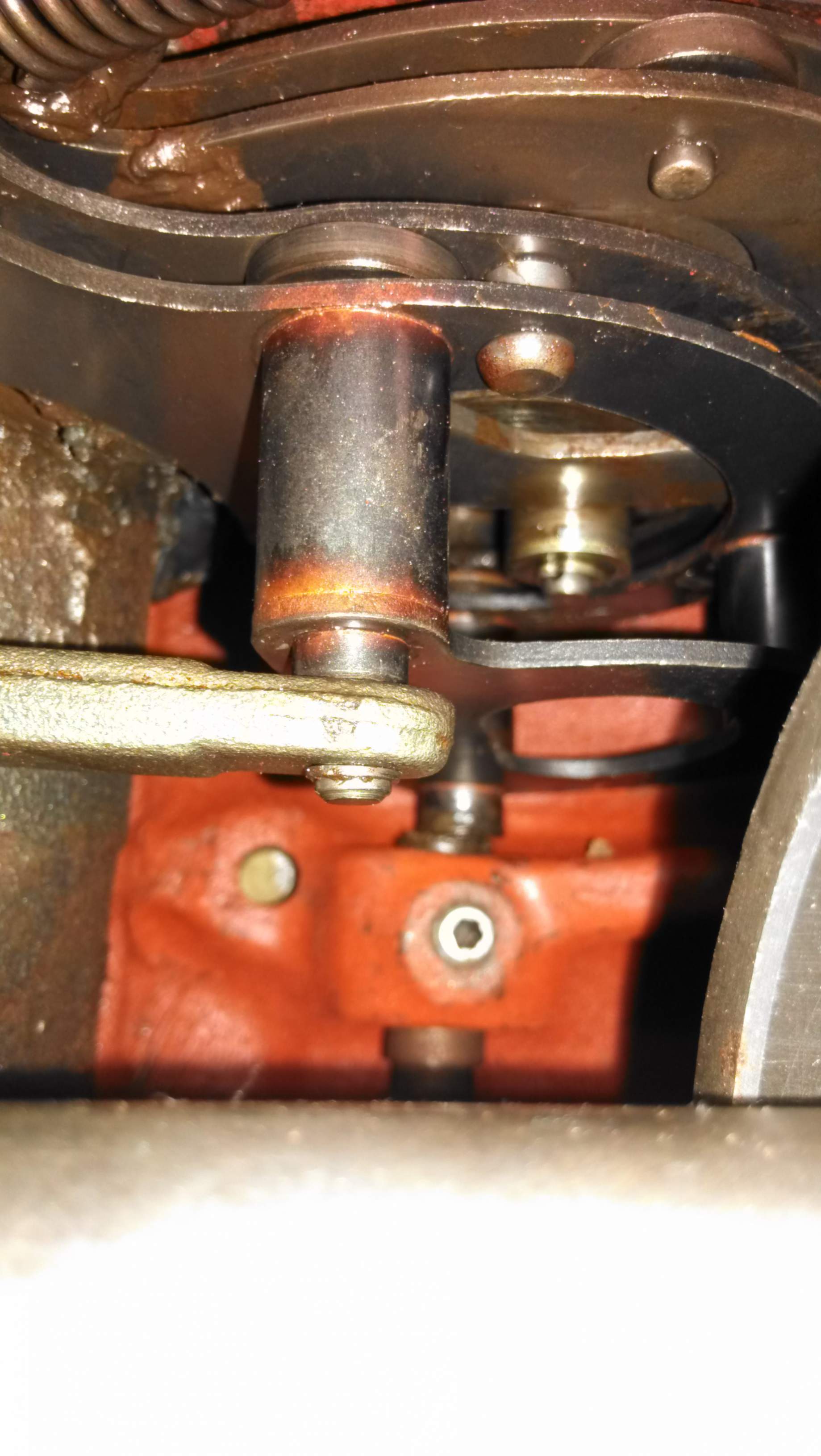

Have also done some investigating on the new issue found. I do believe the pin I referenced before is broken and a new one has been ordered. I also found though that the position arm had gotten on the wrong side of one of the cam rollers.
This picture is the way it was found. I'm not sure how well you can see it due to the clutter. I'll try to get a picture of the correct installation later.
I have ordered new rollers as well for the position and draft as they will be easily accessible when the pin gets replaced. I'm hoping once these repairs get made, I will be able to properly adjust everything and get the cover back on the tractor.
This site has been wonderful for the knowledge sharing as well as being able to reference others pictures.
There have been posts on various sites where this problem is described as:
  • "Position Control Not Working",
  • "Lift only operates with Draft Control",
  • "Position Control linkage is displaced",
  • "MF135 Quadrant controls behaving strangely",
  • "The position control seems to have no effect, and only the draft control raises and lowers the arms",
  • etc
A symptom on the MF 135 is that the hydraulic pump control lever ( 897516M91) does not move in proportion to the position control hand lever (in fact the pump control lever just sort of "wiggles" when the position control lever is moved through its full range from "Transport" to fully "Down" and back). However, the draft control lever does operate the hydraulic pump control lever correctly.
While a broken position control return spring can cause similar problems, I think the position control cam becoming displaced from the cam roller is probably more common. I think we are on to the fix for this - the one Big Dean Austin described as: "the Position control has a piece of linkage that when you move the position lever to (sic) far it will jump out of place it will happen almost every time you do that. To get it back where it belongs you will have to remove the liftcover. I have a picture showing this & how to get it back in place." Unfortunately I believe that Big Dean never posted his pictures on this fix, opting instead to have others contact him directly.
If you can more precisely document this fix (perhaps in a new thread to separate it from your pump issue?) you will very likely help others save a lot of time and aggravation in the future. It would be a real service if you could do this so that tractorbynet.com will be a definitive resource for this issue.
