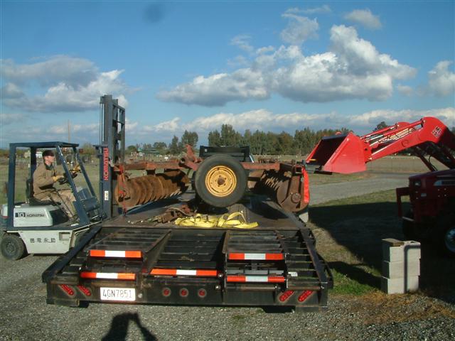

Dudes, (to borrow a word from my high school days:cool:) I am so pumped.:cool2: I got one set of remote QDs replaced today (this one was wore out anyway, as the backhoe kept popping it off) and took it out, just now, after dark and put it in the ground. I started out in first and kept shifting up to 5th gear. I was running between 1500 and 2000 in a counter clockwise large circle. I normally drive around my place in 6th gear, so this was exciting to me.:cloud9: Now, to justify Brian's concerns, when I went a little too far left in a curve, I felt my rear end and the tractors rear end pull a little to the left:thumbsdown:.....................so I need rear weights.:thumbsup: The disced ground was nicely prepared after two passes.:D The far right did show a small furrow. We did have ONE inch of rain this morning, so it was no hard ground. Overall I am tickled pink.
Now, the cylinder will not lift the disc high enough to get the up lock bracket's "transport" hole to line up. It is about 2.5 inches from the hole. Same thing in the wheels up position........it is about 2.5 inches short of that lock hole. So either something is not adjusted right in the tongue hitch spring adjustment to cylinder assembly........or the cylinder's stroke is too short. I don't see how the cylinder is too short when it won't reach either up or down lock holes. I do want to get it in the lock position with wheels down and disc up. I am not much concerned about the wheels not reaching the "all the way" up lock hole.
So overall I am beside myself.:dance1::cool2::drink::cloud9::licking::D:thumbsup::):eek:die::jump::applause::number1: My tractor will pull it, it just needs more rear weight.
Also, my tractor will not lift the rear of the disc with my backhoe off the tractor. My left rear wheel came off the ground fast. Glad I got lots of hours working that loader and slammed the joystick in the right direction to lower that wheel. That really scared me for a second when I forgot my backhoe counterweight was gone.:embarrassed::banghead::duh::censored::pullinghair::worried::guilty::sorry::gloomy:

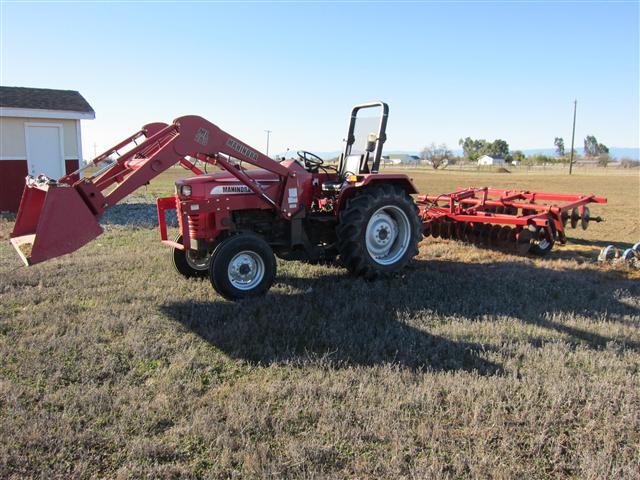

Just FYI...my technique is to make at least 2 passes. First (for squareish field) is to go on a diagonal, kinda from one corner to the opposite corner, then straight up and down. The dirt really flies with the second pass. If I need to do 3 passes, then it's one diagonal, opposite diagonal, then up and down. Point is, a cross hatch pattern seems to do a better job for me than just back and forth.

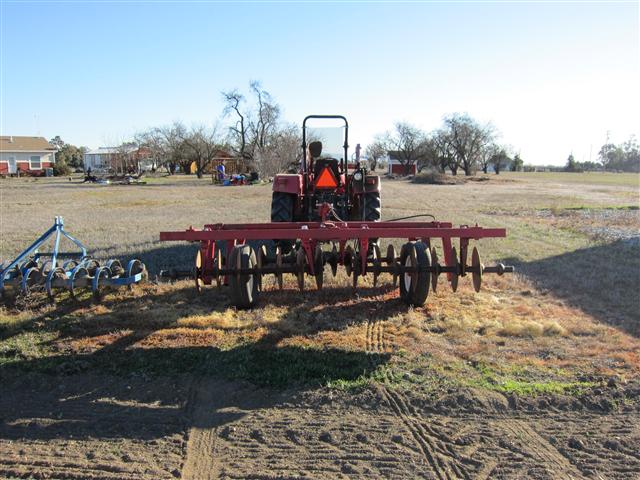

Brian,
Does that tube running to the aft gangs adjust the "toe in and toe out" of the offset?
Sure seeks lite weight, but looks like it is working as designed. I like the photos. How about so more?
hugs, Brandi

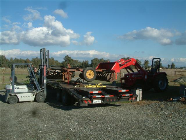

Yes that "tube" that is actually a 2" dia solid bar adjusts the angle set for the disk. I suppose that it is light weight for being a 12' disk. It only weighs a bit over 4000lbs. It has enough drag that the 7520 can only pull it on flat ground for a first cut. It will not pull it for a second final disking. The old D6 does a pretty good job though. In the picture with the 7520, I am pulling the 8' Kilfer disk that I have. That is the disk that I pull most of the time with the 7520 and with the hills that we have, it really is about all the tractor wants. Oh, and it weighs about 2600-2800lbs. I could never pull your disk axle deep on our property with the 7520. :(

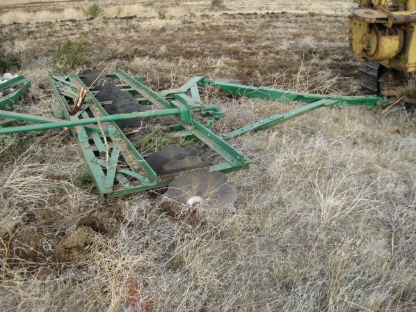

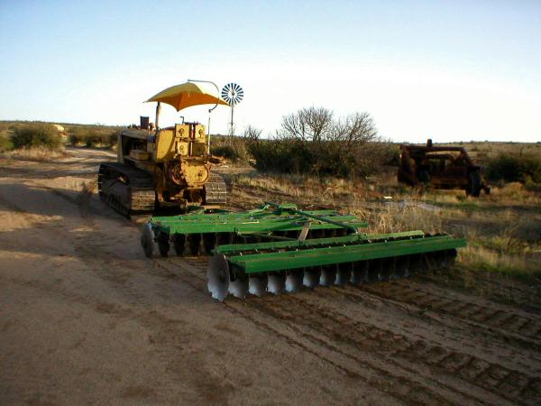

I modified the hitch on that tandem disc I mentioned earlier in this thread. Now it's a pintle/lunette (ring) type that attaches to the 3pt hitch. Gives me an up/down adjustment with the 3pt hitch hydraulics to level the disc from the tractor seat. The original leveling screw/crank assembly on my disk was a bear to turn. I too old to fart around with it. Much better to use the hydraulics. And connecting that pintle hitch is easier than hooking the disk to the drawbar.
Just a thought.

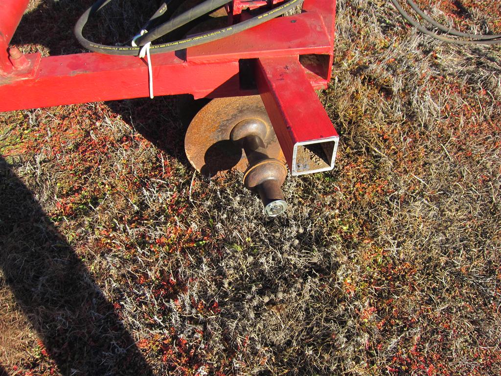

I took the cylinder and forwar mount off today. I thought the forward mount was some type of swing link, with all the movement it had. Along with it just being pinned. As it turns out, I now think it is suppose to be bolted and fixed in position. The holes are way enlarged and I am planning on buying larger bolts and reaming the holes. That will take some slack out of the cylinder in it's operation raising and more importantly, lowering the wheels. As you can see in the photo, the pins were really worn.
hugs, Brandi

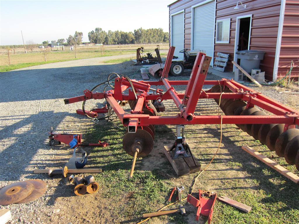

I think I found the most likely culprit of the cylinder not getting the wheels all the way down to the lock hole. Seems the hole the cylinder shaft rod end mounts to is way egg shaped. I am either going to have to remove the whole wheel axles assembly or take the whole disc to the welding shop and have a half moon shaped "filler" chunk of 5/8 inch steel welded in that hole. Hopefully, if I make the filler right, it won't have to be reamed.
hugs, Brandi

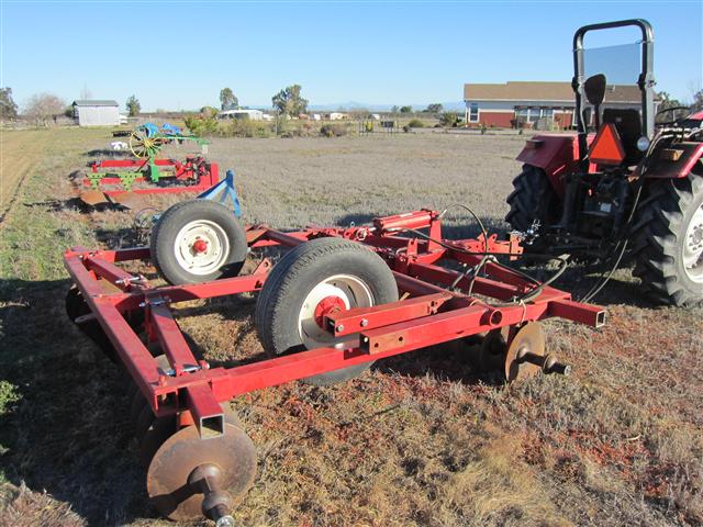

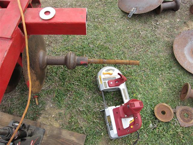

After taking all the wheel up and down lock assembly apart, I realized all the parts are not original. The sliding bracket that has the holes to lock the wheels up or down does not work even with the wheels jacked all the way up until the assembly hits the frame. So I need to fix all the holes I can with bigger bolts or pins, weld the one hole, then try to adjust it all to hit the down lock hole...................and drill a new wheel uplock hole the cylinder can move the wheels up to hit. As you can see in the photo, the hole is about 3/4 inch too far aft when the wheels are all the way up against the frame.
hugs, Brandi

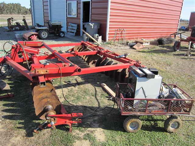

Here is a composite of earlier photos so Y'all can see where all the parts I took apart in the above posts, go.
hugs, Brandi
