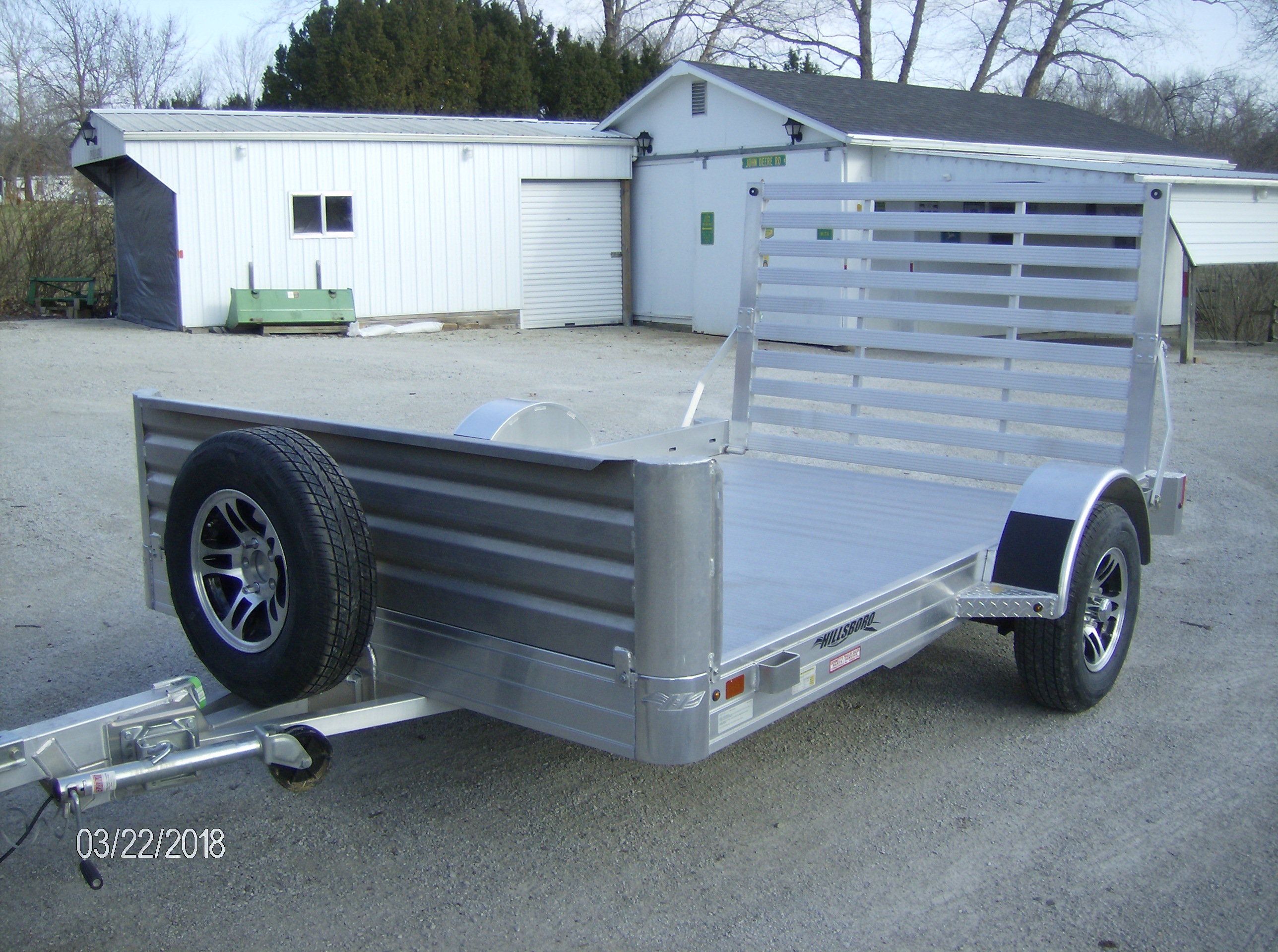

Picked mine up on 22nd, Hillsboro 78" x 120": Pictures 2018 032.JPG Pictures 2018 033.JPG
