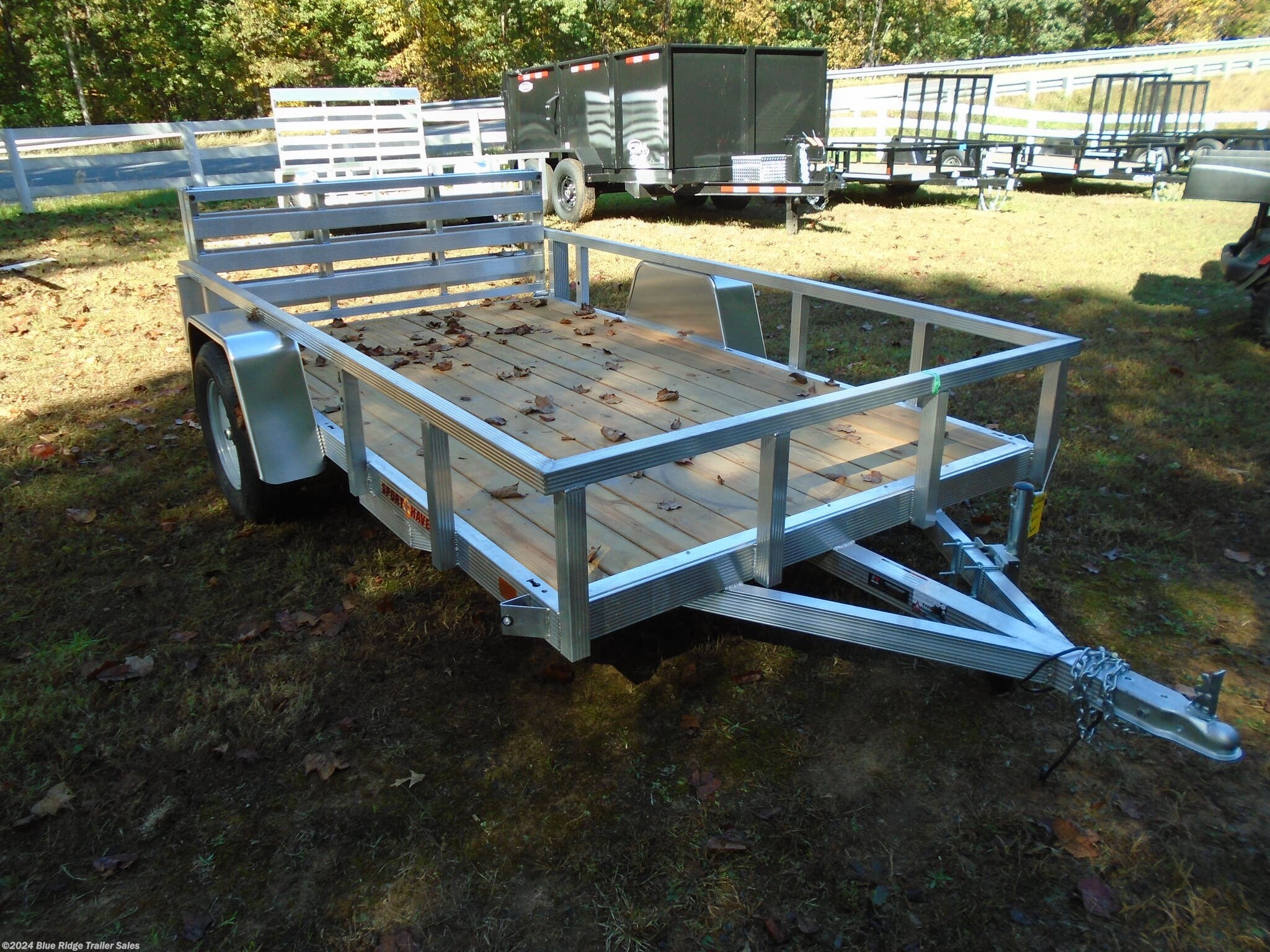

The mower deck would fit. It's a 5' mower. A little more with the grass deflector, but that folds up. I was referring to the ramps that come attached to these trailers - preferably the two-section type. The one shown in the attached image would be ideal.

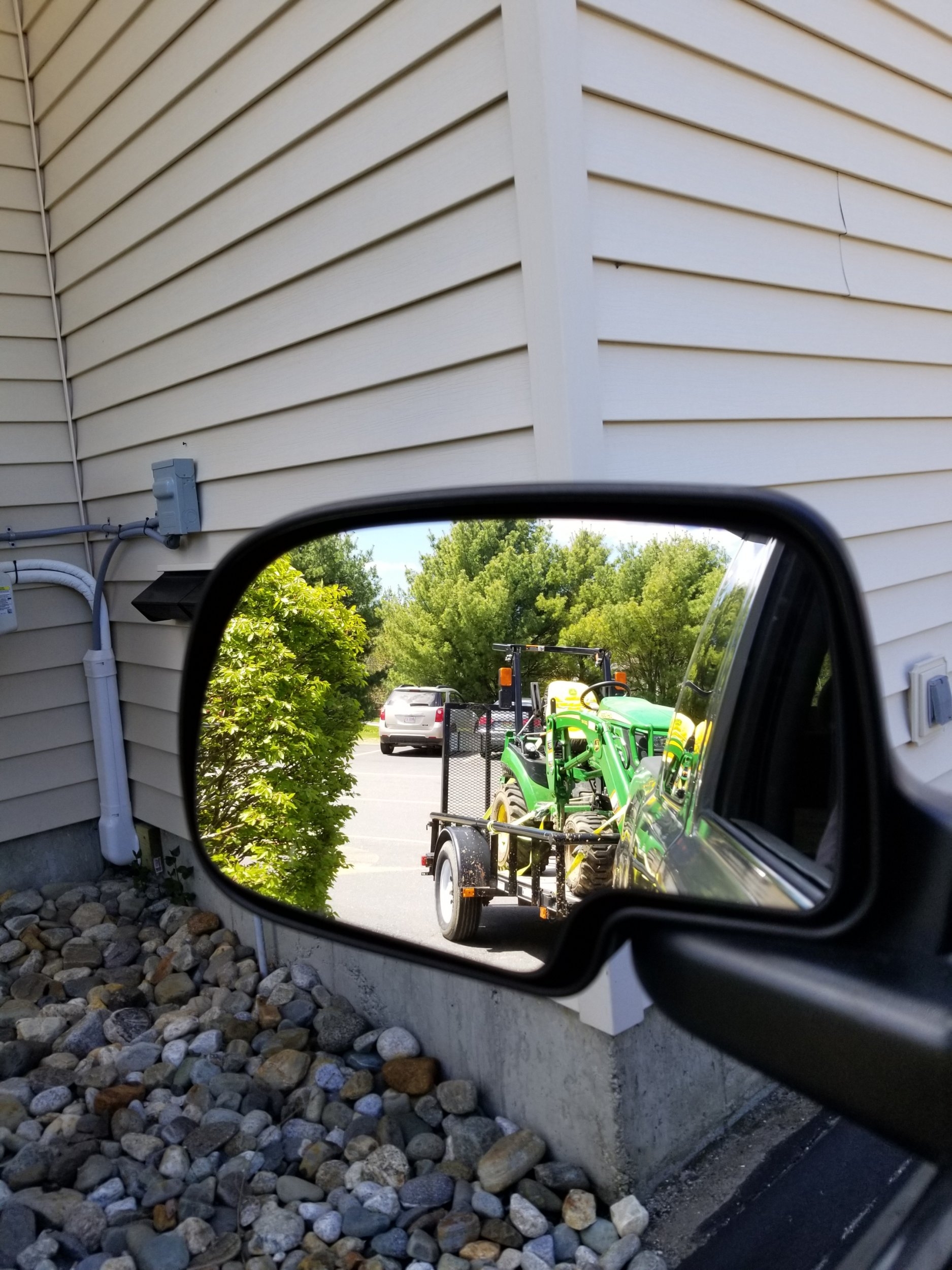

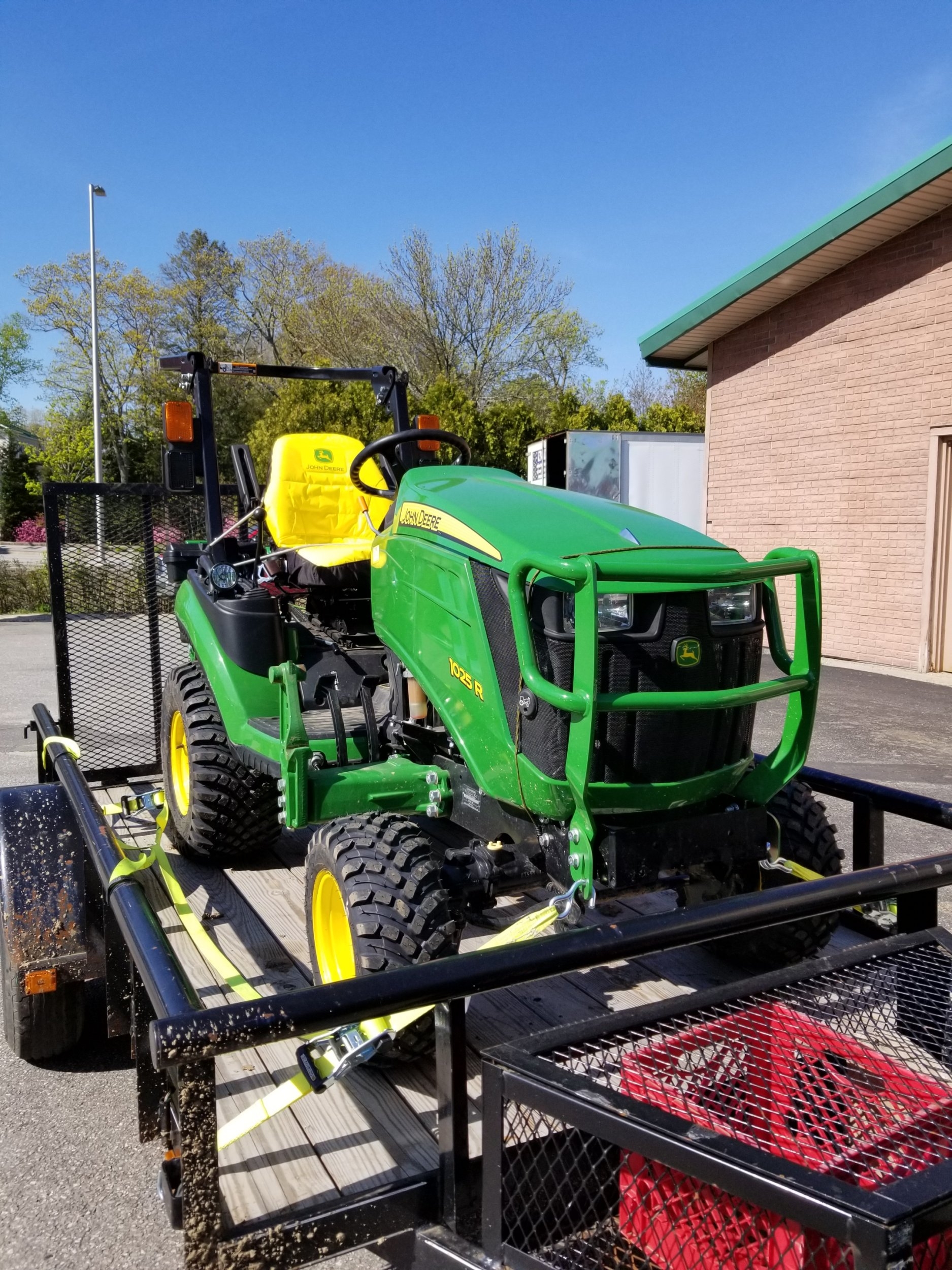

I used to occasionally move around my old Deere 1025R with a 5.5'x12' trailer, and it worked well enough. When I'd remove the loader the fit was actually nice.
I wouldn't go making frequent trips, but to move it around locally it works.
