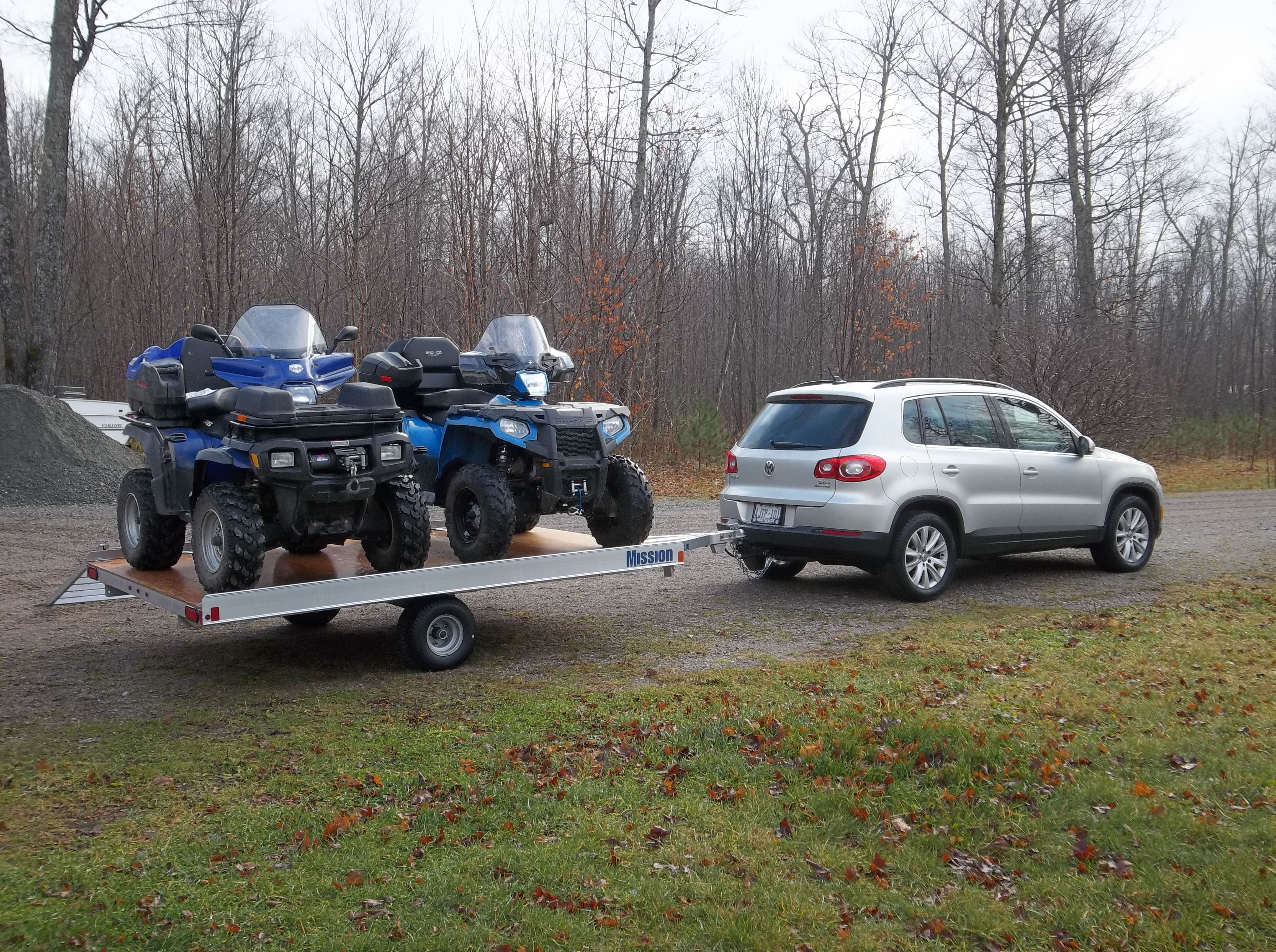

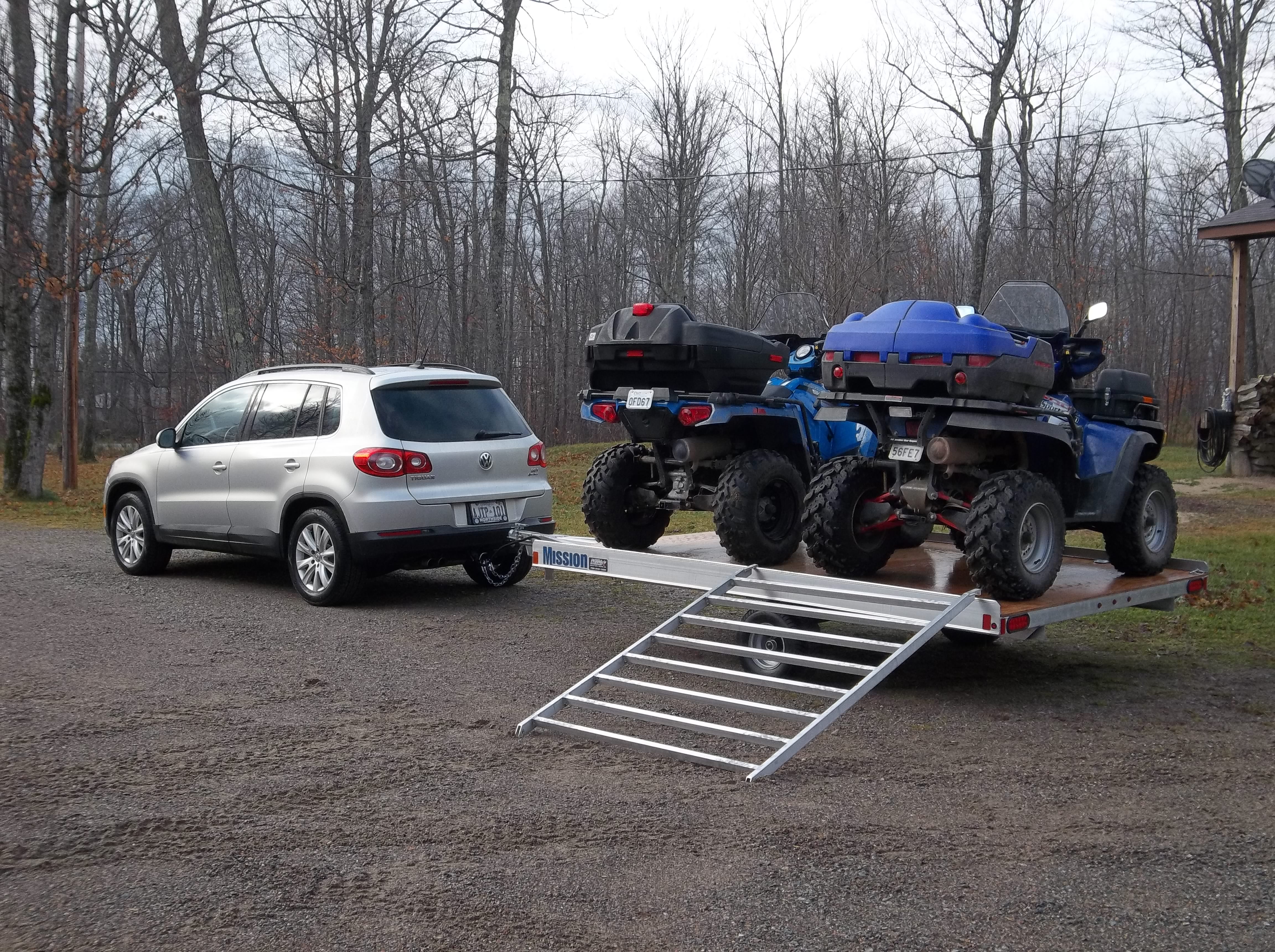

Happy with my Mission aluminum ATV trailer. Was cheap and is only 360 pounds empty, so it is perfect to pull with my small vehicles.
Ramp slides in to store from the back. And can be used to side or rear load. I use it for hauling pallets and building materials too so I can unload with my Kubota and forks.
