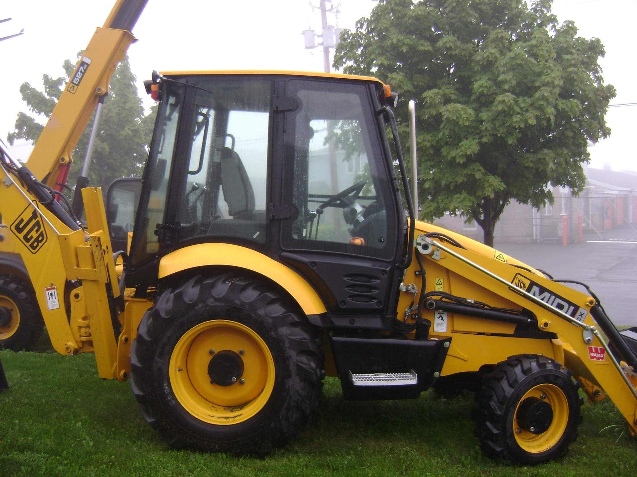

you like my new toy? cab AC 4 in 1 and a pin grabber. Its not here yet. Should be seeing it today or tomorrow. As for the trailer, hat price is actually pretty good. I'm Canadian and we are used to getting Ukfayed on equipment purchases. A steel 16 foot dump here would be around $12000.00. That alumaline would be around $16000.00 CDN.

I don't see how you are going to get that chained down in 16 feet.
backhoe has to be lowered to the trailer and chained.
front bucket has to be lowered to the trailer and chained.
I don't see it.
that's a lot of chains (plus the two for the tractor itself) inside a dumpbox (which you'll soon find out is a serious pain in the rear)
10,000 lbs is a LOT of weight for a pickup. (because as you've noticed you'll need a 4000lb trailer to move it around)
I'm not saying it won't do it, but you won't have much margin of safety.
What are you pulling it with? (did I miss that?)
why not get a single axle dump truck (even a smaller one) and pull a regular equipment trailer? (well ok, puts you into CDL land, but you're already into DOT land (if you're using it commercially))

well, that certainly makes sense, but have you hauled heavy items like tractors in a dump trailer?
very icky feeling.
wayyyy up high, feels real top heavy and "wobbly", not solid like an equipment trailer.
very icky feeling.
Yeah man, it sure is. I didn't even like my deck-over equipment trailer. That machine is kid of high on the center of gravity, too.
Nothing better than a low between the fenders equipment trailer. They can carry a lot of weight and they handle great.

well, I guess I can put this purchase off for a bit anyway, since my new machine is legal on my 12000# deckover. So I will use that for the time being until I sell my gravel truck.
