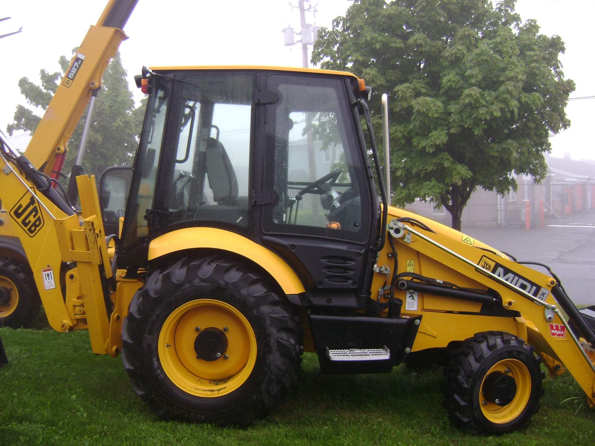

well, heres what I want to put in it. And I talked to Alumaline, thanks for the link. They come in at just under $14000 for a 16 footer. And it weighs 3800 pounds. :D
I see you took my advice and bought a "real" (cab) machine and not that little toy. :)
I hope I'm on your Christmas card mailing list now! ;)
However, if you spend $14,000 on a dump trailer, I'm not sure I want to be associated with you any more.:p That's nuckin futs expensive! :eek:
You know the old saying about aluminum versus steel...."half the weight, but twice the price".

you like my new toy? cab AC 4 in 1 and a pin grabber. Its not here yet. Should be seeing it today or tomorrow. As for the trailer, hat price is actually pretty good. I'm Canadian and we are used to getting Ukfayed on equipment purchases. A steel 16 foot dump here would be around $12000.00. That alumaline would be around $16000.00 CDN.

Finally someone smart enough to look at the smaller machines built by the bigger guys. I bet that thing rips that M-59 you were considering a new ___hole.
