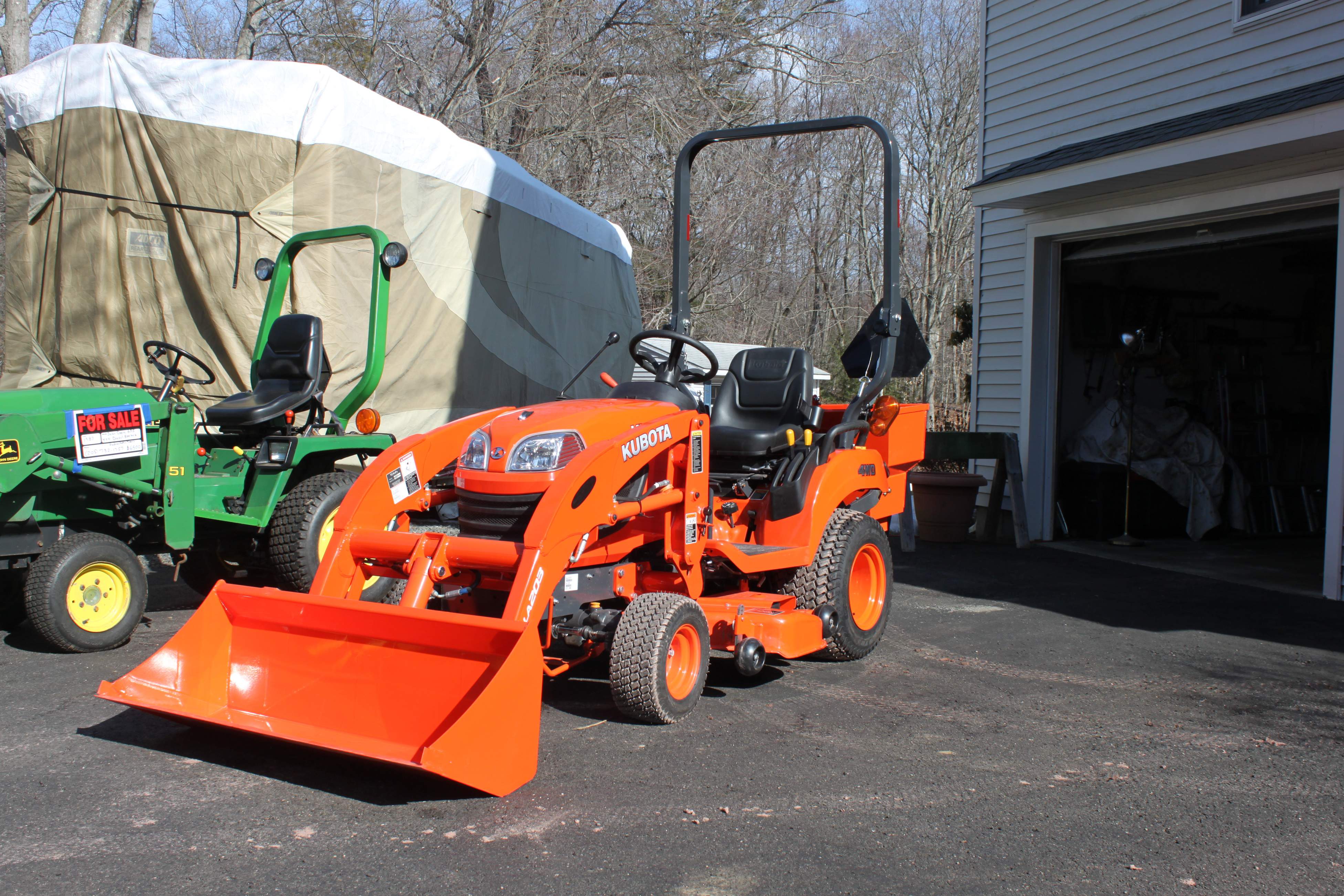

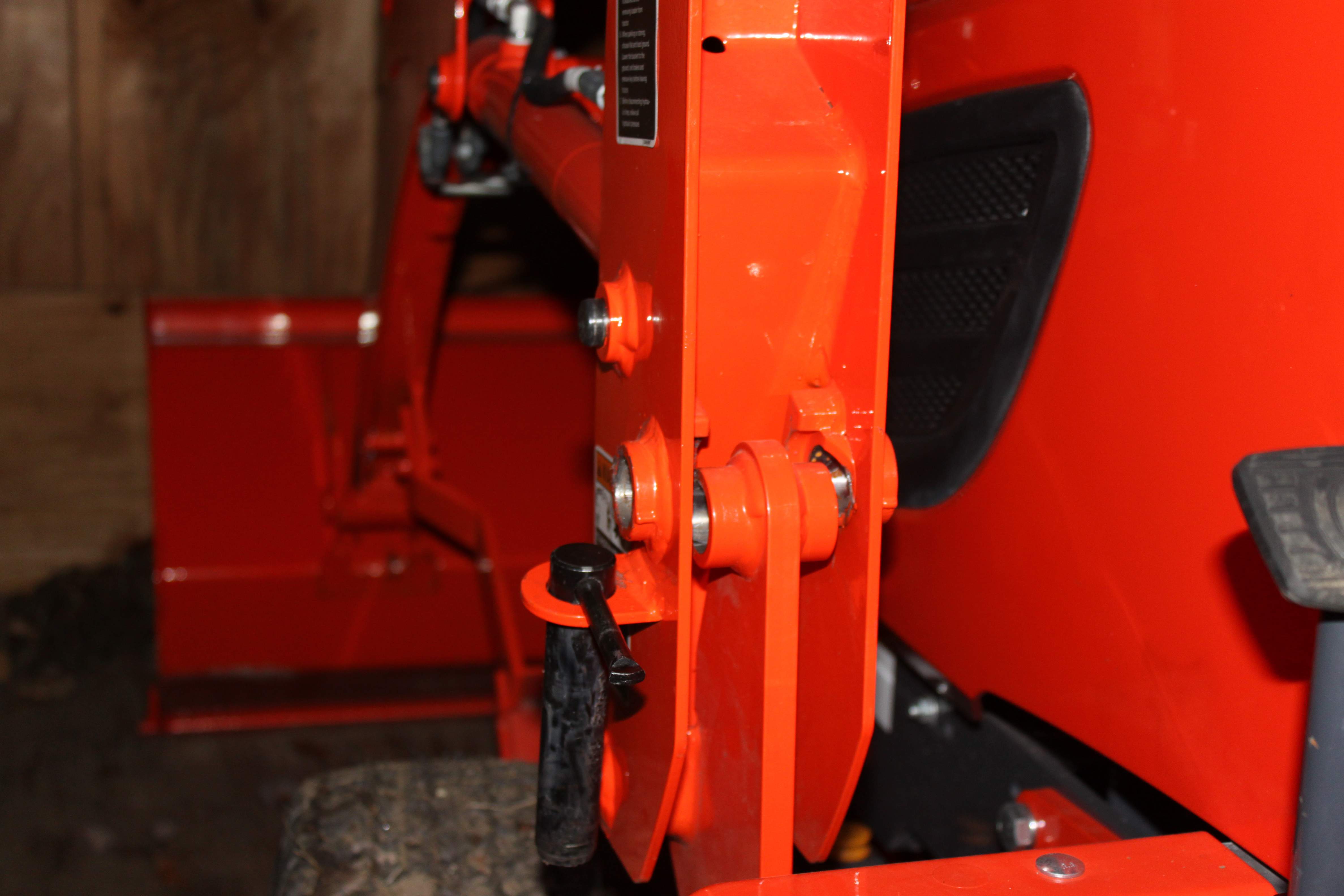

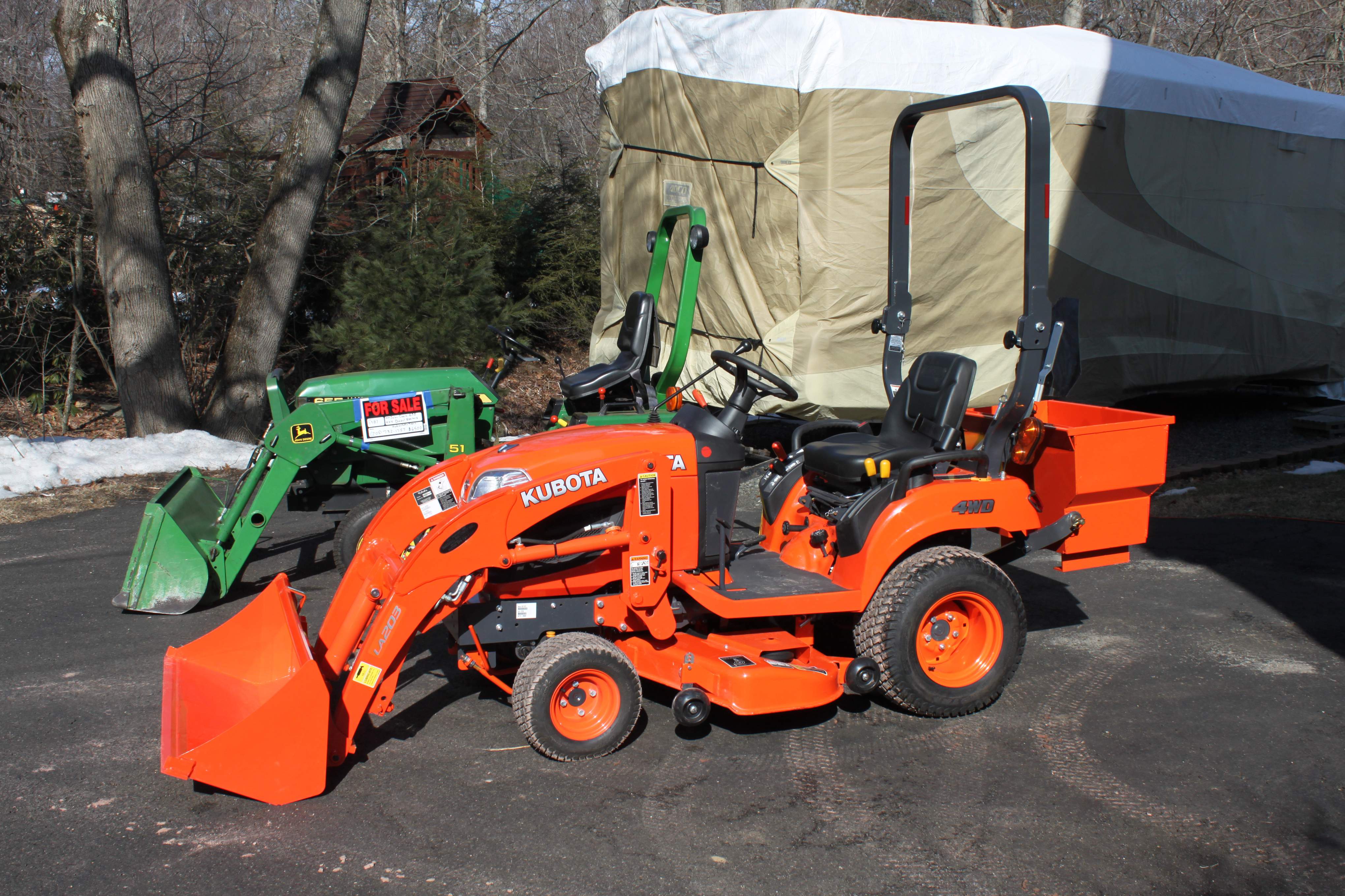

Anyway, I did get the tractor out a bit and discovered I still have a bit of a problem re-mounting the loader. Couldn't get the right side to seat in the "cup" properly. With the right side seated properly, the left is still about 1/2 inch high and floating. No amount of diddling with would get it any closer. Then I had an idea. I used a hydraulic jack to lift the right side of the bucket and slid a 3/4" pine board under the bucket. Went through the installation process again and had the pins in no sweat. So, the there is still a problem with the set-up. Funny that it seemed to work fine when I went through it on delivery. Maybe where I tried it on delivery was just enough out of level the right way to make it work and the garage floor is level and it won't work.

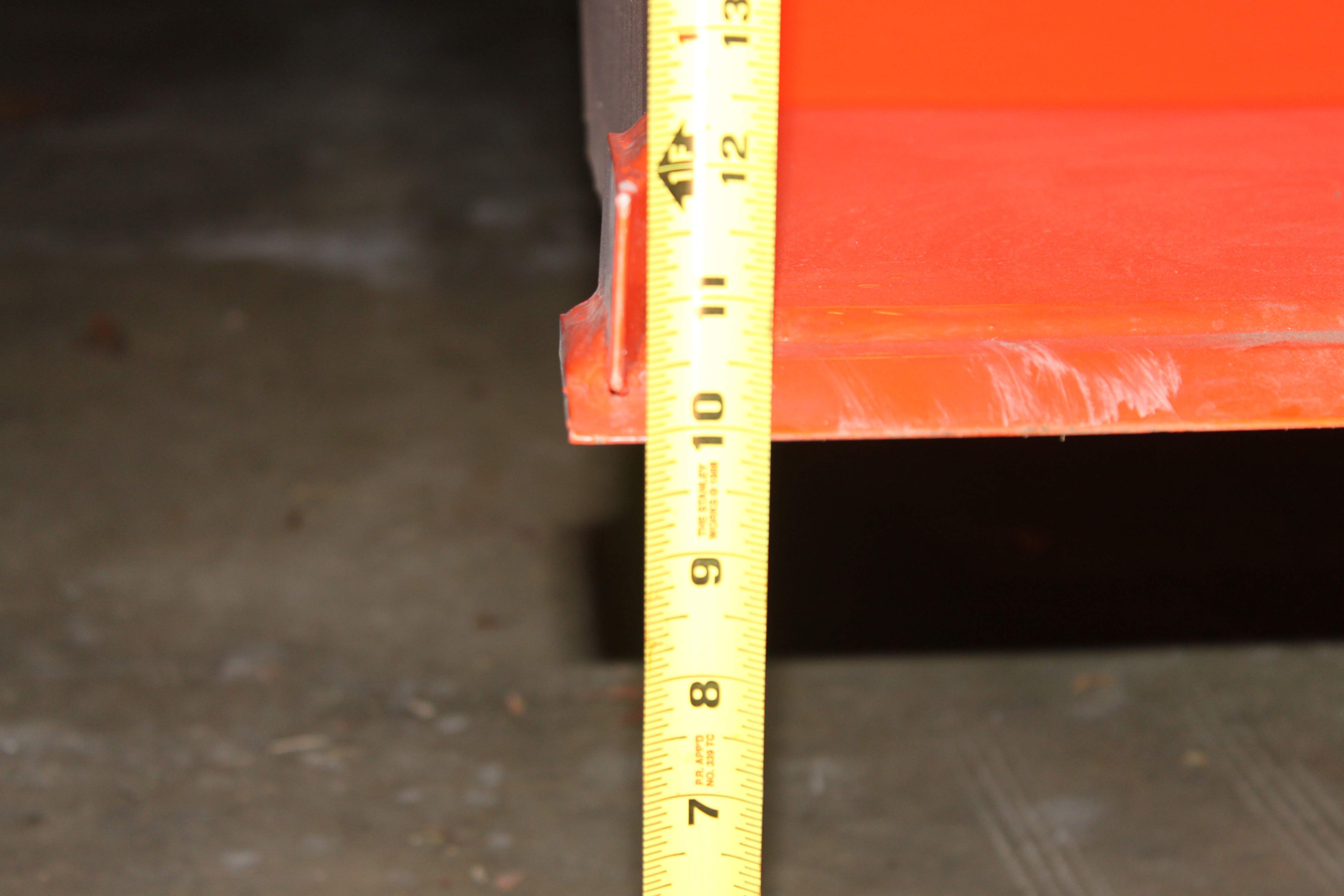

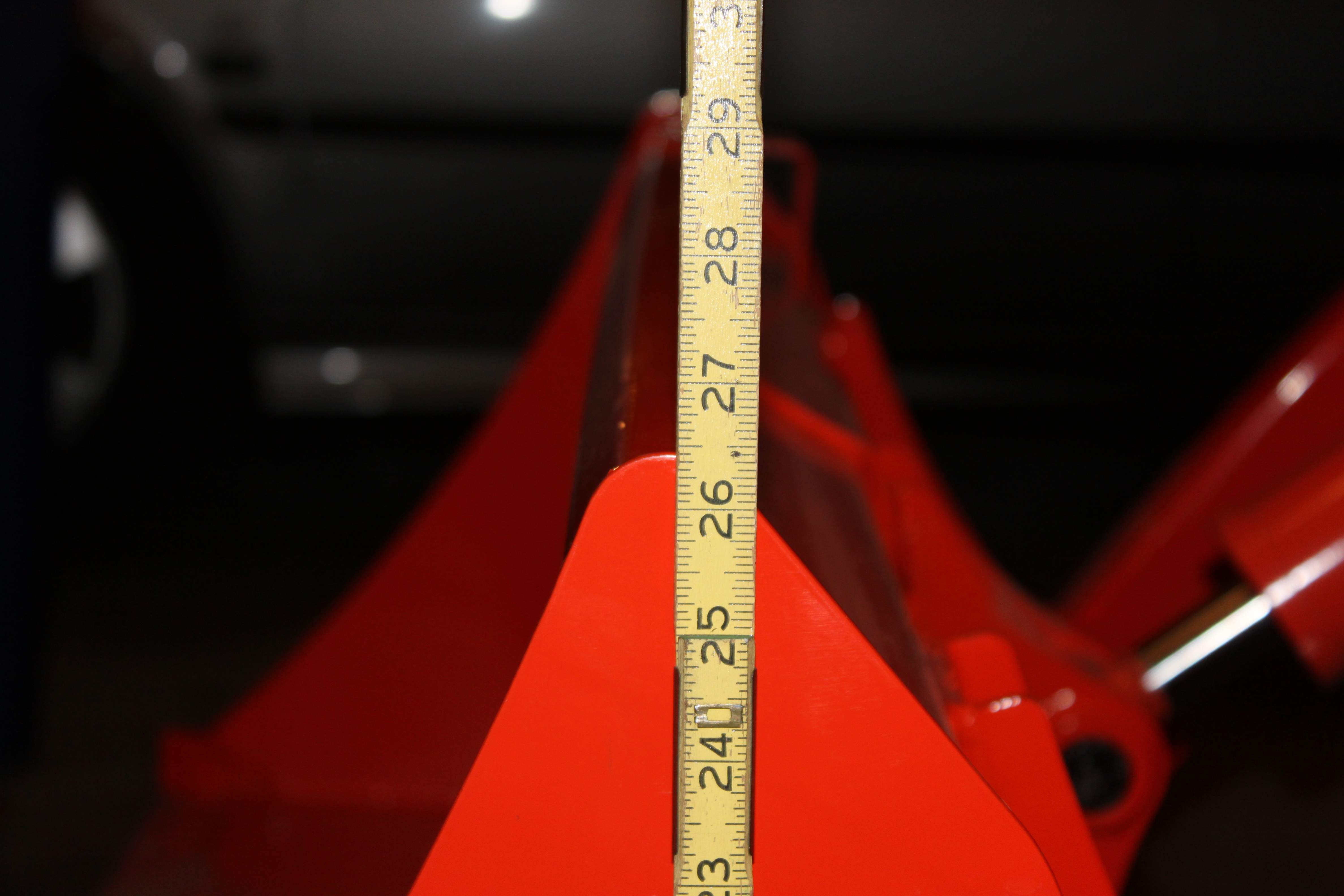

I measured the bucket in the slightly raised position and find it to be 3/4 inch higher on the right side. That is probably why the pine board worked perfectly. Tried tire pressure all around and it is the same on both sides. Going to do some measuring tomorrow night to see here the problem might be. I might try putting some weight on the high side and loosening the frame attachment bolts and see if it improves.

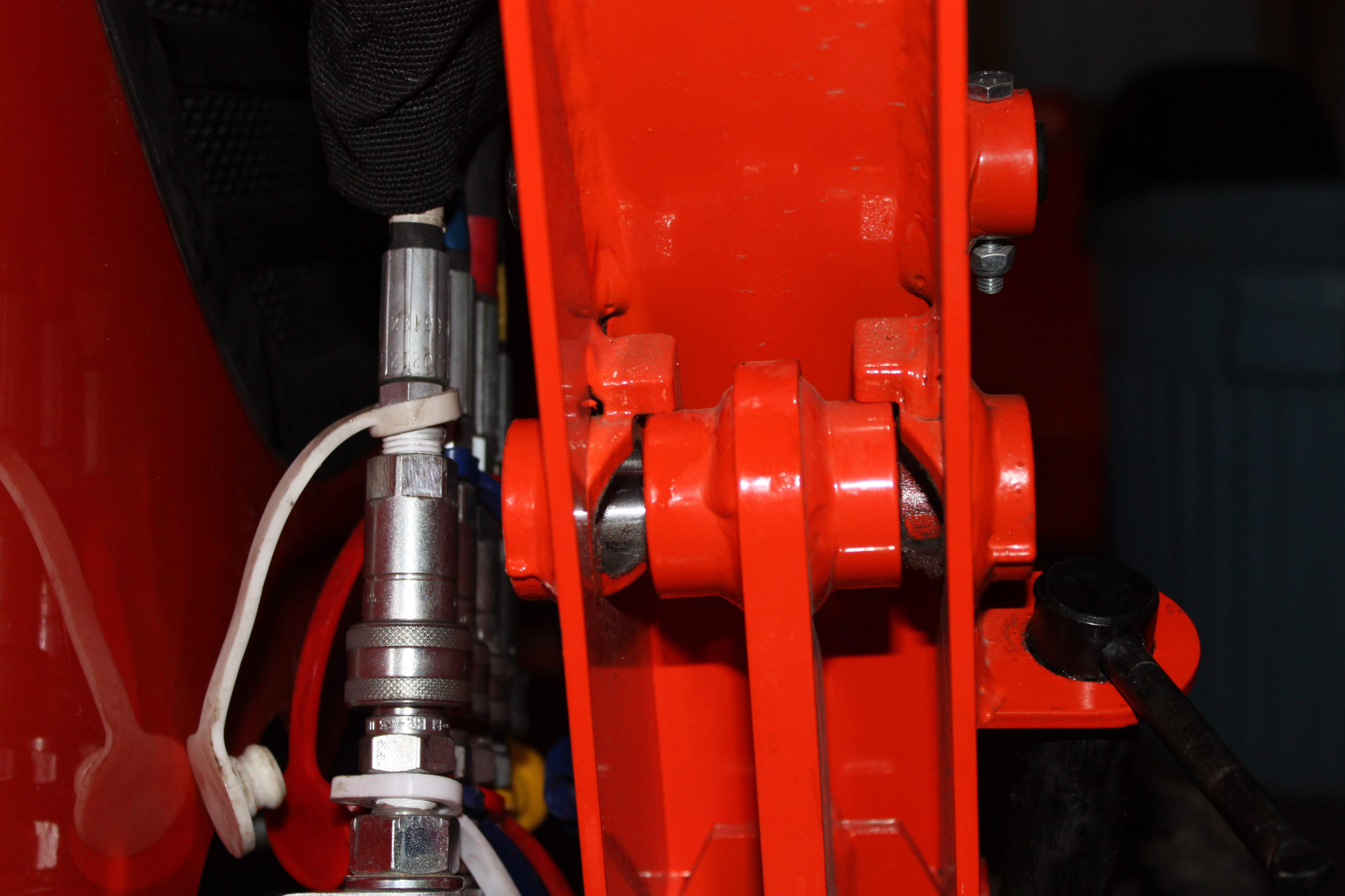

I have certainly had my fun with the "magical" movement of the loader arms that seem to defy logic while I have been chasing this loader issue. And I have had the hydraulics disconnected multiple times and back on thinking I was doing something wrong.

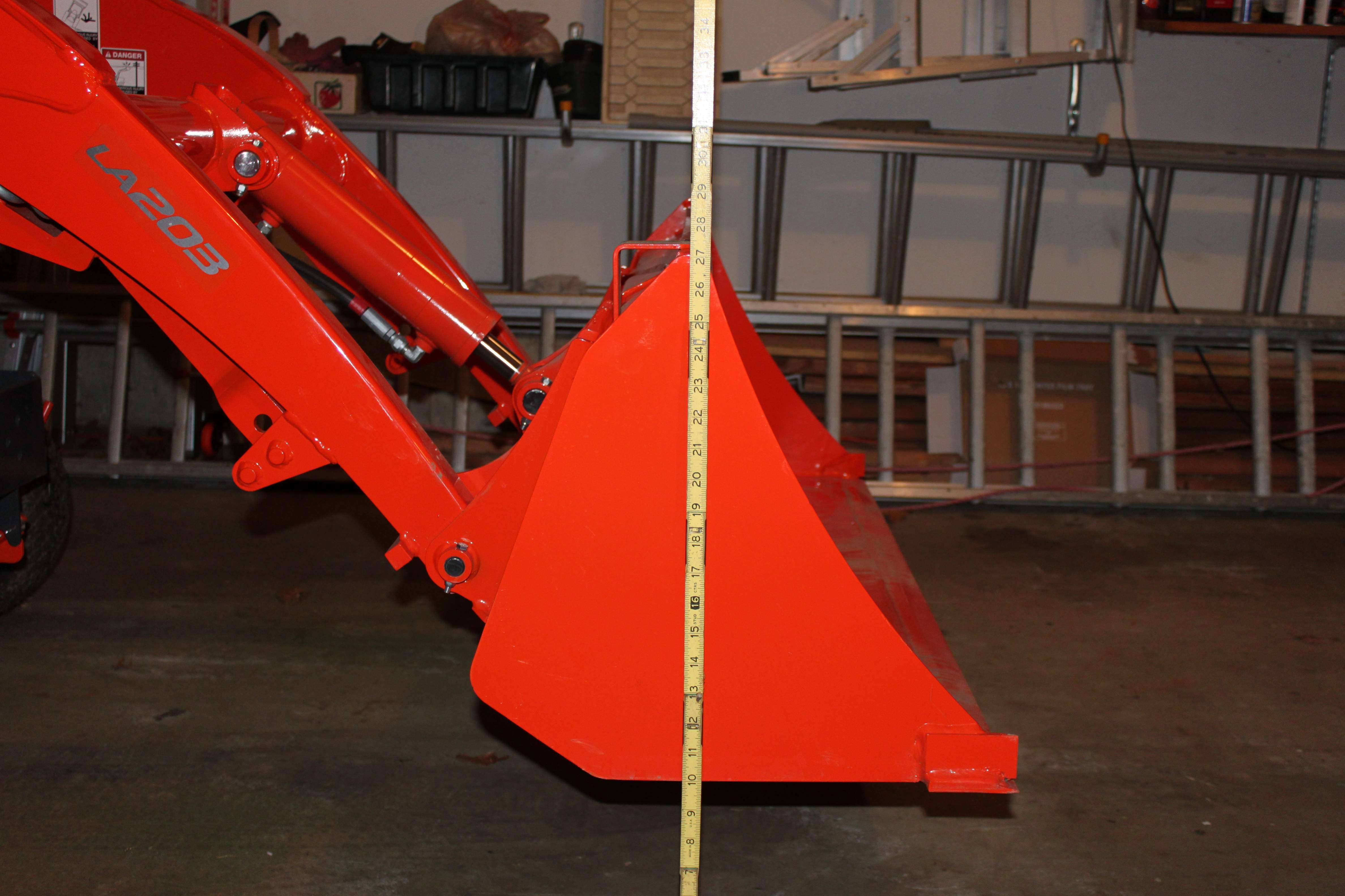

No, I truly believe that the loader is out of rig since it works just like the You Tube videos when I put a 3/4" board under the right side. Without using the board, the problem appears to be that when the bucket applies down force to set the side frame into the left and right "bosses", the right side sets right in place while the left side remains floating about 3/4" too high. (shown on the center picture above) When performing the next step, to lift the front of the tractor by using the boom down force, the left mainframe pops out of the boss (because it was not seated) and floats away. Then the loader arm control dance begins to get the side frame back against the main frame again on the left side.
With the 3/4" board in place, the loader goes on just like the You Tube video shows and just as simple and fast.

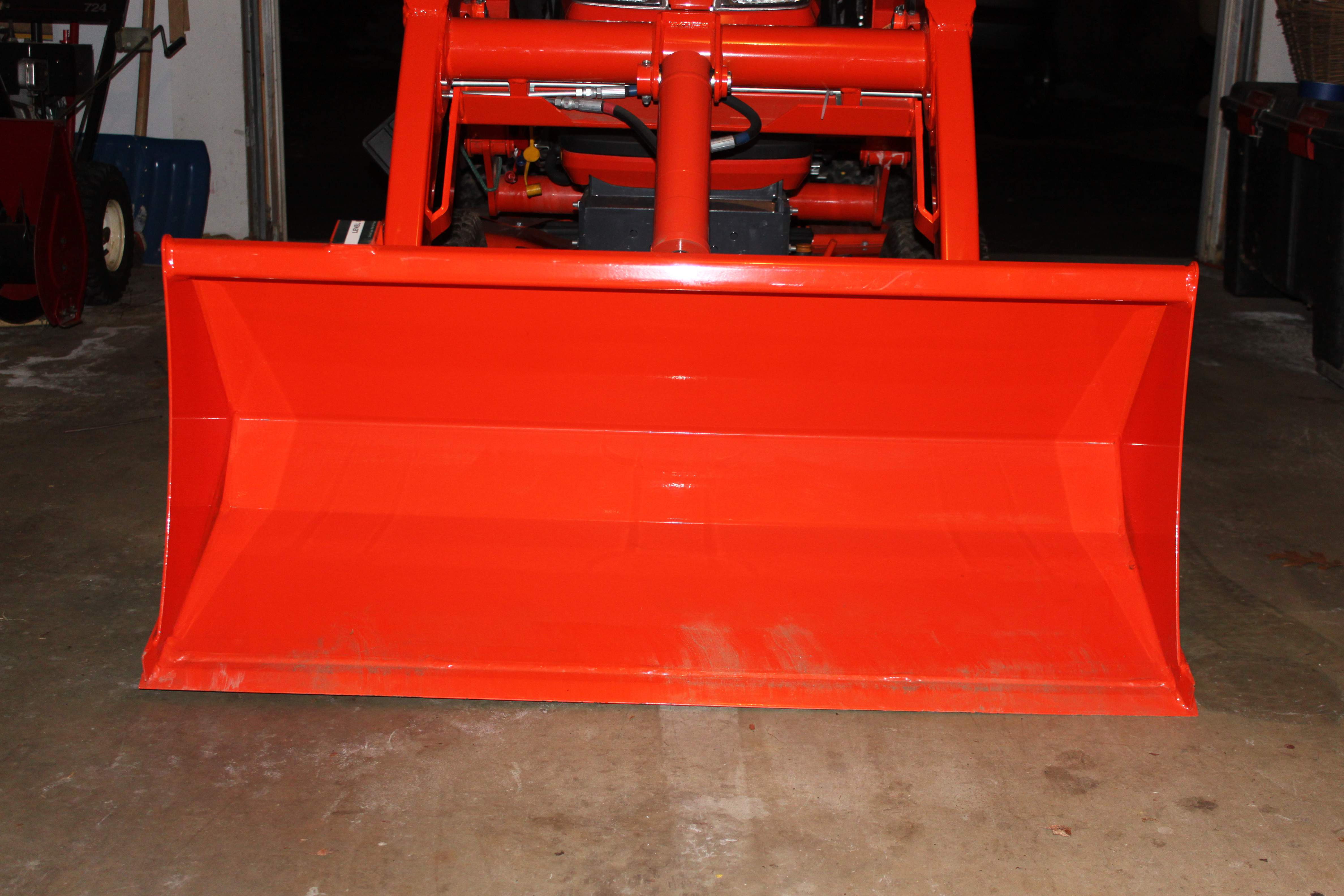

Below are some more pictures of the bucket showing the approx. 3/4 side to side difference.
Tomorrow night it will be a bit warmer and I will get the tractor back in the garage and do some more measuring. I need to answer the question my own mind before I challenge the dealer again. Not sure if this is something I should be obsession over or not. I just know it isn't right and it annoys me that I didn't catch it when the tractor was delivered.

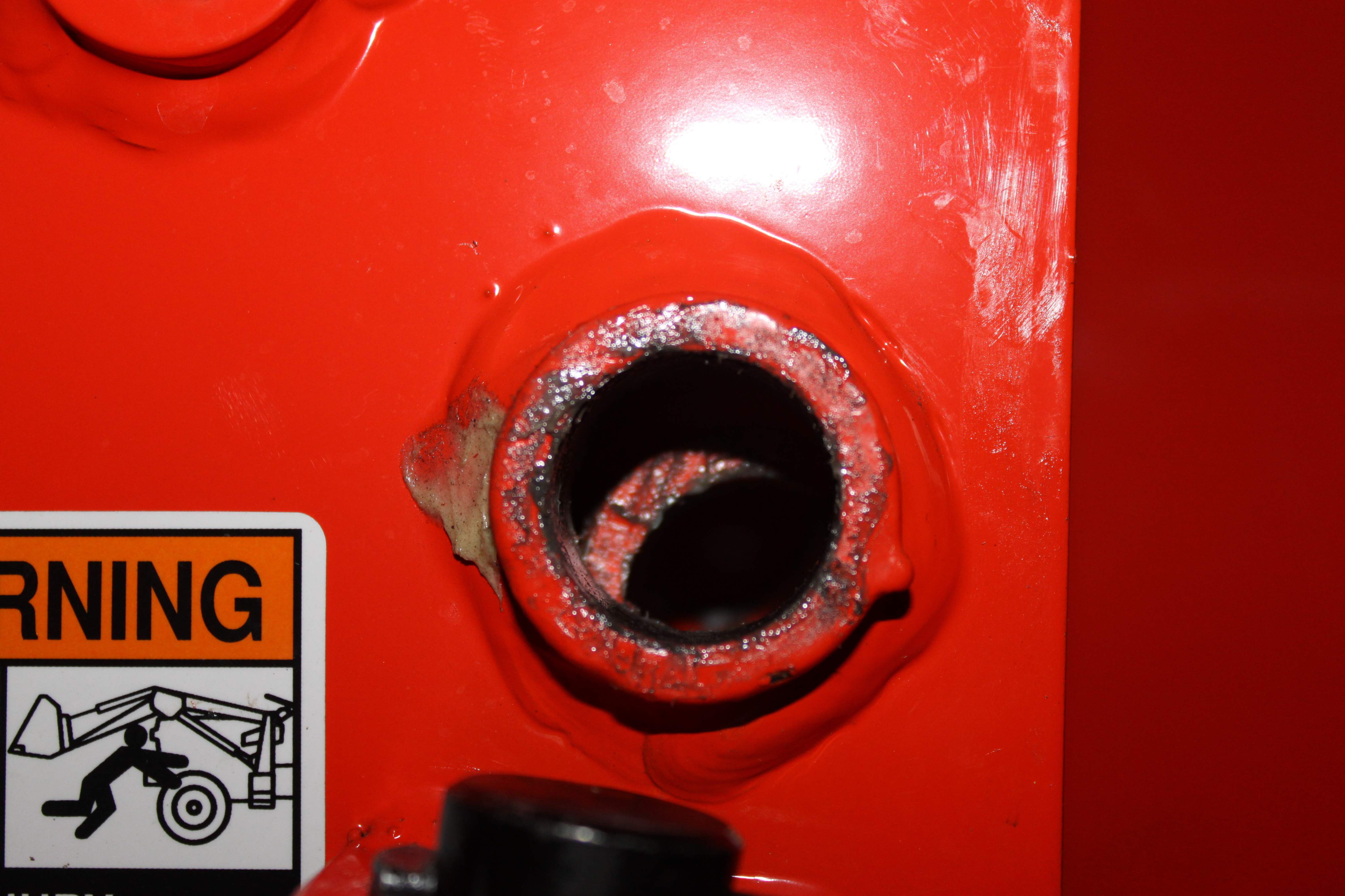

Checked out my 13 year old BX2200. Couldn't believe it :eek: as I never noticed before, but my bucket also sits at a 3/4" tilt but on the left side, opposite of yours. I'm not sticking up for your dealer just mentioning that my bucket is not sitting level and has not caused problems with attaching it. I know you have read your manuals again and again. I Just can't figure out what is wrong. :confused:

Maybe I'm obsessed, but I did a little more looking at the loader installation difficulty I am having.

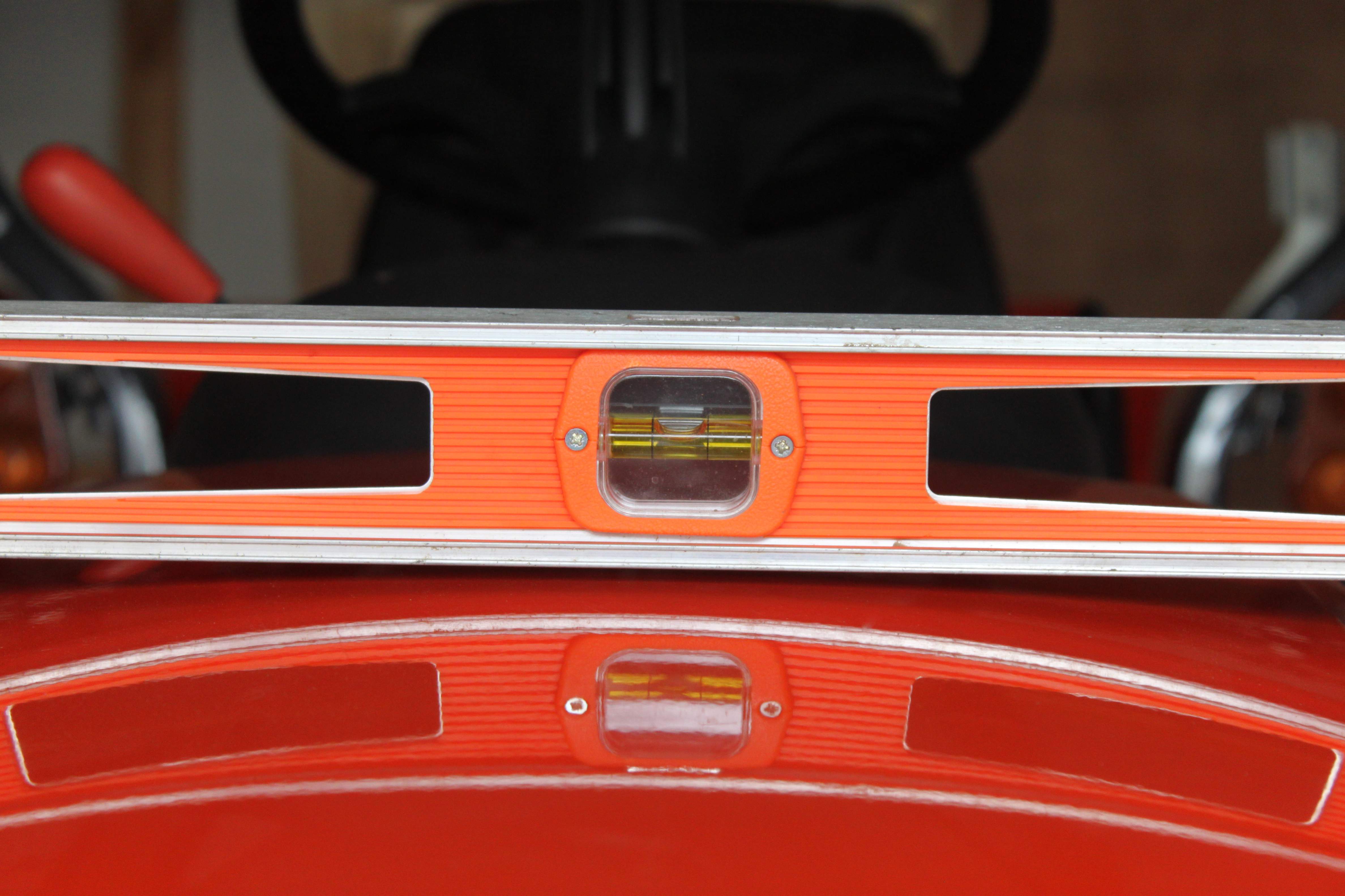

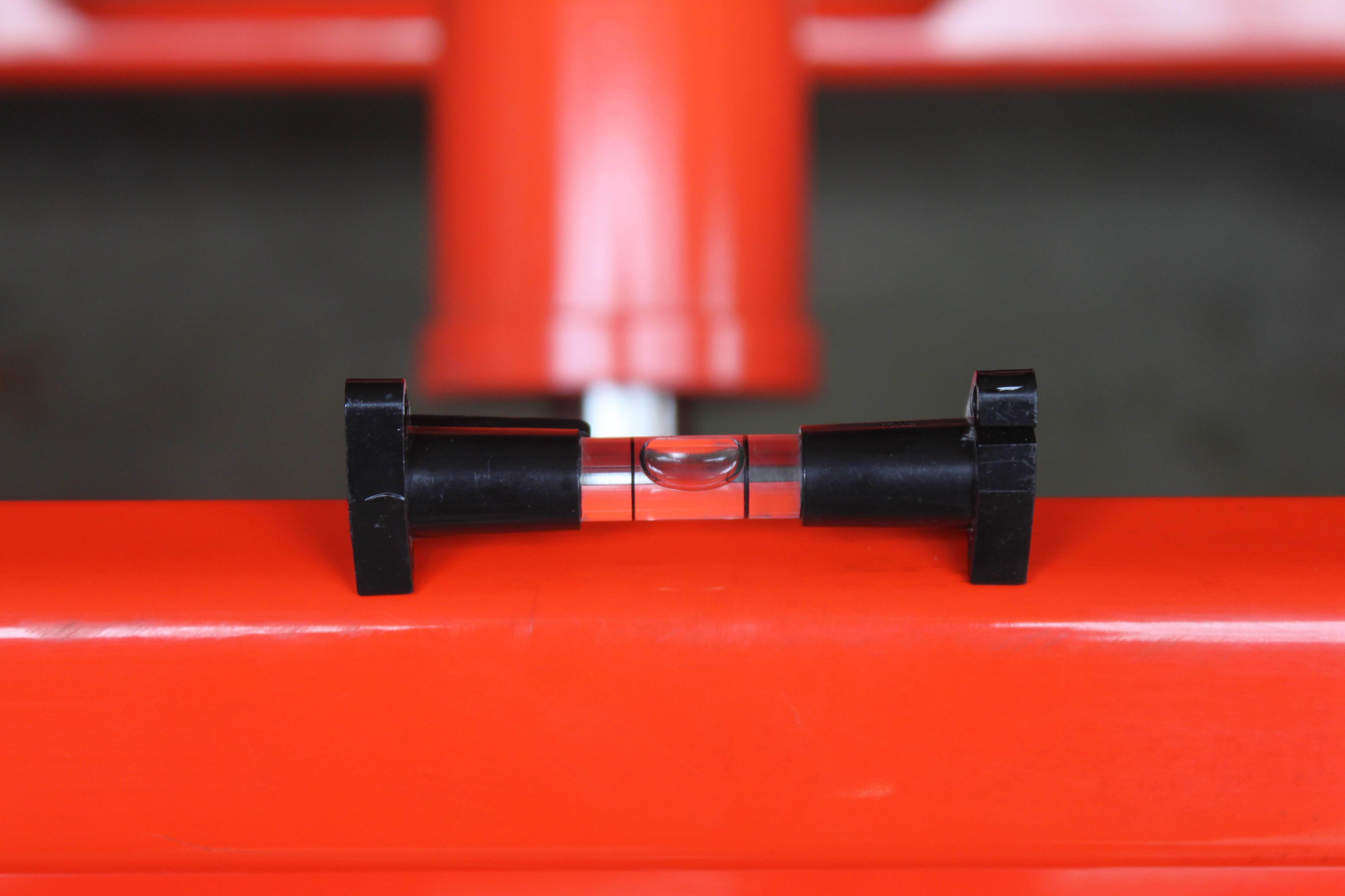

The good news is that the loader is 100% straight. Proved this by un-installing in the garage and setting the bucket flat on the floor. A level across the top of bucket shows bucket is level as is the floor. I placed a level across the upper arms and they are perfectly level. That is great news. But it means the tractor is now suspect.
1A) Bucket With Loader Installed.jpg2B) Bucket Un-installed on ground..jpg2C) Level across loader Arms - Loader un-installed.jpg

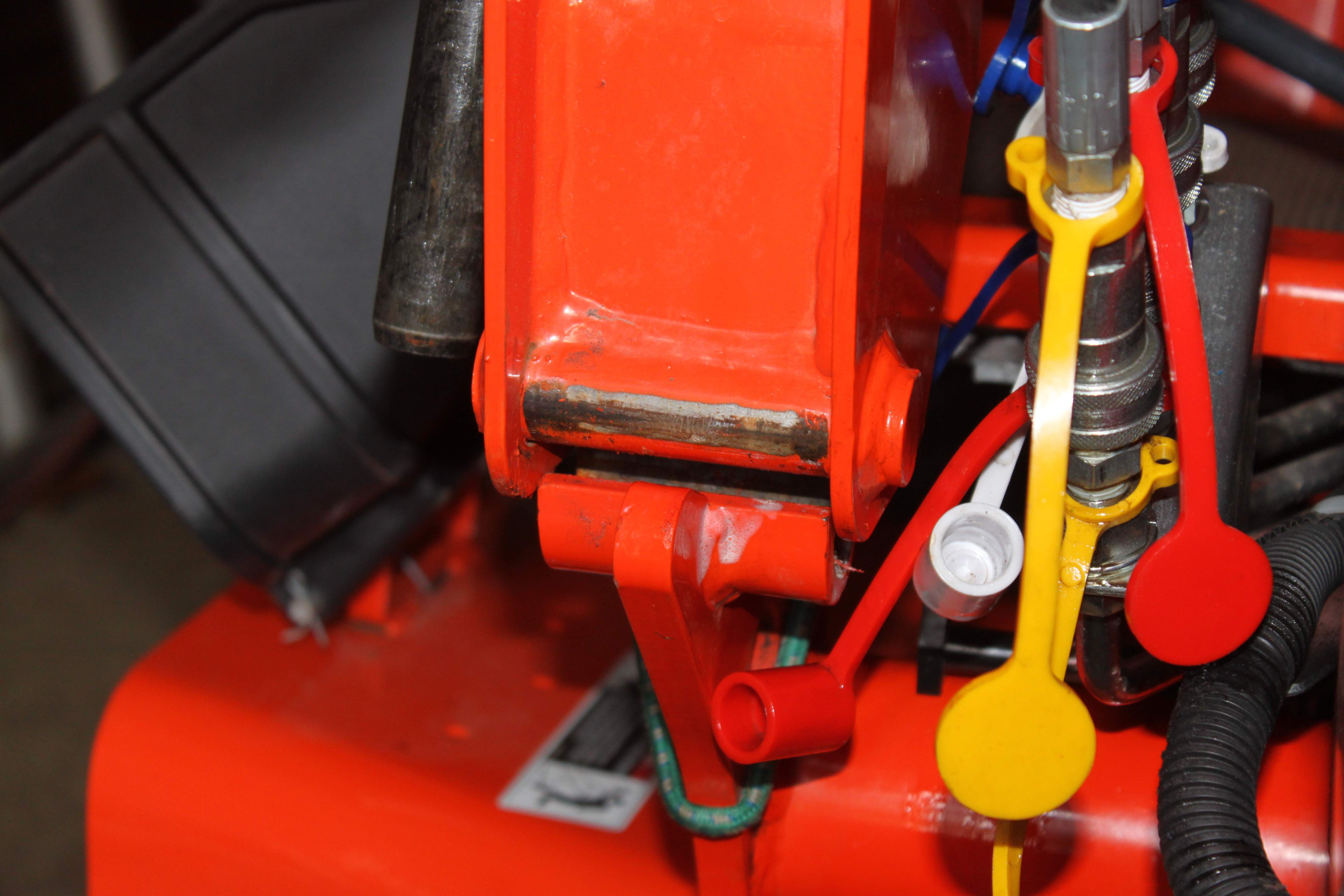

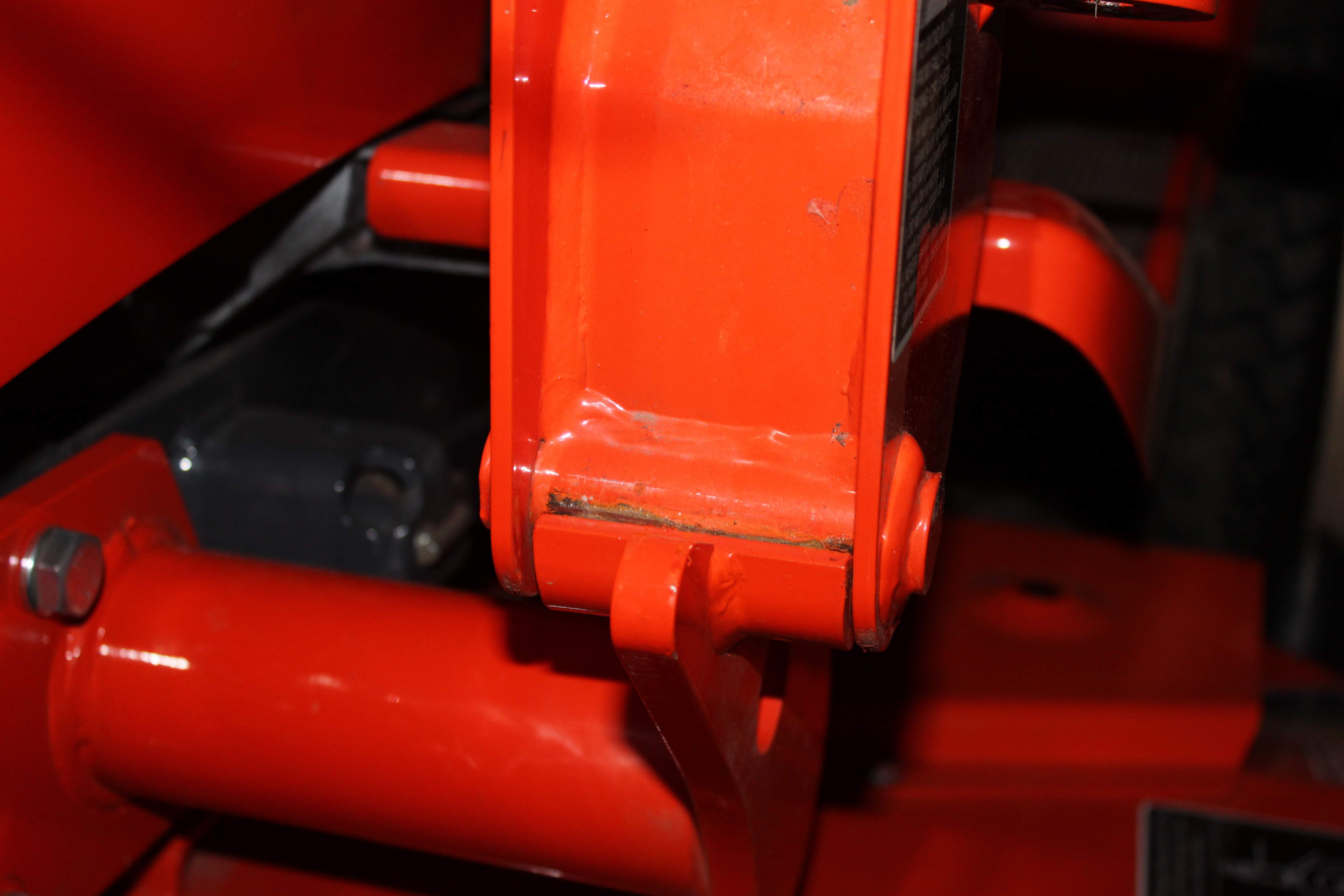

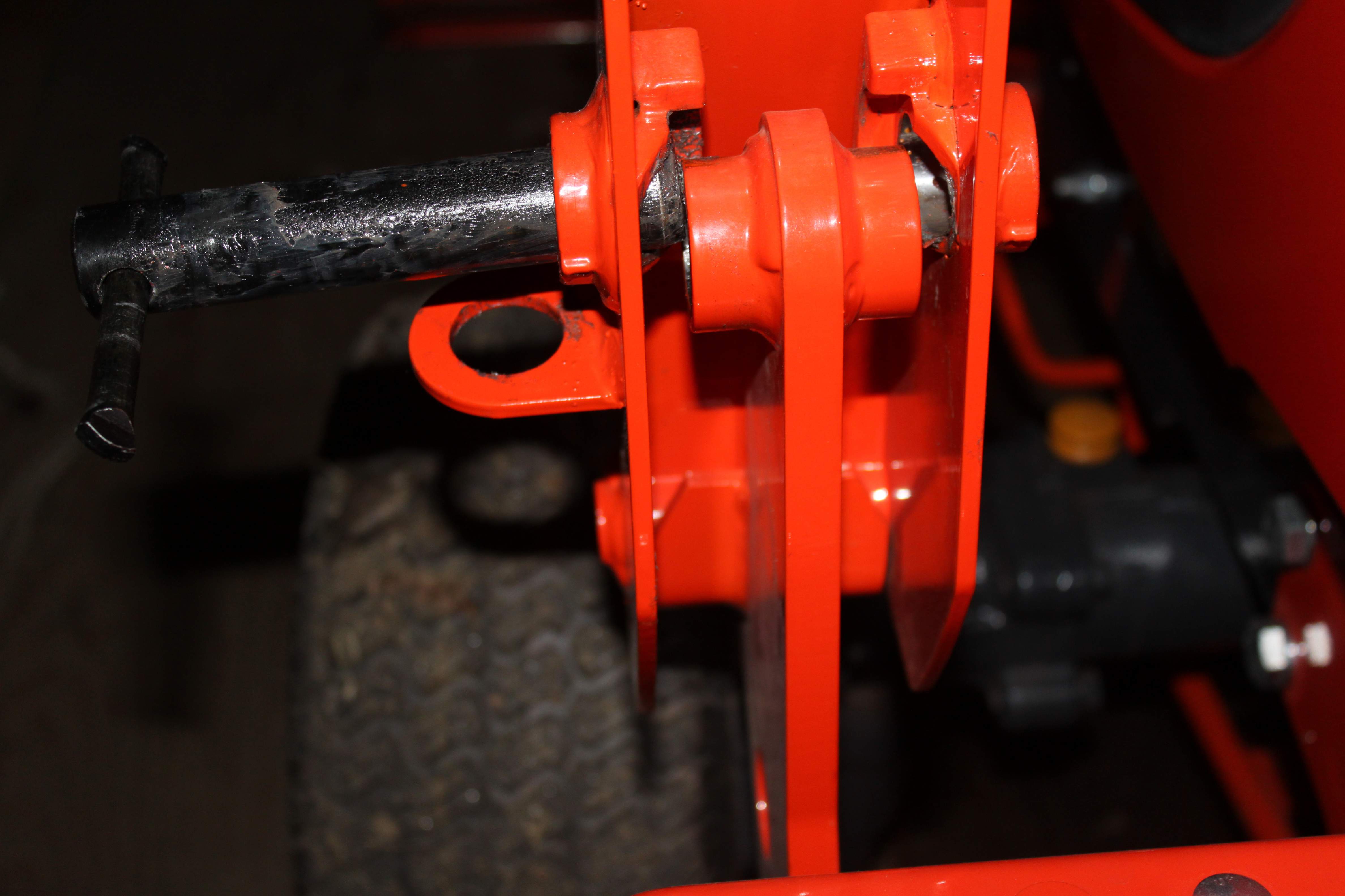

Then looked at the loader arms left and right. The left side frame/main frame boss/guide boss definitely looked to be further apart than the right side. Perhaps by 1/2 inch.
2E) Left Boss interface With Loader Un-Installed.jpg2D) Right Boss Interface with Loader Un-Installed.jpg

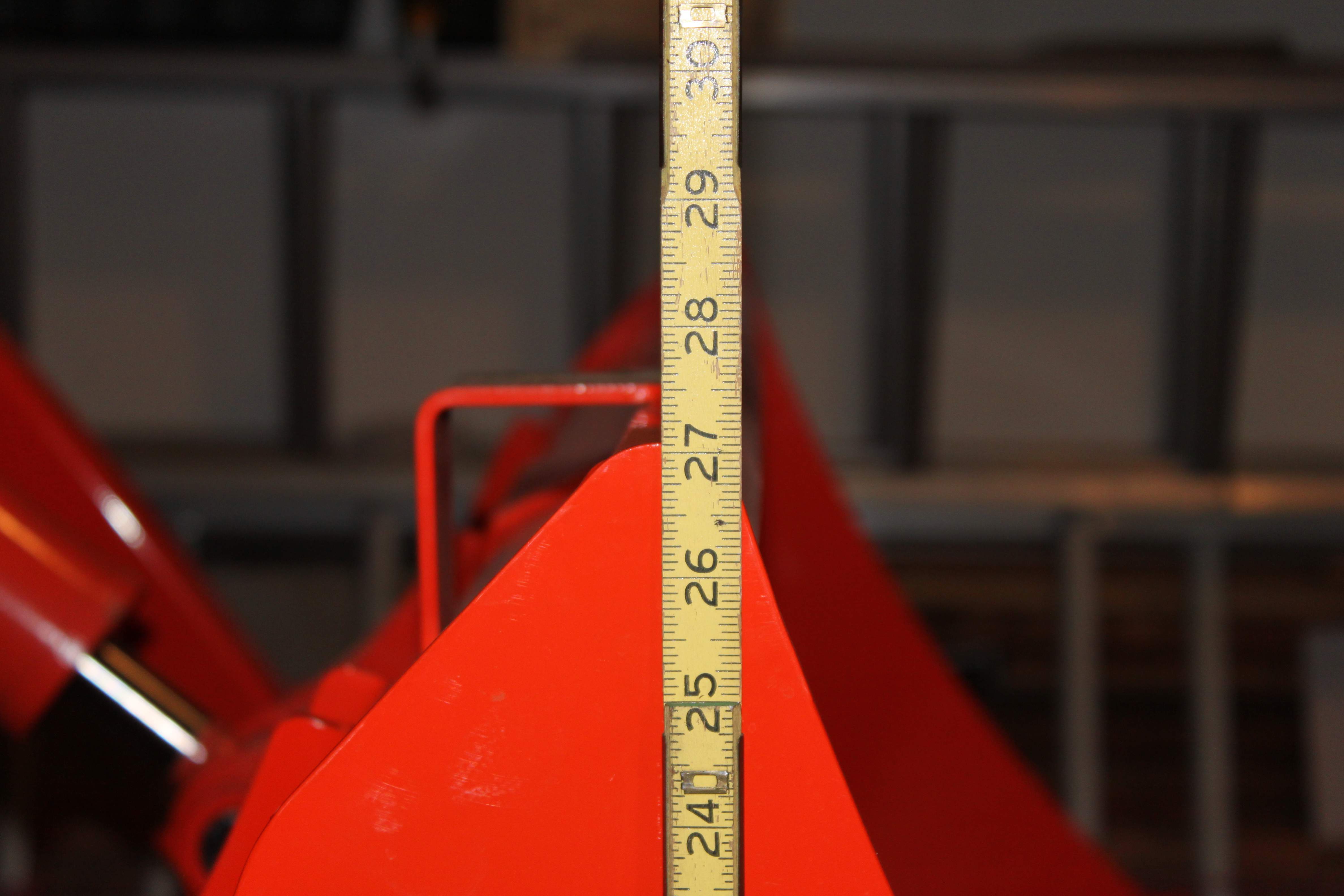

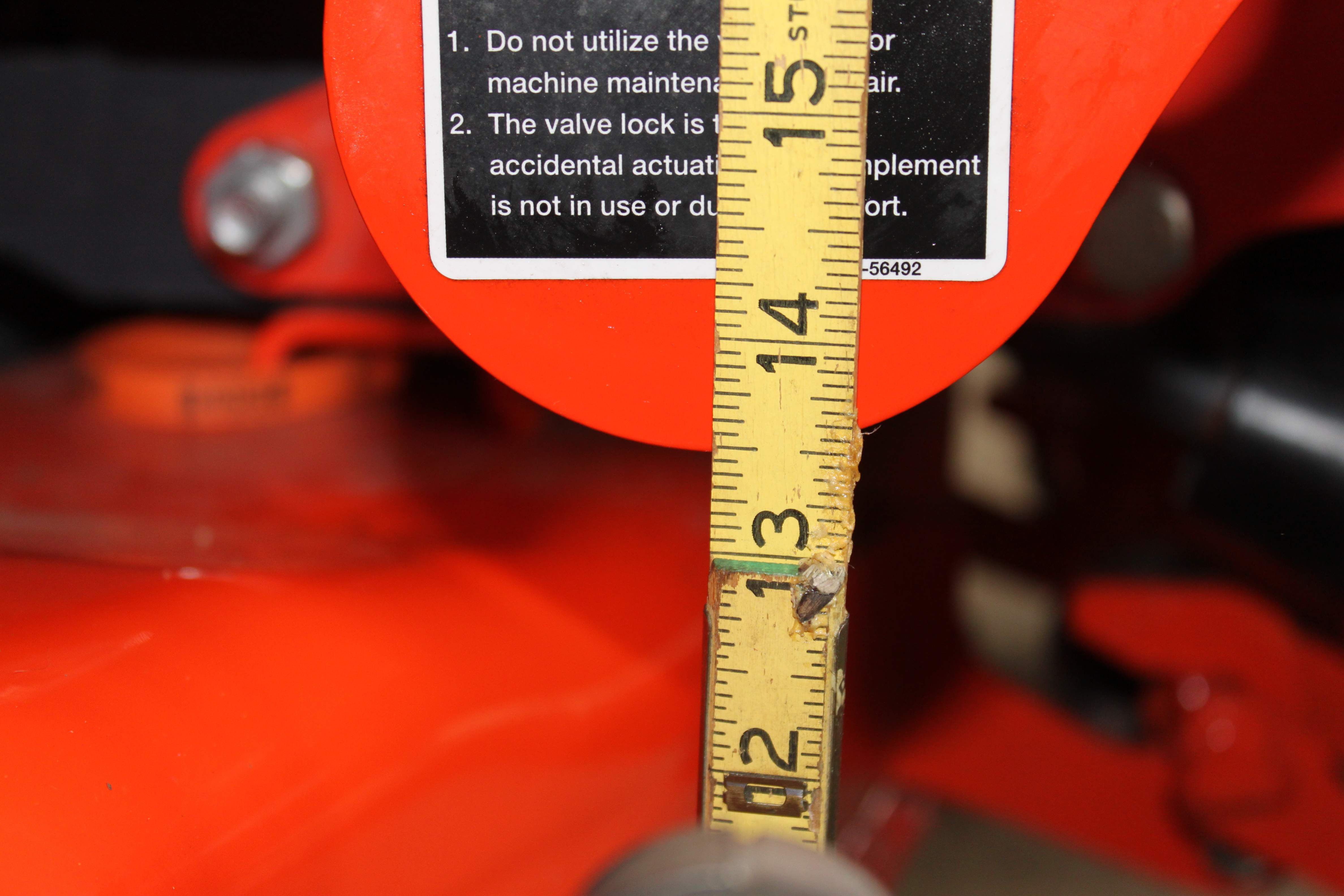

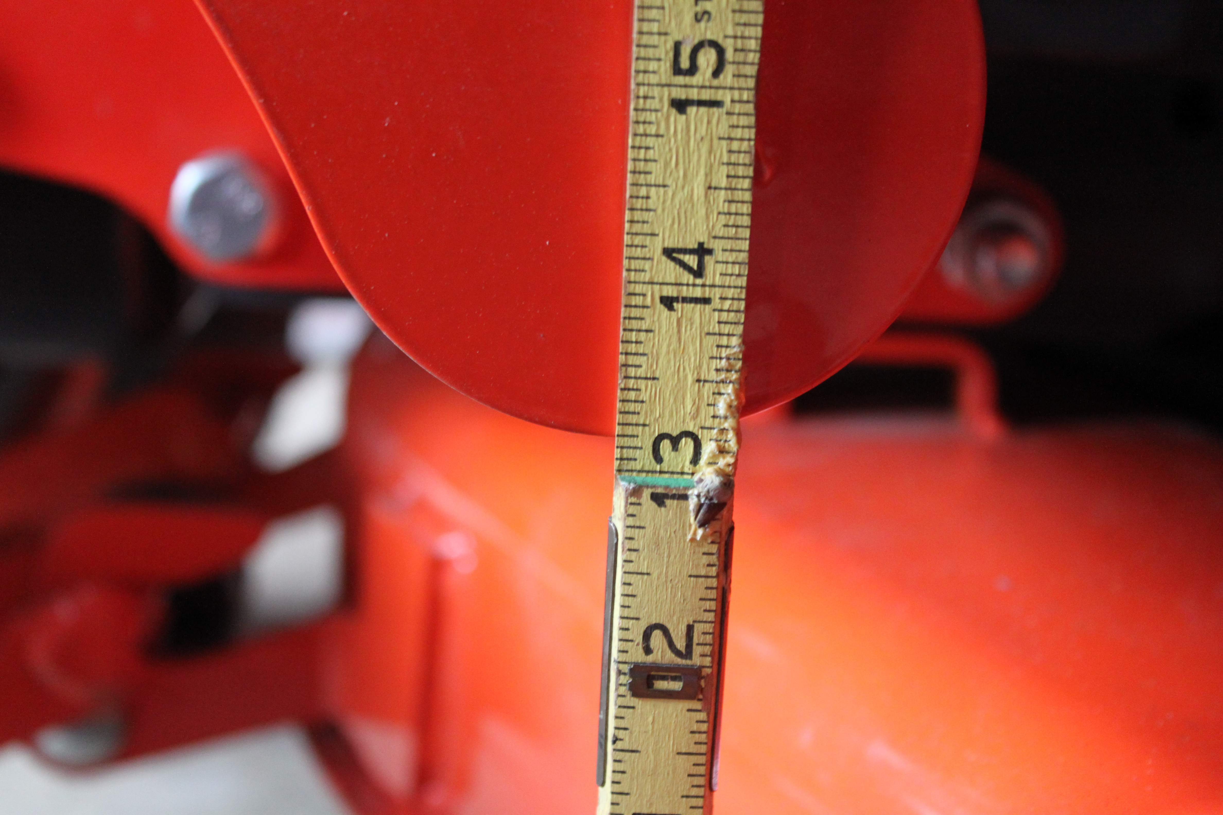

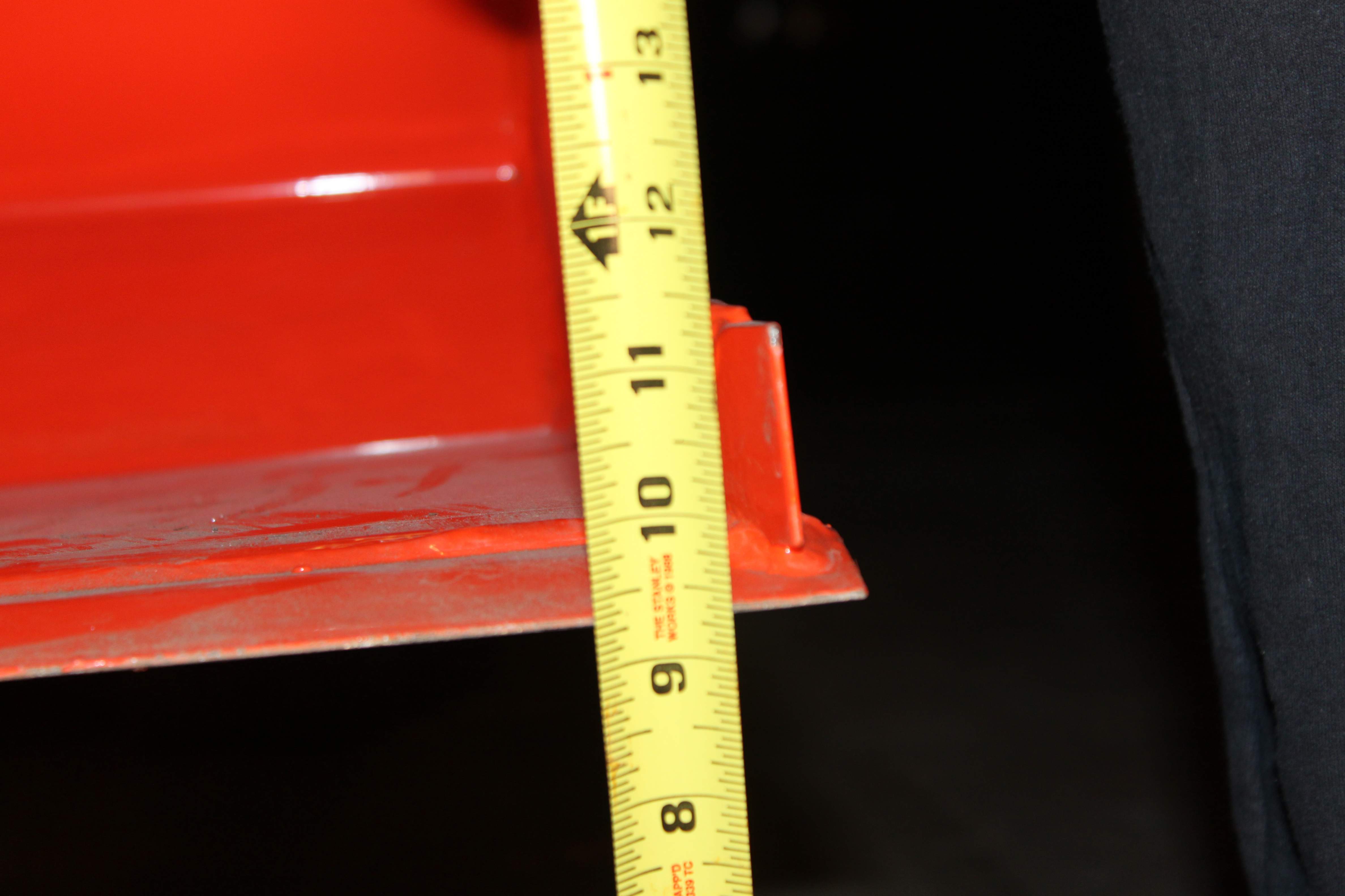

I then measured the height of the Main Frames on left and right side measured up from the cement floor. I found over 3/8 inch lower on the left Main Frame than the right.

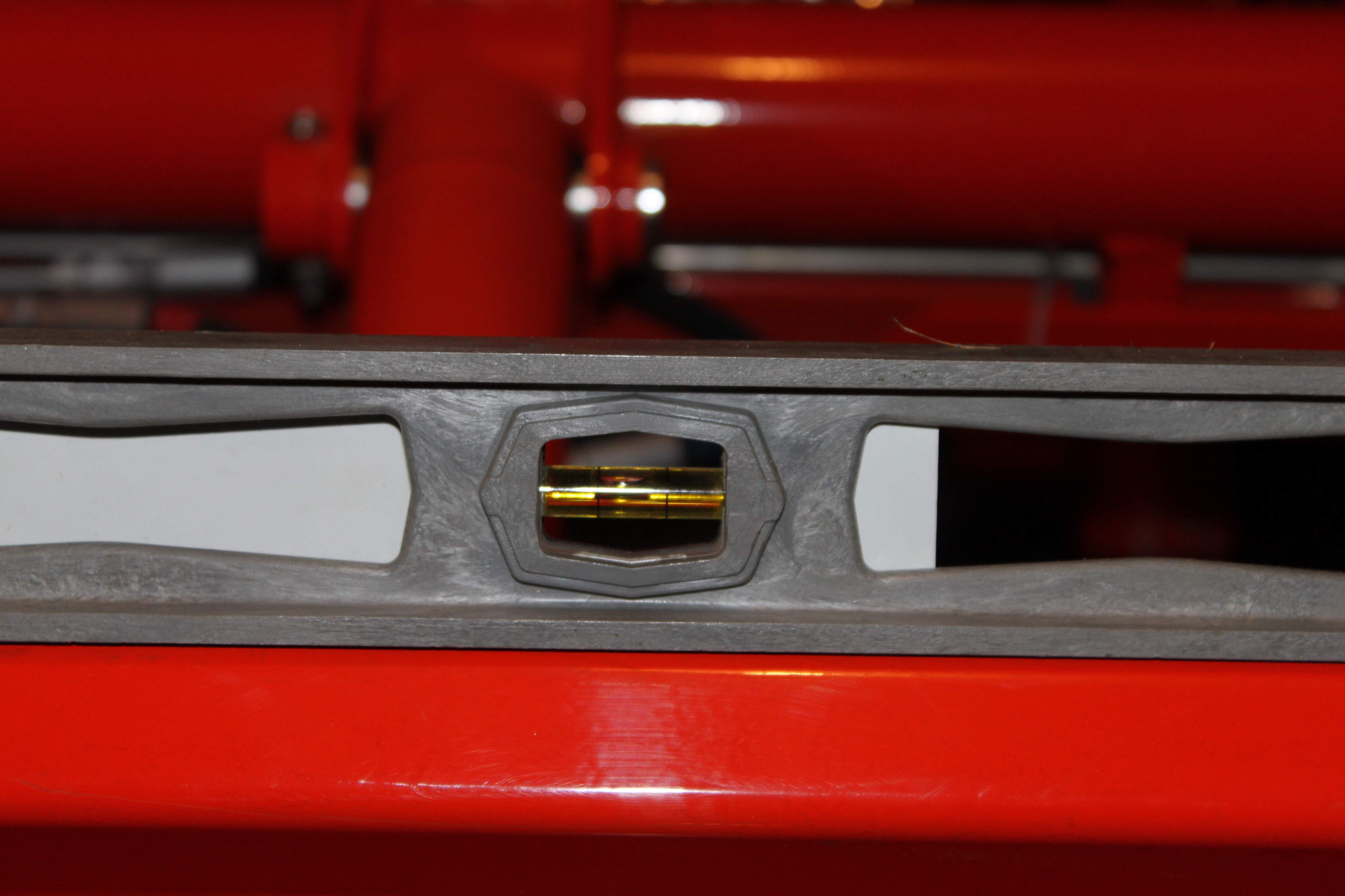

Doesn't seem like a lot, but it looks to be enough to be troublesome in my attaching. Since the tractor at the rear fender appears to be level, I wondered what would cause the left side to be low.

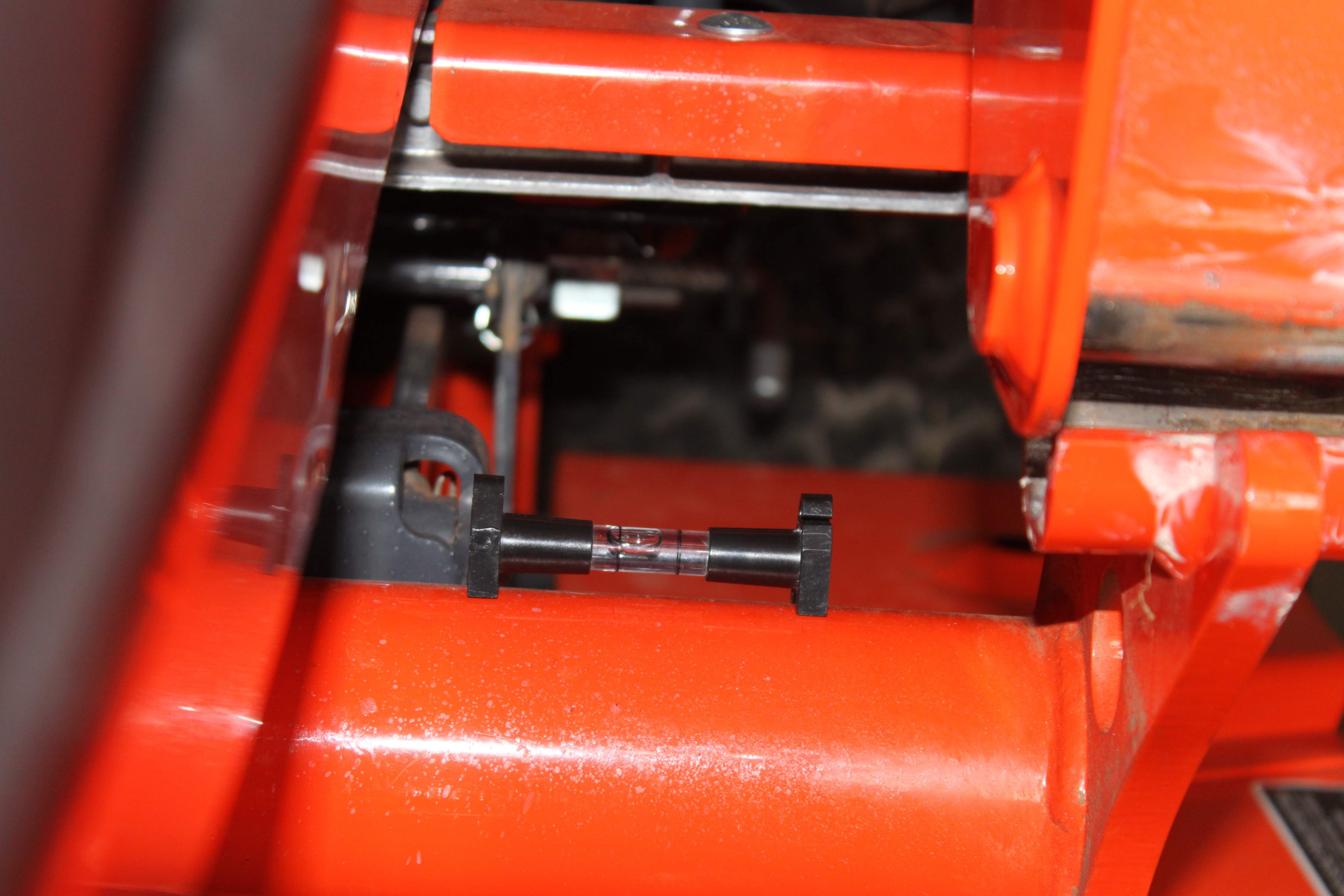

I put a bubble level on the tube that attaches the left Main Frame to the chassis and discovered that the tube is not level. The left Mainframe Guide Boss is also tilted because of this in the same direction, of course. This possibly prevents the side Frame Boss from sliding down in the seat properly when attempting the install.
The right side tube and Guide Boss is level (Took an image, but my auto-focus screwed it up)

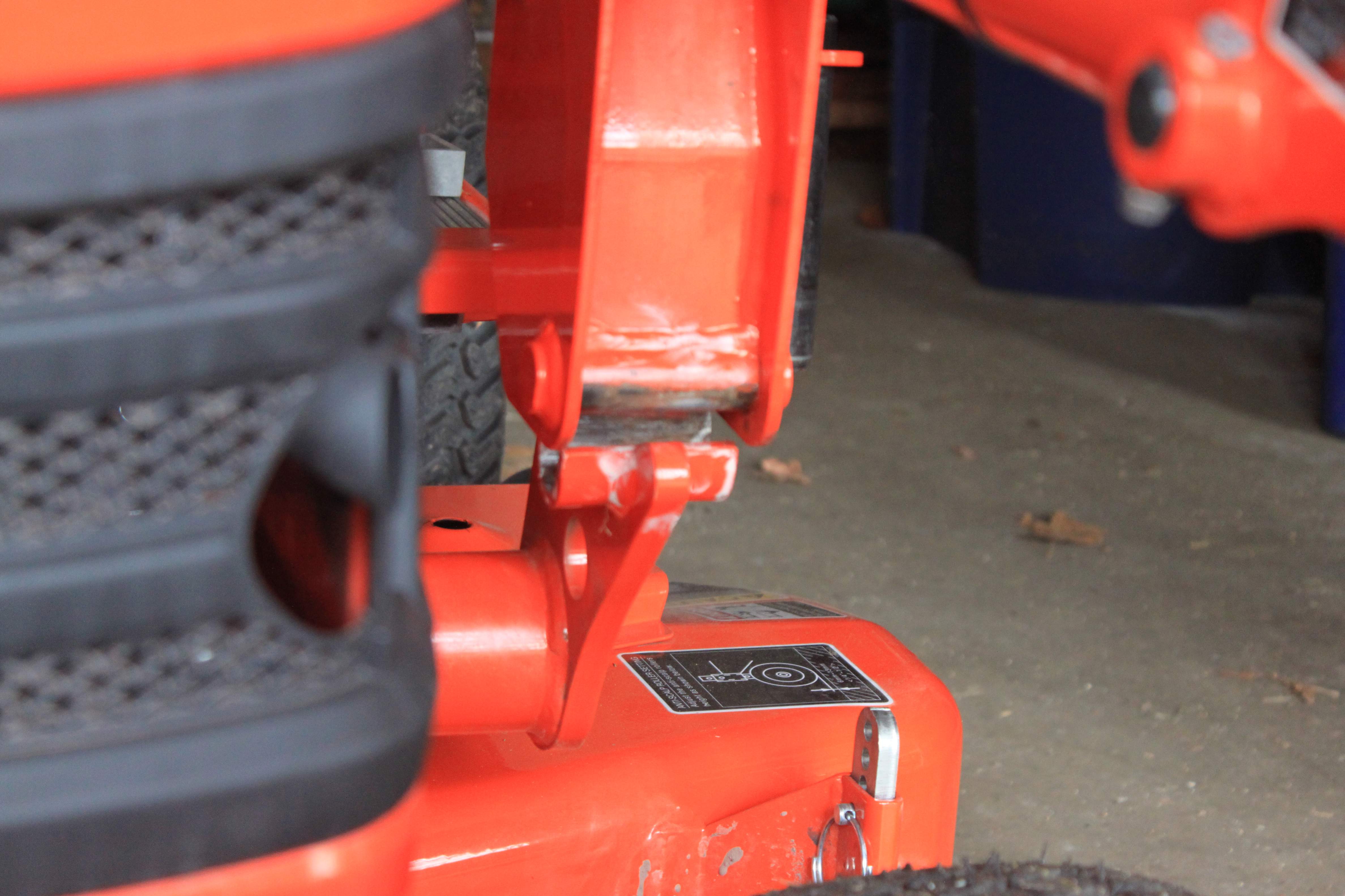

Unless I sit on the left loader arm to force the boss/guide boss to mate while going through the install sequence, the boss won't seat in the guide boss. It pops out when lowering the arms to lift the front of the tractor. Below is the position the boss/guide boss sit in with the bucket rolled to about 20 degrees down like the manual says.
3A) Left Boss with Bucket Rolled to Dump Position to Install.jpg3C) Left Pin With Bucket Rolled to Dump Position to Install.jpg3D) Right Pin With Bucket Rolled to Dump Install Position.jpg
As an experiment, I placed a 3/4" piece of plywood under the left rear tire and went through the attaching sequence and it worked perfectly. I had the loader off and re-attached in 30 seconds without touching the loader arms at all. I did the same by putting the plywood under the right side of the bucket and had similar results (Under the tire worked better) Raising the left side of the tractor (Main frame) with the wood under the tire or lowering the left Side Frame by wedging the board under the bucket served the same purpose and made the installation easy.

Can someone please do me a favor make sure their tractor is level and throw a level on the tube for the Main Frame that attaches to the tractor frame. Perhaps they are all tilted like that and I am off track.

I have a BX2360 and I just checked the tube on the main frame for level. It's right on. I hope you get your problem taken care of soon. I know how exasperating it can be to have an expensive piece of equipment not functioning well. Good luck.

Just as an FYI, I believe the loader stanchions (that bolt to the tractor frame) are not suppose to be torqued to full spec until the loader is mounted. Given that, I'm just wondering if, with the loader on, you could loosen the left side bolts to see if the stanchion will move into the correct position with the FEL weight on it. Now if it's truly bent, then I don't suppose that will help, but otherwise, it might. Good luck with getting it resolved.
