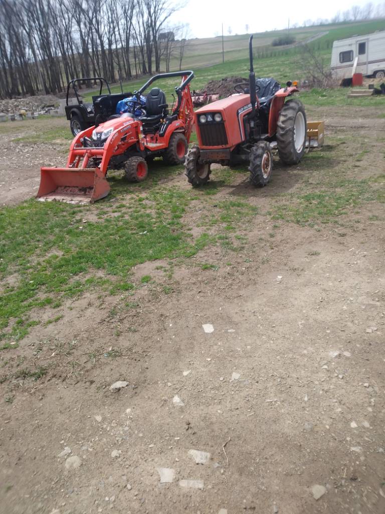

I started shopping subcompacts. I was primarily attracted to the price, and being able to get a TLB package for around $20k. The more I thought about it, the more concerned I became about the subcompact being able to do the jobs I needed.
Our box blade is a 5' model. Our old New Holland TC29 pulled it but when the box got full of material, especially on a hill, the tires would begin to slip a little. There is NO WAY a subcompact with half the machine weight would have pulled that box blade through a load of gravel. I also became worried about the tip over hazard, as subcompacts are very narrow and have tiny wheels and tires. The lift capacity is also a worry...typically you're looking at much less real ability to carry weight in the bucket. Bottom line is, the small size has advantages for homeowners with an acre or less, but if you want to do any real work or homesteading it's just not ideal.
I ended up moving up to a 40 HP compact and it is working out well. It's certainly NOT overkill for our 3 acres...it's often on the ragged edge of being adequate. But it works well and I'm so glad that I decided to forego the backhoe in order to get a bigger and more useable tractor. Our property is only a few acres adjacent to a couple more acres that my parents own, but I can't imagine trying to do the jobs that constantly come up around here with a subcompact.
