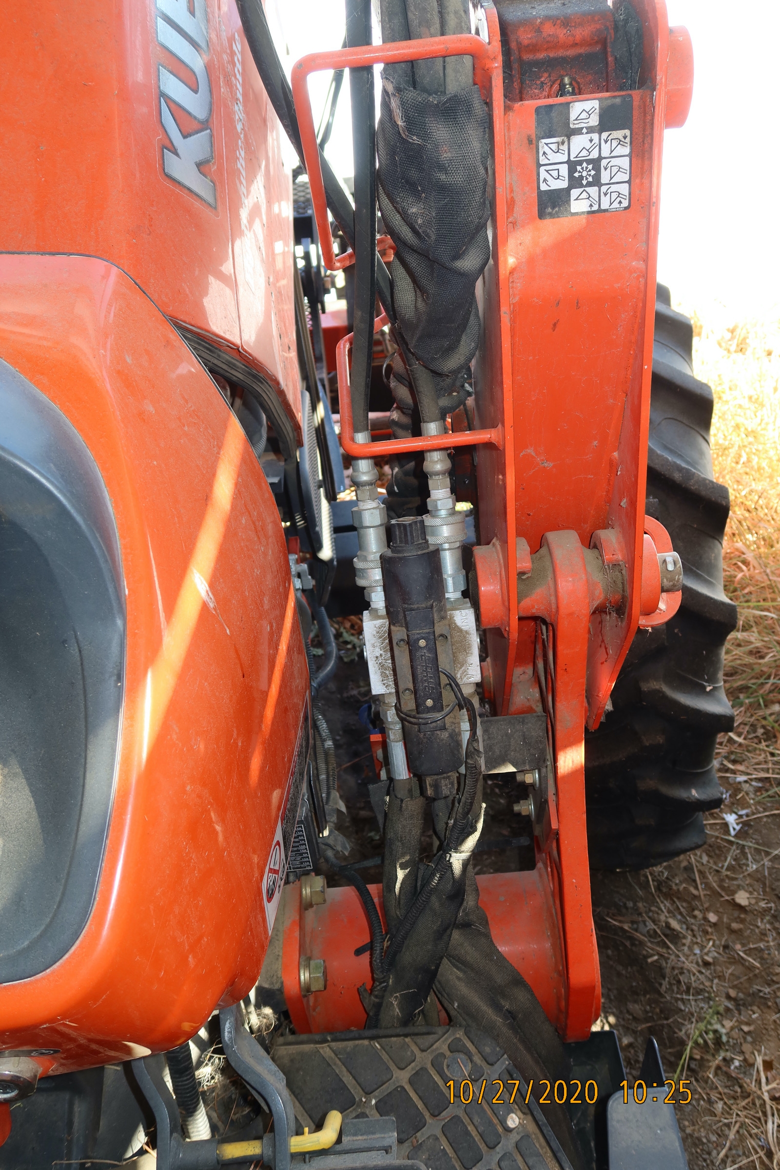

Twelve years ago I bought my Land Pride SGC1560 grapple and WR Long 3rd function valve from the local Kubota dealer. I've never switched back to the bucket.
If you get a grapple and a true 3rd function valve - you will get a new joy stick with the package. There will be two buttons or a toggle switch on the new joy stick. This buttons or switch will control the open/close function of the grapple. I'm not familiar with the plumbing on a diverter valve setup.
The 3rd function on mine is on the rear vertical loader riser. Tucked into the riser with all the necessary plumbing. Pictures........

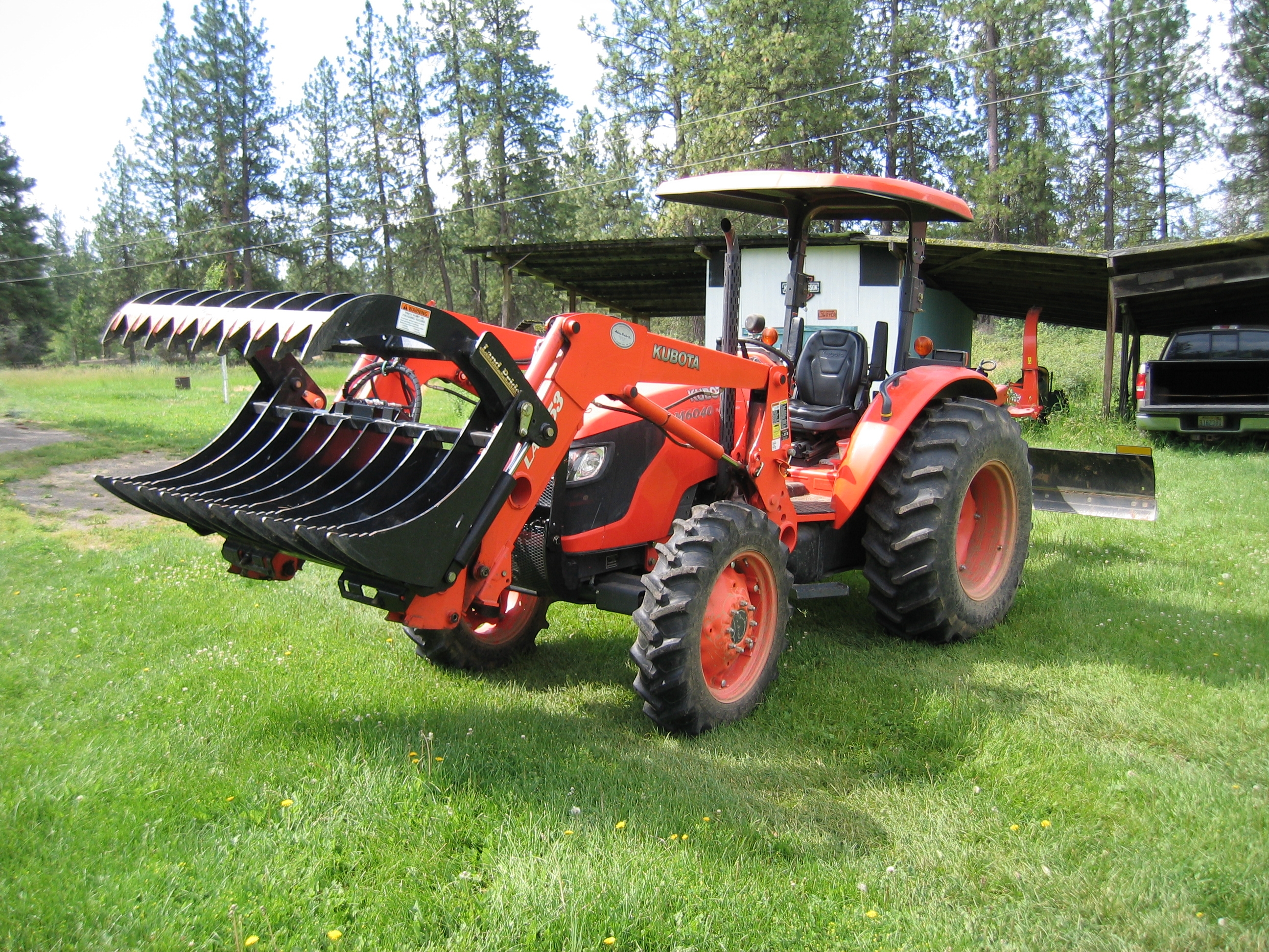

#17
oosik =
Your tractor photo is exactly what I have in mind, although it is not a compact tractor.

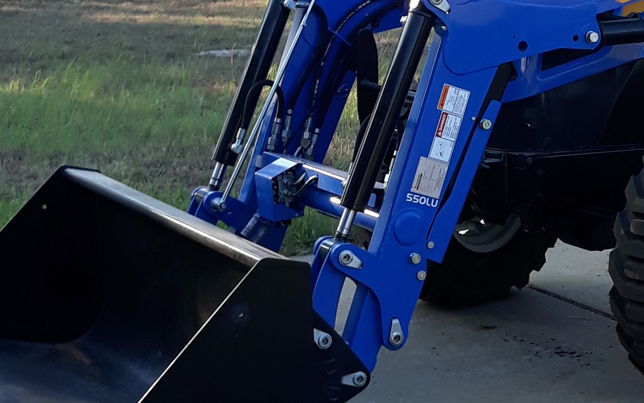

Keep in mind grapples are heavy generally, and with something like a BX or a JD-2025, you aren't starting with much lift capacity. 1023 lbs at the pins, then a 610# standard duty, 5 ft grapple; you have less than 400# usable capacity. Some of the "Economy" 48" models are right around 400lbs, leaving around 600# in capacity.
/ Compact Tractors W/ Grapple #19
My Kioti sits under the DPF limit and is amongst the largest tractors that do. Basically all the manufacturers sell a machine in this class. Examples include the TYM 2515, Kubota L2502, and Deere 3025E.
Machines in this frame size will give you the hydraulic capability of their 30-40 horsepower brothers with the simplicity of no DPF; on the flip side, they do everything a little slower. This may be something to consider given your primarily concern is loader work; they'll all take a 3rd function kit.
