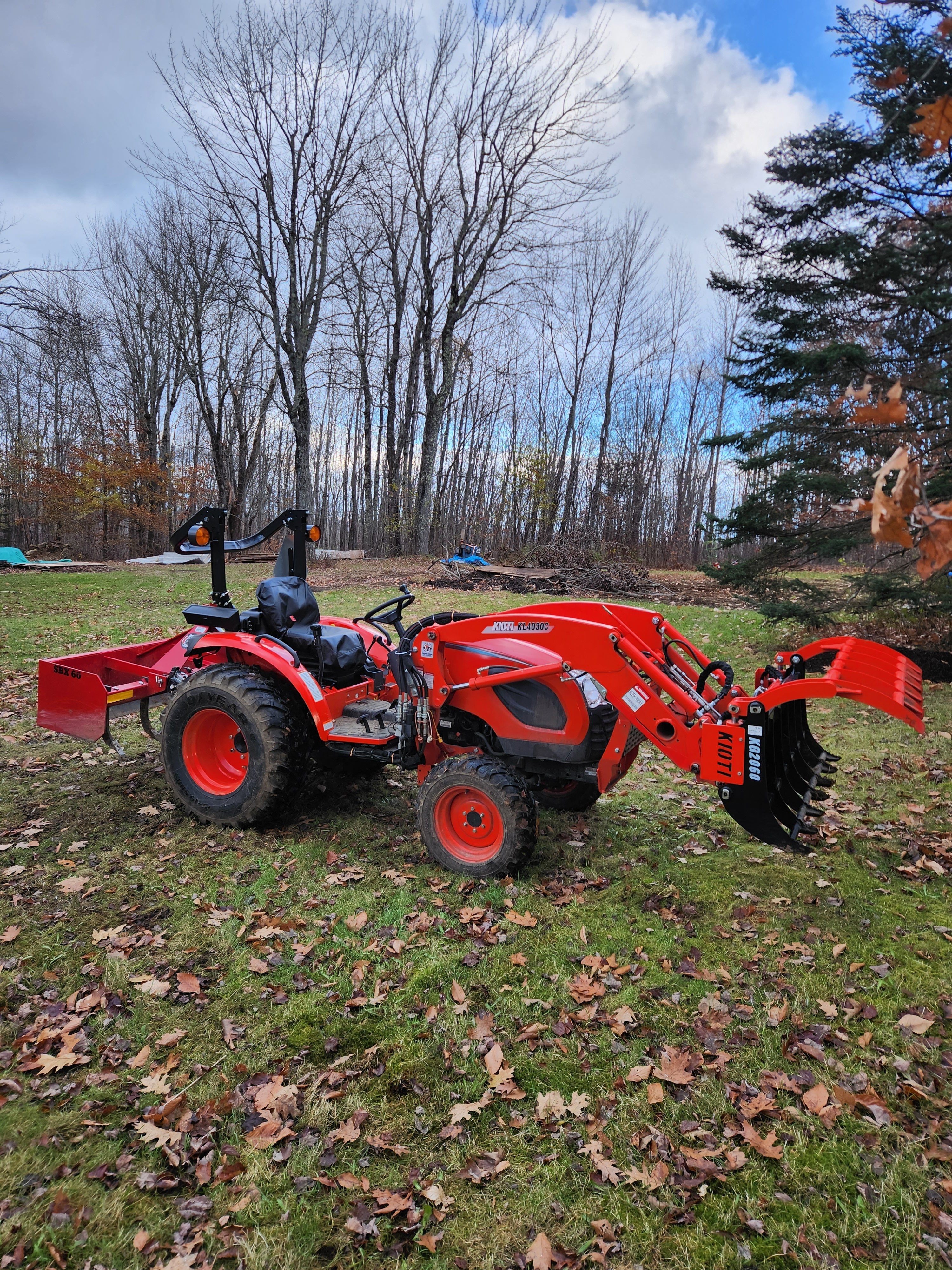

I find the no extra hydraulics mechanical grapple and interesting idea.

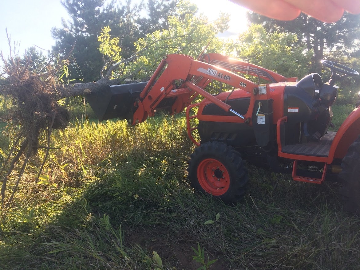

I find for brush I just push stuff around with my bucket or even the back of the box blade, but I'm nearly never operating on grass around the house, so sliding stuff over the ground and scuffing it up isn't a big deal. I do have manure forks which do lift a bigger pile of brush, but most of the time now I cut the roots of the whole tree on one side with the bucket, push it over and scoop the stump up and push the whole thing into the woods or out of the way.
I guess if your place is more like a golf course, a gapple would be very nice. Mine is pretty natural, so just crunching a small tree down out of sight, or pushing a pile of brush 100' on the ground with the bucket seems pretty easy.
You'll find the loader bucket pretty useful and with the 4 bar linkage on the curl there is a big range of motion. This was a pesky tree in the middle of a hay field and I was pretty pleased with removing a tree like this without getting off the tractor. I cut some roots with the bucket, pushed and scooped the bottom out and I stuffed it behind another tree in the fence row. I then scooped a patch of sod from over there and dropped it in the small hole.

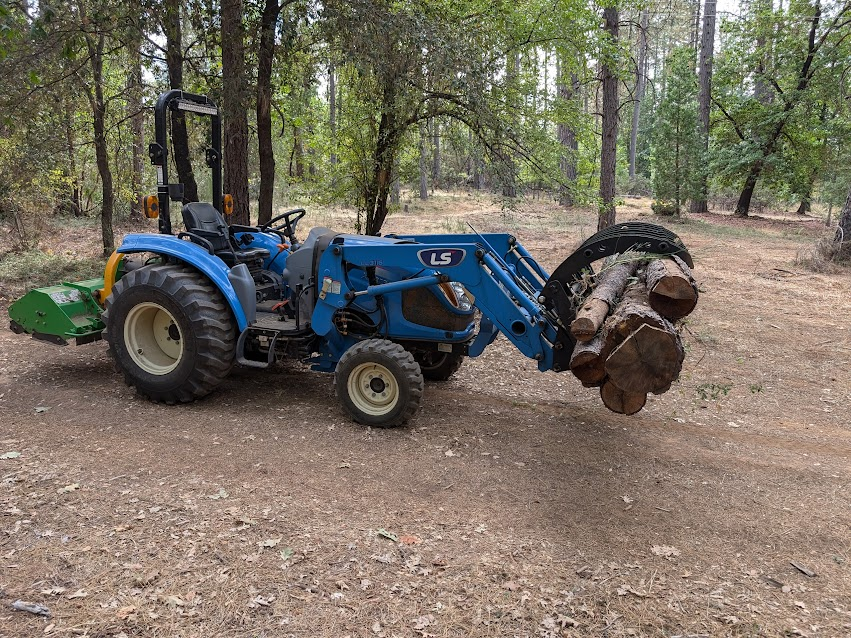

I had a third function installed on my L4060 and have regretted spending the money ever since. Why? Because the hydraulics are either on or off and feathering the valve to close the grapple slowly is impossible. I use the rear remote to control the grapple which allows a slow movement.
I know this is not everyone's experience and lots of folks like them, but I'd think about how you intend to use the grapple before you order a third function kit.
And yes I have installed a flow limiter on the third function, but it is still too fast for my uses.
I use a rear remote to operate the grapple and I can't remember ever feathering it. I crush stuff until it stops moving, or at least enough to hold on to it.
My grapple is a dual lid, so it's got two cylinders. The lids move pretty slow if the tractor is idling. I have to raise the revs to get the grapple to move fast enough when I'm doing work with it.
Different tractor, maybe grapple and likely different material, so different results. I mostly use the grapple on logs and branches.
A diverter will allow you to use the tractor joystick's dump and curl functions to open and close the grapple, when a button on the knob is held down. That's the other common way to run a grapple and it lets you feather the grapple.
The downside is that you can't dump/curl and open/close the grapple at the same time.

I also added a WR Long 3rd function valve and a grapple about 6 years ago and have not taken it off since. Although I'm sure I will eventually need to use my bucket, the grapple is by far the most useful implement I own.
/ Compact Tractors W/ Grapple #38
My set up is a little different. I made the grapple myself and it is attached to my pallet forks. In addition to using it for moving logs and brush I also use the grapple to secure loads on the pallet forks hence the need to be gentle.
I also slowly open the grapple when I am loading logs into my dump trailer. By opening it just a bit I can slide the log down the forks slowly, hold it with the grapple, then drop it into the trailer with less force and place it exactly where I want it.
