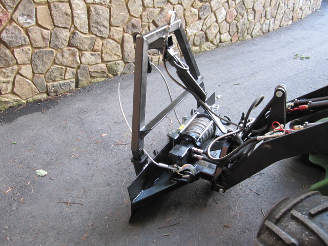

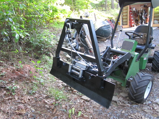

Picture attached of home made hydraulic winch I built for pulling down
the widow makers in my wood lots. Its got 7K of pulling power and can be used on or off the PT. For light pulls the dozer blade digs in to the ground as you pull or you can hook on to a tree base with nylon strapfor full 7K pull. Strong like bull. Winch free spools and has 2 speeds... made for pickup trucks. inexpensive to build with square tubing and trailer towing parts.

That looks good. Good concept too! Is that a mile marker winch?

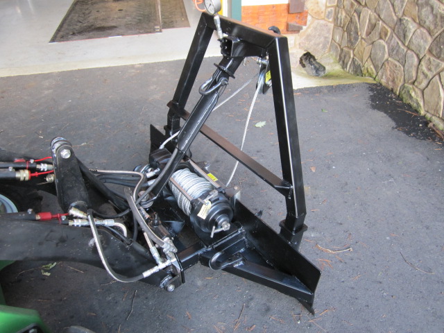

Very nice. I want one. Can you give us a picture from the back/side, please?

At first I thought that was the snow plow. But now I don't think so. More pictures please.
/ All Quiet On The Power Trac Front! #10
Here are some back side views showing the hooks welded on for nylon strap attachment so heavy pull loads go back to tree underneath PT with no load on PT at all. For awkward pulls the whole unit gets dropped and strapped to a tree up to 12 feet away from PT and then also use Mongo snatch blocks to turn the cable in any direction when needed to stay out of way of widow makers coming down.The pulley tower also lifts out of the veritical receivers on the plow blade when not needed. (Winch is Mile Marker, will pull large truck up steep cliff. 150' 3/8" cable ! Mucho winch for mini money at Truck AddOns.com)
