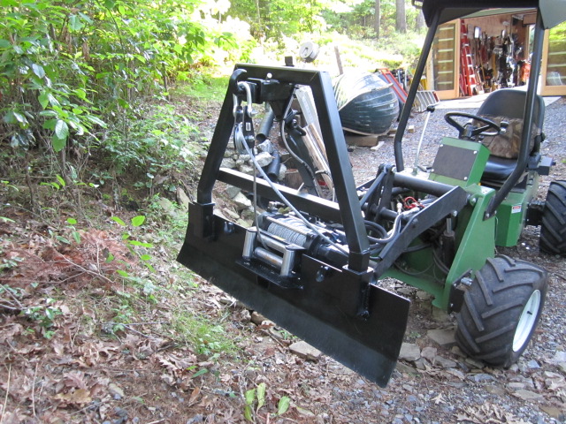

Wow... What a nice implement...!!
I met a cottager once, who told me he had a better technique than a chainsaw to remove tall trees (not necessarily dying ones)... Sounds a lot like your tool.
He explained to me that he uses the 2K lbs winch mounted on the front of his Dixie Chopper zero-turn. Using *very* long cables, he would attach a cable as high on a tree as his extension ladder would allow. Then, he would park his mower 100+ft away, wedged against the trunk of another large tree. Then, he would slowly let the winch do its work, pulling the top half of the tree down, bending it, until the roots would give. Voilà! No stump to grind out!
Apparently works most of the time in his mountainous region. But, I can imagine that depending on the tree type and soil conditions, that approach might never work, as the tree would snap its trunk midway instead of the roots giving out...
Next time you use your implement, it would be great to see a shot of your tool being used when it is not inline with the fall direction of the tree.

Picture attached of home made hydraulic winch I built for pulling down
the widow makers in my wood lots. Its got 7K of pulling power and can be used on or off the PT. For light pulls the dozer blade digs in to the ground as you pull or you can hook on to a tree base with nylon strapfor full 7K pull. Strong like bull. Winch free spools and has 2 speeds... made for pickup trucks. inexpensive to build with square tubing and trailer towing parts.
Very nice! :thumbsup:

:eek::eek::eek: FAZTRAC How could you be keeping this from us!
Wow that is SWEET!:thumbsup:
