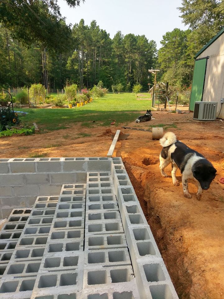

Between rains from Harvey, and goats having babies, I finished the block work on the Akita Pool. 360 blocks and 36 sacks of mortar. As an amateur, I wasted a lot of mortar, but at least it wasn't a lot more.

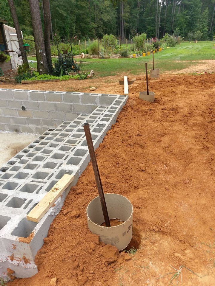

Before the snake, I got some work done on my footings for the porch. The porch will be 16 feet by 24 feet. The boy dogs, Matsu and Raidan, like to hang out with me more then the girl dogs. We have no idea why.

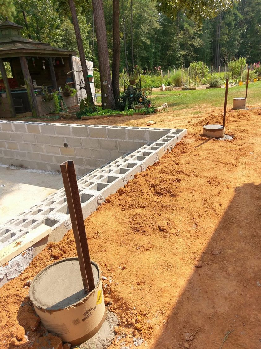

I dug my footings and set the sonotubes 1 1/2 inches above the finished concrete height. It's important to me that the posts remain as dry as possible. Then I brought some dirt over to start back filling and bringing the dirt up. The backhoe bucket is great for this. I don't get a lot of dirt compared to the loader bucket, but I do get it really close to where I want it.
The holes are 3 feet deep and centered for the channel iron. That's five feet long. I want two feet above the concrete pad to anchor my cedar log posts.
Once I get the hole mostly full, I level my channel iron. The sonotube is off to the side of the hole, where I want the post to sit. For this, the channel iron is 14 feet from the house, and the post will be 14 to 15 feet from the house, allowing me a foot of overhang.

Will the post be on the footing and then will you drill and bolt through the channel iron?
I guess I am confused on the placement of the channel iron at the edge of the sonotubes. It looks like it would "easily" pop loose when any racking stress.

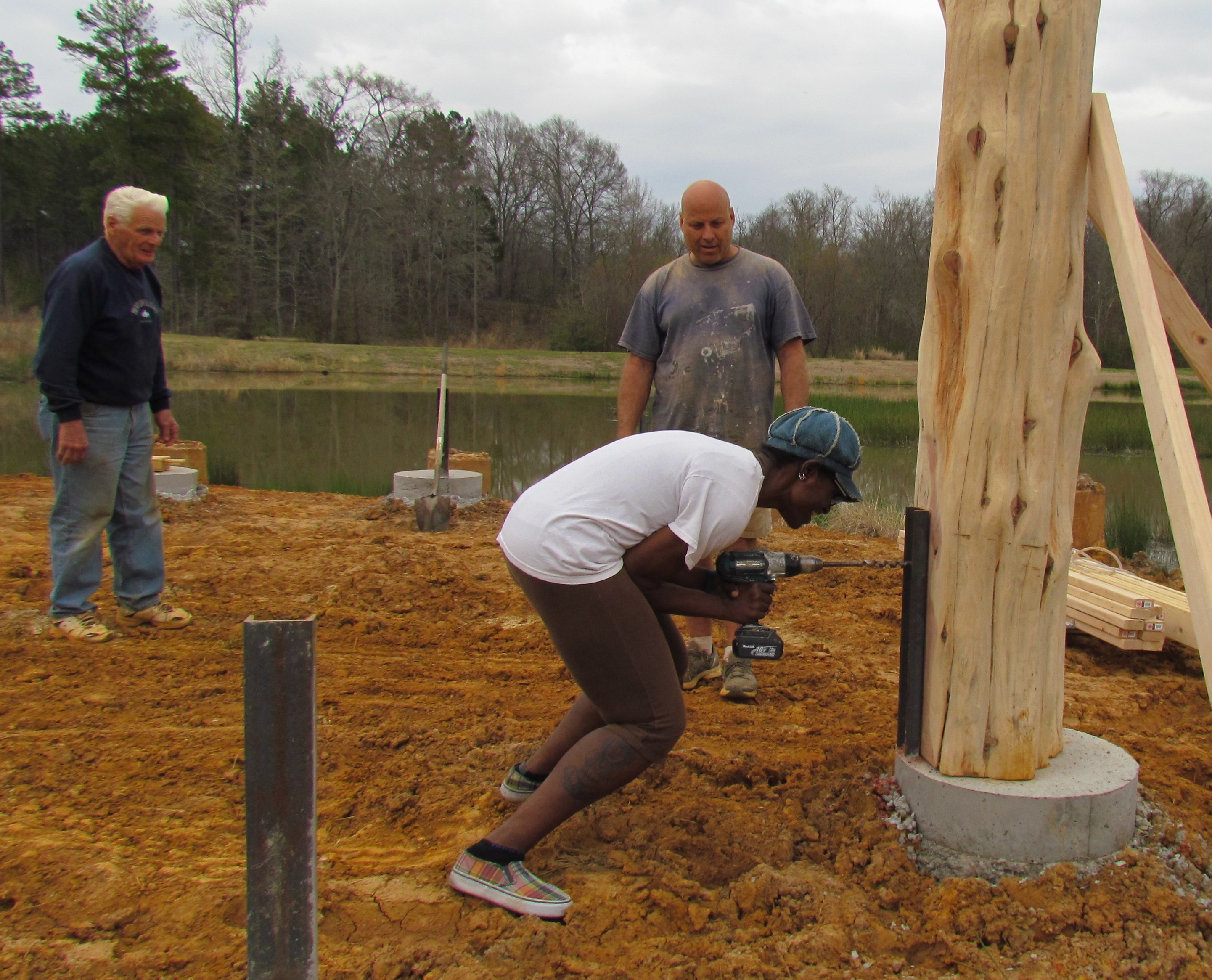

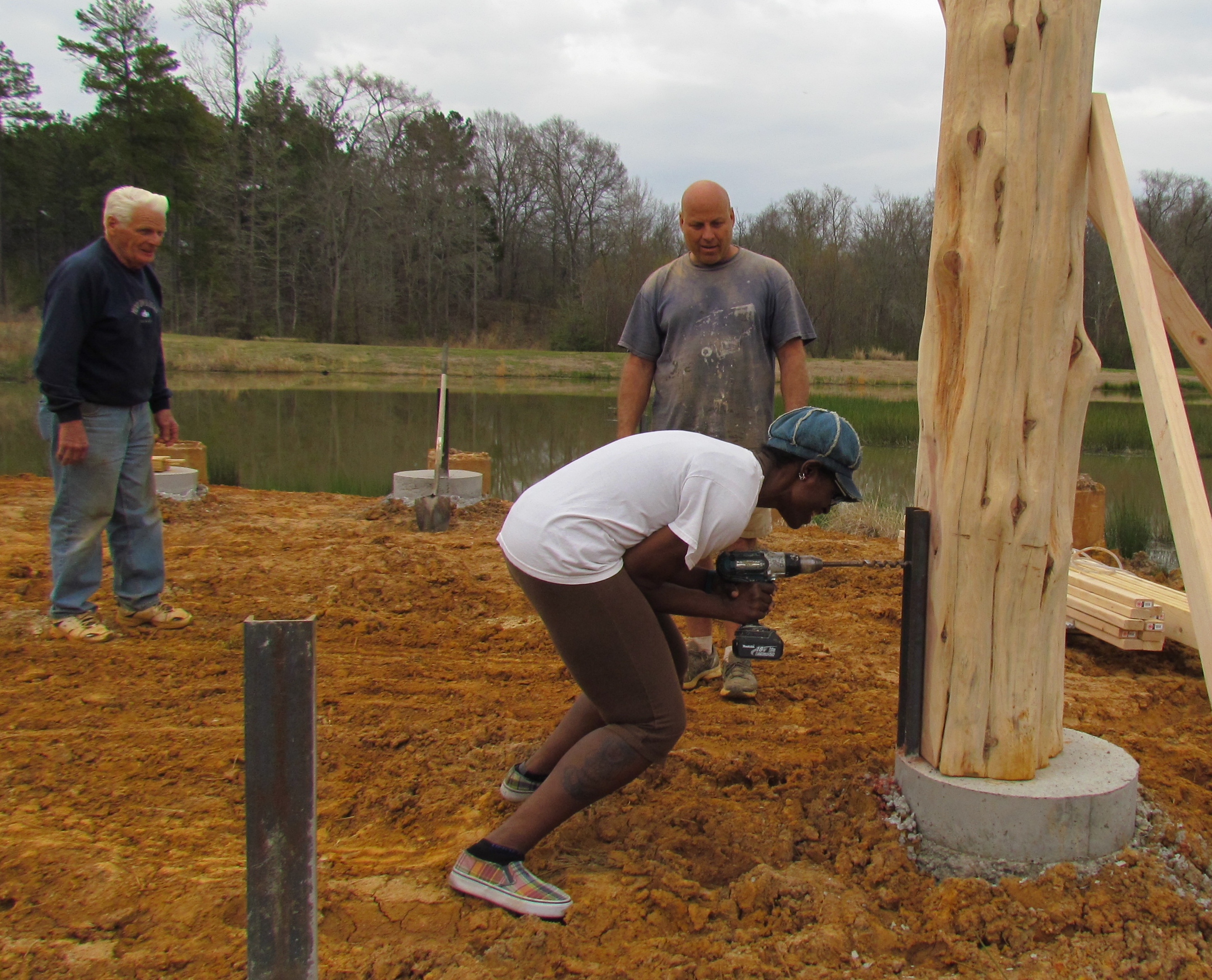

Hope this picture helps. This is from my gazebo build. The channel iron is in the middle of the hole with concrete all around it except for where it comes out of the ground. The it's only at the edge of the sono tube. The concrete in the sono tube is only on about half of the hole, so a good part of the weight from the post and above is carried all the way down into the hole, but also some of it is resting on soil.
I'll cut two holes in the channel iron with my torch. Then when the log is set in place, I will drill a 3/4 inch hole through the log, insert 3/4 inch galvanized threaded rod, add a galvanized washer and nut to each side and tighten. Then cut off remaining threaded rod.
The log will still move, so I'll keep it braced until I have the roof all tied to it. That will lock it all in place so there is no racking.

Why do you choose to use channel iron bolted to the cedar posts, and not drill the posts to have rebar go up into the center of the cedar posts? This is what I have seen Harvey do in the past.
hugs, Brandi
/ Akita Pool
#170
Pining the posts is fairly common, but only if there is a a really good way to secure it at other locations, or it's not really supporting anything that might move around.
Log home builders use a blade type of steel that goes into the posts cut out with a chainsaw, then you drill a hole through the post and attach it that way. This is a lot better then relying on gravity to hold it in place with a pin, or rebar. Some of the log home builders leave the bolt and nut exposed, some plug it so it's hard to see.
When thinking of how to keep the cedar from rotting, and make it as secure as I possibly could, I decided on using the channel on the side. The look doesn't bother me, and nobody who has seen it person has every commented one way or another. I think they see the cedar logs and don't even notice the channel iron, but who knows?
60 mile per hour winds on a big thunderstorm are not uncommon. The potential to have even stronger winds exists. I've see porches blown completely off of house and there was not a tornado. Straight line winds are blamed, and they can be very impressive. I hope to be building something that can resist this.
Thanks for the explanation. I was wondering if the sonotubes were offset.
Makes perfect sense to me.

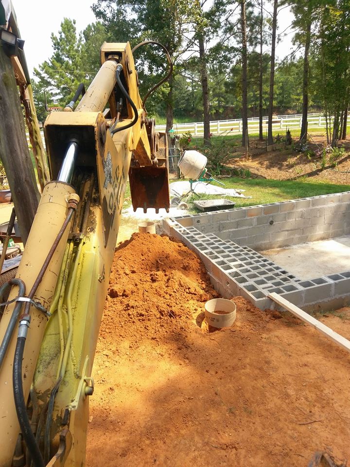

Didn't get as much done as I had hoped, but a little progress is still progress. The porch is being extended quite a bit and to do this, I need to build up the dirt. I brought in 7 yards so far and probably need another 3 for the pad and one more yard for the fill behind the blocks on the far side, that is hard to get to until I remove the cement mixer. I'm a little amazed at the change. I pictured it in my head, but it's never the same as when you actually create it.
