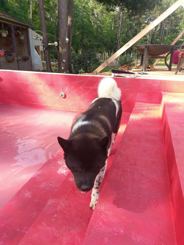

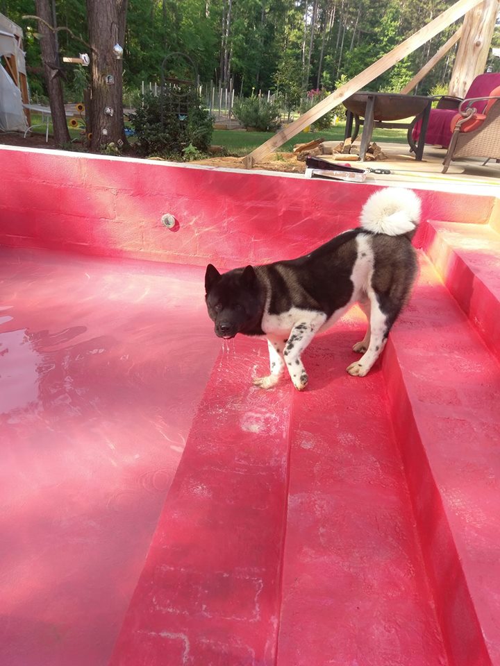

I haven't worked on the pool or done anything new to it. I'm still on the original water, which is a first for me. The chlorinator and Bromine are doing the job. I have it set to where I'm consistently at 3-4 ppm. We have had some issues in finding Bromine tablets. It's hit or miss at the local stores, but Amazon has been pretty good with the small 5 pound buckets. Summer ends in mid Sep, and then it cools off enough that it's not fun being in the pool anymore, so I'm good for the rest of the year on Bromine.
Yesterday we had a birthday party for our Grandson. Warren is now 5 years old. Since he love Dinosaurs, we bought a few to decorate. To say he was excited wouldn't do justice to his reaction!!!! If there was a better reason for building the pool, I can't think of it. He just loves playing in the water, and he's now big enough that he can walk in it and his head is above water. I think 3 feet deep was the perfect depth for this pool.
The dogs just drink out of it. Last year the puppies would come into it, but not this year. They like to run around it more then anything else. When I'm in the pool, they come to visit and slobber on me. I'm usually in it every evening.

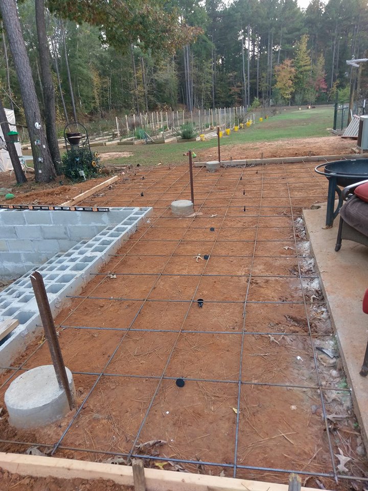

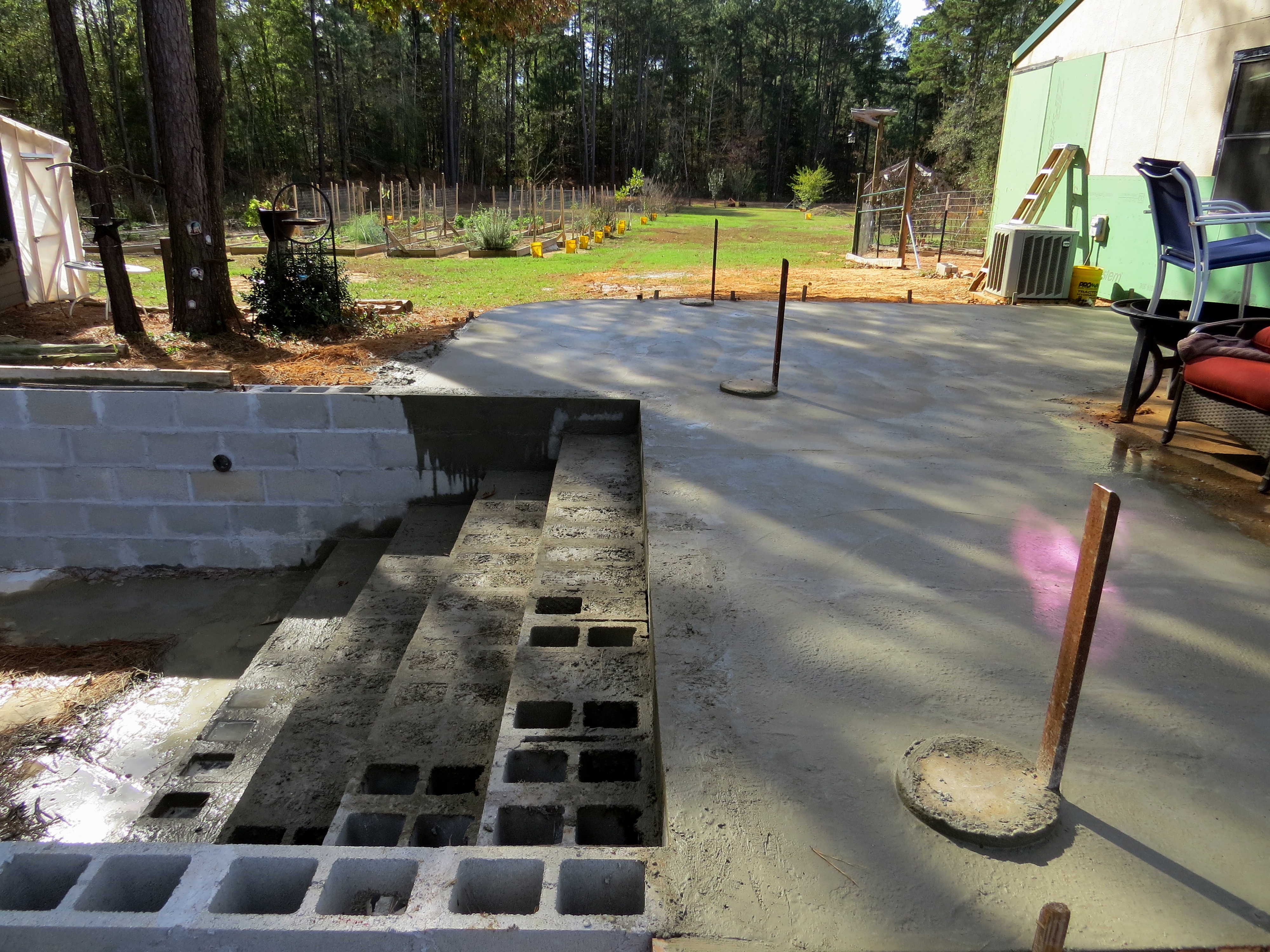

I had some concrete left over from my shed project and wanted to get it out of the way. We realized that when we poured the concrete for the porch that it should have gone out a little farther, so this seemed like a good time to get rid of all those sacks of concrete. Since there is a round section of the concrete, I cut out 4 inches where the form started so it would be thick enough to have some strength. I drilled into the original slab and the cinder blocks of the pool for the rebar, and used glued them in with liquid nails. Depth of the slab starts at 3 1/2 inches and drops down to 9 inches deep. Instead of trying to build up the dirt and compact it, I just mixed more concrete. I had 66 sacks and I used every one of them. I didn't have enough concrete left over to fill a coffee can!!!! I can't remember when I was so close on materials and actually had enough to finish it.
The weather changed today. It's less humid out and morning temps are in the 70's with a forecast to get down into the 60's later this week. My days of swimming are coming to an end and I'm expecting to drain it in a couple of weeks. Pretty soon we will be enjoying a fire on the porch!!!
