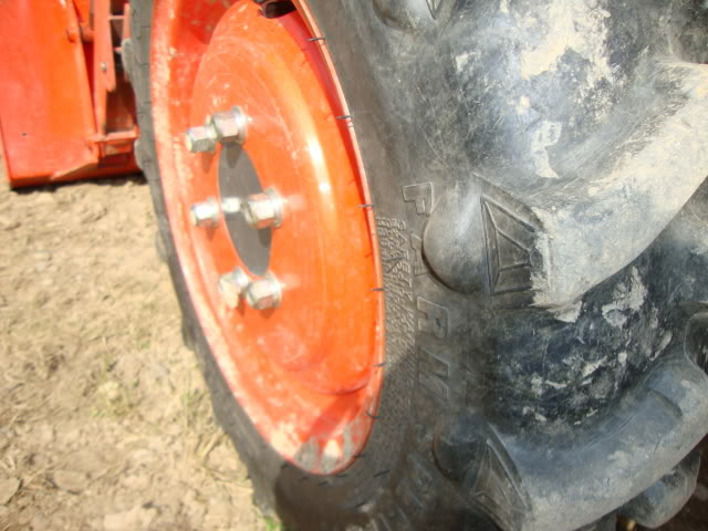

If you have a front end loader, run the maximum allowed pressure for the tire as noted on the sidewall or in the loader manual. I made the mistake of running 26 psi in my R1 Ags on my L3400, which is what the manual calls for except in the small print where it says to increase to 36 psi if using a loader.... ruined 2 tires.
Sean

Wow. I have seen them welts like that on rear tires but not fronts.
/ air in front tires #16
Yeah.. the air got between the sidewall and the inner carcass, they were becoming delaminated. As soon as the air was out of the tire, the bulges slowly went away. I could have probably simply tubed them and they would have been OK, but Carlisle offered to replace them instead. I tubed the new ones just in case.
