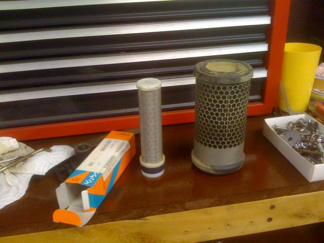

Kubota B2910 Inner (left) and Outer (right) air filters:

It's an Option, when I asked my dealer about it, I was told that I didn't need it. The reason I changed my air filter (2x) was the fact that I used my tractor a bunch building a couple of roads and it was very dusty. Now that the roads are done... I'll be changing my tune instead of air filters...
Well, I bought both of the filters...
I put in the single outer...
I might put the other one in if it will work....

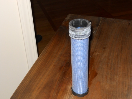

whatcha think of this nasty filter?

So, did you buy the inner filter, too?? (yes, you guessed it... I need a Photo!!! even a blurry one :D)
That dirty filter was about what mine looked like...
I will when I get home. Right now I am at pizza hur waiting on lunch!
here ya go...
It's BLUE!!
FYI-- That was with a new camera--- and I had the auto focus off...
and the little thing that "steadied" you when you hand was moving..

I am pretty sure the filter paper has an anti bacterial coating-the smaller inners inners always seem to have had that color paper for the most part.
The cartridge filter these days does more than visit the engine compartment in Kubotas-or other machines there used in all sorts of places like hospitals for postive ventilation, screening plants for salt and grain, air handlers for large buildings( the one we had worked great when they cleaned and was lousy when they put a pallet of valves in front of it (BECAUSE WE HAD NO WHERE ELSE TO PUT THEM)
