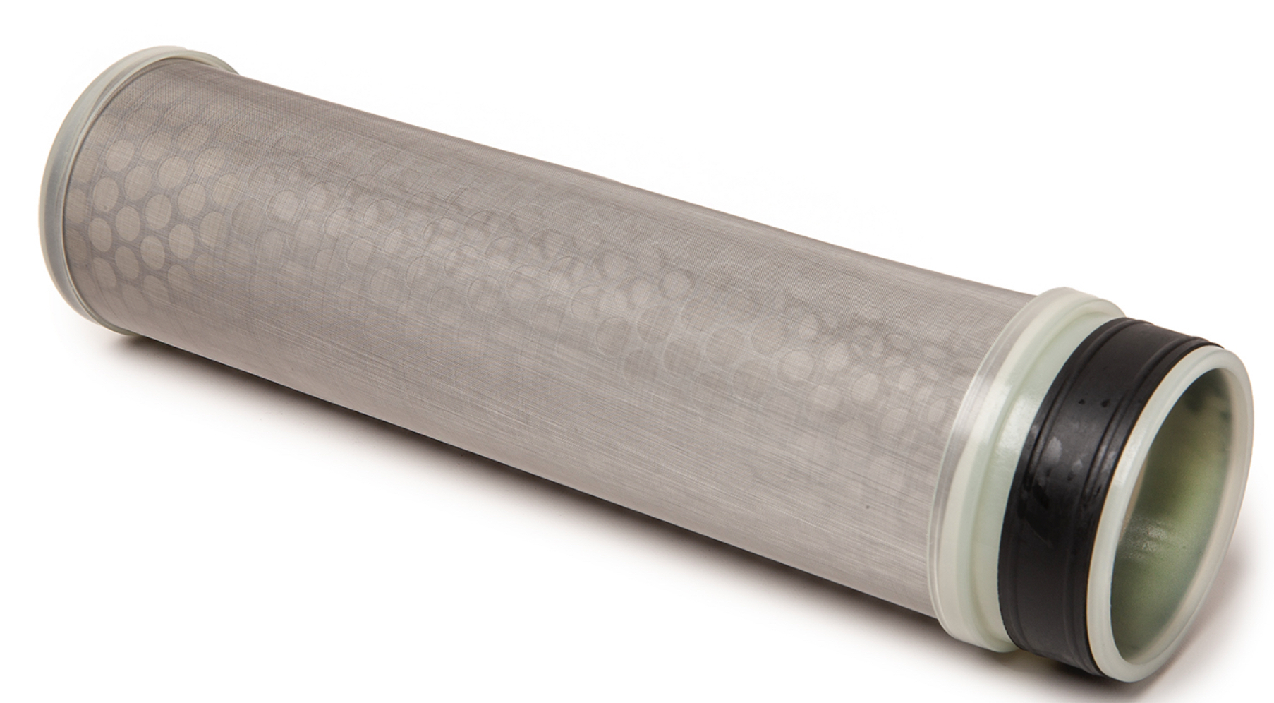

Uno, on the u48 the inner filter is just a thin metal screen. I had never pulled it and was shocked. Most inners are a thick fabric. This thing is a joke. Look at it, it doesnt seem like any kind of life saver.
Perfectly adequate for intended purpose.
For decades, IC engines had little or no intake filtration of any kind.
