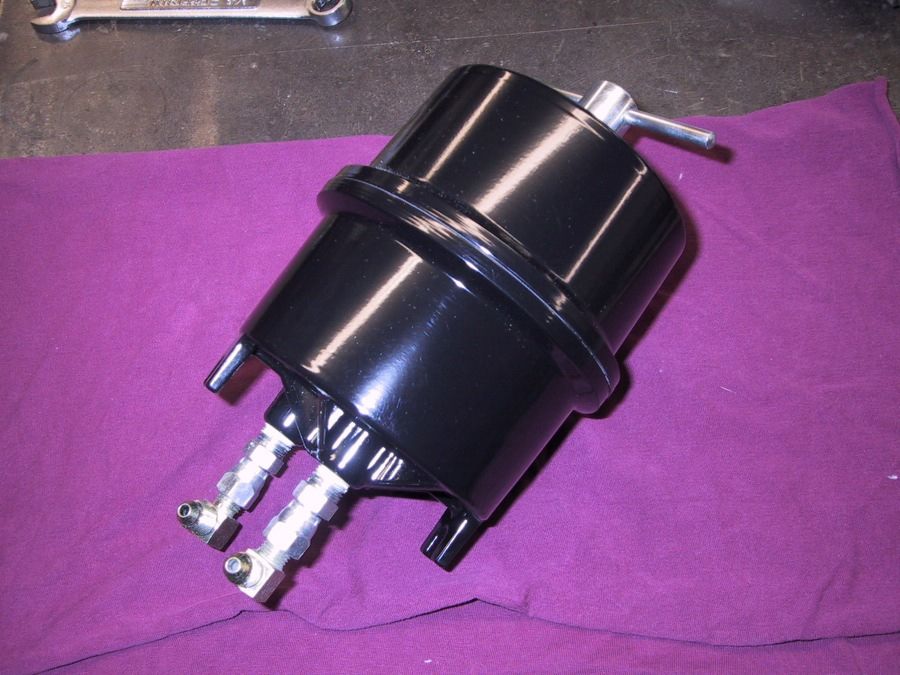

You had an oil centrifuge on the mercedes
Nope - I had a bypass filter - but it wasn't a centrifuge: it was actually a specially modified MotorGuard filter, modd'ed and setup by an old boy from down in Texas, by the name of Ralph Woods.
MotorGuard likes to sell 'em for air filtration these days (alot of folks use 'em on plasma cutters .....), now that the original founders have retired ..... the new management guys don't wanna hear about no steekin' oil filtration ....
It used a single roll of TP (toilet paper) as the filtration medium and flow was restricted by means of an orifice (.0625" IIRC), to ensure that it wasn't starving the engine of oil ....... filtered down to the sub-micron level:

I haven't gotten around to getting the mounting brackets and plumbing for the Spinner fabbed (it requires a 1" ID drain back to the sump/oil pan) - the Sprinter's engine compartment doesn't have alot of extra room, so it's a bit of a challenge .......

The real beauty of the MotorGuard system is how cheap replacement filter media is, and how relatively clean and easy it is to change:
Let the filter drain for 30 minutes or so after the vehicle is shutoff, unscrew the T-handle and swap the media and reassemble - the actual media change takes maybe 5 minutes .... if you are really slow ....

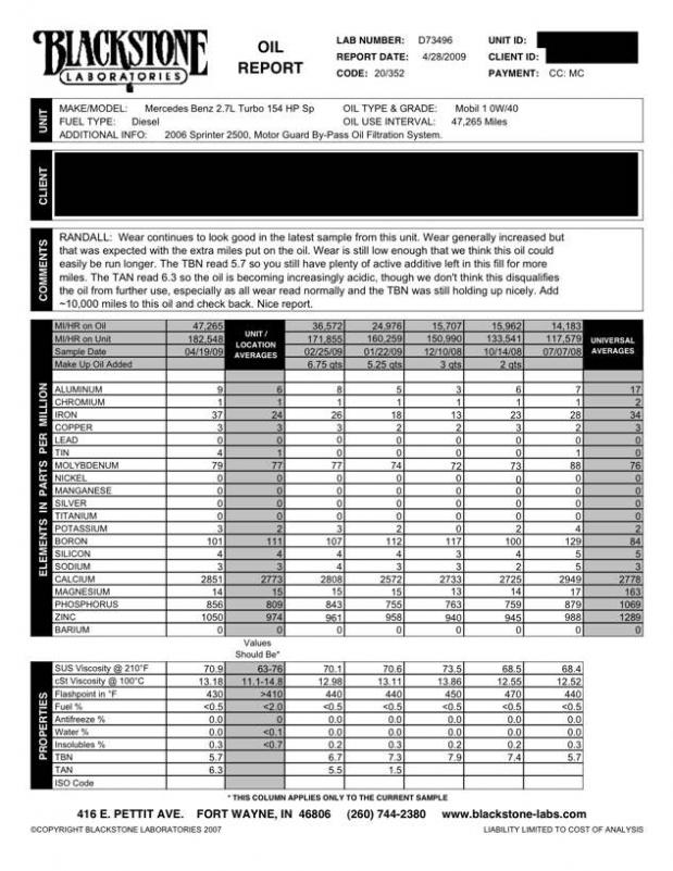

About the first thing we noticed was one day we ran heavy and slow with rain coming down all day, and that evening when we pulled the sticks after supper Mush's truck showed the foamy whitish looking oil you expect in them circumstances, and mine looked just fine. I sorta figured that was cause them rolls of toilet paper was taking the water out of the oil. That was what the brochure said it would do and it sure seemed to.
We also had to draw oil samples every so often and send them off to a lab, had these glass jars with a lid that slipped into a cardboard tube that had a screw on top just like a mayonase jar that was all labelled up so all you needed do was find the postoffice and ship her off. We ran that test for the better part of a year, and every time it came back that Mush had contaminants inhis sample and mine was clean. Only drawback I saw to them filters was having to change the toilet paper. I sure didn't want to be having to walk in no store and ask for 6 rolls of TP for my truck and have people look at me all funny so I got a cardboard box and carried 6 rolls in the sleepercab. I forget where we were this one time but the fellow at the truckstop gave me some mouth about my truck needing to wipe its a** so when he wasn't looking me and Mush went inteh bathroom there and swapped out all their paper for the stuff I pulled out of my filters. I bet that went over real good when some driver was sitting there doing his business and reached for the paper, but we didn't get to see cause we hauled out of there right quick. Another time we got the bright idea to see how one of them used rolls would burn and had us a little campfire right there in the lot. Let me tell you a roll of TP full of oil burns a long time and it burns hot. They did come in handy when we was up north in wintertime, for when youhad to thaw out a frozen air tank. You could jam a used roll into a paint can and carry it in the toolbox, and when you had a froze up tank just stuff a stick inthat roll and use it instead of a roadflare to thaw the tank.
Well after that first year of testing the company had them filter stacks put on just about everything, and they worked out well. I don't think we went to more time between oilchanges though. Also don't ever recall one of those engines needing any rebuild ahead of schedule because of them filters either. The mechanic in the shop saved the used TP and burned it in this woodstove he had in the shop to stay warm with. He figured they worked better than busted up pallets, and you could use em to get a fire started too.
/ Air Filters?? #36
Real results but I don't know what they mean!:confused2::ashamed:
Trying giving the following link a read and see if it makes more sense:
Report Explanation
You can hold your cursor over various items on the report and it will give an explanation of what it is.
One thing to keep in mind when looking at a UOA (used oil analysis) is that in terms of wear metals, you mostly are looking for trends (somewhat opposed to a single number or value ....)
