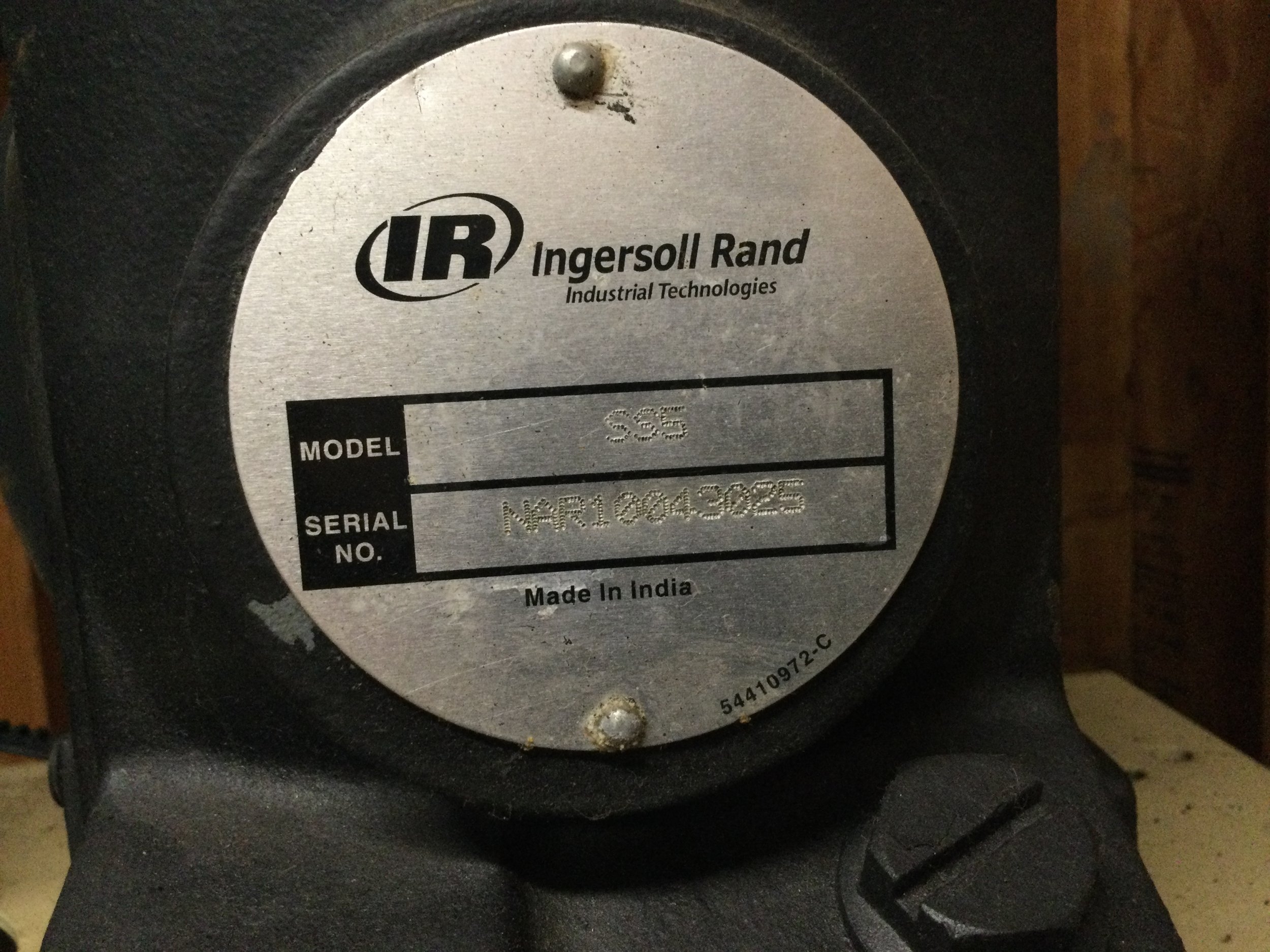

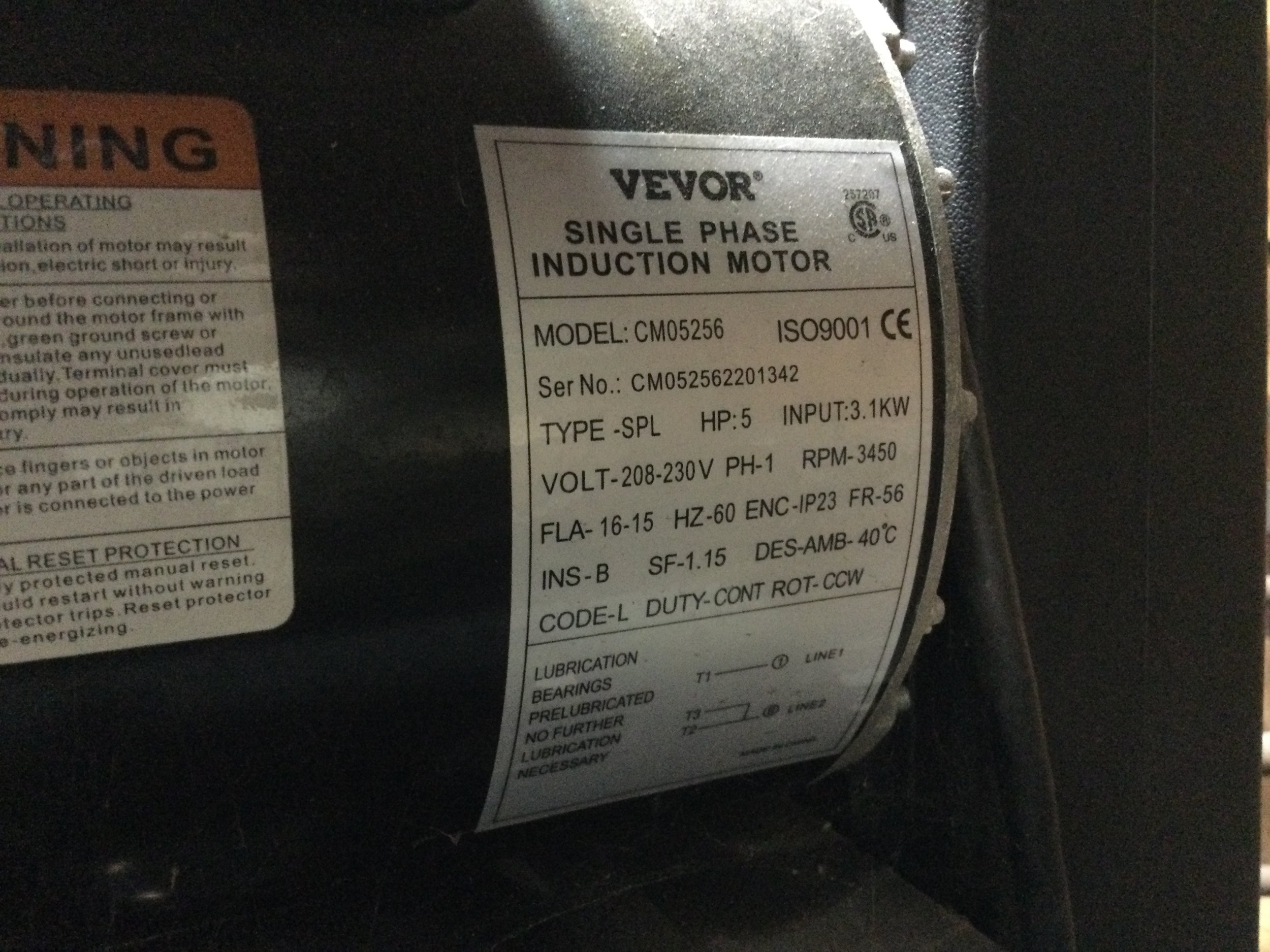

One is an 80 gal with an SS5 compressor and 6hp motor, 0-130psi in 7min 16 sec.

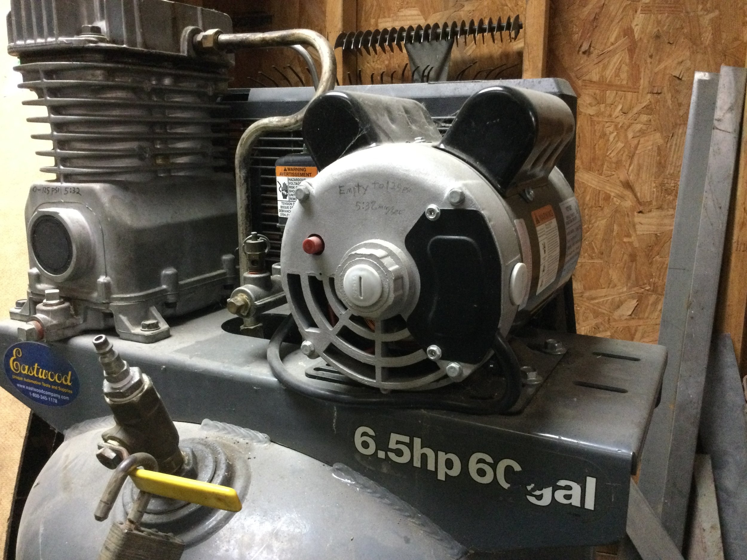

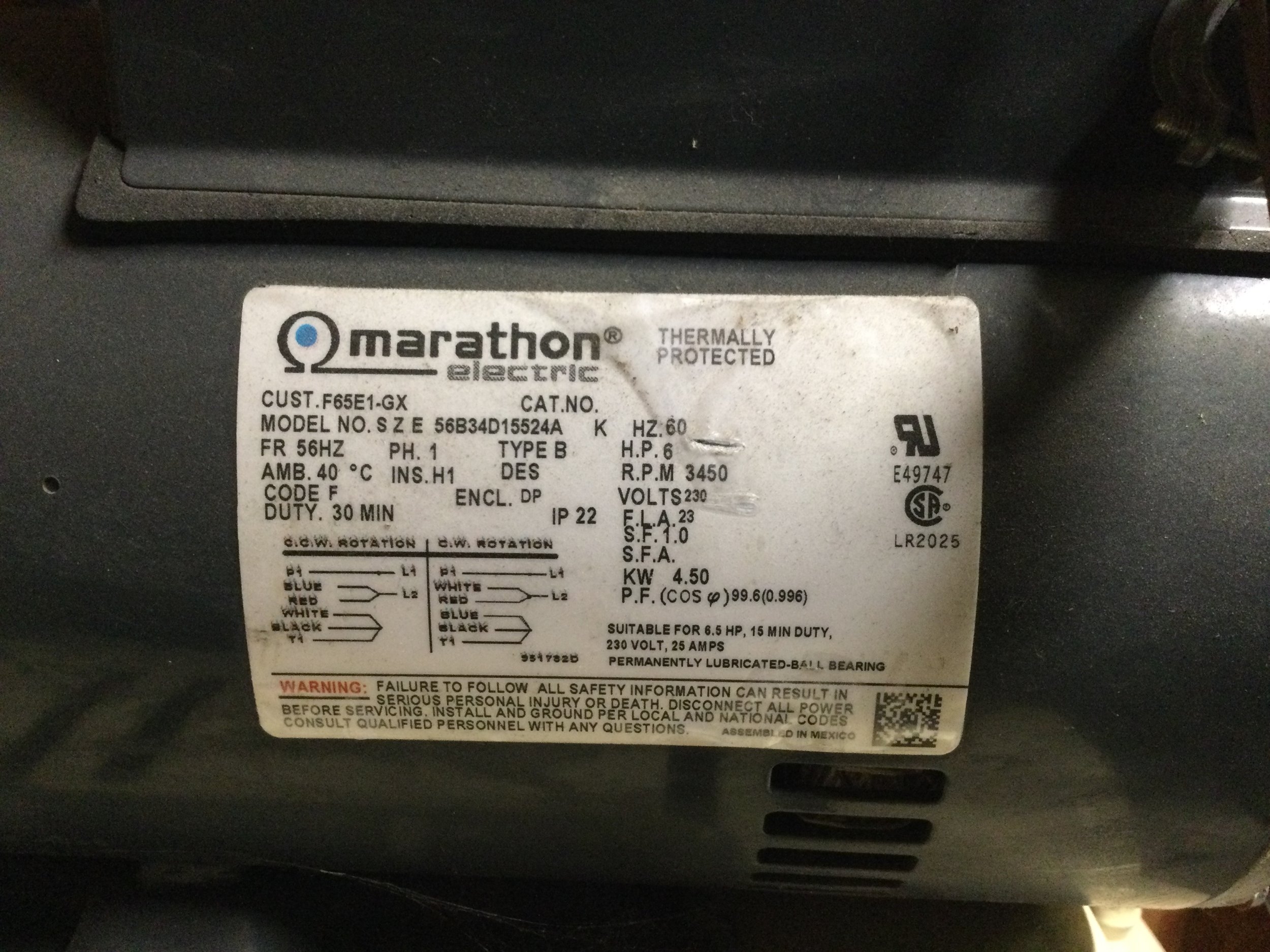

Next is a 60 gal SS aluminum twin with a 5hp motor, 0-125psi in 5min 32 sec

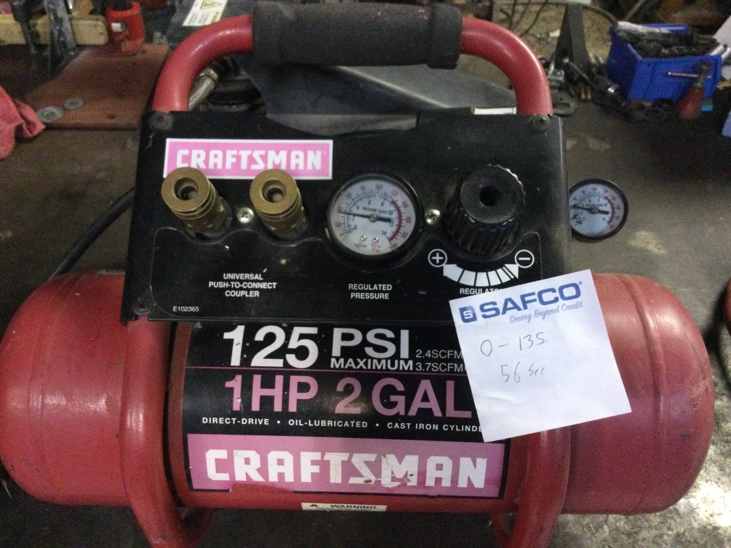

A little 2 gal 1hp, 0-135psi in 56 seconds. Might need to adjust that regulator if that gauge is correct.
Next is a 60 gal SS aluminum twin with a 5hp motor, 0-125psi in 5min 32 secView attachment 848314

Is that the original motor on the Ingersoll?
I find it odd that it is not showing a continous duty motor and looking lists 30 minutes.?

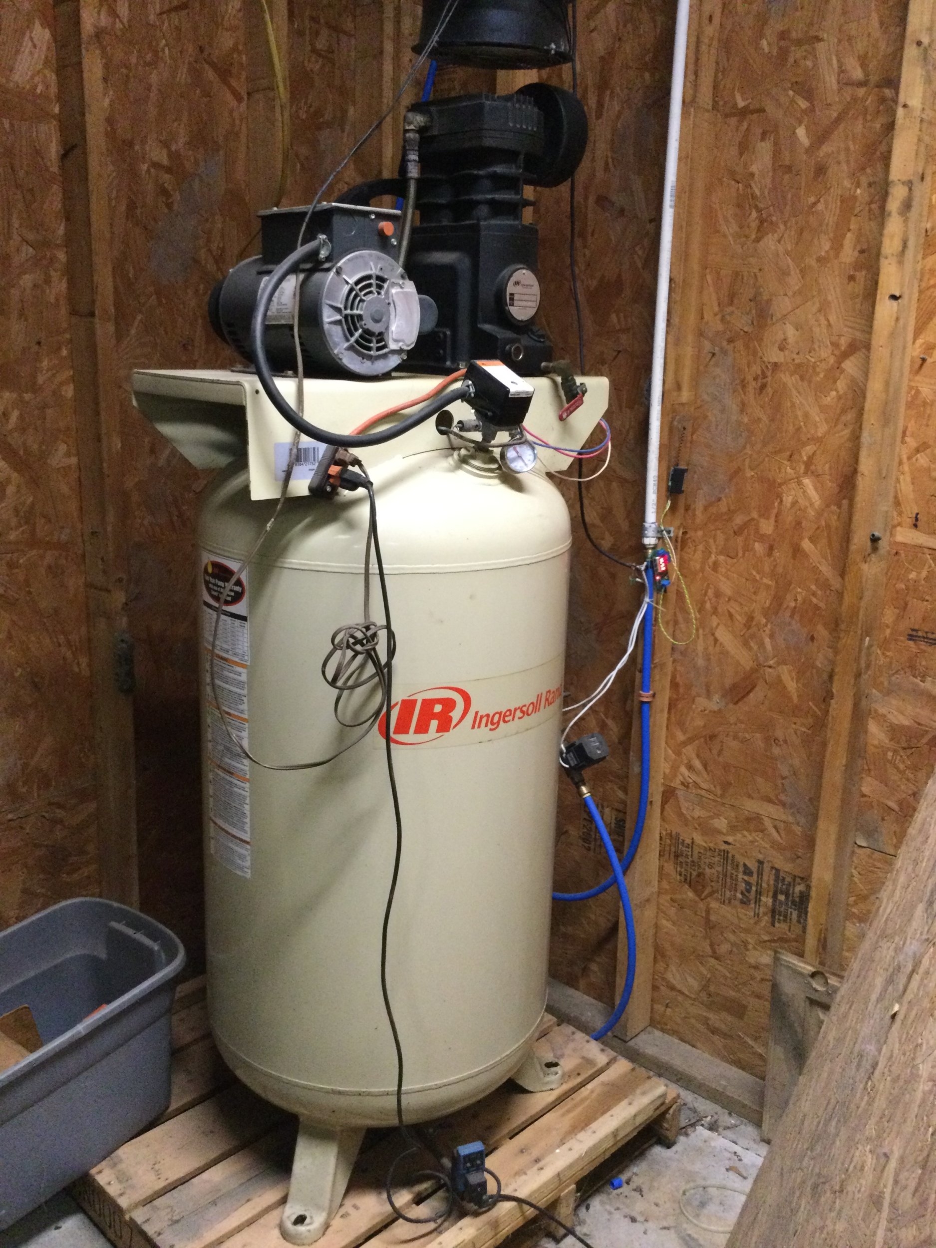

I will run my Ingersoll 60 gallon and my new Black Diamond 80 gallon empty to full and post the numbers

Dang, I didn't know IR's were made in India... Glad I don't have one. My 30 year old Quincy QP was made here and so was my Sullaire Screw compressor I keep as a standby.

Checked the old Ingersoll 60 gallon 5HP and it pumped up to 125 psi in 7:07 but it spins the single stage pump much faster than the 2 stage. Still not bad for a near 40 year old aircompressor that has sanded and painted cars, trucks, skid steers, tractors, trailers, and even a 12 yard dump truck.
