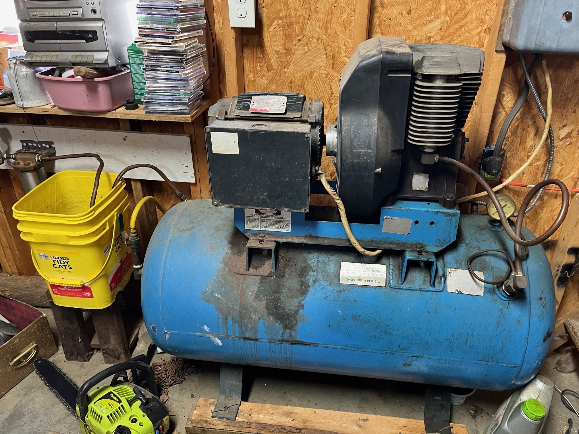

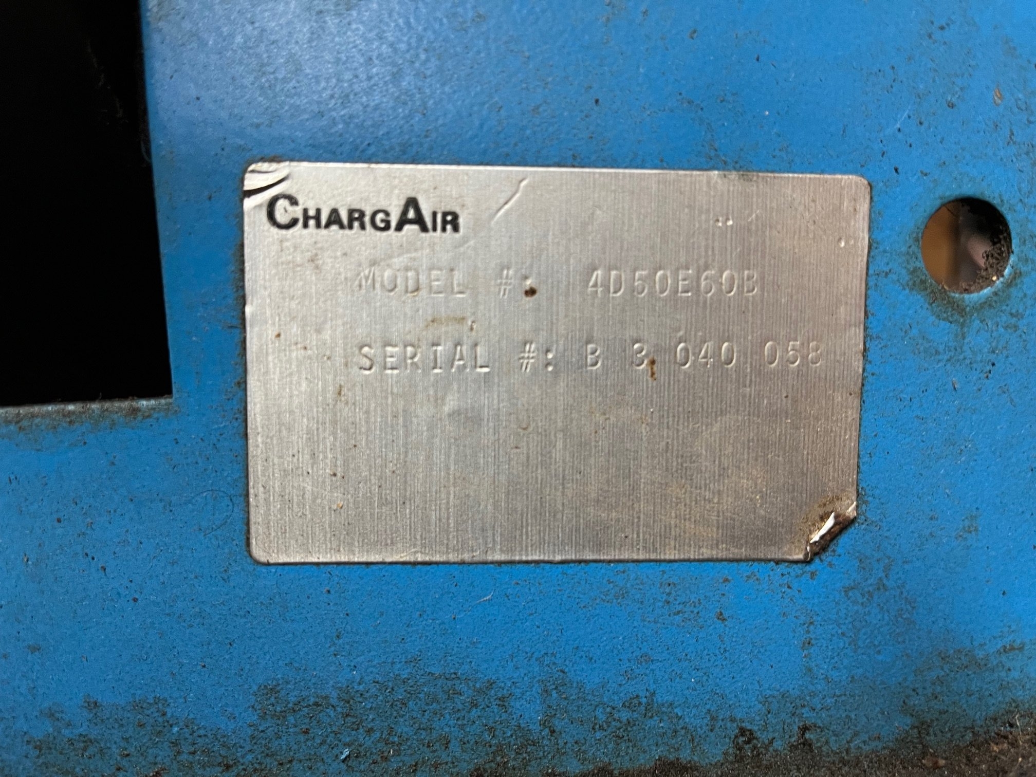

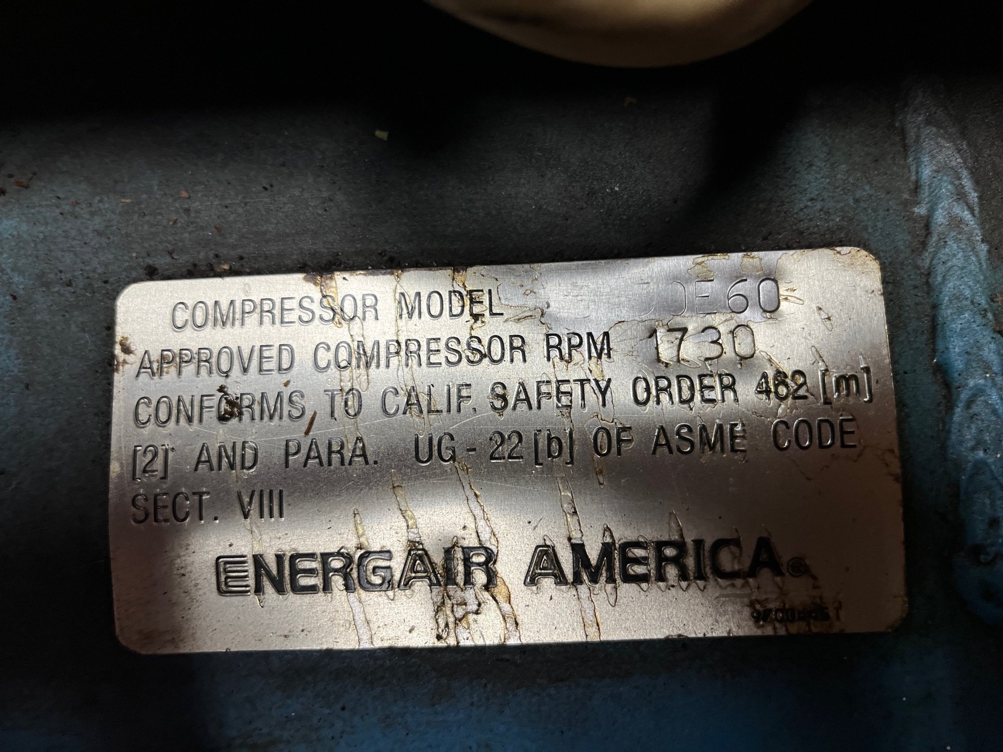

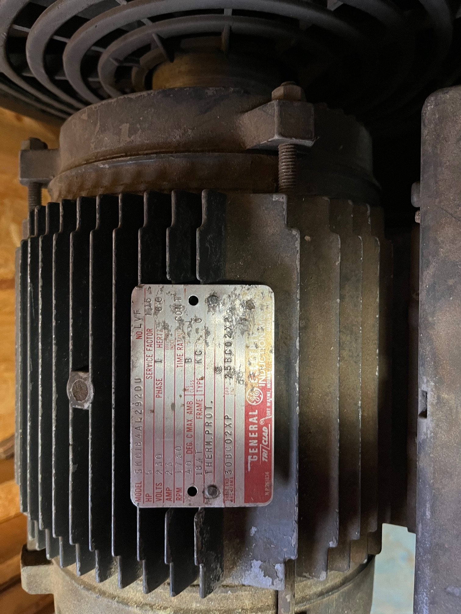

This got me thinking again about my 60 gallon compressor, a ChargAir 1 bought used 38 years ago. The 5 HP GE Tri-Clad motor had a faulty centrifugal switch which I replaced and has been fine ever since. It's a bit different in that it is a direct drive rated for 1730 RPM rather than a belt drive. I remember after I got it (in 1987) the Ingersall Rand representative had a hard time finding an exact manual for it and was only able to supply a similar model manual. I'm just a hobby guy and don't use it often. Anyone know when it was manufactured by the serial #?
Edit: Just found the tank plate and it's dated 1983, rated for 200 PSI WP.
