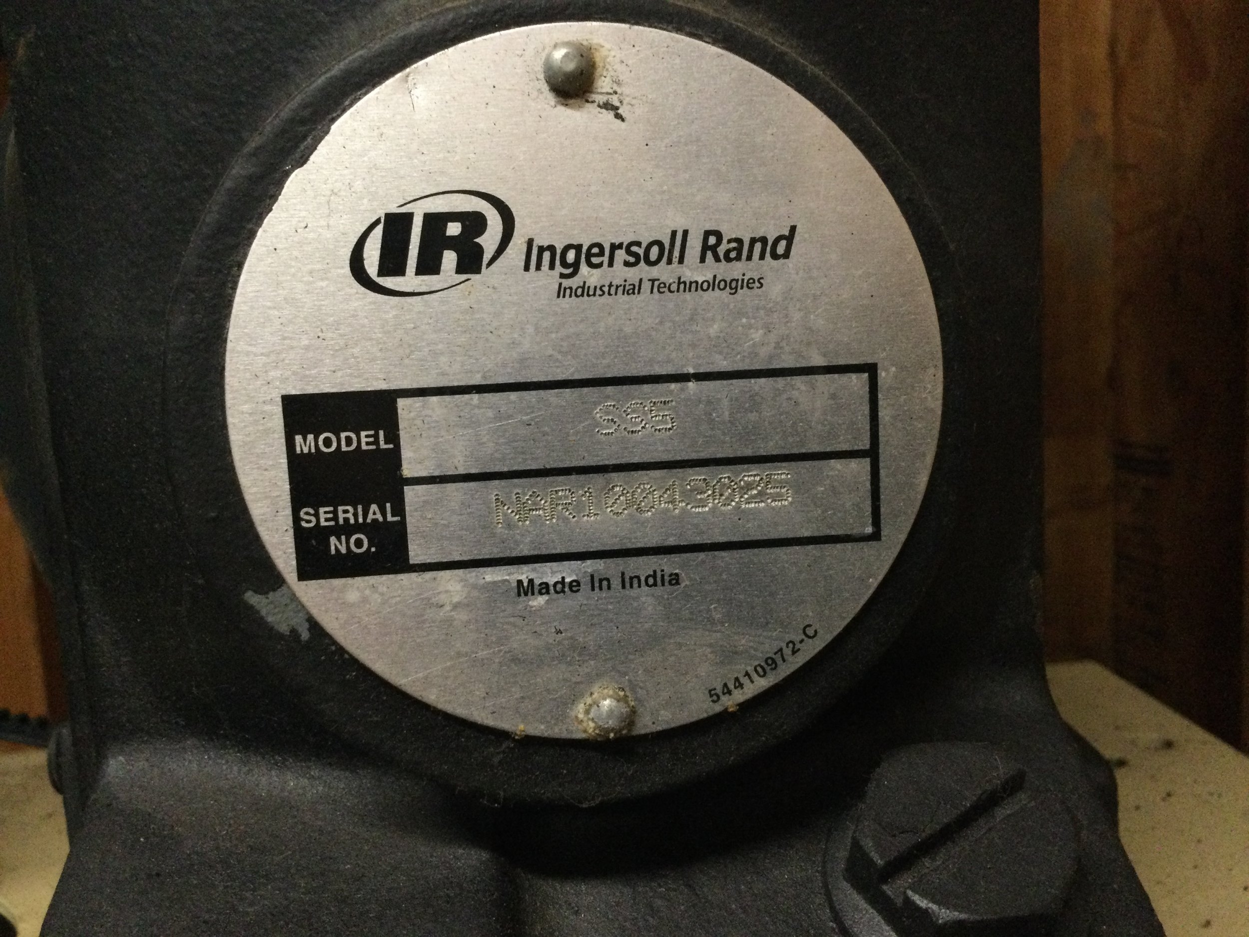

I was quite taken back when I found out that IR compressor heads were made in India, but then Cummins blocks are cast there as well.

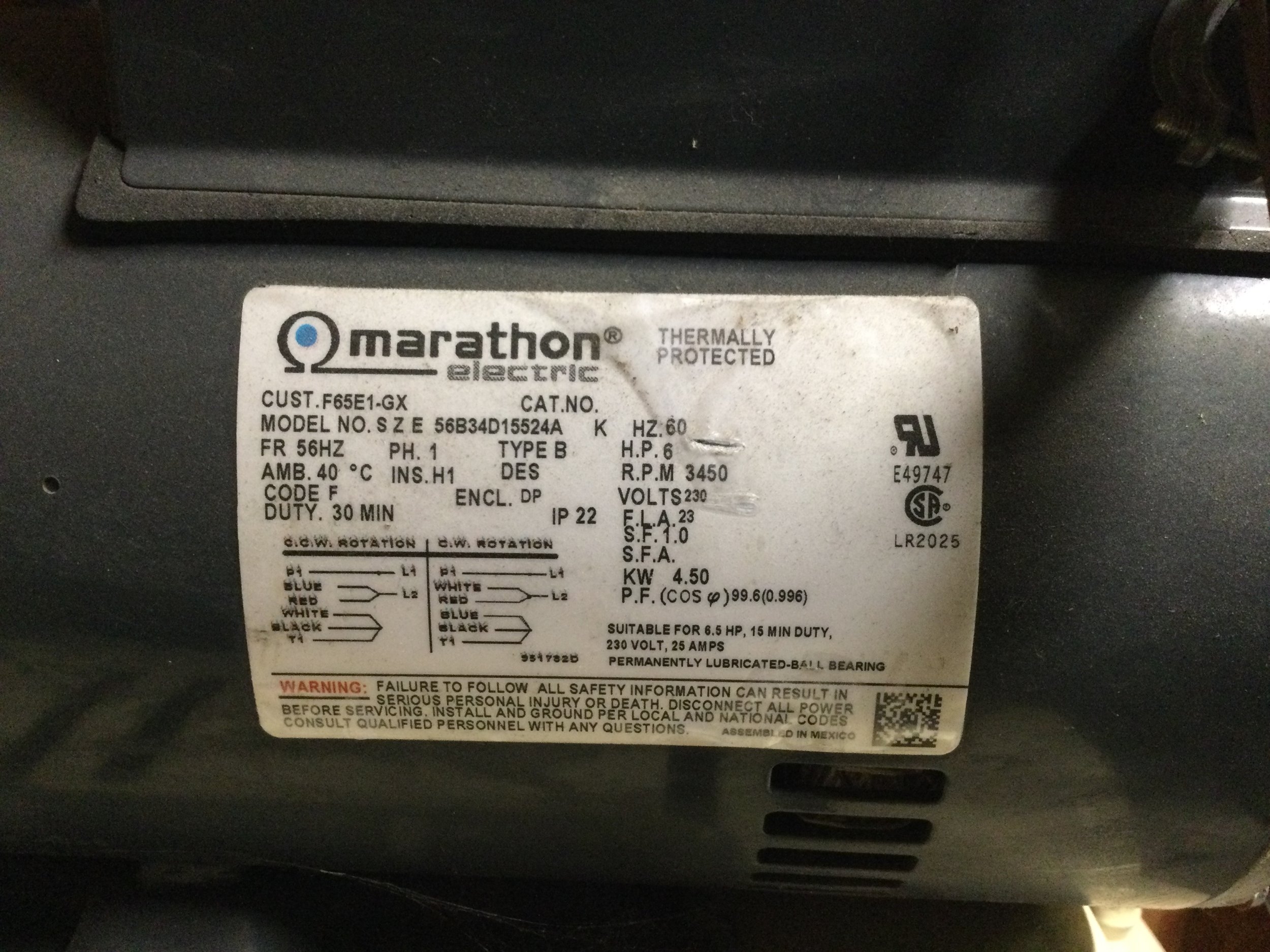

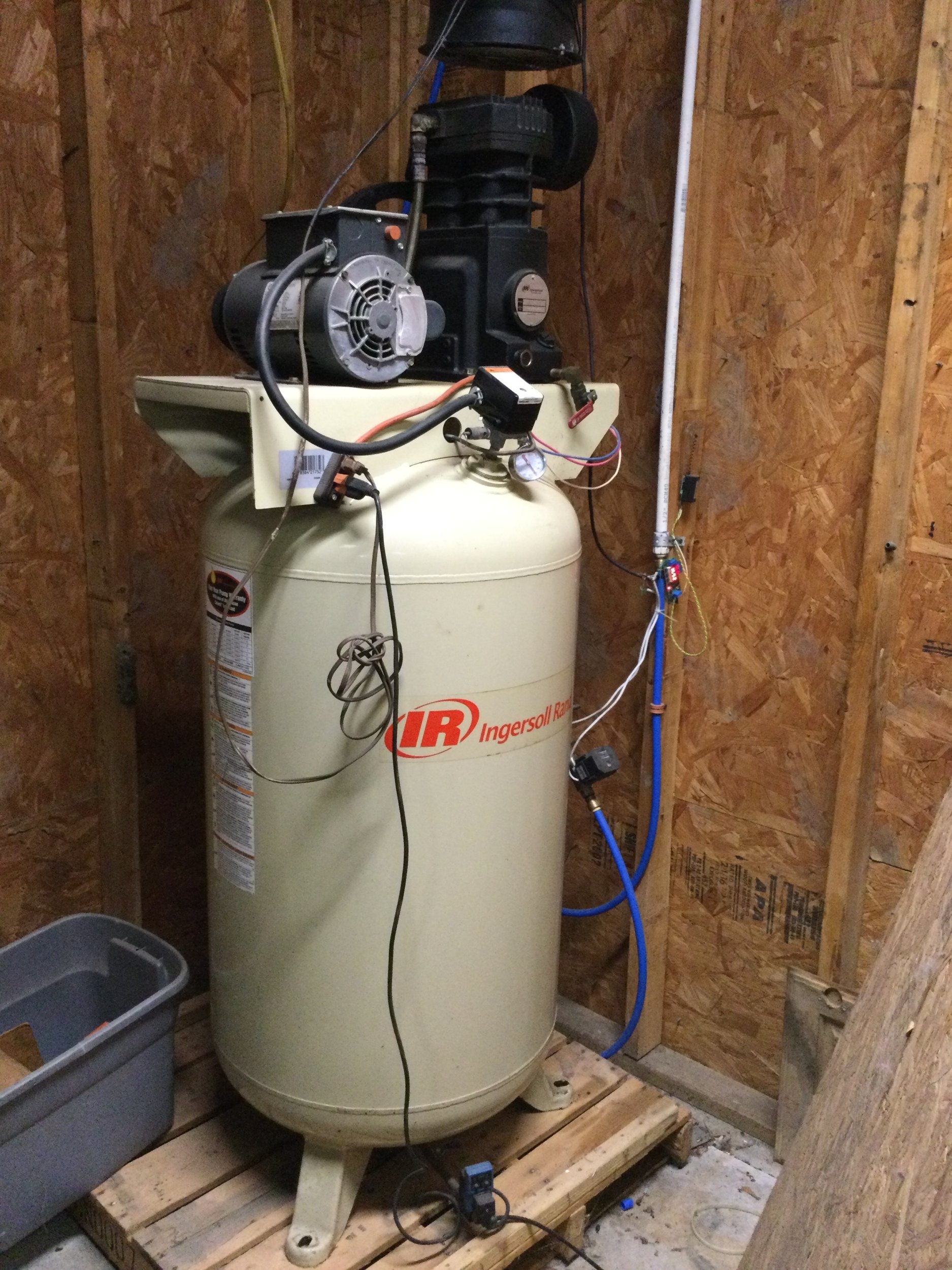

One is an 80 gal with an SS5 compressor and 6hp motor, 0-130psi in 7min 16 sec.

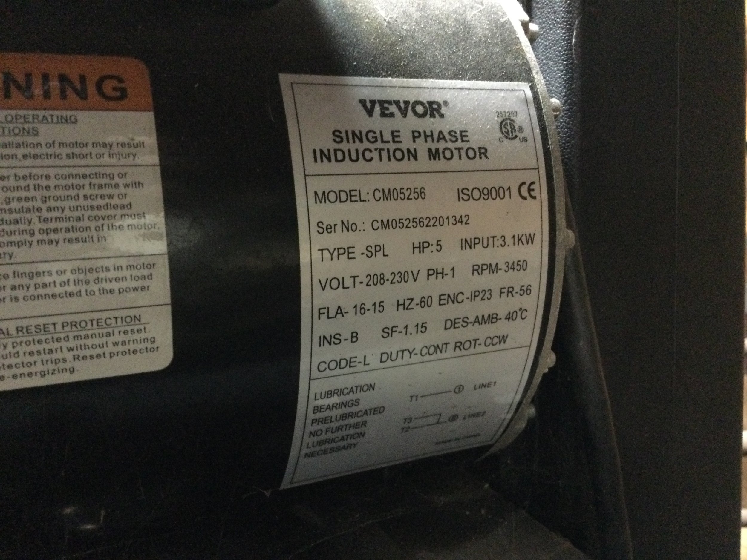

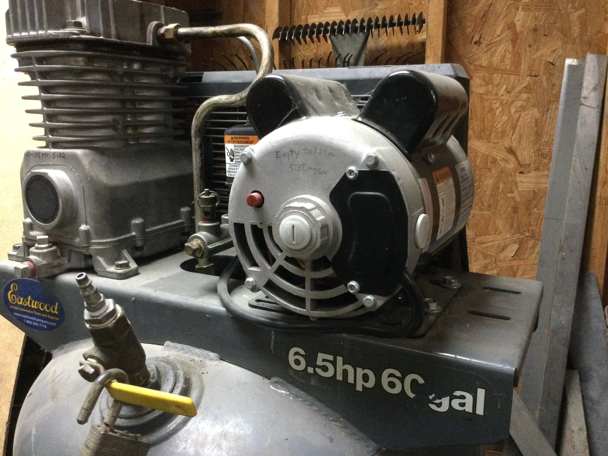

Next is a 60 gal SS aluminum twin with a 5hp motor, 0-125psi in 5min 32 secView attachment 848314

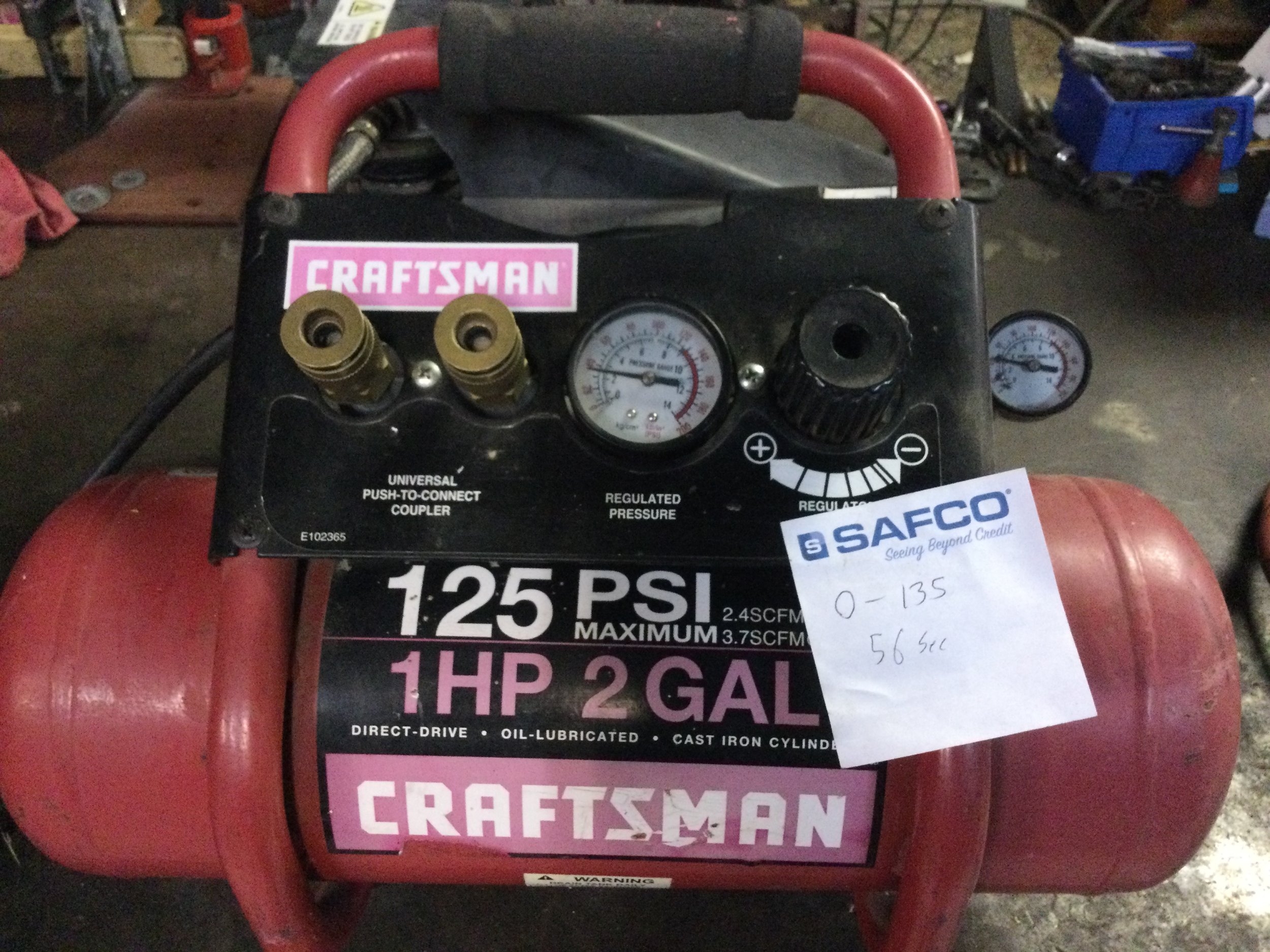

A little 2 gal 1hp, 0-135psi in 56 seconds. Might need to adjust that regulator if that gauge is correct.
