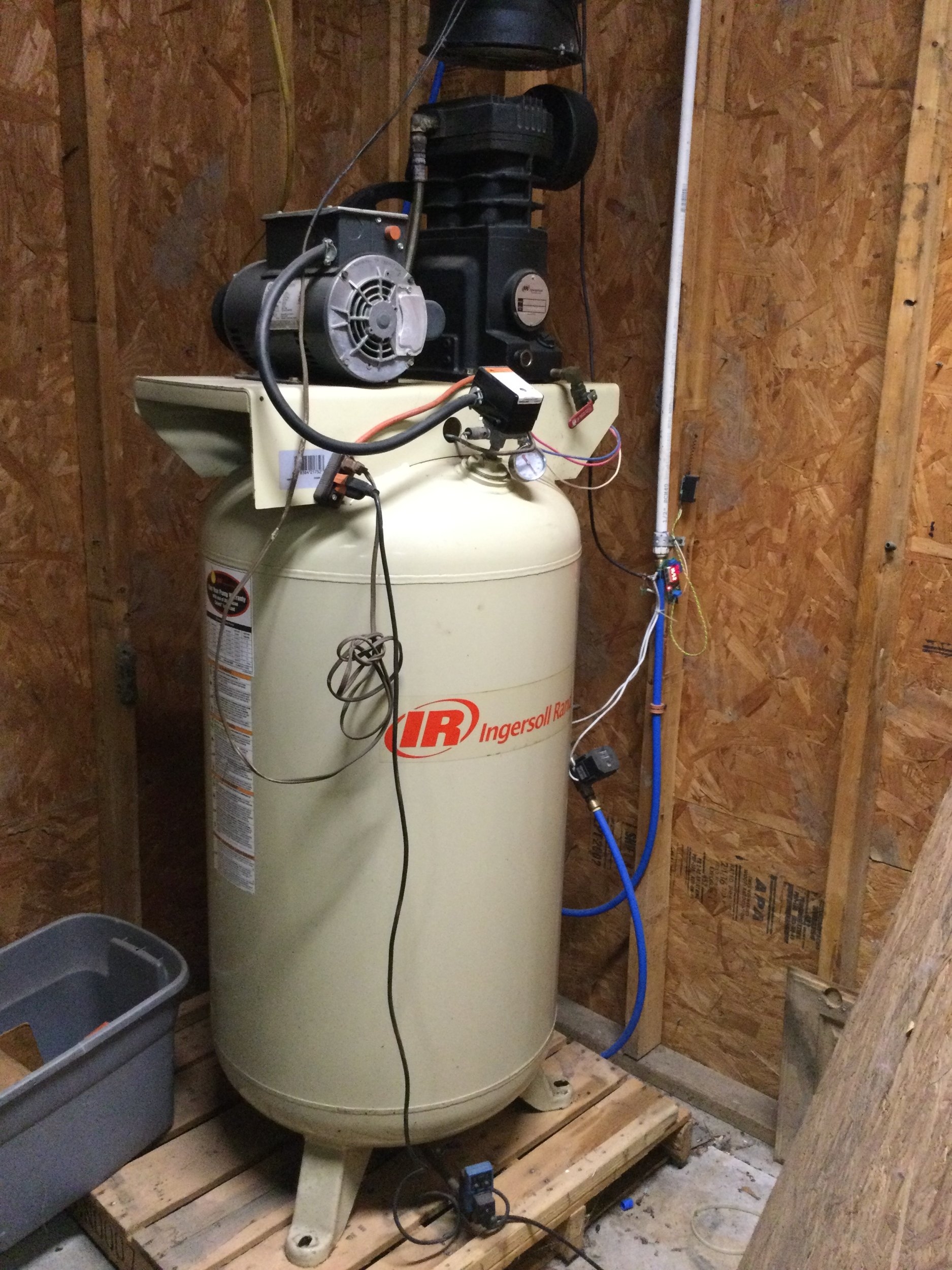

I have a number of older compressors and wished I had wrote down how long they ran, to fill from empty. So I could see how well they were still doing.
Thought maybe others had the same thought at some point and numbers could be collected and shared.

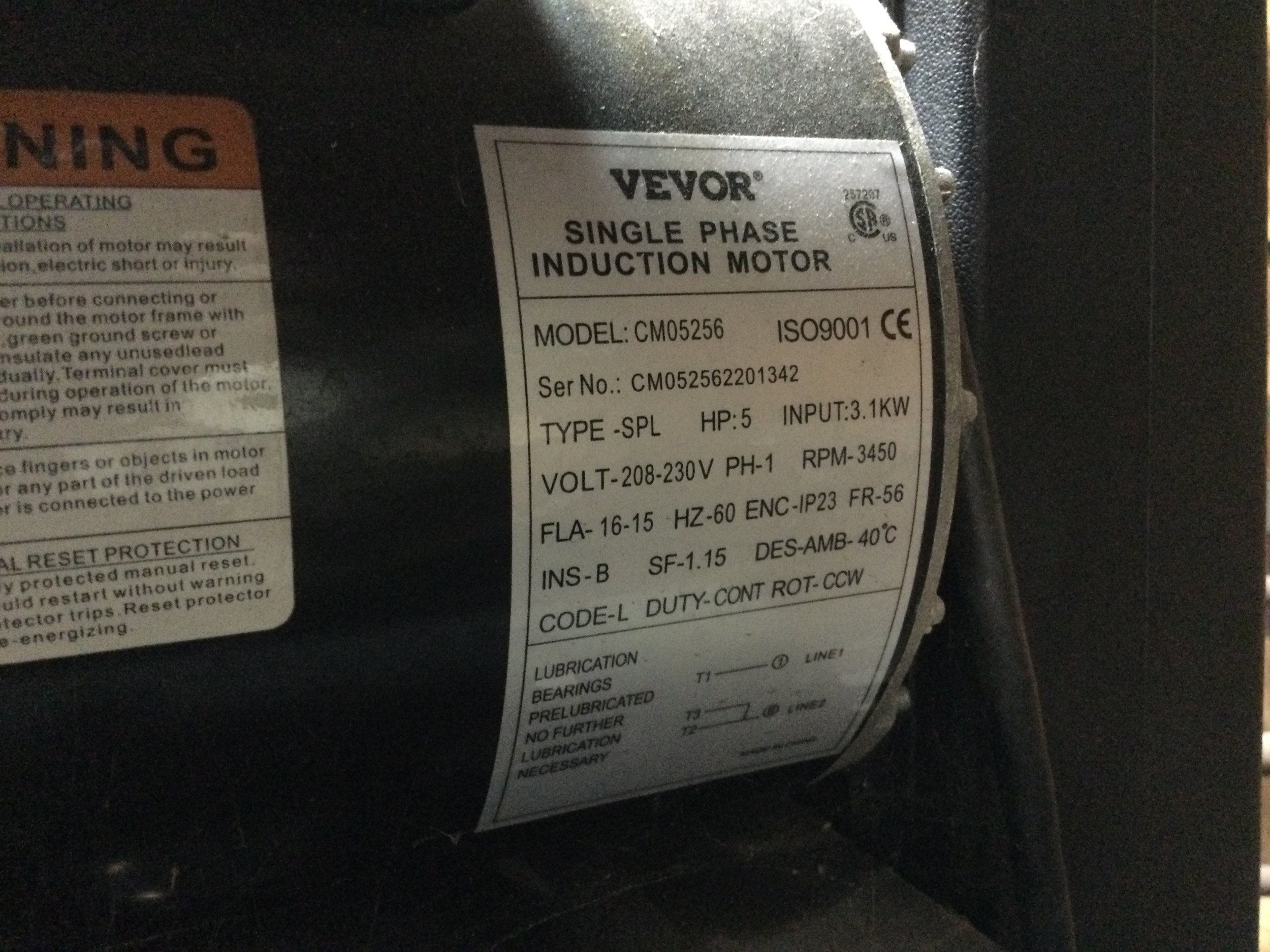

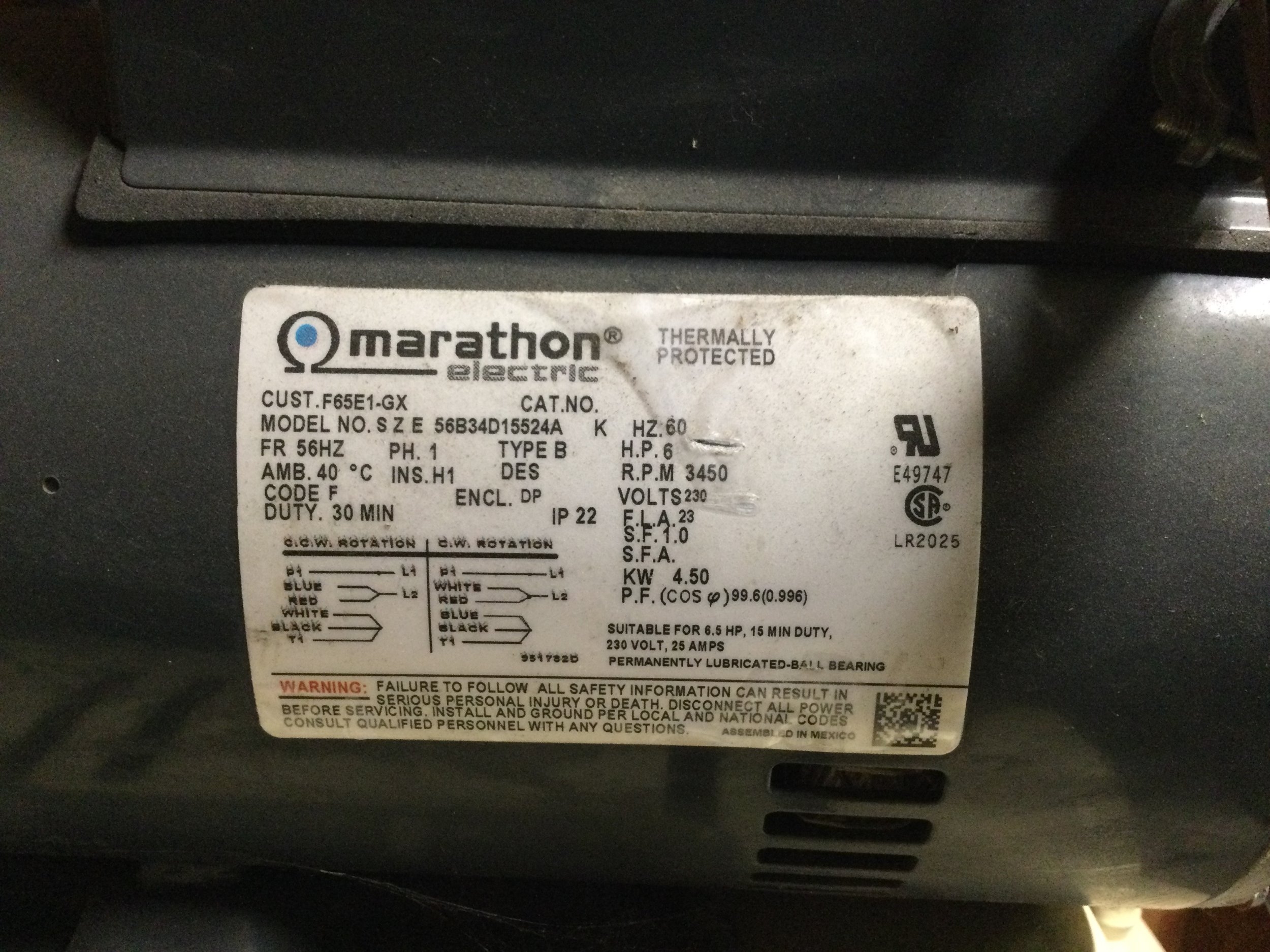

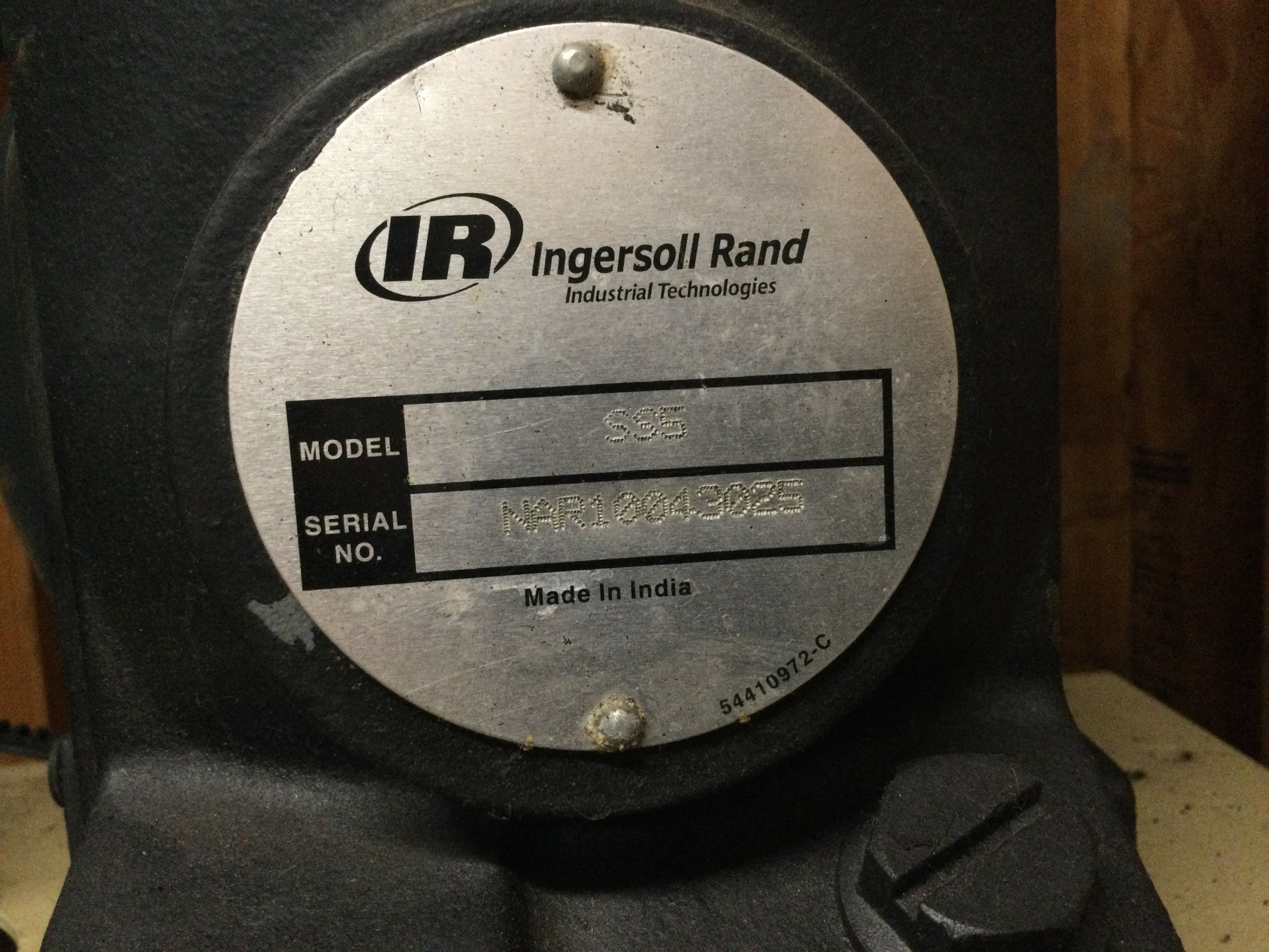

One is an 80 gal with an SS5 compressor and 6hp motor, 0-130psi in 7min 16 sec.
Next is a 60 gal SS aluminum twin with a 5hp motor, 0-125psi in 5min 32 secView attachment 848314

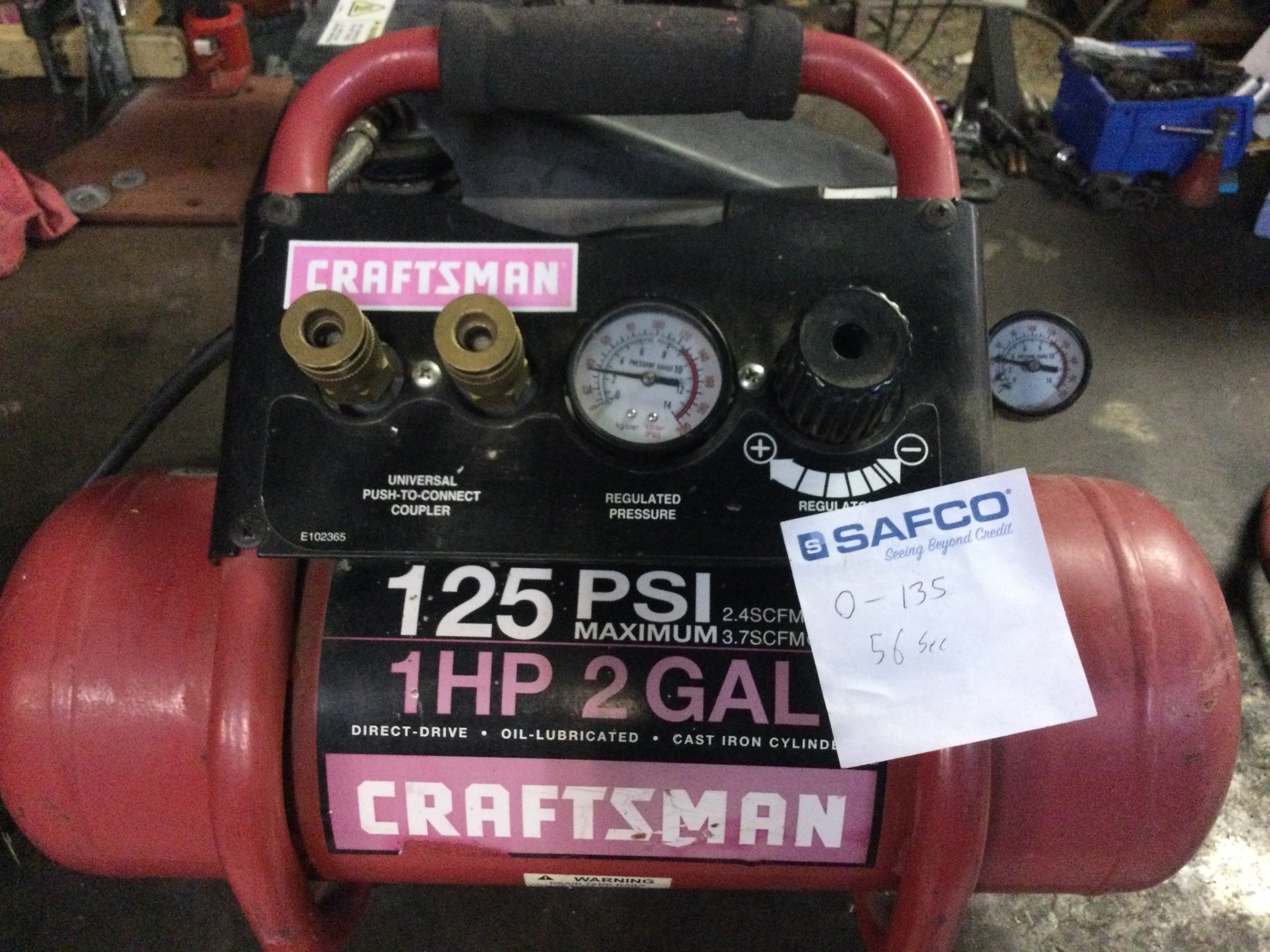

A little 2 gal 1hp, 0-135psi in 56 seconds. Might need to adjust that regulator if that gauge is correct.
