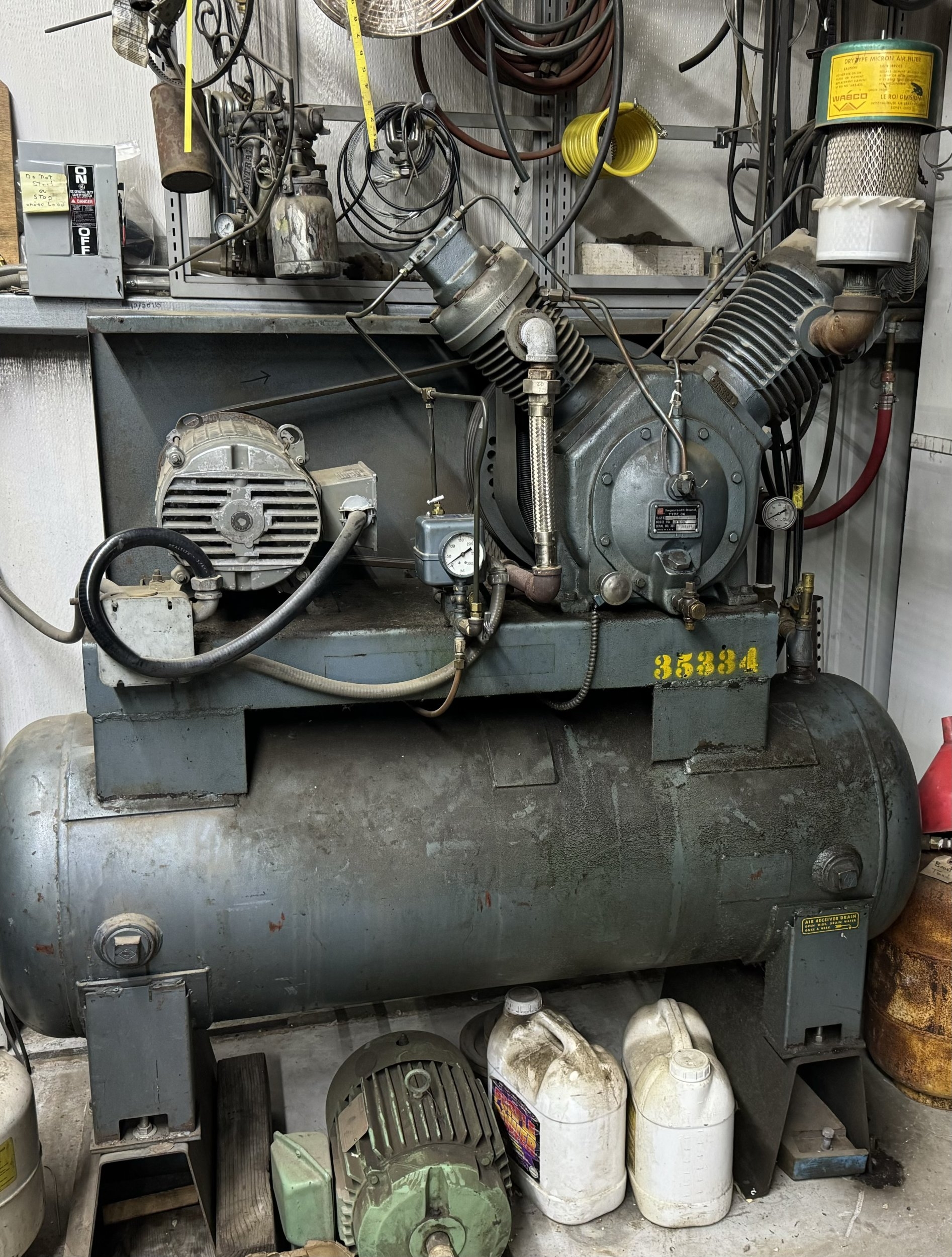

Ingersoll Rand 80 gallon type T30 v2. Was 10 hp 240v 3ph changed to 200/208v 15hp & increased motor pulley by 1/4 inch.
Zero ~ 200psi +- 171 seconds hot.
Replaced original air filter with an old air filter from my 1720 Ford tractor. Made a noticeable reduction in pump up time unfortunately I threw old filter out so no real numbers available🙁
Date on tank is 1967 rated for 200psi @ 650 degrees.
