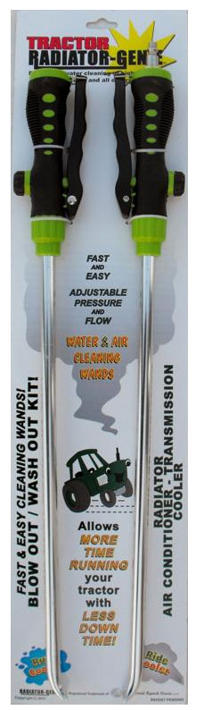

That should work as well as any of the others I have seen. I would get the 24" one in-case you need to stretch a little to reach the target. 12" seams short and 36" is too long for me. Remember, as oosik said, lower the preassure. 30 psi works for me.
I use the radiator genie with air and water wands.
Radiator Genie - Water & Air Cleaning Wands for High Efficiency Cooling Systems and Radiators - Blow Out / Wash Out Kit - - Amazon.com

I have this same kit. Works great.
