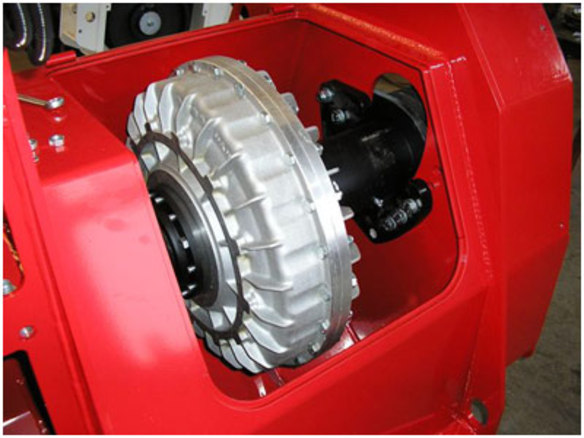

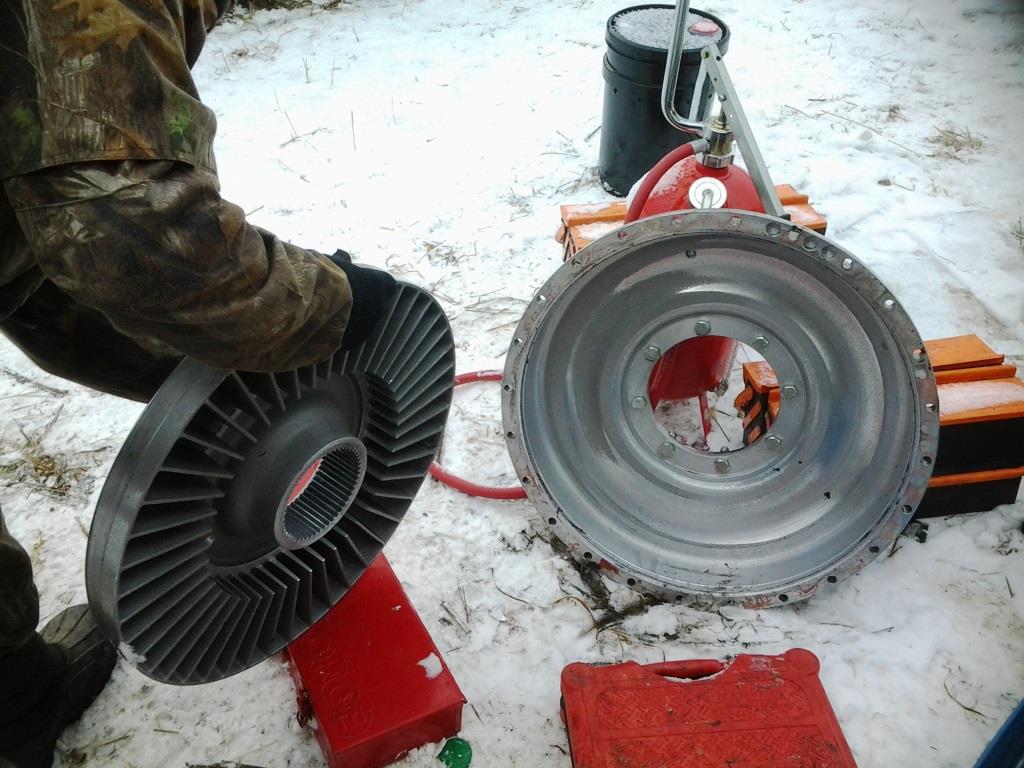

On pictiure is turboclutch from AHWI RT 400.
If you broke the seal on it in the woods at a temperature of - 27,do not worry-everything can be repaired))
/ AHWI RT 400 #12
Is this the pto turbo clutch housing ? Would like to adapt that to our fecon bh 120 on our valtra
/ AHWI RT 400
#13
Marek,write me the model of your Valtra.And correct me if I'm wrong,but bh 120 hydraulic hitch(mulcher)?Will have to remake almost everything to install Turboclutch.I think you will be cheaper to buy a hitch(mulcher) with PTO,than to do bh 120.

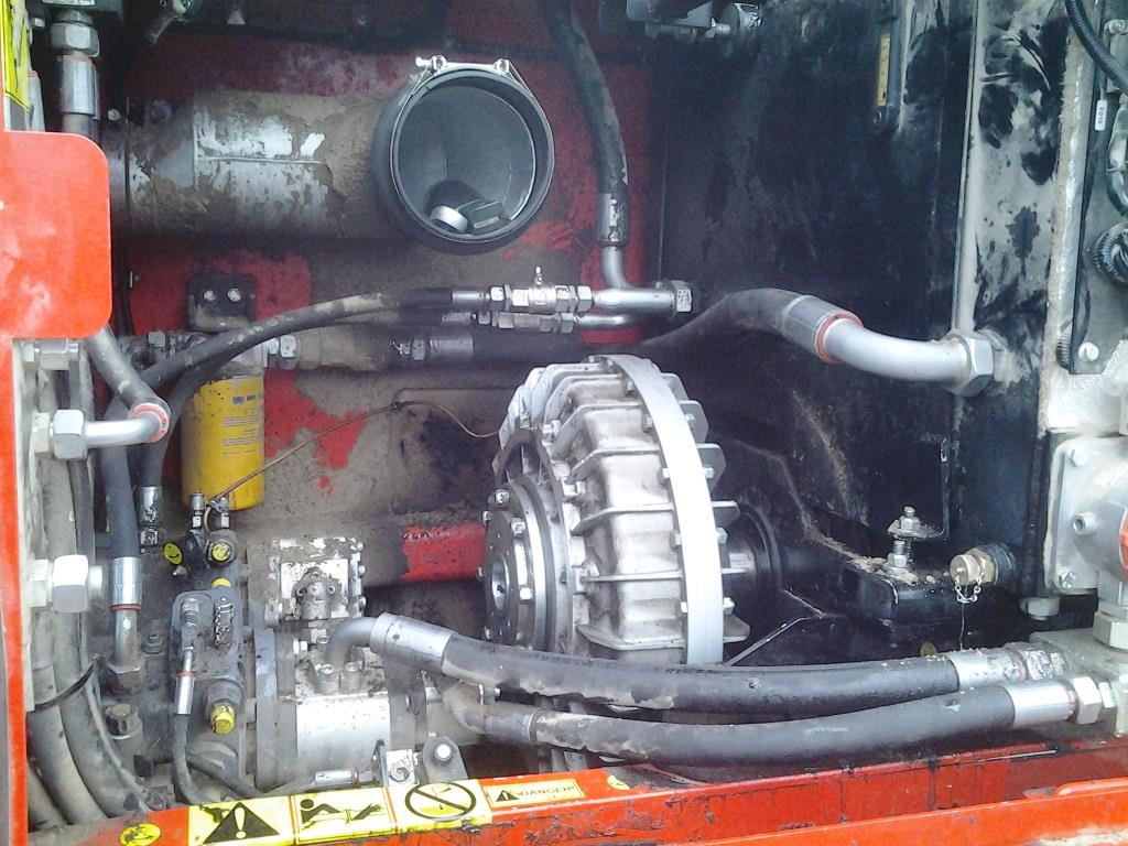

At AHWI RT 400 Turboclutch is in the engine compartment,between engine and main module.That is placed on the tractor as in AHWI Raptor 300 and AHWI Raptor 800.
In your case,you will have to put two(2) Turboclutch in the cutter,one on each side!,gearbox,cardans,the bearing assemblies,and the hydraulic pump with motor for oil cooling in gearbox.
Will do, let me know,I'll help!

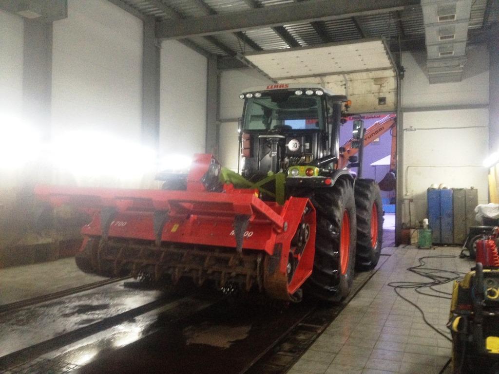

#14
Hi.Recently hung the cutter head from AHWI RT 400 with turbo clutch on Claas Xerion 3300 TRAC VC.I'm not a big fan of wheeled vehicles(tractors),but this monster made me happy))
AHWI M 700 the width of the rotor 2300 мм.
https://www.youtube.com/watch?v=3XyV6PE0DNk
Excellent work in agricultural fields to clear of shrubs.You are deepened into the ground or soil to 7 cm!
Cutter head AHWI 700-2300 M attached Plug and Play on any tractor with three-point CAT 3 or CAT 4.

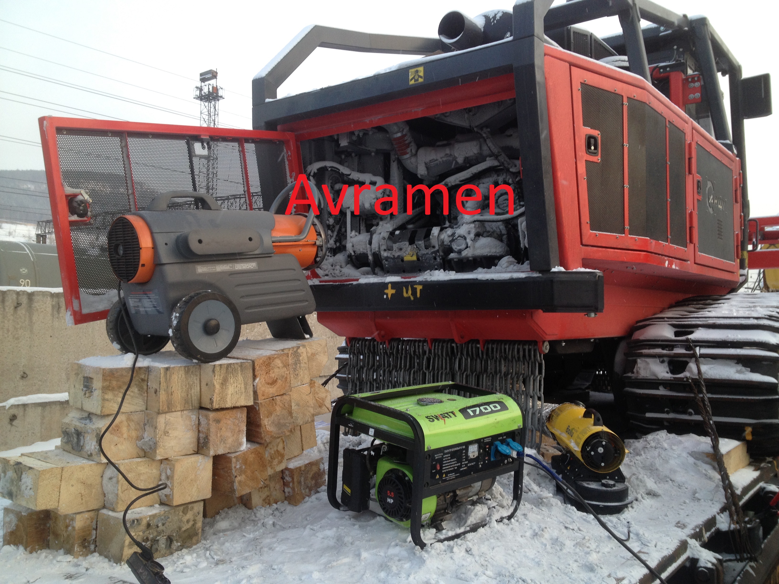

In the next post I will tell you how warm up the mulcher if the temperature outside is -43!!!

#17
Hello.
As promised, photos of the frozen tractor,mulcher AHWI RT 400.
Warm with gun for 4 hours.Change the diesel,diesel separator filter and started the tractor!Thats all,boring))
