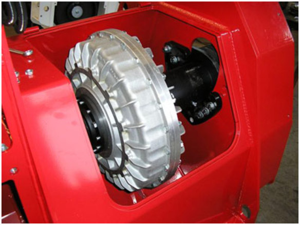

On pictiure is turboclutch from AHWI RT 400.
If you broke the seal on it in the woods at a temperature of - 27,do not worry-everything can be repaired))

Is this the pto turbo clutch housing ? Would like to adapt that to our fecon bh 120 on our valtra
Marek,write me the model of your Valtra.And correct me if I'm wrong,but bh 120 hydraulic hitch(mulcher)?Will have to remake almost everything to install Turboclutch.I think you will be cheaper to buy a hitch(mulcher) with PTO,than to do bh 120.
At AHWI RT 400 Turboclutch is in the engine compartment,between engine and main module.That is placed on the tractor as in AHWI Raptor 300 and AHWI Raptor 800.
In your case,you will have to put two(2) Turboclutch in the cutter,one on each side!,gearbox,cardans,the bearing assemblies,and the hydraulic pump with motor for oil cooling in gearbox.
