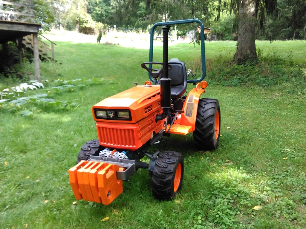

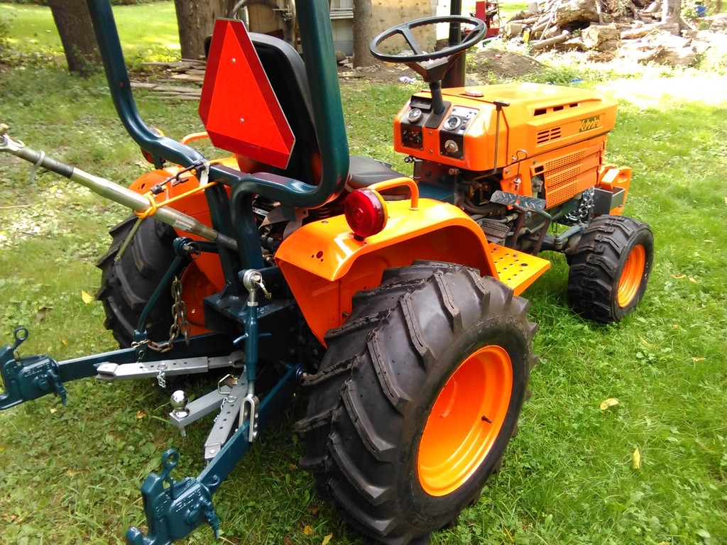

I just put new tires on my B6200. I'm in the woods a lot and back field so I went with bar lugs on the rear and R4s on the front. I grooved them for extra traction.

Out of curiosity, did you calculate the circumference of the new tires and try to keep the front to rear ratio the save as the OEM configuration? Also, what type of tires did you have originally, and did you have to buy new rims?

The rears are Carlisle Tru-Powers and the fronts are Titan R4s. They replaced turfs that had some dry rot. The rears are 29x12.5x15 - standard circumference the fronts are 20x8x10 vs the stock 20.5x8x10 - well within the .02% RC difference allowed and no binding whatsoever. The rears are 6 ply the fronts 4 and are way heavier duty than the turfs that came off so yes same wheels as turfs. I'm going to fill the rears with Citrastar 50 for an increase of 150lbs per side. Hope this helps.

With that combination, in 4WD, your gonna bind up and eat up gears. Slippage and gear ratios are mismatched with two different tread patterns. Why do you think manufacturers never do it?
Good luck in the long run. Your will need it. Also, you might wanna search mismatched tread patterns on 4WD. Your will not like what you find out. Doesn't matter if it is a tractor or 4WD truck. They all will bind up.

Tractor 4wd is set up with binding by design, with 2 to 7 % over speed on the front axle. Seems crazy but check your service manual, its in mine with a procedure to calculate how much over speed you would get with different tire sizes.
Tractor 4wd is set up that way so the tractor will turn when the front has to travel farther than the back, if the tires have the same ground speed the fronts will just get skidded sideways as they would be under speed in a corner and get pushed along.
I notice it now more with my tractor as the fronts have worn down a bit, that they do spin a little when in 4wd going straight.

Actually the tires sizes are the same. They are listed as 20x8-10, but specs say diameter is 20.5" and they measure the same as the turfs that came off. I found a bar lug that is a better match for the TruPowers by Kenda. If I experience anything out of the ordinary I'll buy those and sell these. The grooving helps with traction - so far so good.
