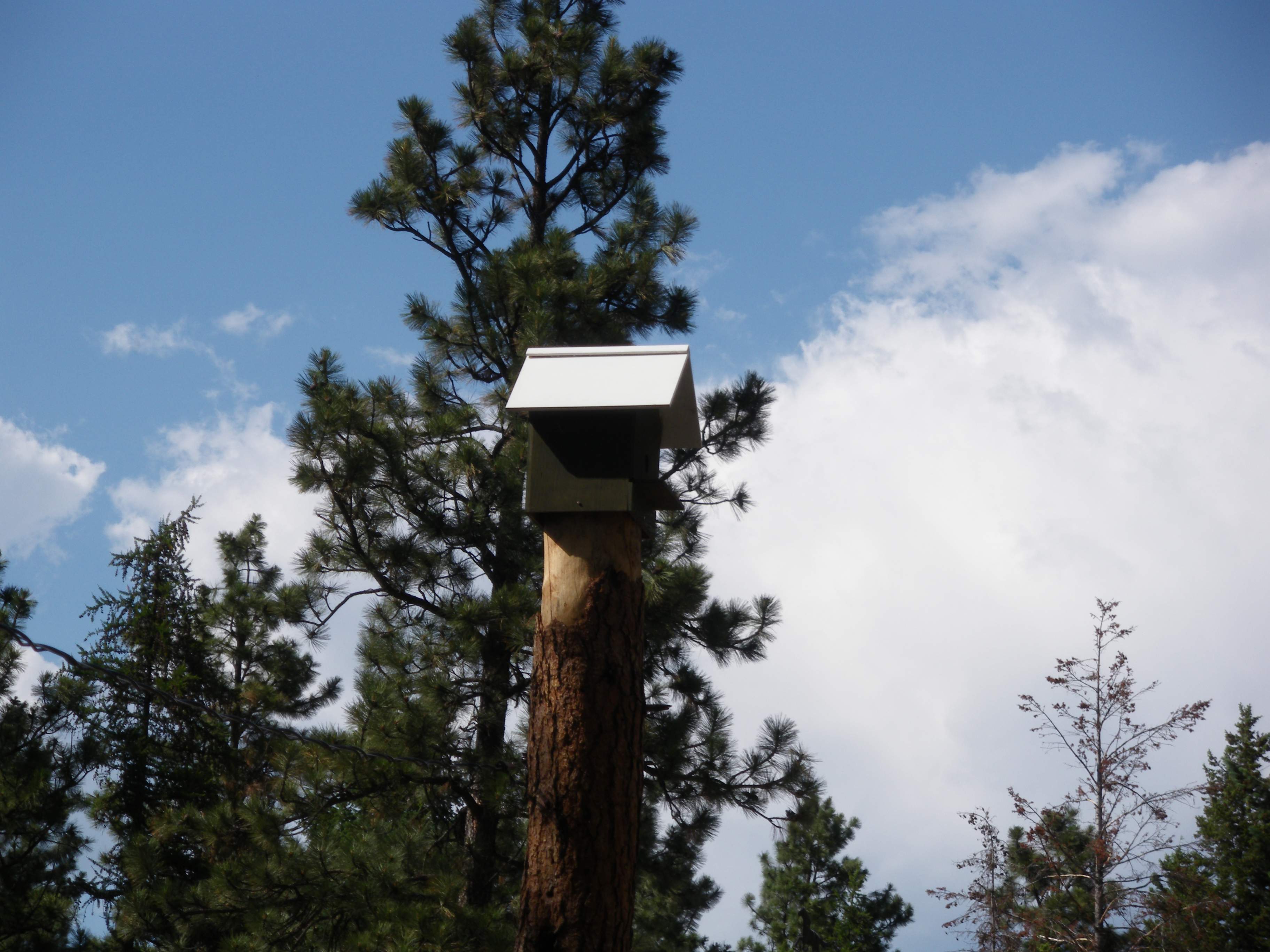

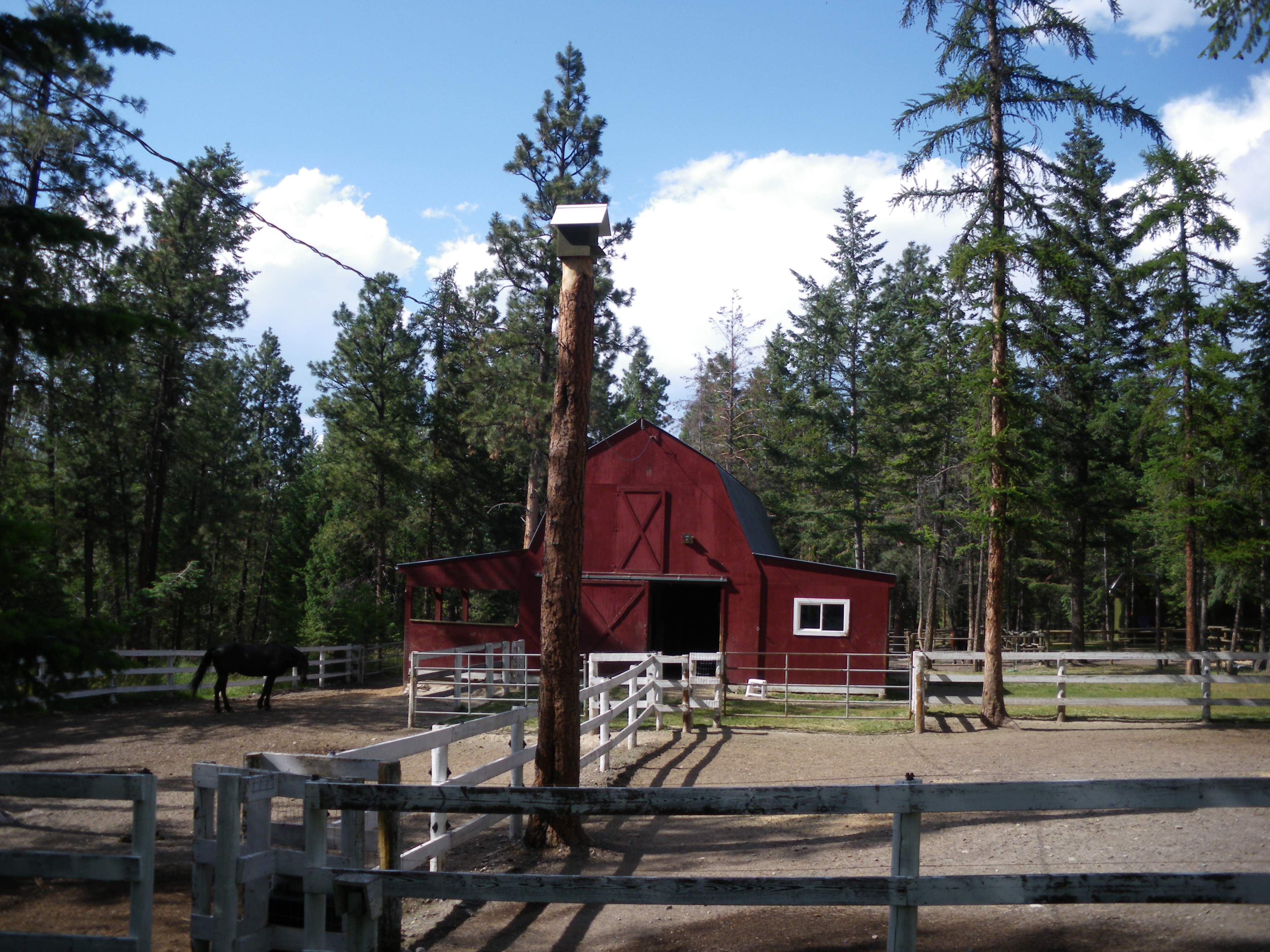

I doubt if your electrical code would allow the line attached to a tree. The home I bought had a line to the barn attached to a bull pine half way to the barn. It died about 4 years ago and to solve my problem, I cut the tree above the line and mounted a bird house. A fashion statement and to keep water of the top of the tree in the hope it will last longer.
Fred

View attachment 318511View attachment 318510

I have almost identical situation, it's a tall pine about halfway between the two buildings.
