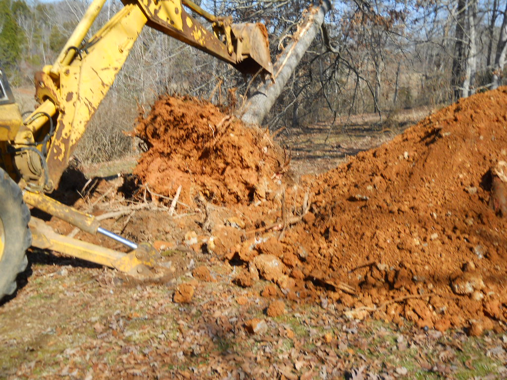

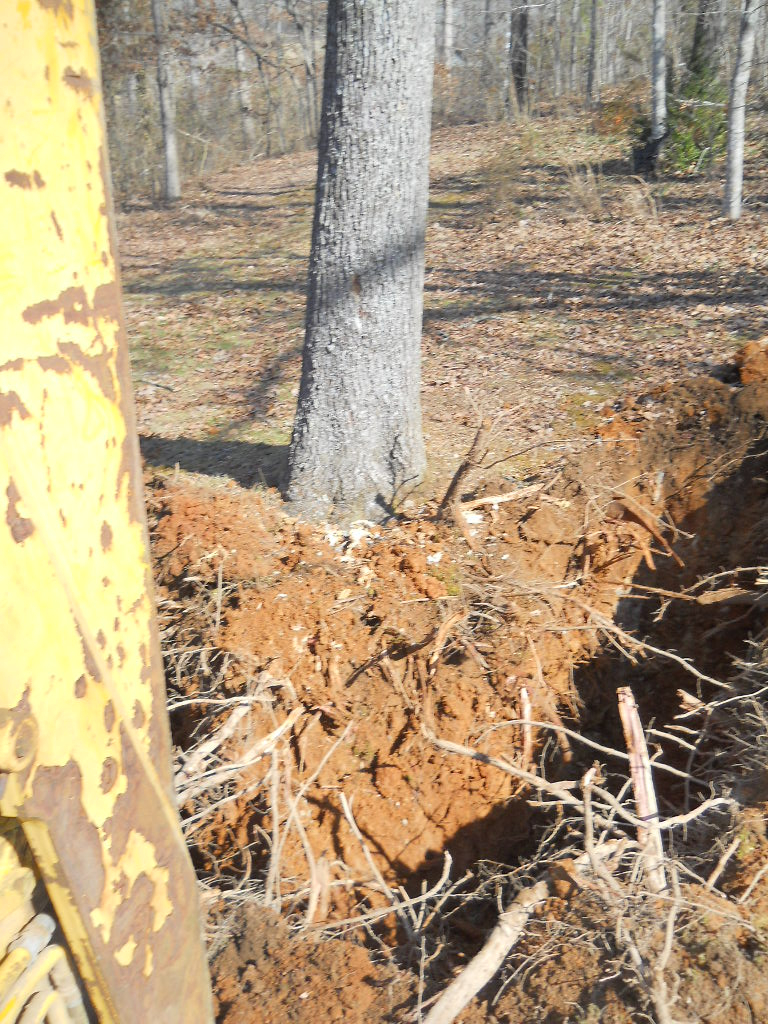

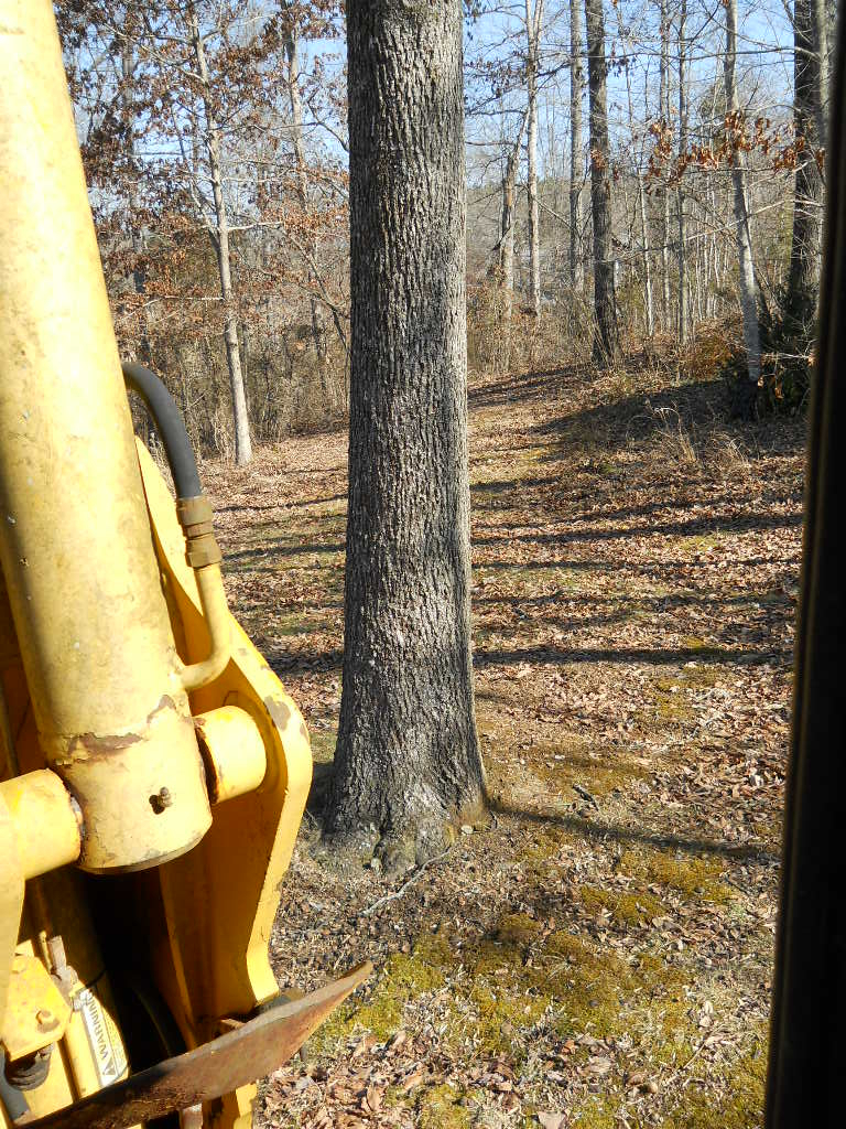

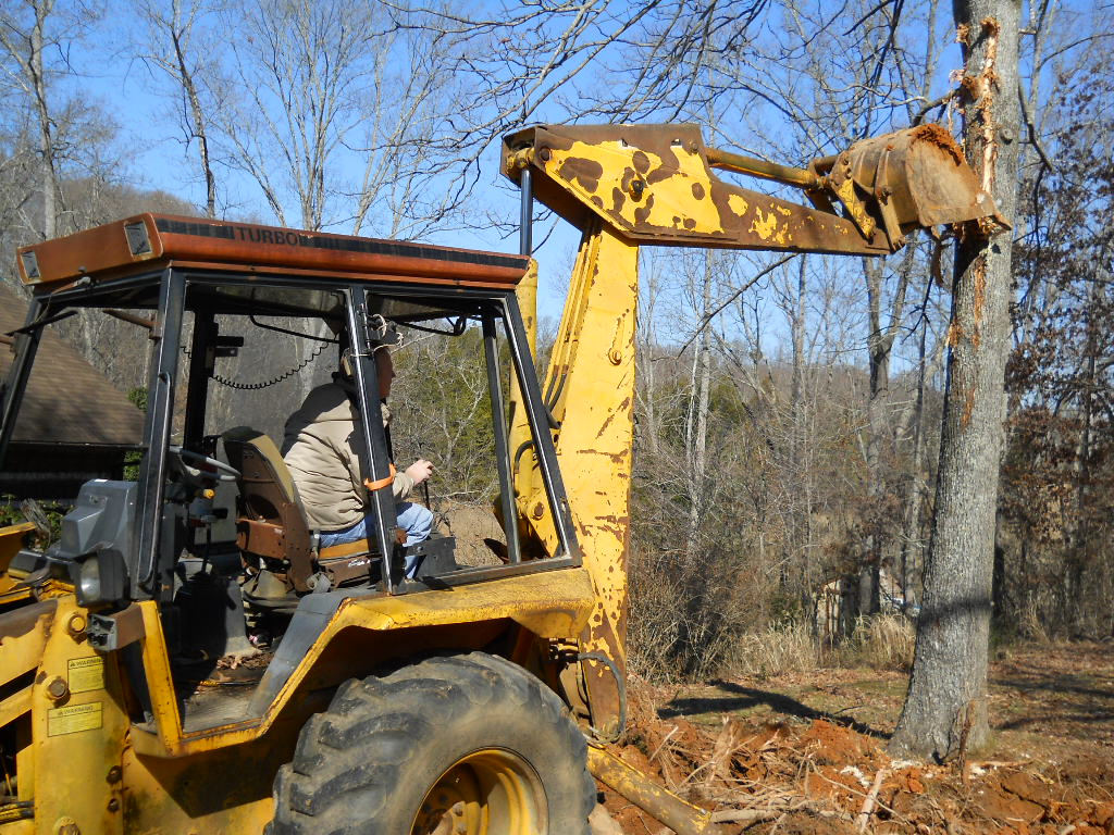

Do you have any other tasks you could use a backhoe or bulldozer for?
My wife's cousing next door had a tree that was fine....but within range of his house so he wanted it down AND the roots out.
I dug on three sides letting the 4th side act as a bit of a hinge to hold the tree from falling towards the house... then pushed...
Tree came down, roots came up and he & his hired working cleaned it up.

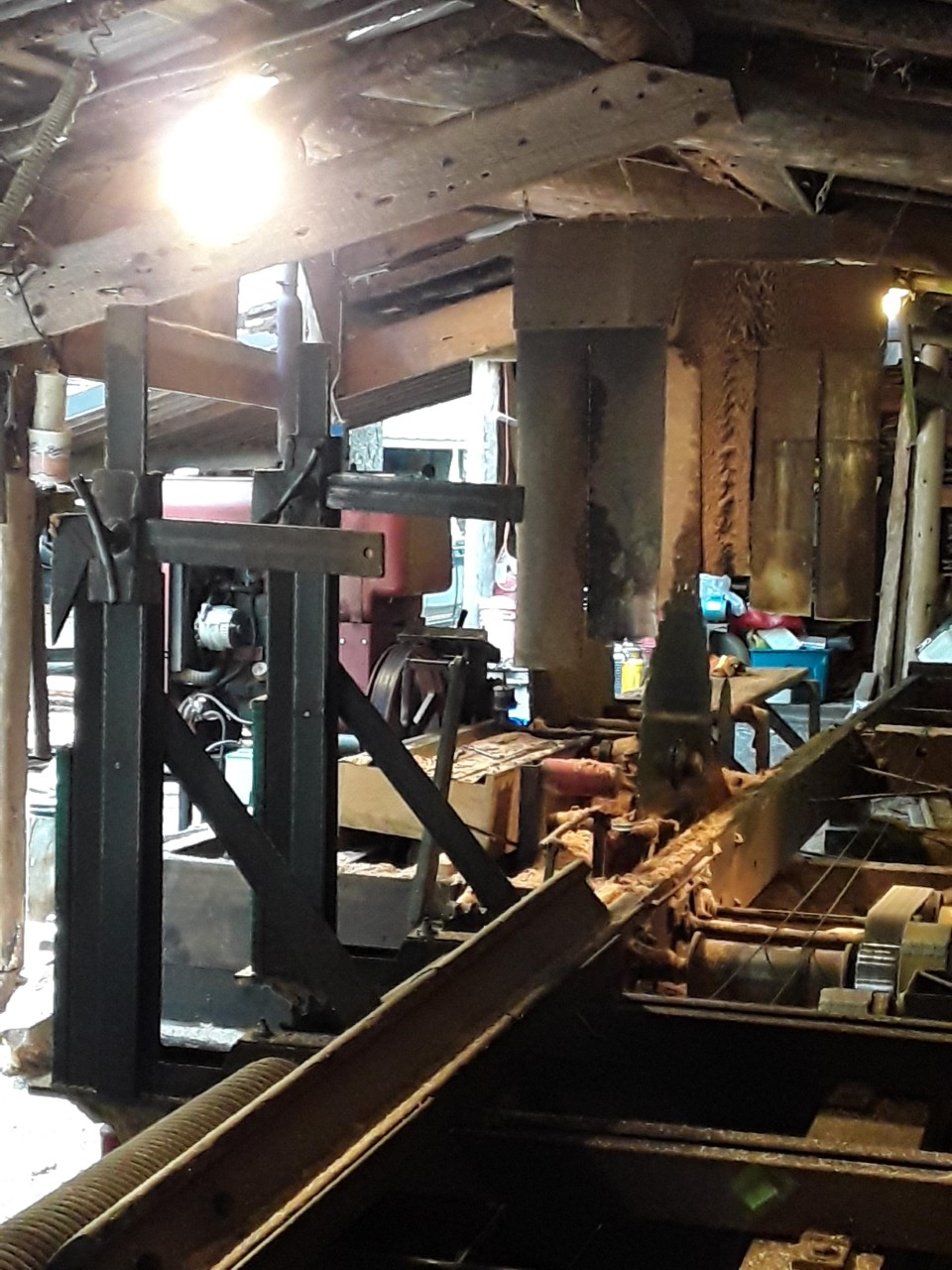

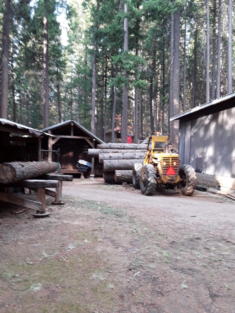

Tree slaughterhouse! Cut 2 more pines for the mill yesterday using plastic wedges to direct the fall. 45 years of falling and milling with a timber fallers license per state regulations. I encourage people to have professionals do the work when in doubt.
