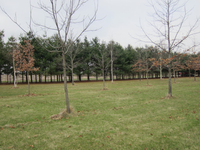

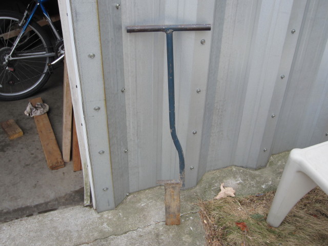

Here is a dibble and a wind-row of trees.

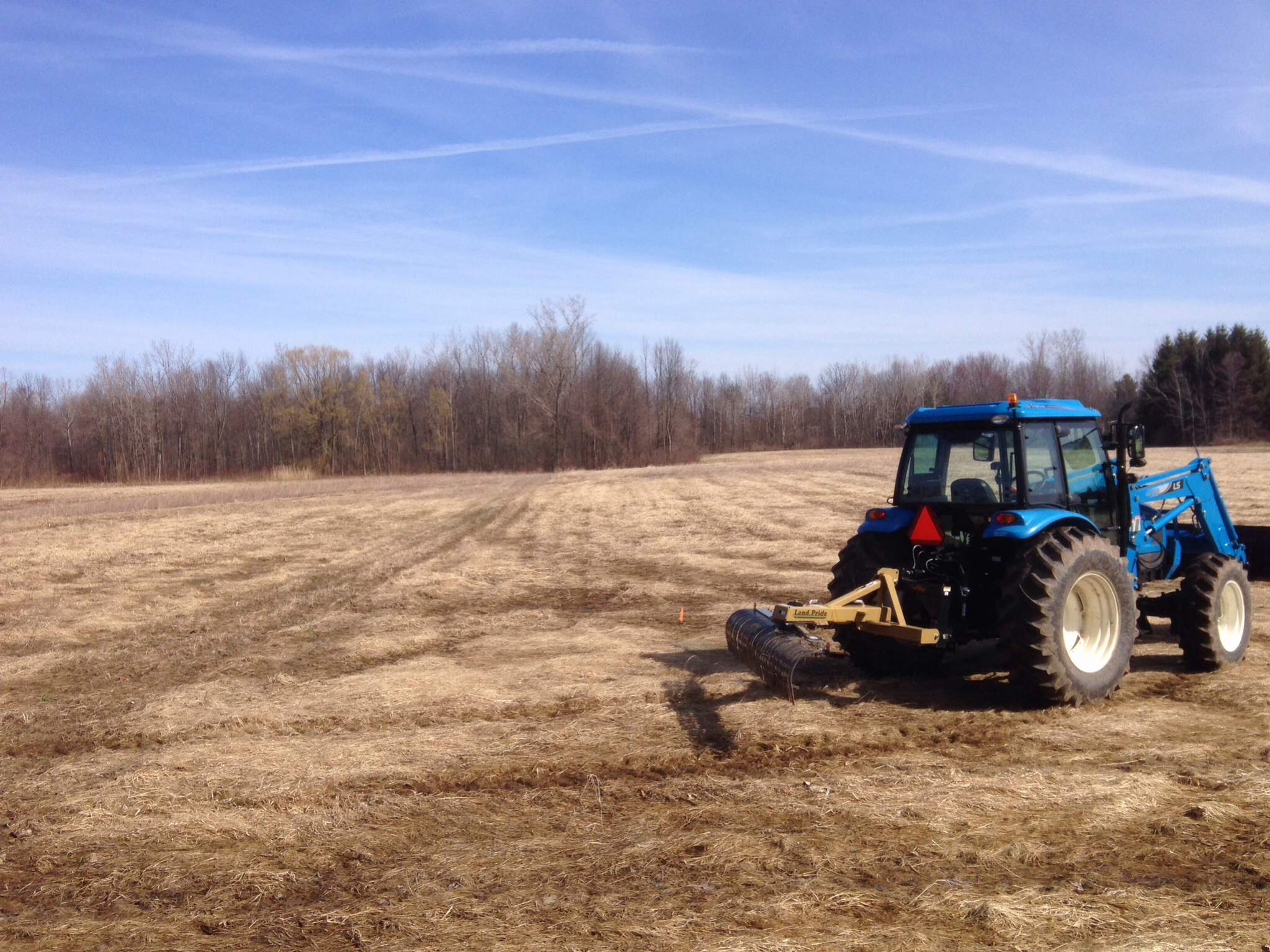

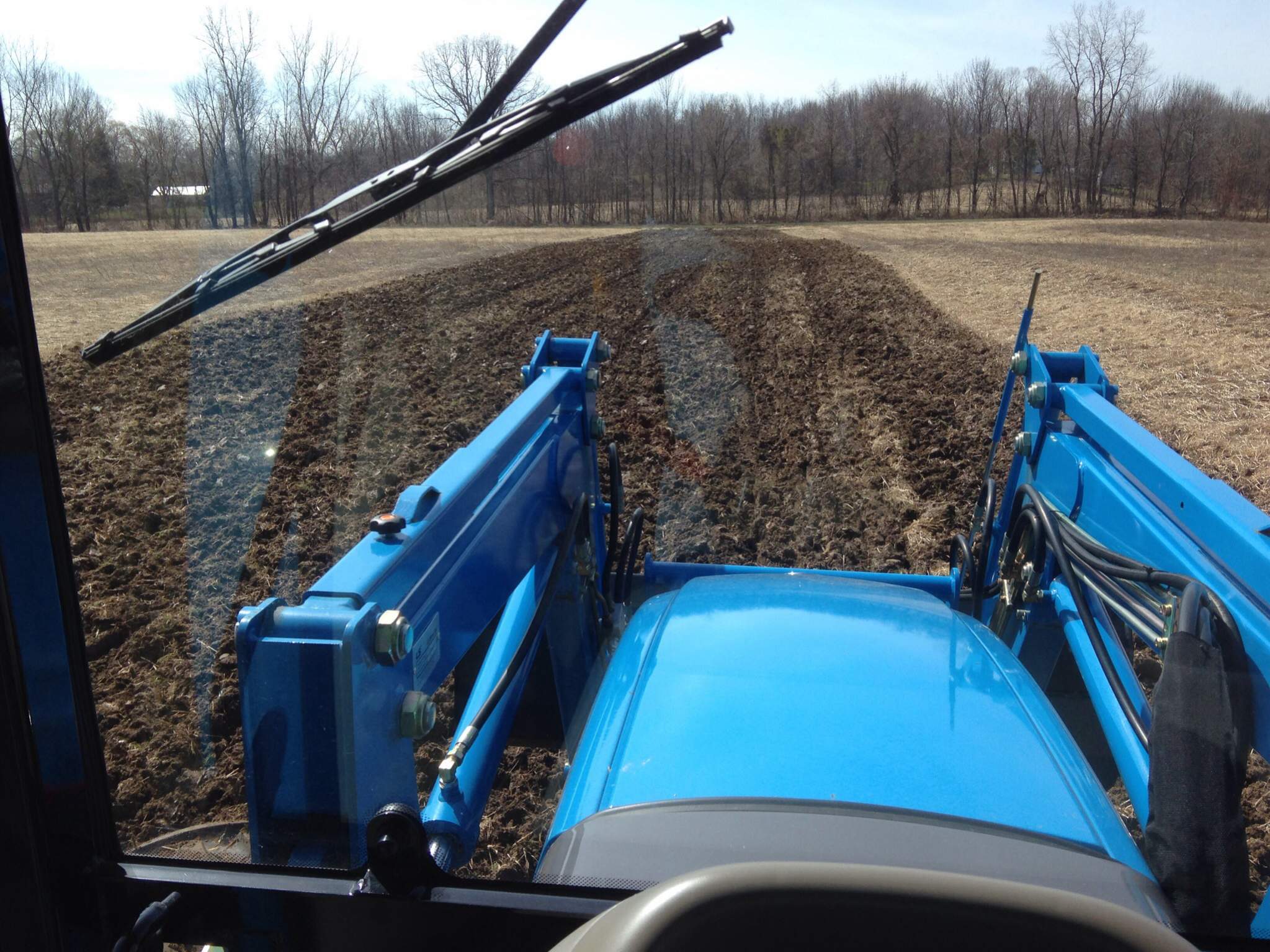

Thanks for all the replies and it kind of eases my mind a little bit, it seems I was putting a lot of pressure on myself to get them planted. I'm going to order up a dibble bar today. I did try the rake, but that was a bad idea. Hooked up the disc and one end of the field was pretty wet but got it opened up so hopefully that will start drying things up. Thanks again for everyone's help!
Here's a before and after shot from each side of the field:

Ordered up a couple different dibble bars from that link. Thanks again!

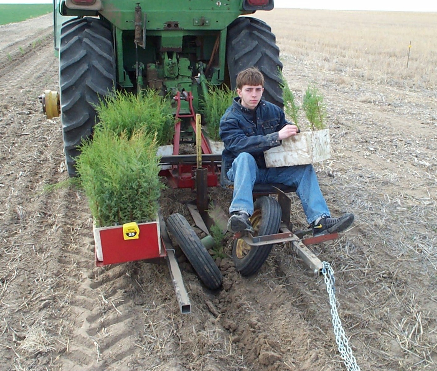

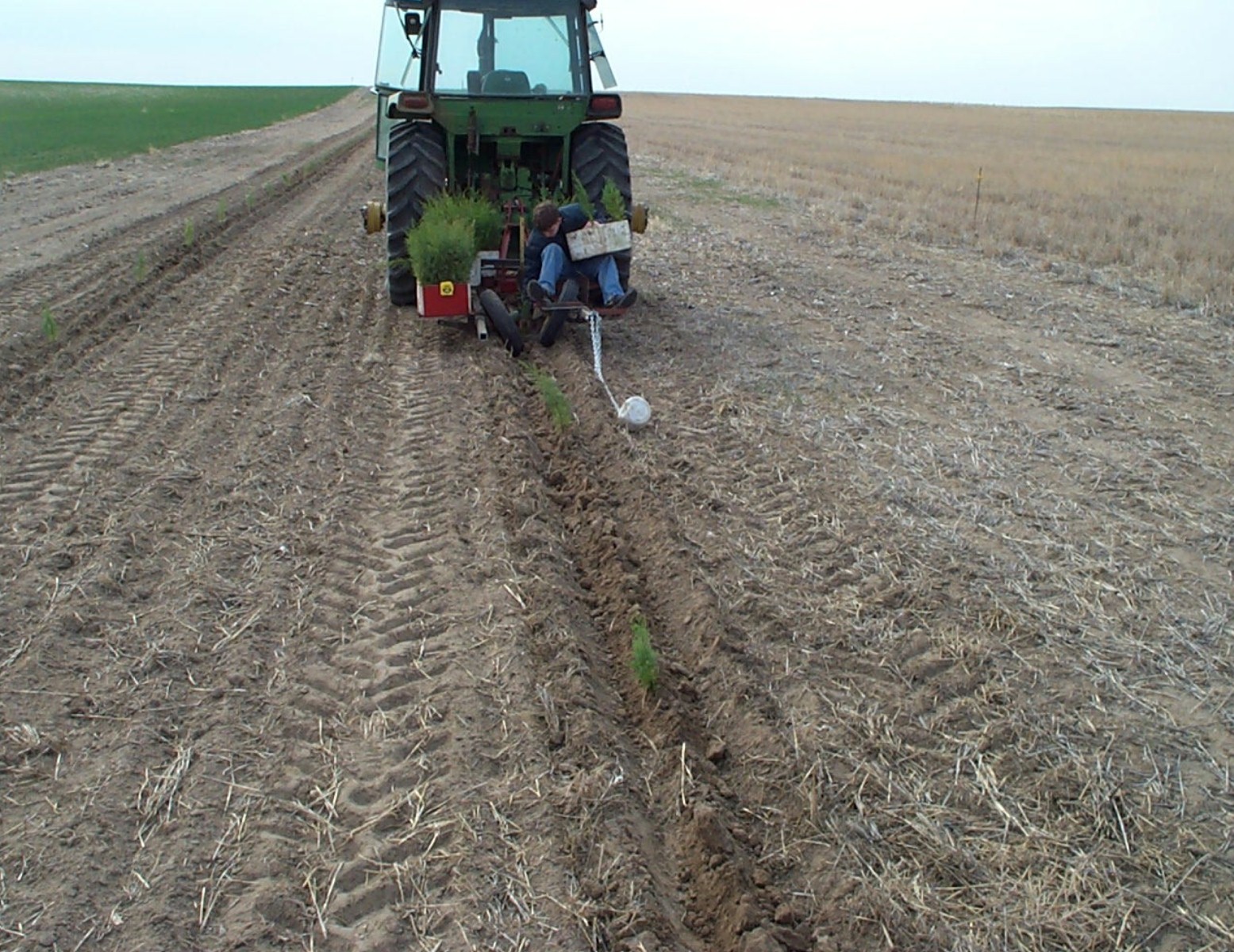

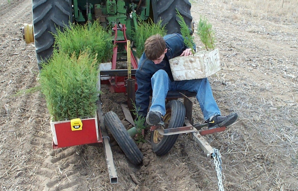

IF the ground is not froze, I would scrape the snow off or if it is not so deep it is a problem, go plant them
here is a picture of when I planted about 3000 trees, we put the weed barrior cloth on later,
That's great! I can see how that is a fast way to plant a lot of trees.
