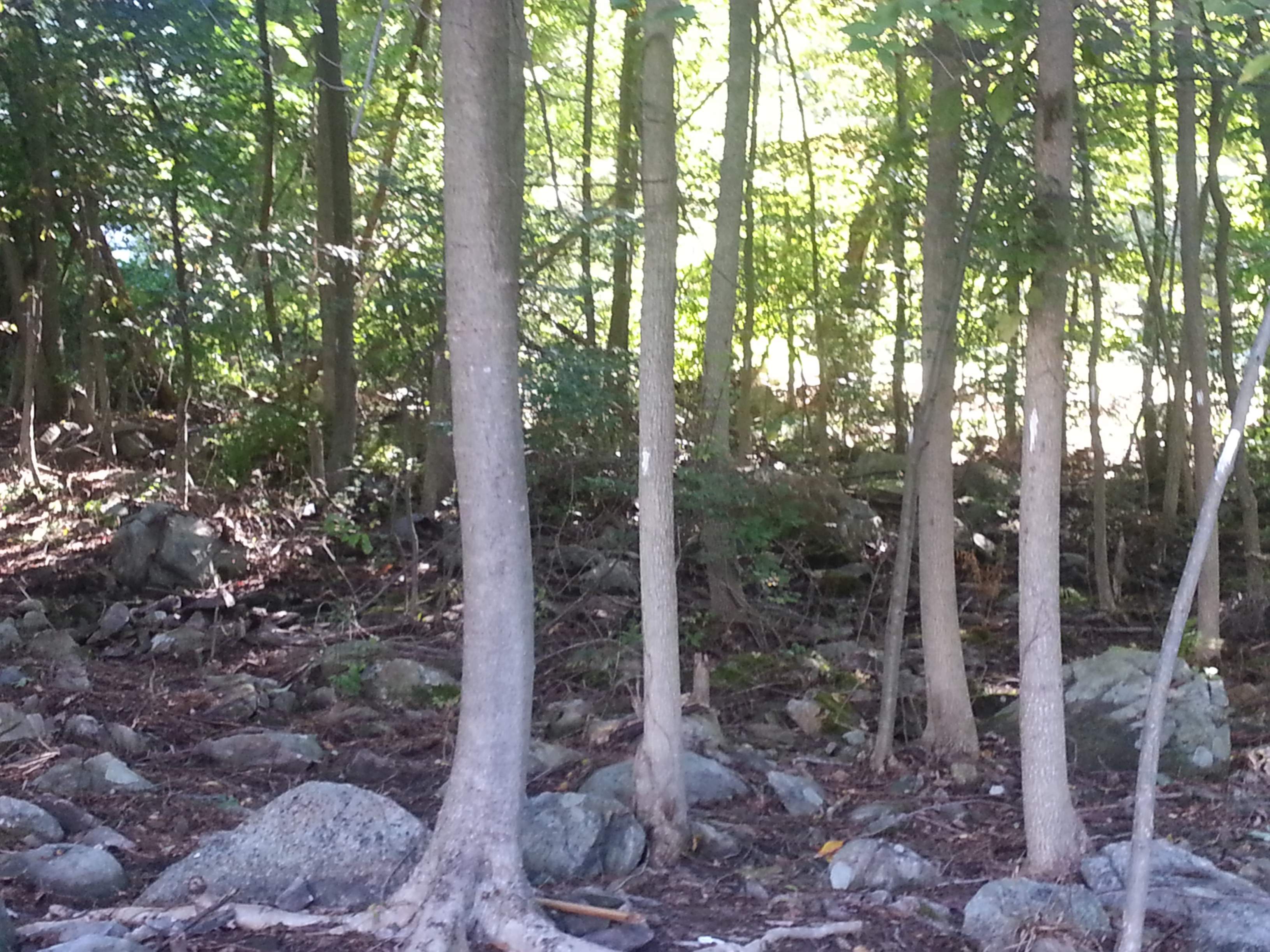

Here is picture of the worst part which is reflective of most of the property. From what I am hearing it sounds like I should rent (or hire a guy) a good sized machine to move the bigger rocks. When I say "big" I'm referring to rocks the size of the one in the left of the picture. I probably need to move about ten of those total no more than fifty feet. It's the medium and small size ones that I am going to try and do myself. 20140922_091916.jpg
Do you think I could move those with a B-series? I'm not really in a rush.

With a property like that, I wouldn't even look at buying a tractor. I would get a Compact Track Loader or a Multi terrain loader. I have been doing rock work for a couple years, and I have been using a Mini Excavator tractor combo for a while. Both work great, but I would never just want the tractor. I have done that and It isn't fun, and with a bx25 it REALLY wouldn't be fun. I had a Jd 2320 with a 46 backhoe. It was an Amazing tractor, but the backhoe couldn't pull stumps out bigger the 4in. I know how to run the backhoe and how to baby it, its just didn't have the power. If I were you, I would buy a multi terrain loader like a Cat 247, and get a bucket, pallet forks and a rock grapple. With that combo you will be very happy. And when you need to dig, rent a mini excavator. Thanks, John
/ Advice on First Utility Tractor Purchase #11
Interesting. the BX is a toy and not going to be useful for what you are wanting to do IMO. Looking at the pics it appears you are missing a lot of topsoil. I noticed the roots seem to be exposed and it appears you are missing about a foot of soil from that area. Is that a shoreline by chance? IF so you will want to leave the rocks there to prevent erosion, basically natural rip rap.
I'd try renting a couple of different pieces of equipment to see what works best for you but I dont' think you are going to find a small inexpensive machine to move large rocks like that. To me an excavator with a thumb would be best for that application. Rent a dump trailer as well and you could move a lot of rock.

Are you saying that most of the non-lawn one acre is like that?
Sometimes you can usefully read some land history. For example, on the other side of the rock wall through the trees in your pic looks like cleared ground with grass growing. If there is a rock wall it means someone in the past picked and cleared rocks to make a small field/pasture. If the part in your pic was left undone, it's probably because it was too rocky to pay doing the work. That may still be the case. :D
The trees don't look to be thriving all that well. If there are no old stumps from larger trees, I'll bet the rock runs thick and deep and/or the ledge is not far down.
With my 40 hp NH & backhoe attachment I could handle most of those rocks, all of them if there isn't more rock buried than sticking up. A tractor can push a much larger rock, once you get it up on the surface, than a typical tractor backhoe attachment can lift. But if you take off the top layer and it's just more of the same below that, you haven't accomplished much. Maybe you could get some re-bar or other steel rod, sharpen a point on one end with a grinder and try driving it between rocks here and there. See what you hit.

What are you trying to accomplish, what is the goal for this land?

You all are pretty perceptive. Dave you are correct in that on the other side of that is my neighbors yard.
I will do my best to describe what is in the picture. It is almost like a swale in that it takes runoff from the yard and holds it in that little depression. I need to go out and measure the slope, but it is pretty noticeable. On the other side of that depression is a little mound and then on the other side is another swale-like depression. So there has been indde
1. Cut down most of the trees that you see in the picture. There are a couple of maples outside of the picture that I want to keep but for the most part they all need to go.
2. Start forming a retaining wall that begins from the "mound" I mentioned above and runs as a semi-circle up to the lawn area. This would be done by first moving those gigantic rocks that are not buried into the right place, and then digging some of the rocks that are smaller (not necessarily "small") from the area and using those to form the retaining wall. Moving those big rocks was something I was going to leave to somebody else with the larger machines.
3. Once wall is formed, fill in that depression with dirt...it's going to be a lot of dirt. Again probably worth somebody else coming a doing it, but it will cover up about 95% of the other rocks.
4. That will become lawn with a couple of trees planted.
The other areas are not really as bad. There are a lot of surface rocks, but they are smaller. There are several downed trees that are pretty large. But to Dave's point I have some extremely tall elm and sycamore trees there that are really healthy. That area will pretty much be left natural after I get rid of all the vines and invasive plants.
John, I never really thought about a skid steer. Would ground clearance be an issue with that? I wouldn't want to high center it going over some of those rocks.
Maybe the best thing to do is rent a couple of pieces of equipment over the course of a few weekends and see what works and what doesn't.
