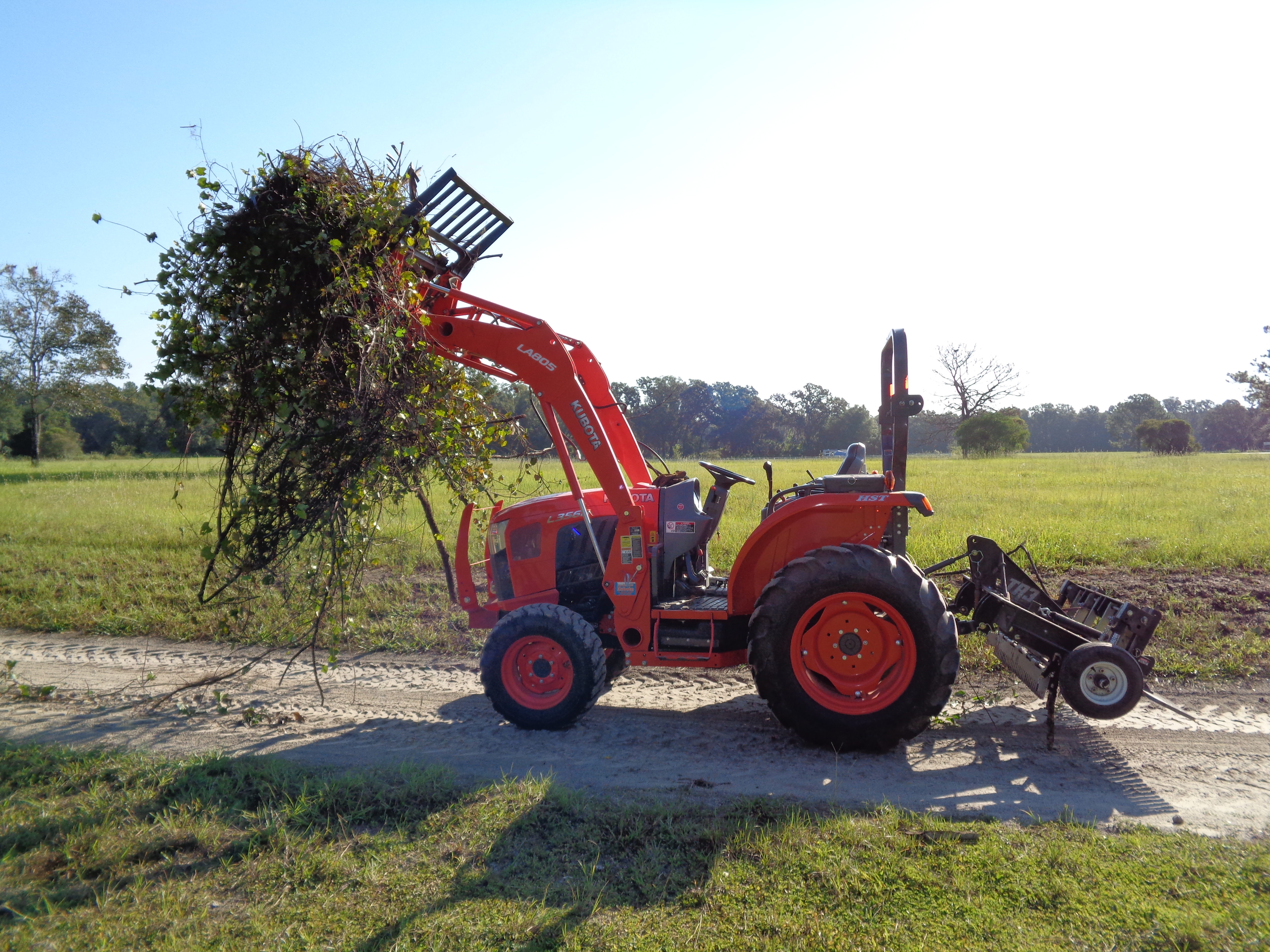

/ Advice on first tractor purchase. #5

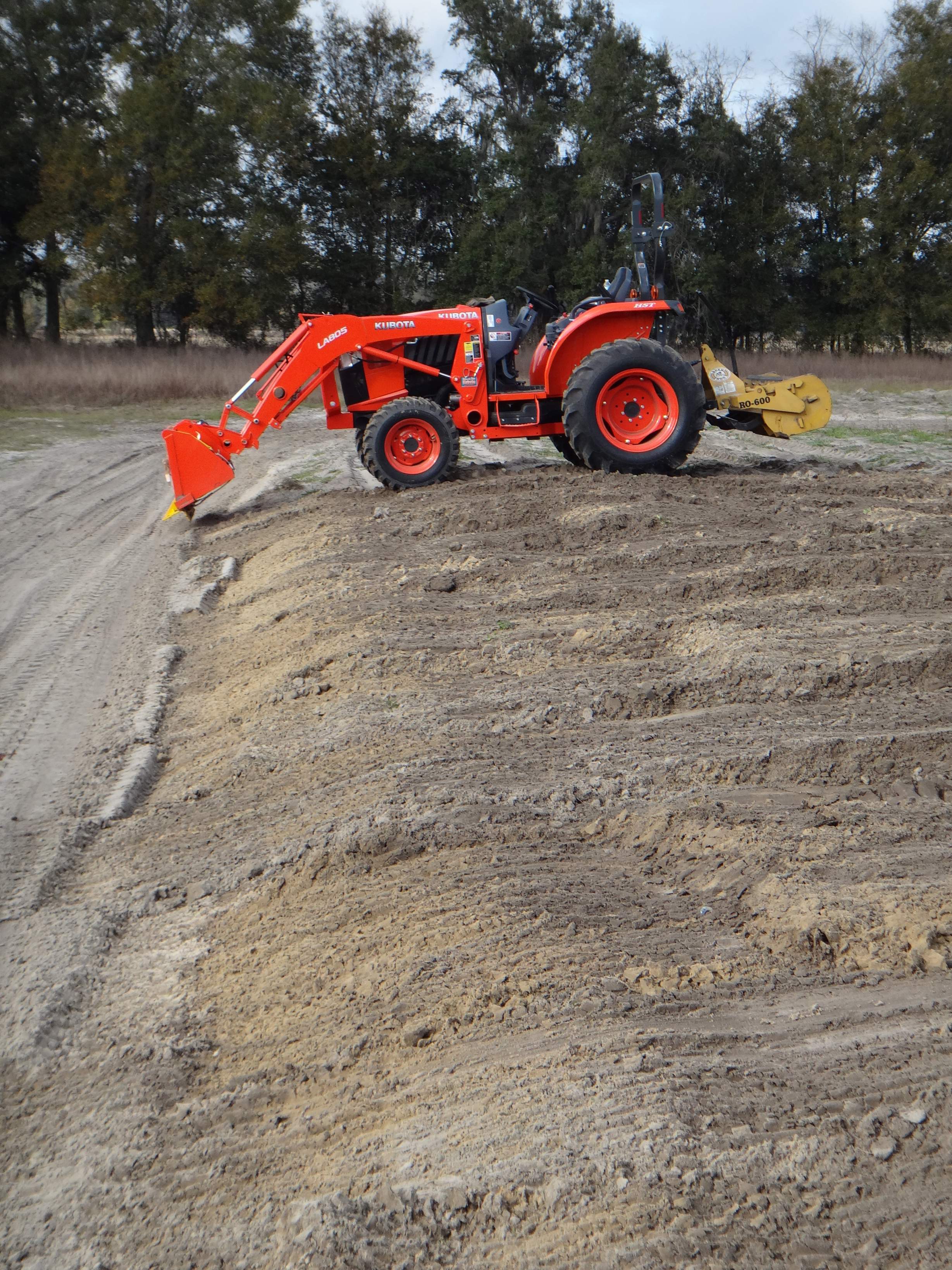

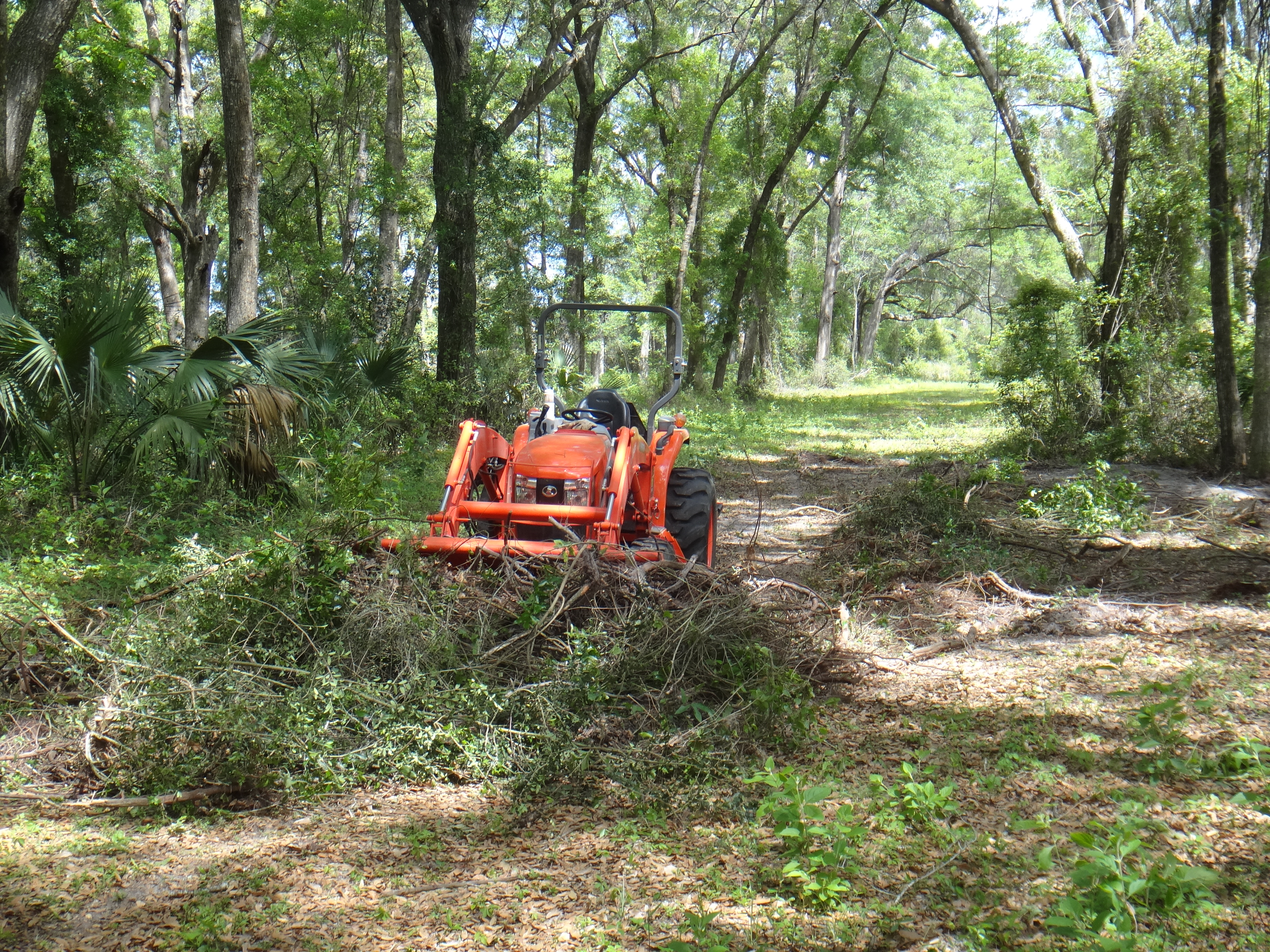

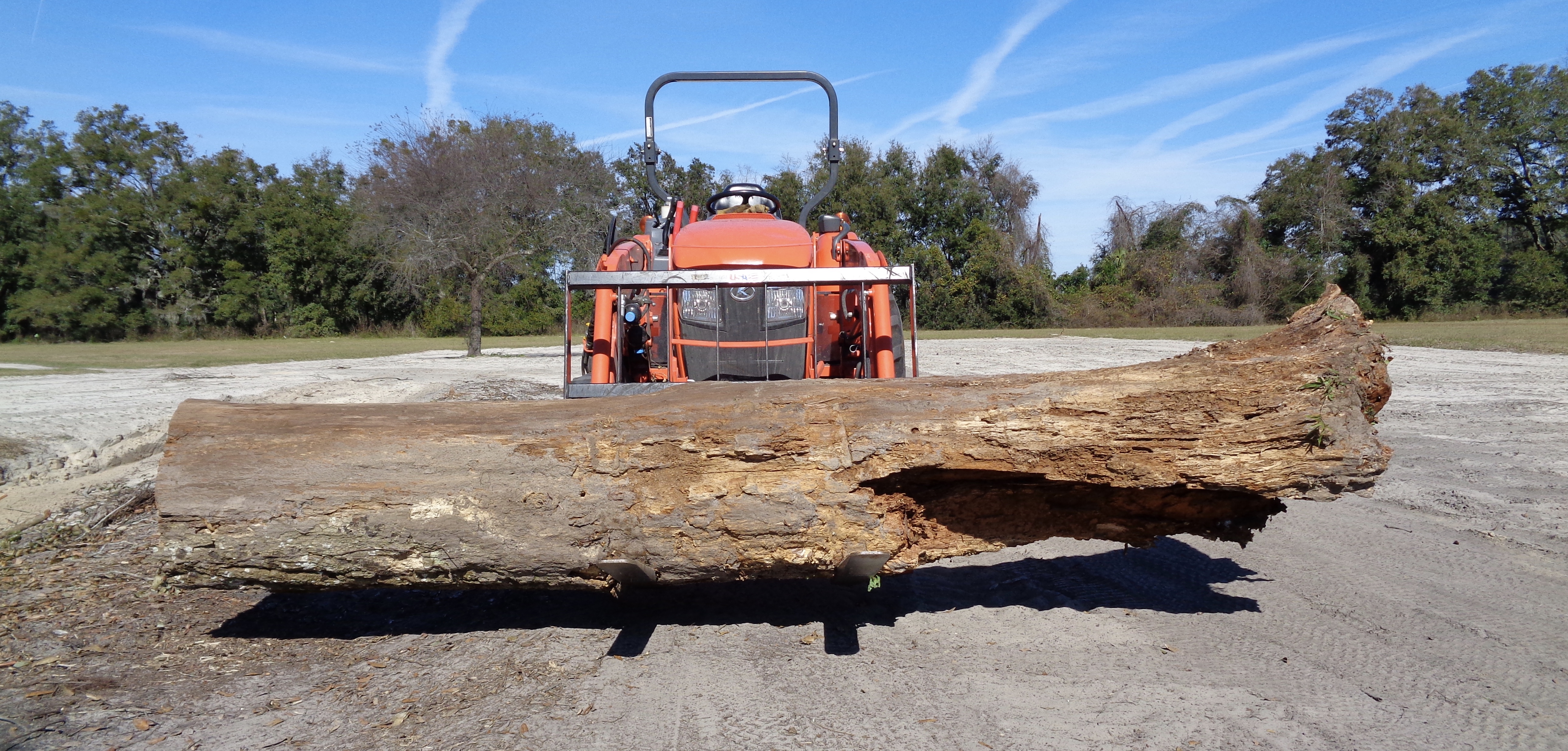

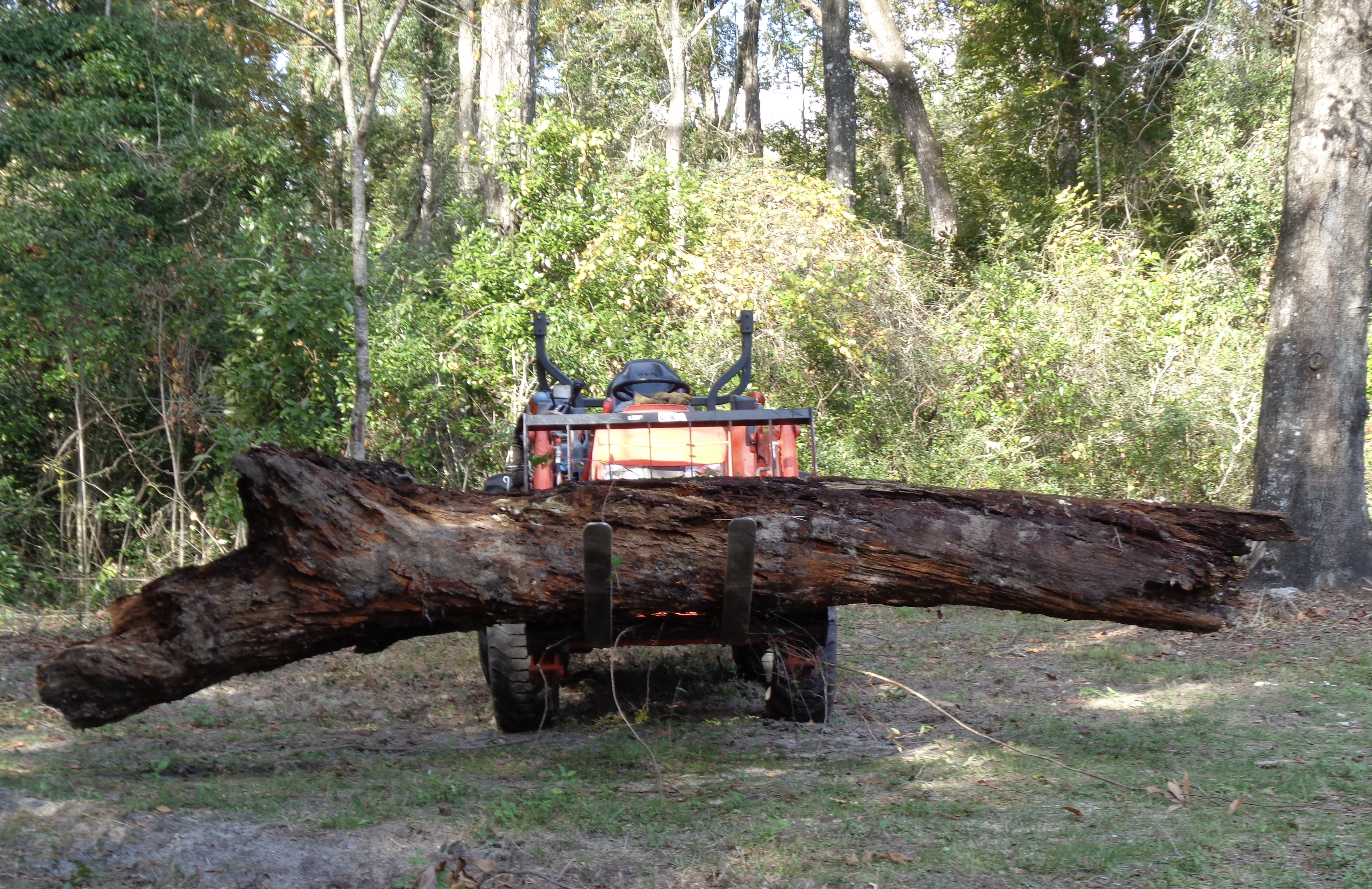

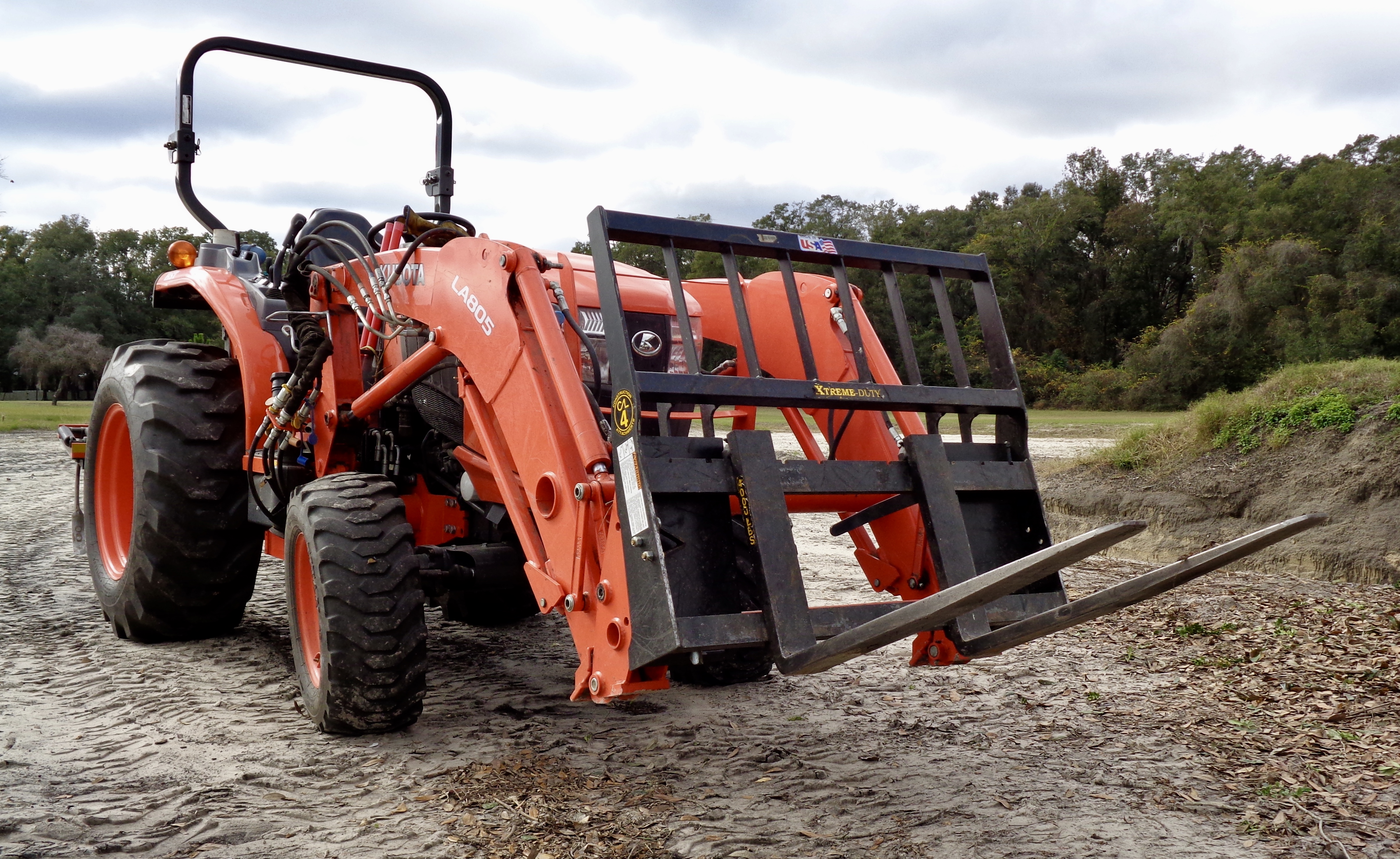

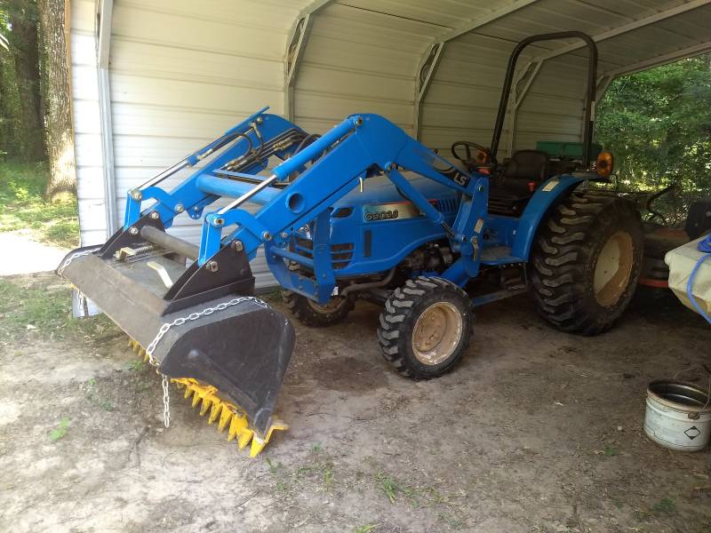

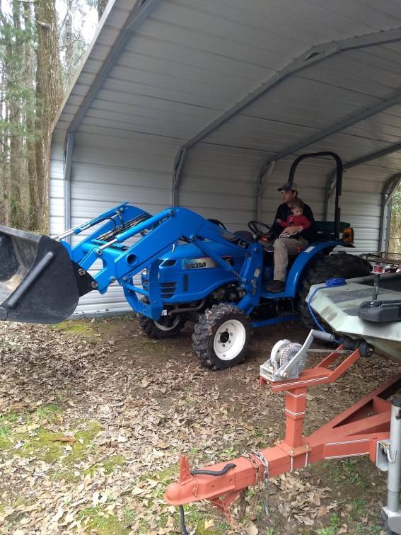

I'm guessing this was directed to me? I really like it. It's a G3038, which is the pre tier IV emissions version of the XG3040. It's a bare bones tractor, shuttle shift, no rear remotes or third function, no cup holders, etc. But, I needed a tractor to work and on a budget, and this fit the bill.
I bought used, so while I was looking for any tractor 30 - 40 Hp, 4x4 and with a loader, I was mostly looking for LS or Kubota. I started out looking for a new holland or Kubota, but I found out LS makes the new holland and figured I'd cut out the middle man and some cash. Those, along with John deere, are the dealers I have within 45 minutes of me, and that was a requirement since I'm no mechanic by any means. The green machine was ruled out because of the plastic hood and fenders, along with a substantial price difference even amongst used.
Like I said, I bought used, so I couldn't pass this tractor up because it didn't have luxuries. It's a solid machine that has done everything I could ask plus some (it withstood my dad's hard use...).
I test drove some of the newer LS's at the dealer, and the XR series is solid. It's got all the luxeries mine doesn't on essentially the same frame. But, if you're ok with open cab and no cup holders, the XG series can be had with an HST and you can add more hydraulic valves.
But again, I've heard good things about the Kioti line, so if the LS dealer is giving you the run around, not to mention the distance, and the kioti place is working with you and is close by, I don't think you'd regret the kioti.
Attached are a few pictures of mine. MVIMG_20190704_104505.jpegTractor.jpegAttach0.jpeg

Since it seems most of the tractor advice is pretty much covered, when it comes to the FEL it's worth finding out what size/capacity bucket is stock for the tractor as that will likely tell you more about the practical lifting capacities than the spec sheets.
The other thing to pay attention to on the FELs is the reach height and distances, and consider what makes sense for your applications.
Overall, it really comes down to determining what your applications/tasks are (or will be) and how quickly you want to do them (and if they impose and absolutes on performance/size). It's also worth keeping in mind that power is great for running the PTO, but all the power in the world doesn't matter if you can't transmit it to the ground (which is where weight, tire type, 2WD vs. 4WD all play a role). Then it's just a matter of budget and quality of dealer (which is important since you'll likely be working with them as long as you own the tractor).
Edit: Just for illustrative purposes, I've had times where I've had the tractor in Low, 4WD on, the rear differential locked and had all four wheels spinning ...hasn't happened often, but it has happened in a few different soil conditions and turf types. In pretty much all cases it's happened when trying to do more than the tractor could handle all at once. I've also maxed out the lifting capacity a time or two. However, I'm completely happy with the tractor I have as does what I bought it for, and most of the time I've run into limitations I've been able to work around them. .....which for me is just a fact of life as even I had a much larger machine, I'd probably find harder tasks, or attempt to do my existing ones at the limits of the machine. ...... so as I hinted at above, sometimes it's good to have an idea of how fast you want/need to get something done, and then start figuring out how fast your budget will allow you to do them (which may ultimately drive the size of the machine to buy).
The only other thought is that sometimes it's also worth looking at other types of machines (e.g. skid steers, compact wheel loaders, compact telehandlers, etc. ) just to verify that a tractor is indeed the best option for doing the tasks you need/want to do.
