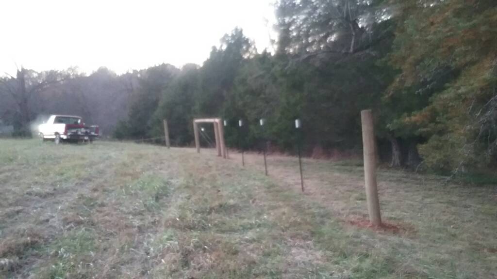

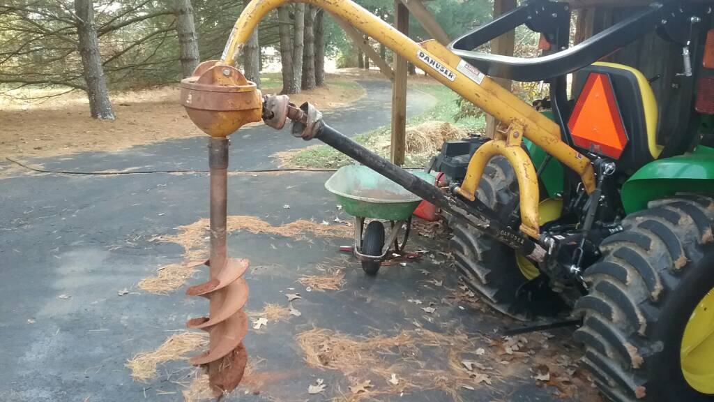

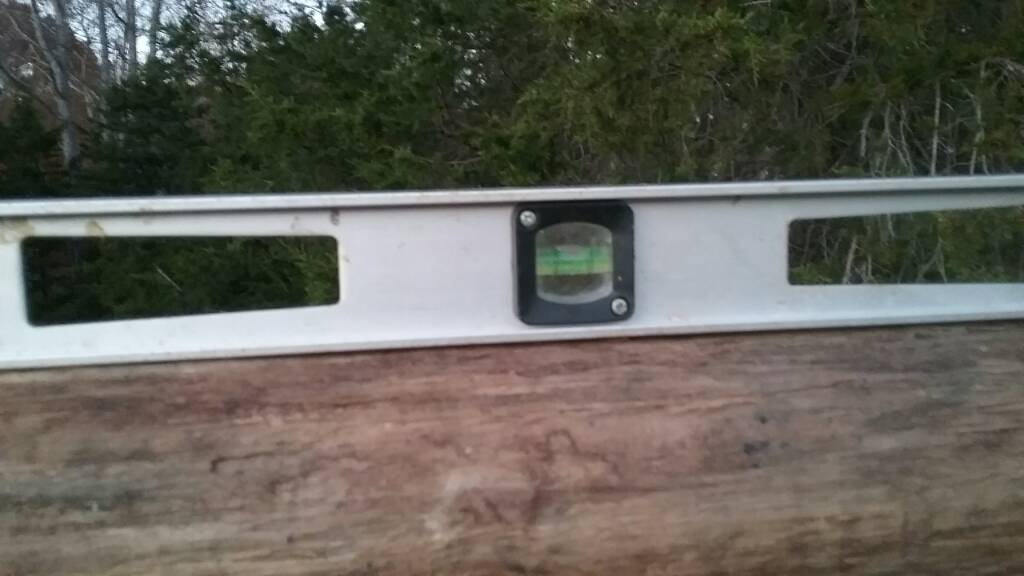

What the fencing company said doesn't make sense because like you said the 3 rail won't keep coyote or dogs out either. Imho I would think you don't have to have just one type of fence everywhere.

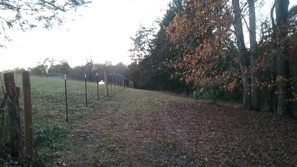

If you have a tractor already and time I would consider a PTO digger, do it yourself. I'm installing lots of fence by myself. It's not that hard to do. I'm working on this section now. 20181110_172034.jpeg20181110_172122.jpeg20181110_172343.jpeg

If you have a tractor already and time I would consider a PTO digger, do it yourself. I'm installing lots of fence by myself. It's not that hard to do. I'm working on this section now.View attachment 579448View attachment 579449View attachment 579450
Great job and nice looking property.

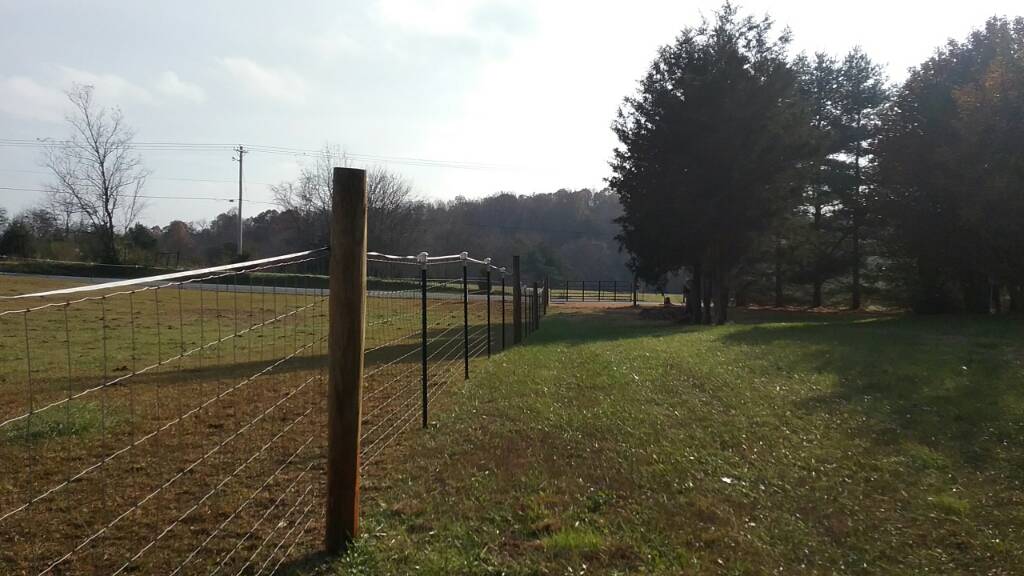

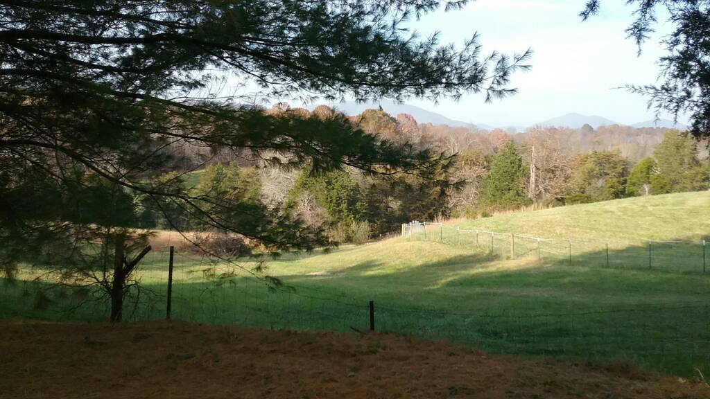

Here's a few more pictures. If you have the time, digger it's not that hard to fence. I made a stretcher, 8ft 2x4 cut in half, four carriage bolts. I did buy a T post driver, $32.
Old fence in foreground I'm taking down.20181118_144319.jpeg20181118_144151.jpeg20181118_144330.jpeg20181118_144359.jpeg

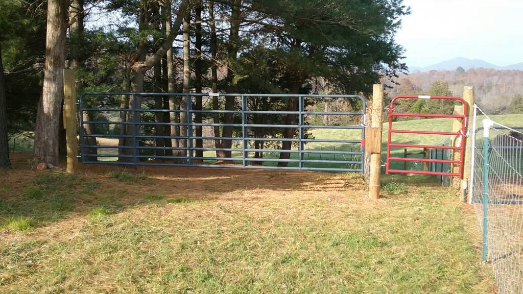

That's funny that they said its not a farm fence. Kinda says a lot about them right there. I use to have horses but now its goats. My fence is all electric, Yep the wires are on the inside. I bought my rolls of wire in rolls of 4000' for about $100 a roll. I have 15 acres that the exterior is all 5 strand High tensile electric. All my corners are utility poles that are 4' deep averaging about 12"+ in diameter. The really nice thing about this type of fence is if you put springs on the line it will bounce right back up if a tree or something lands on it. A couple years ago I had a tree do a direct hit on the fence and once I cut it off the fence it just sprang right back in place. Here is a picture of one of my gates That gives you an idea of the general construction. gate.JPG
