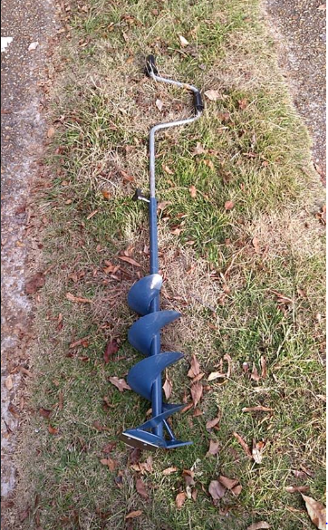

Bought this at a Black Friday Sale for $450. Ready to start putting in posts. :laughing:
   / Advice on fencing type and installation #66
I was trying to think of a funny reply but I bet that's for ice fishing?
