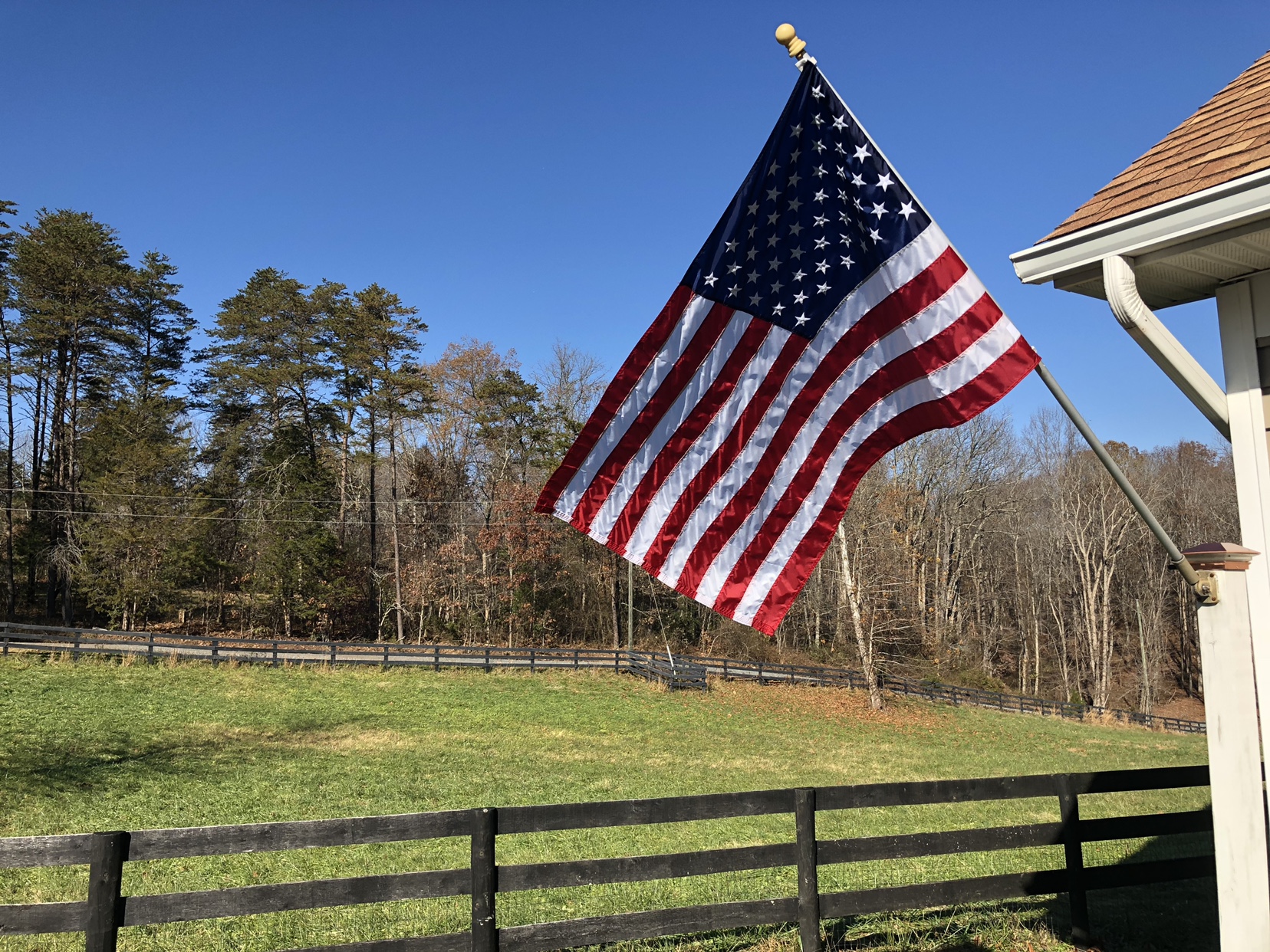

I also have to put in about 700ft of fencing around the back of our property. Most of the property is already fenced and sectioned into paddocks with three-rail blackboard horse fence with half-round posts and 16ft 1 x 6 oak boards, so that’s what I’m going with to match. Around the house to keep the dog in we have 36” tall 2” x 4” wire mesh stapled to the fence.
I was thinking of renting a skidsteer or mini excavator with hydraulic reversible auger (and down pressure) for a weekend to dig the post holes in our rocky hard clay soil and then coming back and tamping in the posts and attaching the boards. Having a trailer long enough to haul the 16ft fence boards would be a big help too.
I consider fencing to be a maintenance item that will need attention from time to time.

Tractorable; [ATTACH said:
580702[/ATTACH]
Nice place Tractorable.
