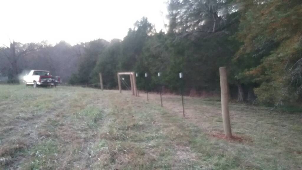

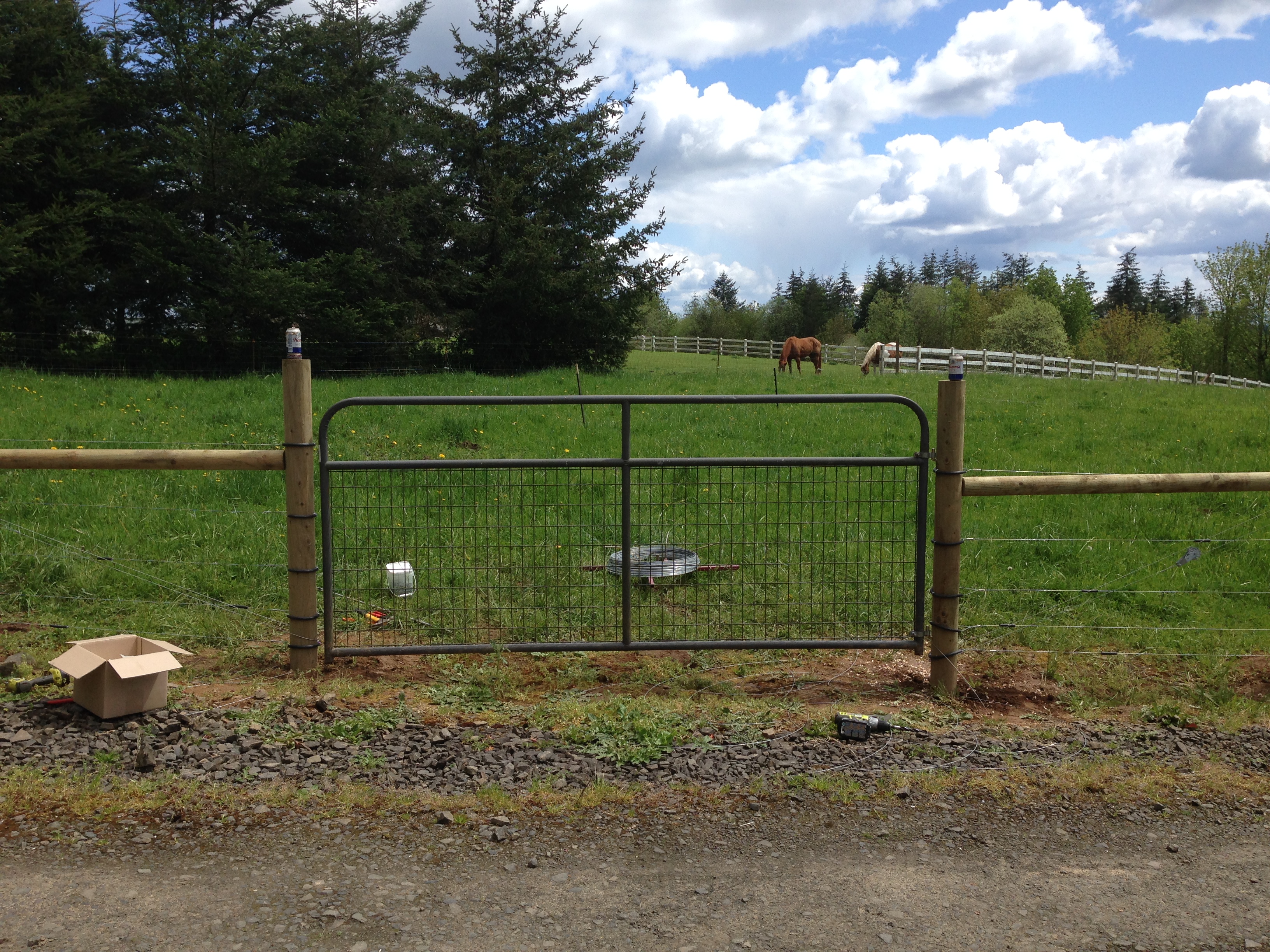

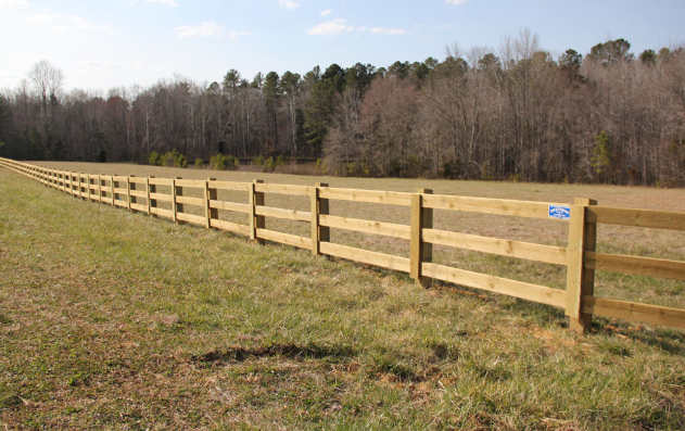

Horse rail (RAMM fence, etc.) works pretty well. It does require tensioning about once a year.
https://kencove.com/fence/Horserail_product.php
Personally, I like the Hotcote wire. comes in white, brown or black and can be electrified if you choose to.
https://kencove.com/fence/Hotcote+(Electric)_detail_WSWH.php

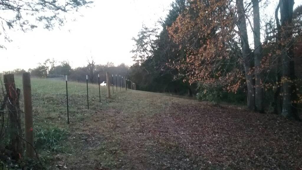

Fence imho should match what's typically found in your area. Treated posts, steel T posts every 10ft then either woven wire or barbed wire is what you see in our area.

Pressure treated fence we usually let untreated for 6 months before we stain or treat it. Usually get a few boards that need replaced due to warping.
Cedar wood fences seems to hold better but is more expensive.

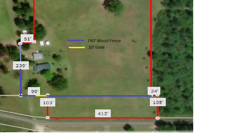

A last thought is how long you plan living there. I looked at your picture again and it looks like maybe a 10ft gate going to the house? If so, you need much wider, 16'-18'.
Where I'm fencing (I'm far from expert) I love gates. I want one so a fire truck, rescue, tractor can get to different areas easily. A couple places I have a 4ft walk through right beside an 18ft gate.

Barbed wire and woven netting with T posts, steel or Concrete strainers etc are not hard on the eyes or pocket in years too come.
