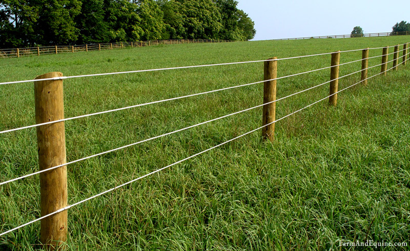

My vote would be a 16' gate and high tensile fence. really easy to install and maintain, and cheaper than most others. Posts don't have to be 8' apart, if you have level ground you can go up to 100' apart if you have good corners set.
Was not my first choice but if the cost is significantly less I will certainly consider this approach.
we did 460 feet of woven wire no climb horse fence and like the look. 5 ft to keep our large dogs in, with the 6 in round green treated posts. I slopped a bunch of sealer on the top of each post to help them last. I wish i would have kept the fence a few inches off the ground for trimming. the woven wire will last longer than the welded stuff.
Any idea what the cost per foot is? I'm betting I could do the work my self and go this route and save $5,000 or so even after purchasing a 3pt phd.
Rustbucket - The more I look at this type of fencing the more I really like it. Easy to mow under/next to, durable, has the farm look to it and I bet it is cheaper. I assume you put the wires to the inside of the post if you have horses?

You might also check to see if there are any legal requirements in your area. Here in Ohio, state law requires farm property line fences to be field fence with an optional barb wire top line unless the neighbor agrees in writing.
   / Advice on fencing type and installation
#40
I don't actually have horses or farm animals so I would be what the country folks call a "poser". If I were fencing for a working farm I would choose the cheapest utilitarian type fence there is now that I know how much it costs.
My main concerns are aesthetics, durability and cost. When I asked my fencing company for a quote on the high tensile fencing Rustbucket posted I was told they did not do that type of fencing and that it would not keep dogs, hogs or coyotes out. Said it was not a good farm fencing. They may be right but it was interested that they did not mention the same concerns with the 3 rail PVC or wood.
