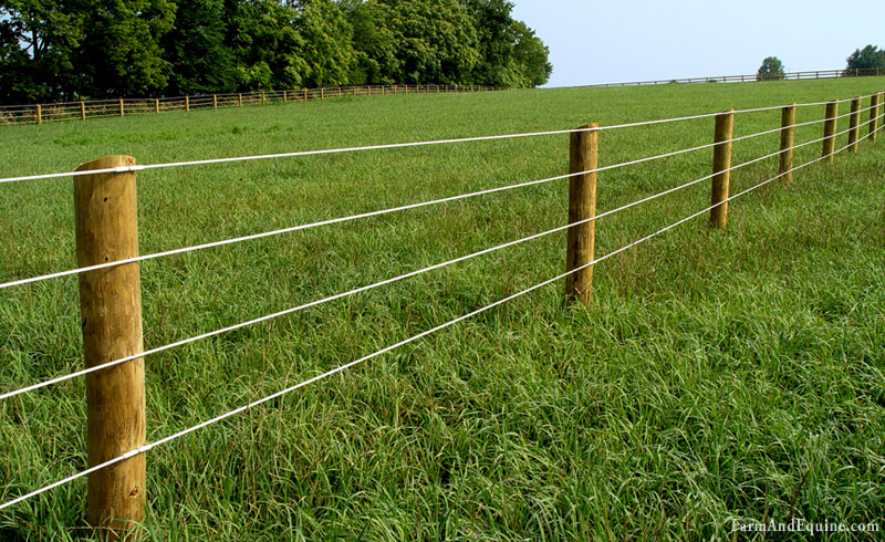

What about the white tape they use for horse fence? It makes an easy to see barrier and is a little more aesthetic than plain wire, but less expensive than a board fence. It has tension wires in it, and while often used with electric, there are types for use without. It looks like there are hangers for use with wood, vinyl and metal posts...

Horse rail (RAMM fence, etc.) works pretty well. It does require tensioning about once a year.
https://kencove.com/fence/Horserail_product.php
Personally, I like the Hotcote wire. comes in white, brown or black and can be electrified if you choose to.
https://kencove.com/fence/Hotcote+(Electric)_detail_WSWH.php
