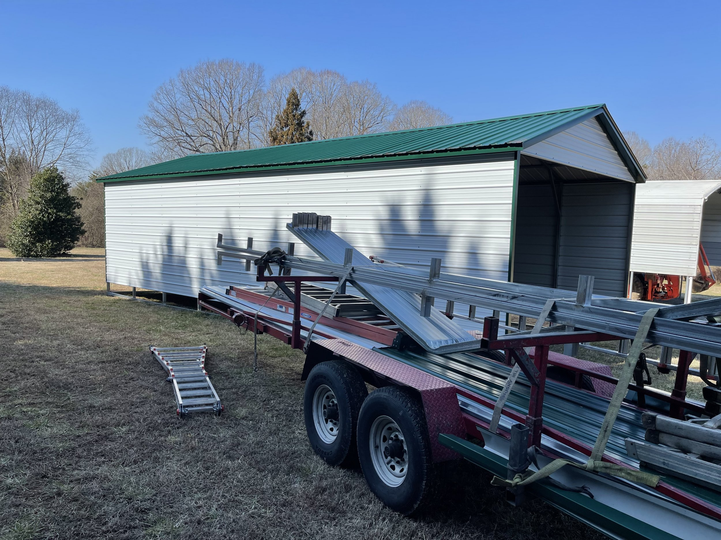

I think what to build comes down to what your personal ability are.
If you aren't a builder and want 3 or 4 walls, a metal carport type structure is probably the best bet,
If you aren't a builder, want most sq ft and or most height, a hired in pole barn company is probably the best bet.
If you have some basic carpentry skills; building a pole barn is best.
If you can do block, and have the time; CMU is a good option. With that, you have to have good/easy access to the site with a block truck and a concrete truck
If you are a Good framer, and want the most finished space, but not as worried about max height or max square footage conventional framing is the easiest to finish out. Basically, finished detached garage.
If you just hate yourself, quanset hutt style; not very cheap, a pain to erect, almost impossible to finish interior,
   / Advice on building a tractor shed? #102
With the prefab metal pole barn roof trusses, you can get 12 ft wide bays. You use 2x6 purlions, attacked to the truss flange, in the upright position to get the 12 ft span. It does work, but in the kits; i dont like the idea of walking on 29 ga metal, with 12 ft spacing; just from an installation stand point.
So, the trusses for a 16 ft building will cost right around $200/ea; and you can free fly atleast 12" of metal past the last attachment; so; thats easily 18 ft of cover. The same truss for a 14 ft building is about $170. Unless there is a specific, hard, property/placement issue; I would go atleast 16 ft

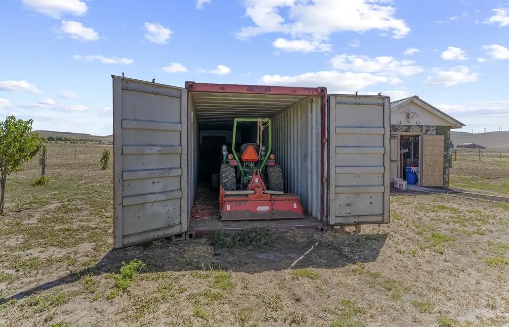

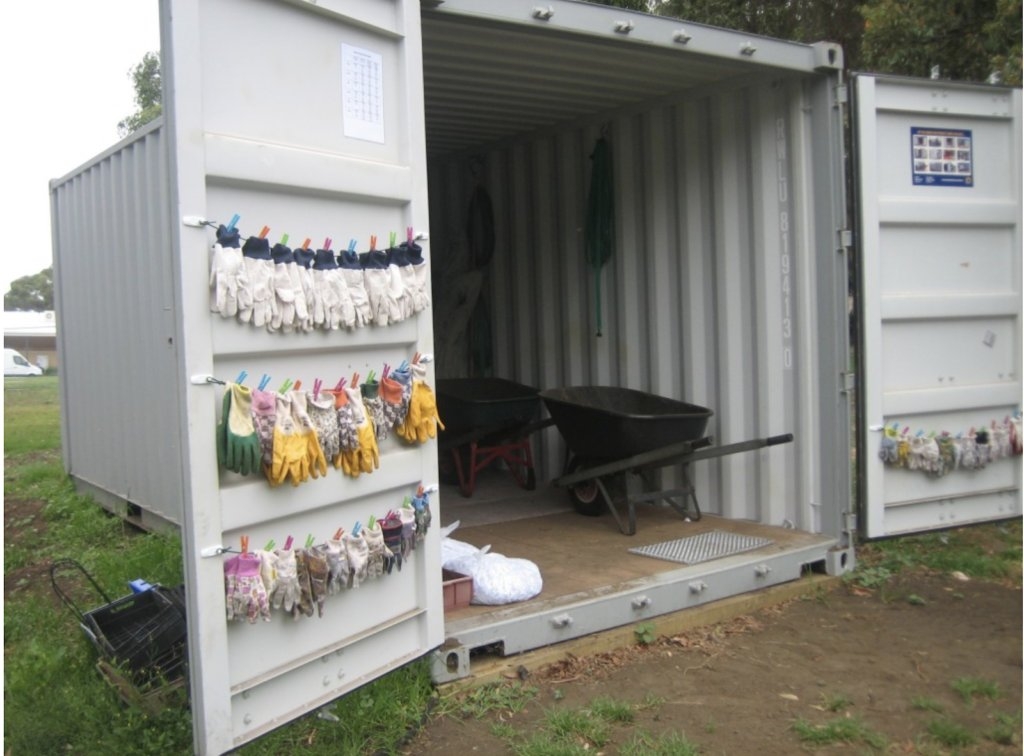

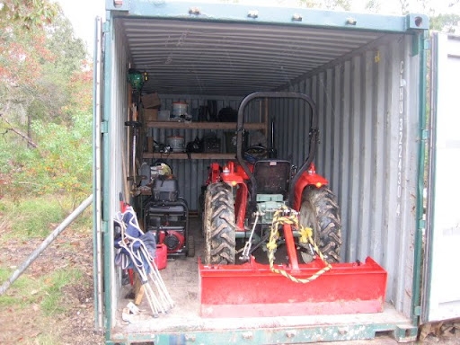

Several TBN members are not into building, but have it delivered and dropped in the perfect spot to use. Most are delivered within 50 miles for free delivery.
A 8x20 runs $1,800 to $2,400.
8x20 deep.
   / Advice on building a tractor shed? #112
I'm arguing with the city/county building department about placing a pair of 30-ft shipping containers with side doors, 24-ft apart on a raised concrete foundation, then roofing over the gap and installing a metal roof system. The code explicitly forbids them, but being a licensed engineer, I have the legal right to go outside code. Their big objection is they are ugly. My argument is when I sheath them with LP Smart siding, they will look fine. And, it is the least expensive way to get a rodent proof, highly fire resistant structure. Working on drawing it up, so I can do architectural renderings.

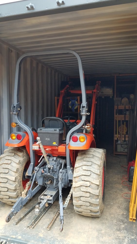

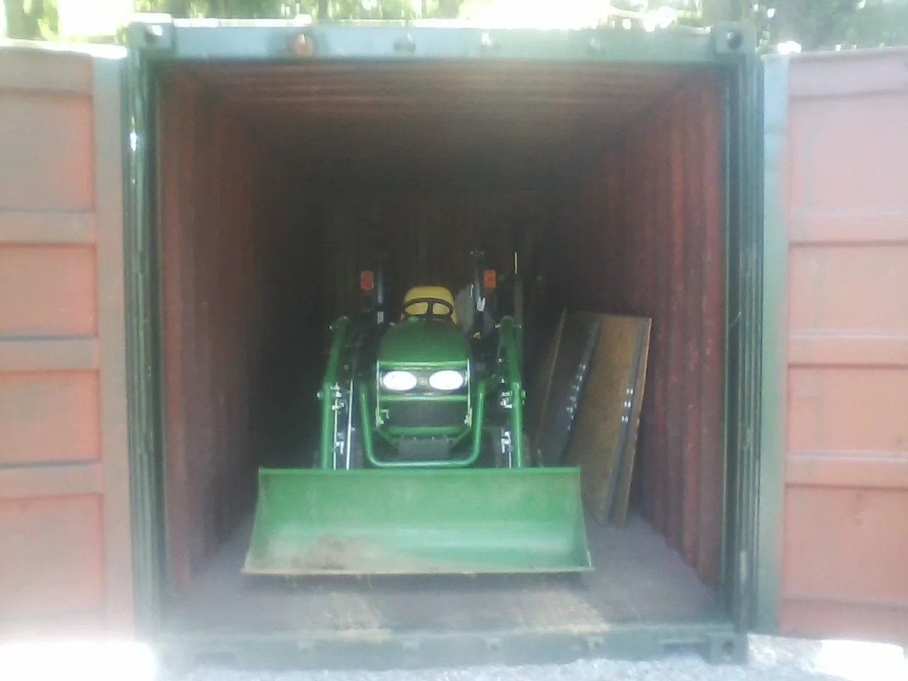

All the tractors we have looked at are slightly to tall to fit in a high shipping container...
The same reason I want a 10 foot tall door for my tractor garage. I would like to get a bigger tractor within the next two years. My little Mahindra 1626 is down to 19HP due to altitude loss. I want a 40HP tractor so it won’t bug down when grading my roads and the land plane gets full going uphill.
