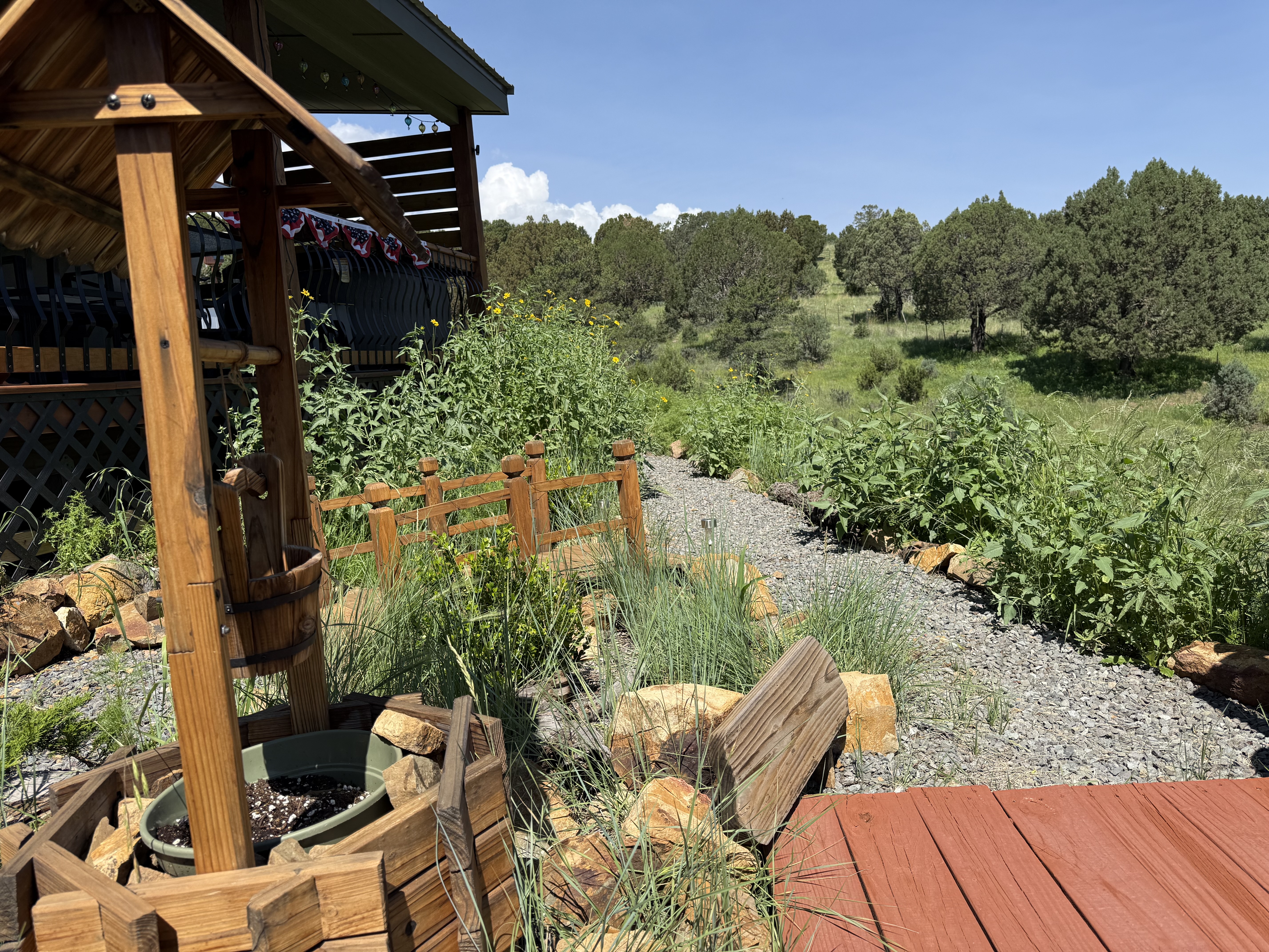

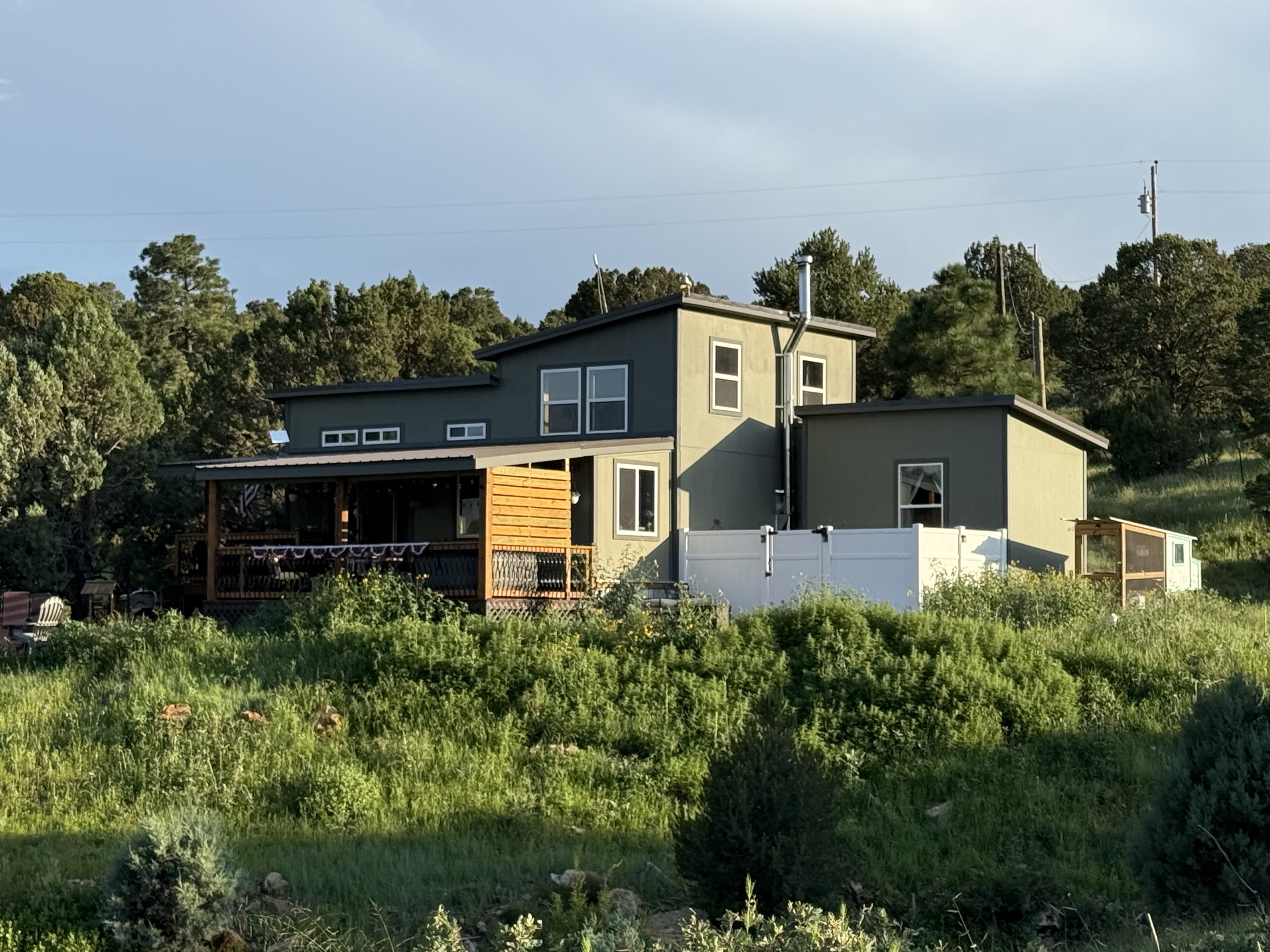

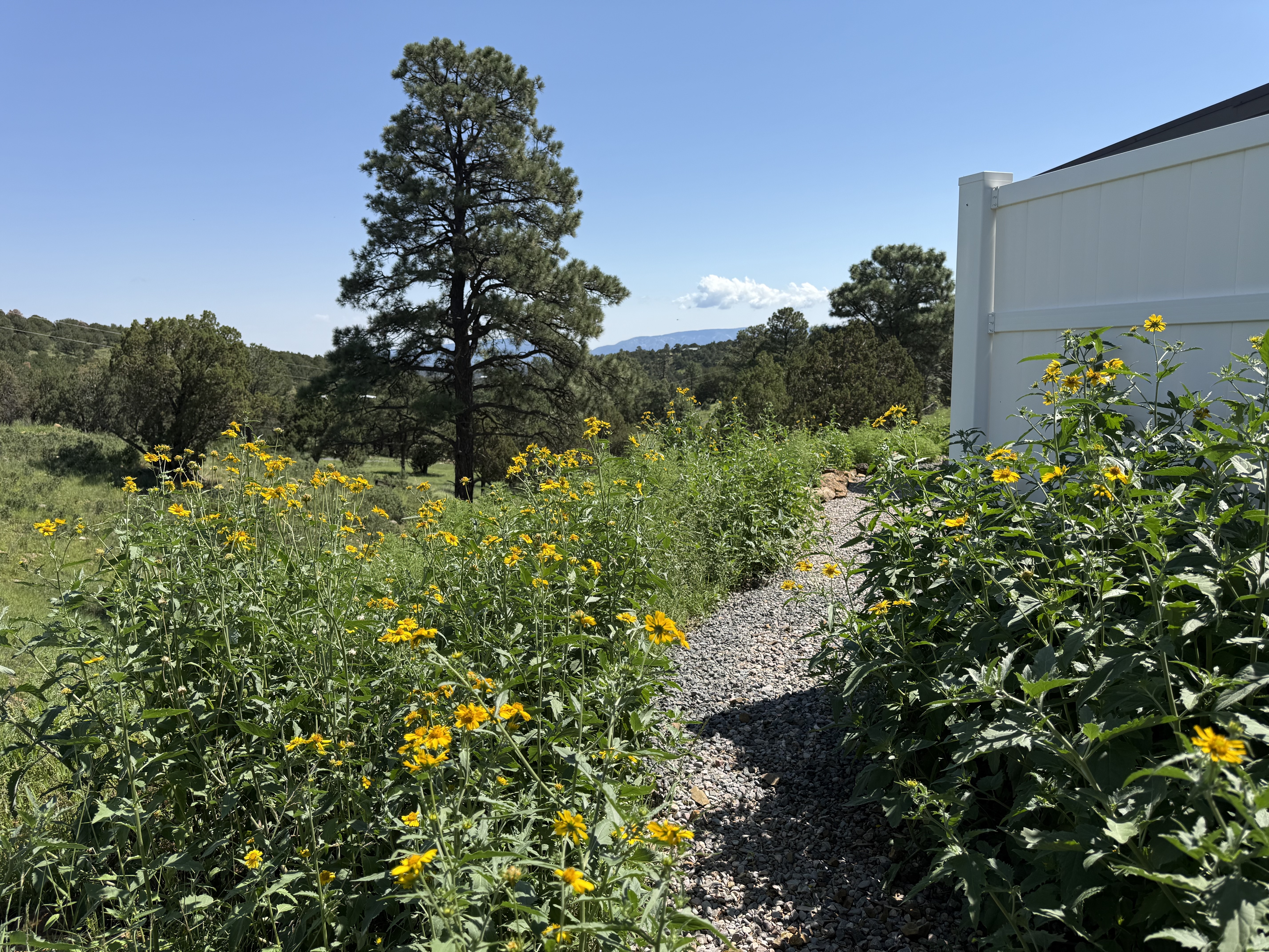

That’s the idea. We like to keep our acreage mostly in a natural state. I have a flail mower for my tractor but haven’t used it in two years since we like the flowering plants and grasses that grow yearly. They feed the local animals and birds. Our two driveways are long, one being 1/4 mile long. I grade them a few times a year. We just finished our guest cabin. Waiting on final inspection. The last picture is the guest house.

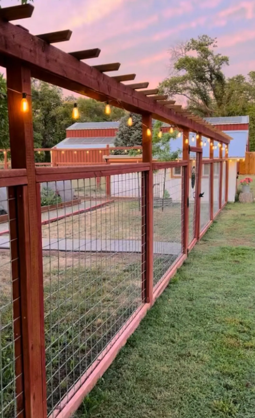

We have good luck with a 6’ tall woven wire fence with a cable running at 8’ post to post.
The fence shown looks nice too.
   / Advice on building a tractor shed? #89
Good luck with a deer fence; I watched a doe walk up to a 6' woven-wire fence, rear up, then spring over the fence easily.(this was uphill too) She then walked to the neighbors garden for lunch.
I’m planning on building it at 8 feet tall including the upper board. Hopefully it will stop Elk too.
