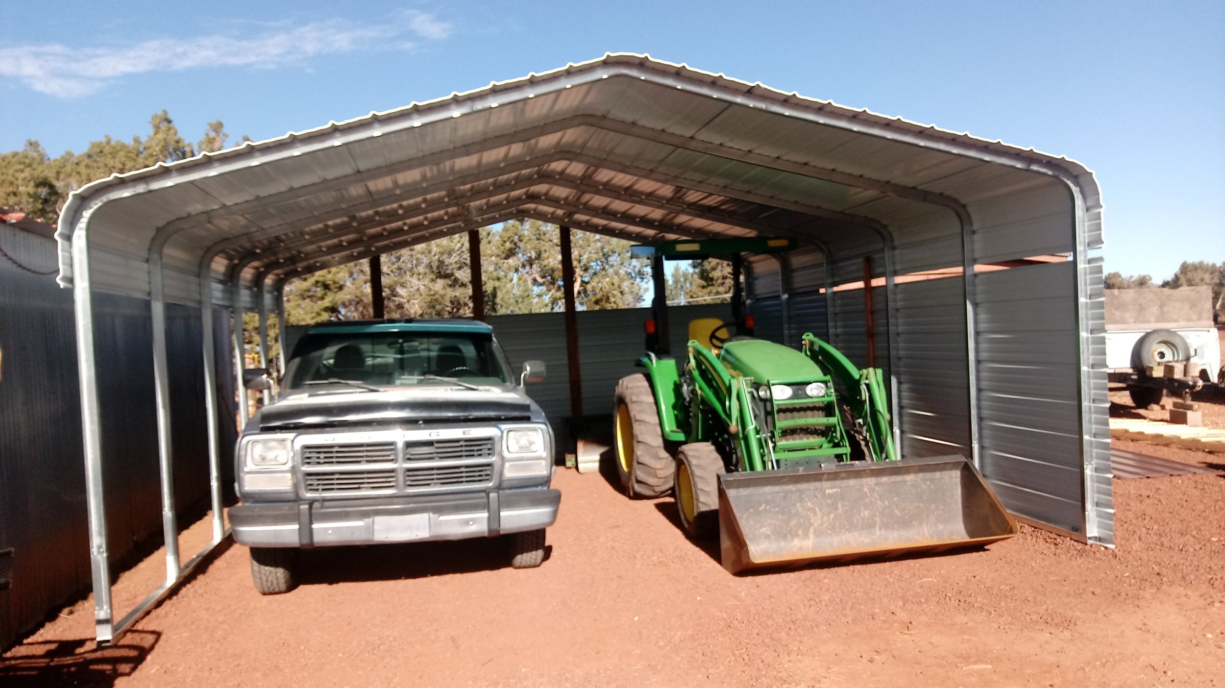

My shed, is split into 2 sections, 1 enclosed, 1 just carport. The enclosed is 16x24, and the carport part is 12x24. I park the mower, tractor, SxS, and grill under the car port part. It is barely large enough. The enclosed part also has concrete floor, partial insulation,
Guess what I'm saying is, 20 ft x 20 ft is pretty small

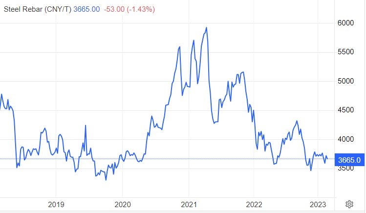

One of the problems with the kits like Versatube is the amount of steel.
The price of steel just about doubled from 2019 to 2021.
and to all you groaners out there I realize that it's rebar, but the price of all steel goes along.
Anyways the companies jacked the prices up in many 10% and 20% price hikes since 2019 and have only come down a smidgen.
The price of steel just about doubled from 2019 to 2021. View attachment 817250
yes i have noted that also the price goes up immediately but is slow to come back down.
