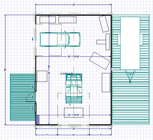

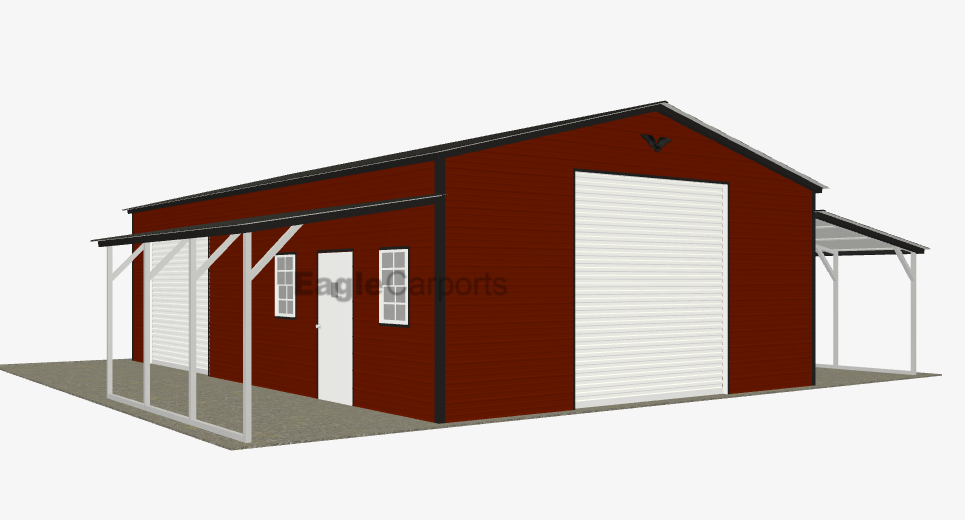

If my wife gives the green light to build our third metal garage on our property, I am considering a garage to store my tractor, tractor attachments (7 in total), my Jeep Wrangler YJ, a chipper shredder, push weed trimmer, cement mixer, you get the hint. I have way too much stuff. The garage would be a 24 x 35 with a covered entry. A front 10x10 garage door and a 10x8 side garage door. On the right side of the garage there will be a 35x12 lean to carport to park my flatbed trailer. I am considering raising the height in order to also store our 20' camper. This one would be sitting on gravel unlike the two other garages and powered by solar panels for lights, a few outlets for charging batteries and tool use. The other two garages are used for parking, storage, gym with a traditional sauna and woodworking shop. This time I will position the new garage away from the house and two other garages, so it doesn't look too crowded. I wish I could have had the 2,000 sq ft garage space under one roof but our land does not have that many flat areas, so I had to spread the buildings.
What do you all think about this garage plan? On the plan I more used 2D images of vehicle sized accordingly to what is going to be parked inside. The tractor with the land plane and the Jeep. The shapes spread out inside represent attachments.

   / Advice on building a tractor shed? #76
You have Too Much Stuff!!!
Downsize.
